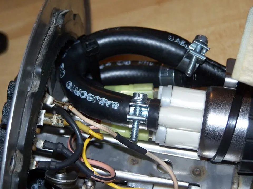

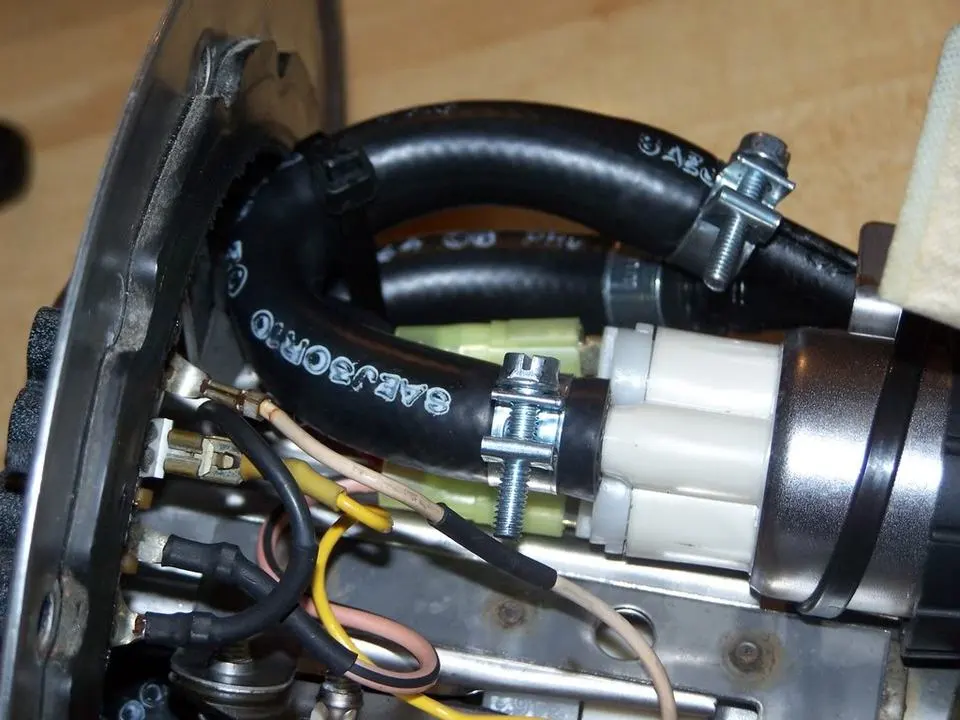

i also did the PPRV delete and ran 8 gauge wire for the pumps today:D

:D Its a valve inline on the 03-04 cobra basket that dumps fuel pressure past 70? PSI. So when you shift it dumps pressure and causes a hesitation....also is a big flow restriction.
No way I was going to leave you hanging on the answer lol. :D
DO IT DO IT DO IT
Im thinking about doing it to my 03....has that darnd hesitation! Mainly because I suck at shifting this thing....if I was faster like with my GT I would never even feel it! I shifted faster than the pressure could build up :eek:

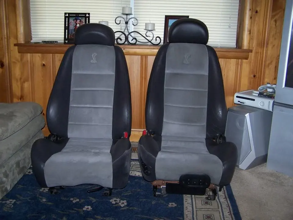

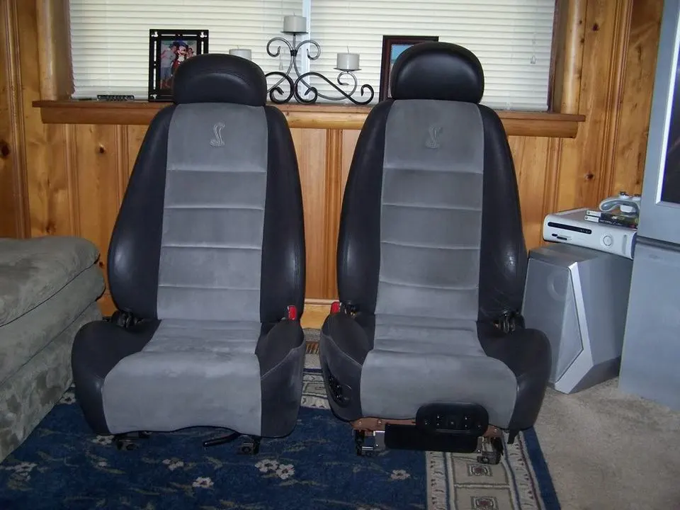

got a couple more things to add to the list today. i have been wanting these for a long time!!!:hail2: these are sooo much better than the stock GT leather seats. you dont even want to know what i paid for them............i got them for the best deal i have ever made:nice:
they are still a little damp from cleaning the inserts. thats why the color is a little darker in some spots
