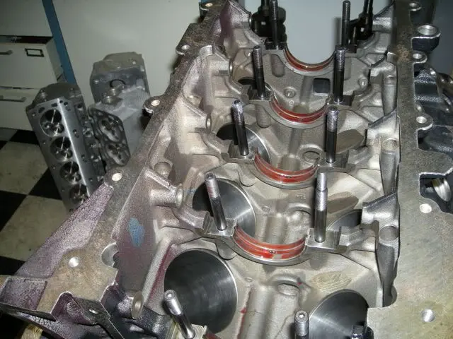

more new parts came in

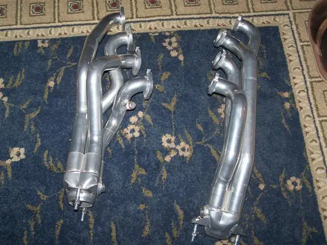

got another one in today
These are the header gaskets that I used on my GT. Turbo cars have alot of back pressure....and I had only one blow out (I didnt retighten the bolts :( ...two bolts IN A ROW were hand loose and it didnt blow....somehow it backed out again (not using locking bolts FTW!) and this time it started leaking.
I was very impressed with it not leaking the first time, so I bought another set and just replaced the one side....never had another problem and I highly recommend them. If they will hold up to my GT....they will hold up to a S/C car no problem, just use good bolts!
Percy's dead soft. I bought mine from summitracing...but you cant link with their site, so I found another place that sells them.
http://www2.partstrain.com/store/?N...331+1616+4294967010&y=2004&mk=Ford&md=Mustang
