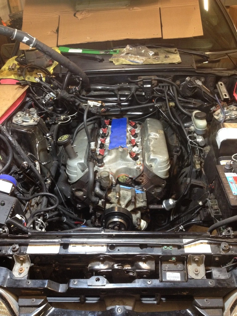

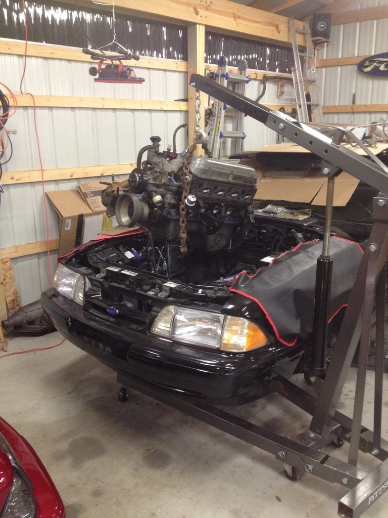

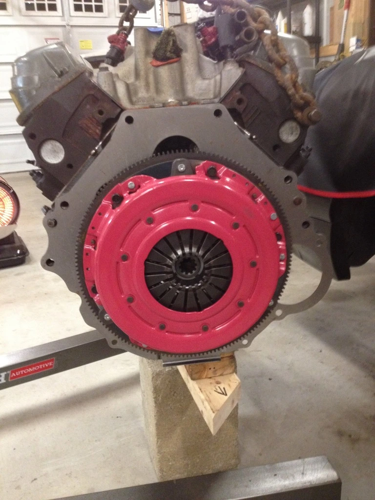

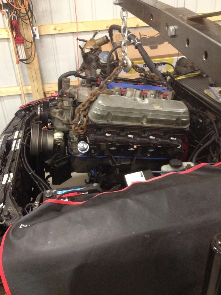

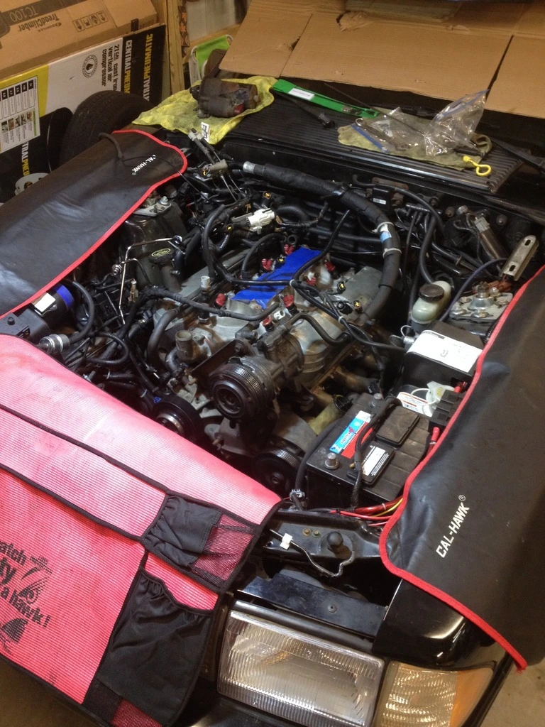

Got the motor bolted in. I had a but of trouble getting it to come together with the trans. Then I realized the trans was in gear. Put it in neutral so the splines could mesh and it went home. A strange thing happened with the clutch play. After bolting it up, at first there was a ton of free play in the pedal but after several depressions and releases of the pedal the slop went away. Any idea what might of caused that? Im thinking the clutch cable may have become partially dislocated at the fork while I was struggling to bring the engine and trans together and then it worked its way back into the proper position on the fork. The clutch feels good now and is holding and releasing as it should with no excess play. Here's a few pics of the action.

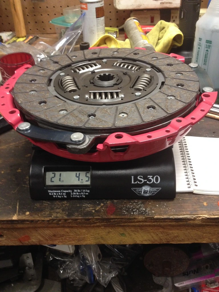

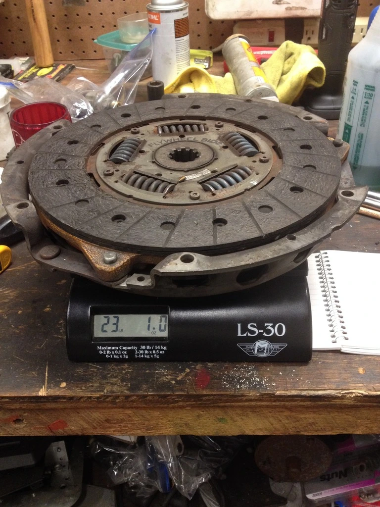

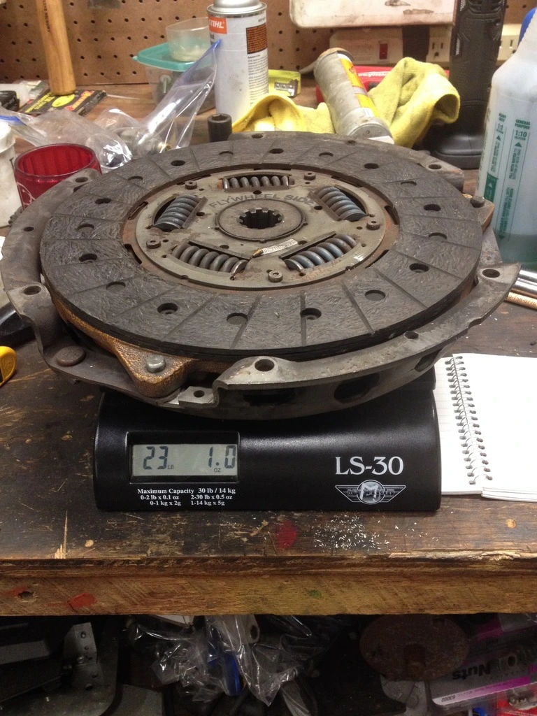

New ram pressure plate / clutch is almost 2 lbs lighter than the old one
Clutch bolted up with new separator plate
Dropping in
Home
Cold A/C back in place
