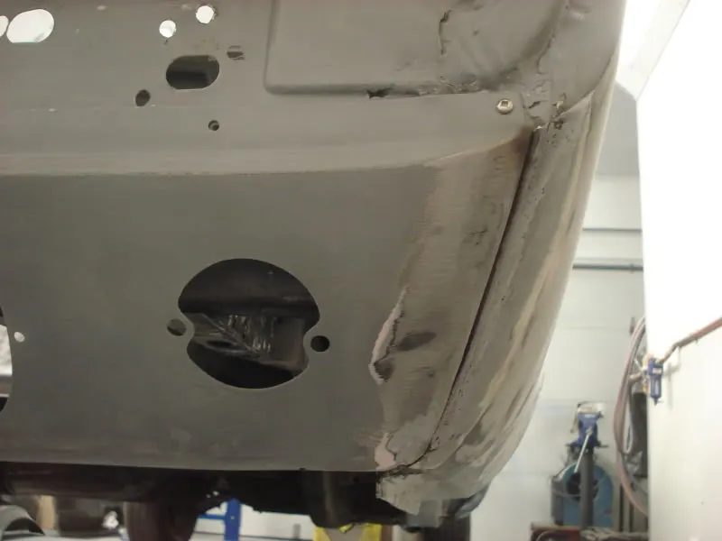

I was staring at it today and starting to make a template but it just doesn't look right. I was going to add onto the valance assuming it was the offending part but my quarter panel doesn't look right. It was also replaced prior to me getting the car and I know it was put on poorly in some areas, I already replaced the bottom of them between the door and wheel well.
Anyway, shouldn't the seam that runs between the valance and the quarter be basically a straight line? The bottom of my quarter curves in a lot, I'm now thinking I need to add on to the quarter so I'll have a seam that follows the very near to straight line on the valance? Does that make sense? I wish I had a nicely restored one near by to look at for reference constantly.

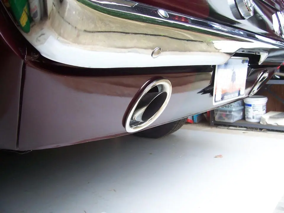

Some of the repo panels are pretty bad. My fit looks very similar to the 1st pic displaying the bumperette and same color too

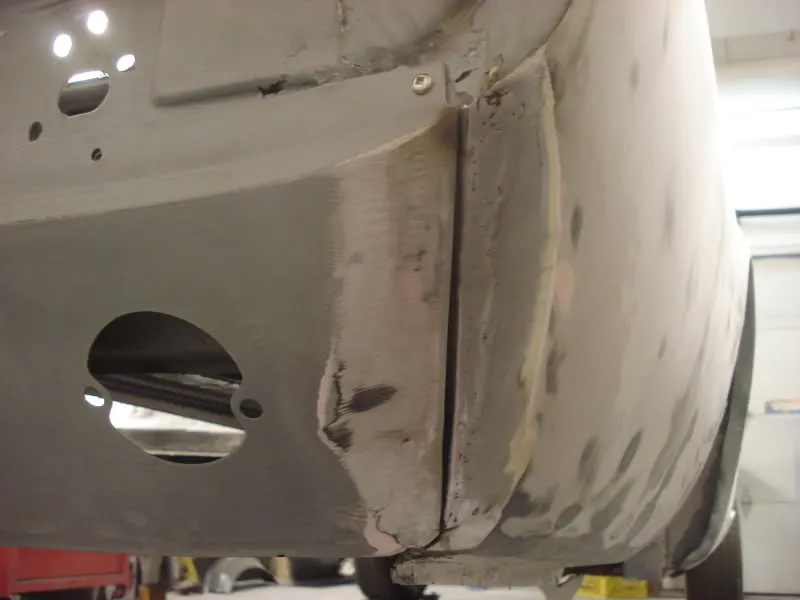

I got started with making the patches today, I'll be adding onto both the valance and the quarter. Lots of fitting left to do but you get the idea, trim and shape the pieces on the outsides to fit and then weld them in
I haven't chewed into the other side yet so I'm not sure what it really looks like, this side looked fine until I started grinding all the filler out. I'm away for the weekend but I'll take some pics when I get back. Both quarters were replaced so my guess is the other side sucks too, we'll see.

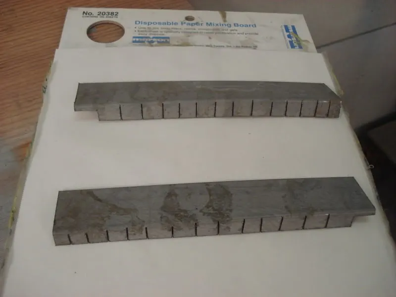

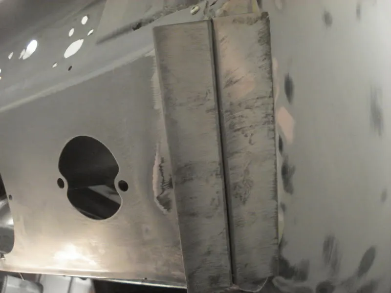

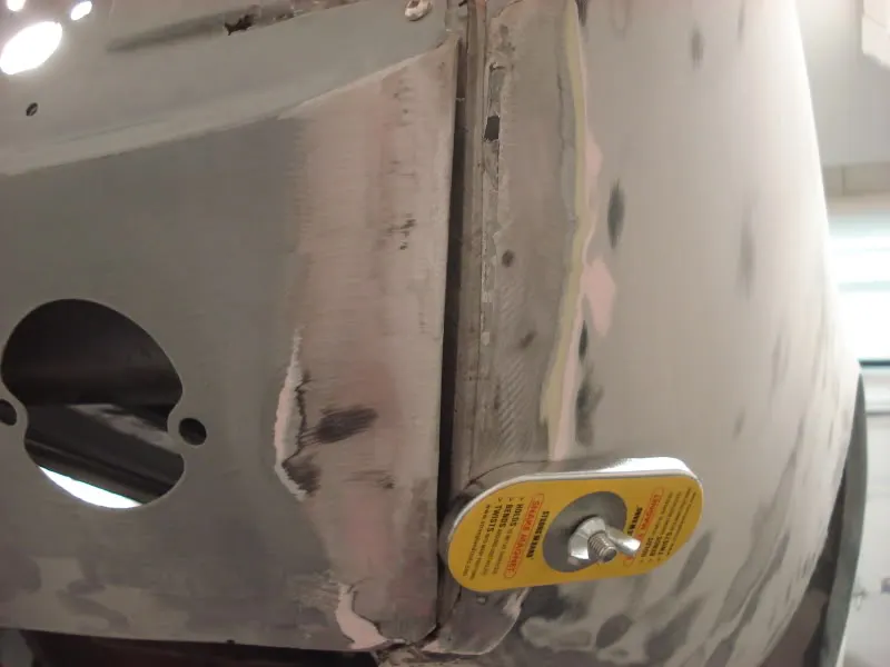

As far as the repair, there isn't much to it, I bent some 90 degree blanks up and put some relief cuts in one side so it would bend to the curve. Trimmed the other side to fit and welded it in. One side is roughed in, still need to clean it up after I do the other side. Already looks way better.
held in place with a magnet
