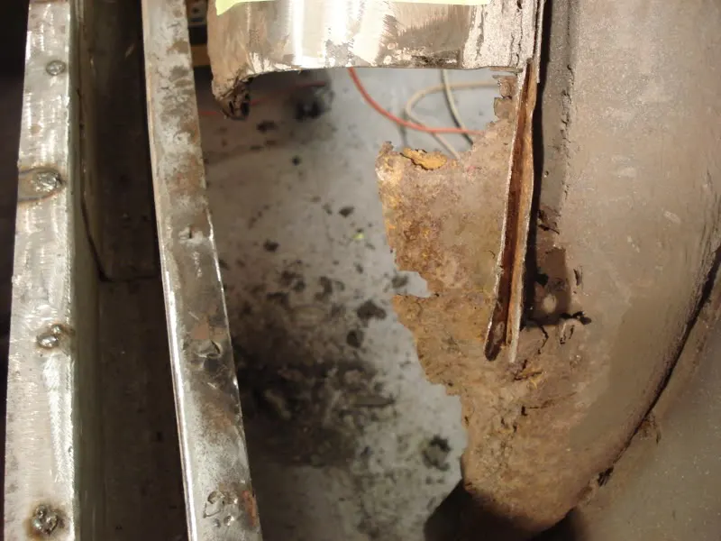

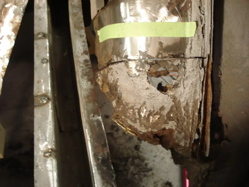

I cut a small piece out of the rotted wheel housing to start on fitting the patch, still have a lot more to cut out. When I cut the piece out there was more metal under it, I thought the wheel house was two pieces spot welded at the centre flange? In the bottom picture it looks like it's a one piece deal, I'm pretty confused by this :shrug:
I will also have to make a patch for the outer wheel house at the bottom, should that have a flange for the drop down panel to attach to?
