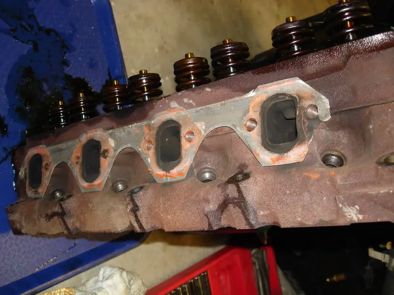

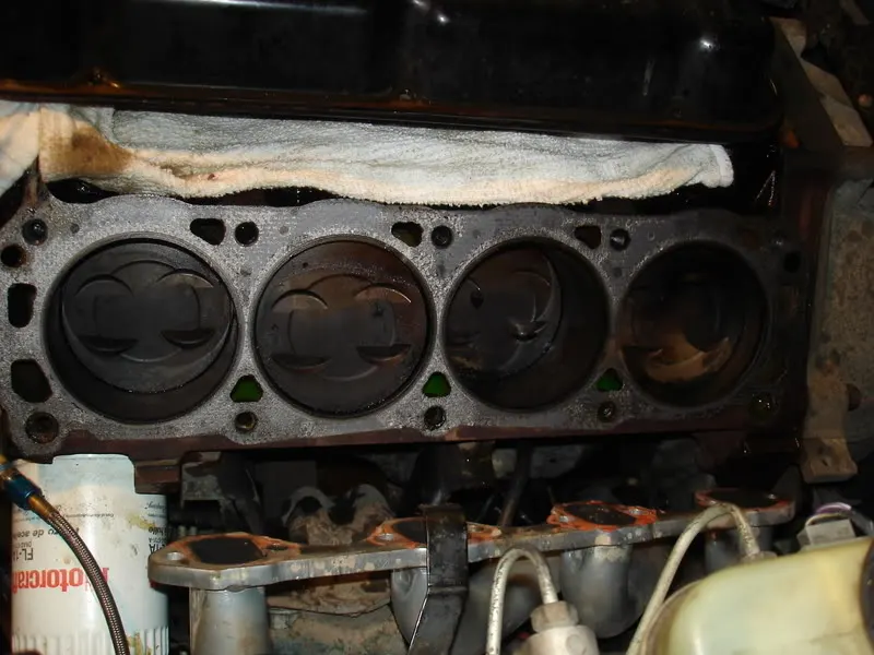

Well i took it for another drive It started over heating again So I started ripping into it. I got it all taken apart but not cleaned. I also broke one of the front bolts for the lower intake in the head. My question is if/when I get it out where can I get another bolt, Would a parts store supply them??? And should I replace the head bolts?
And I got some sand in the lifter valley vaccumed most of it up but couldn't get the rest, hope it comes out with oil change.
I had 5 exhuast leaks that could have caused my rough idle. 1 big leak on #8 and #1,2,3,4 were all leaking. I was using bbk gaskets with copper rtv.:D:nonono:

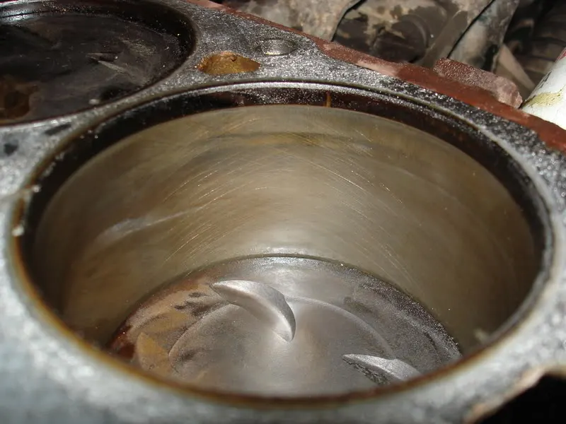

Atleast my cylinders still have the cross hatching.:nice:

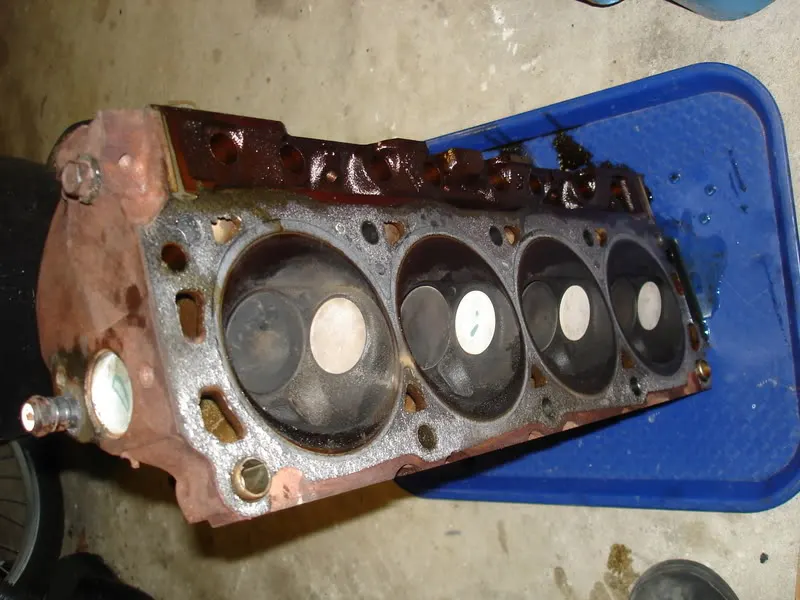

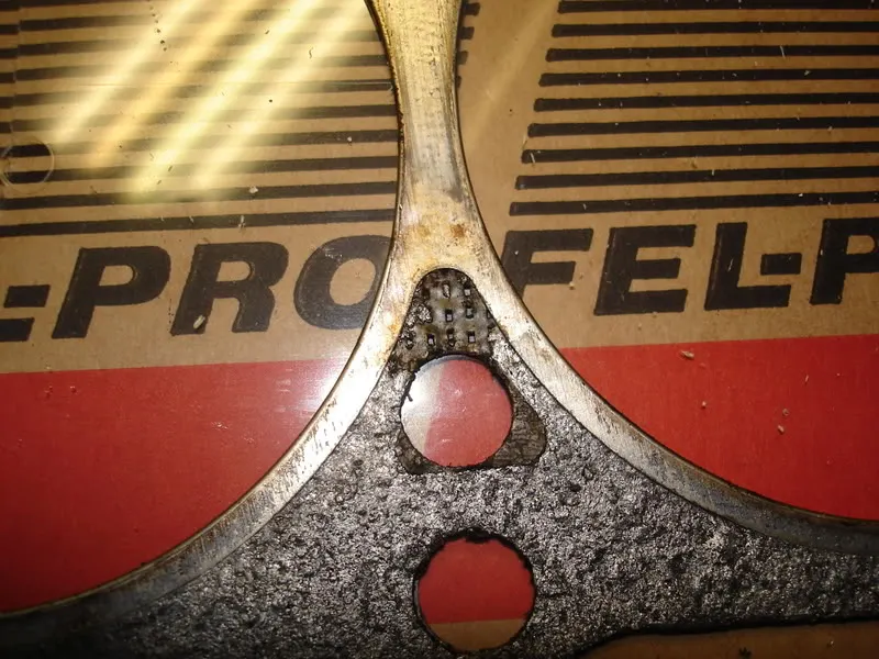

And I found the problem. :nice:
Its funny how it looks to be very difficult but its really easy. :nice:
Whats for lunch kids??? Heads A la Mode Via lunch tray. :spot:
Doesn't look too bad...it could be worse. It is recommended to buy some new bolts. Get some ARP studs. Same goes for intake bolts. Engine heat cycles weaken bolts. Its a little insurance so you don't have to look at head gaskets for a while. If you got bolts snapping im sure the rest of the bolts that didn't snap aren't doing that much better. You could be like me and reinstall the intake and snap a bolt 3/4 of the way threw the torque sequence and have to rip everything apart again. :nonono:
good to see its something simple like a head gasket. your better off getting new head and intake bolts. they aren't that expensive, and it's better to buy them now then to keep replacing head gaskets
