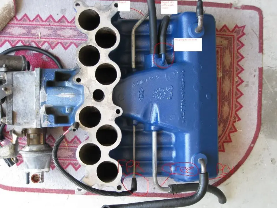

using 98 upper and lower. all torqued to specs. used explorer 19# injectors. all new gaskets, stat. cleaned rotor connectors on dizzy. added fuel injector cleaner. smog pump was removed and egr disconnected. vacuum lines that are connected to the upper intake are pcv, vacuum tree, fpr, and vacuum check valve. all other's are capped. on the stock i had a line going to the map but current that line is capped from the upper with a tube coming out for a quick install to the map. the map is not capped (opened to atmosphere). the solenoids for the egr are all still connected but no vacuum lines are connected. there are a few small ones that went to the smog pump that are free (worked fine on the stock intake). stock tb and egr block. tps was not disconnected (was set fine on the stock intake). dizzy was not taken out. only the top part. so i didnt have to restab it.

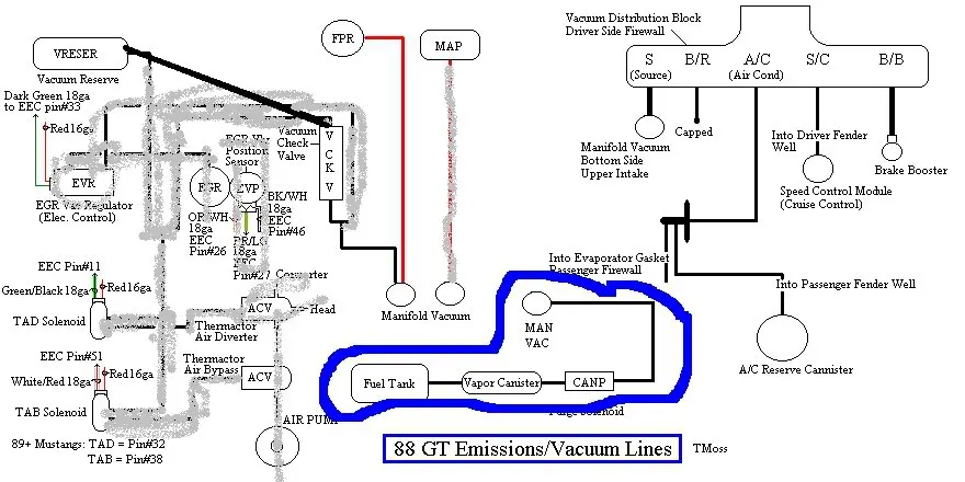

here is an edited pic of how i have my vacuum going.
does it matter where they are connected to on the upper intake

Vacuum lines to supply vacuum are not location specific. Vacuum is the same at all manifold locations.

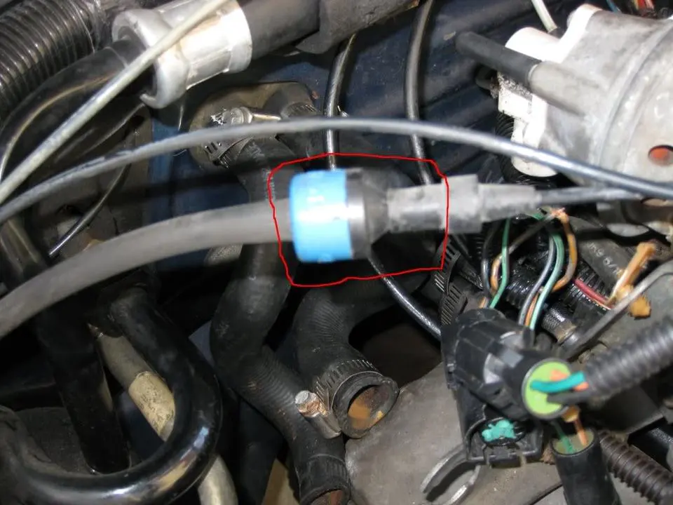

is this the vacuum check valve and does that stay on when the smog and egr is removed?
current upper intake connections.
