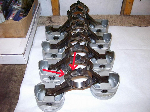

The rods are labeled for you from the factory... they have a number stamped on each of them so you can't get them mixed up unless you don't look at the numbers. Do you have the correct size rod bearings for the crank journal diameter? Also, there is a chamferred edge on the big hole of the rods that must face away from each other... two rods share a single journal on the crank. And BTW, plastigauge is your friend... an engine should never be built without using some of it to make sure things are right.
This is MOST likely the problem.
Go back and check each rod for the chamfer is toward the crank journal radius and not towards each other.
Don't forget... it's possible to have installed the rods on the pistons backwards. When you have the rods installed on the crank correctly, the pistons must also face the correct directions too!
where are the numbers ? I can't find anything but casting numbers on the rod length. When I assembled the motor I turned the notch in the piston towards the front of the motor i have never seen factory pistons put in any other way, with the exception of some old mopar men who believe turning the notch backwards is good for 5 or so horsepower.
Capri debri is right as rain the rods have each cylinder number stamped on them albeit very small you can see them if you know to look. Now moving on, let's say I tear this thing back apart yet again switch the slugs to the proper holes, check clearences and chamfer's and retorque everything do I still need to expect problems because of the first wrong assembly? I did not use excessive force trying to get this thing to turn so i know i did not damage anything, and the bearings are the correct bearings as far the size. thanks you guys you have been a life saver and have deverted a disaster.:nice:
Rods and caps are matched sets. They are put together and then the big hole is machined. They can not be mixed up. Each rod has a cap that goes with it and only it. The numbers are stamped where I put arrows in the pic below. Each rod, cap and piston assembly must must go in the proper cylinder with the notch or dot on the top of the piston facing the front of the engine. You should have done some more homework before trying to build this engine. I wish you luck, but who knows what else you may mess up before it's all done.
