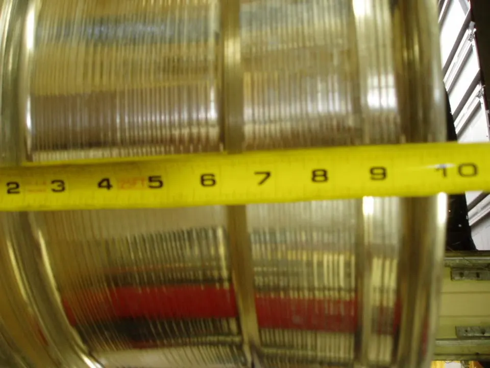

9.5 Inch

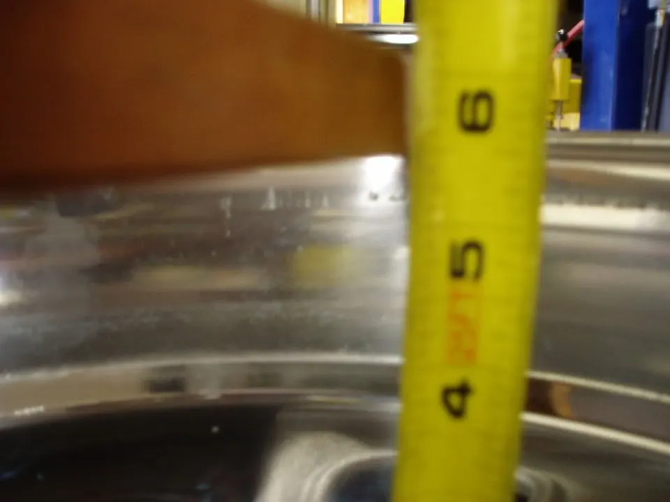

I have 9.5" (inside to inside) rear wheels,
With a 5.5" backspacing

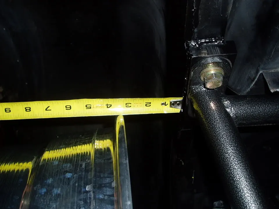

I have tubbed the rear and I get 3" of clearance from the frame.
Now I have removed the stock rear springs and the axle bump stop. I replaced the entire axle with a coilover. The stock springs may be your biggest obstacle!
