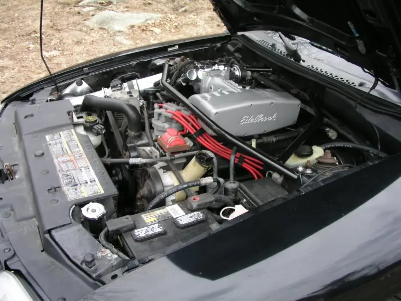

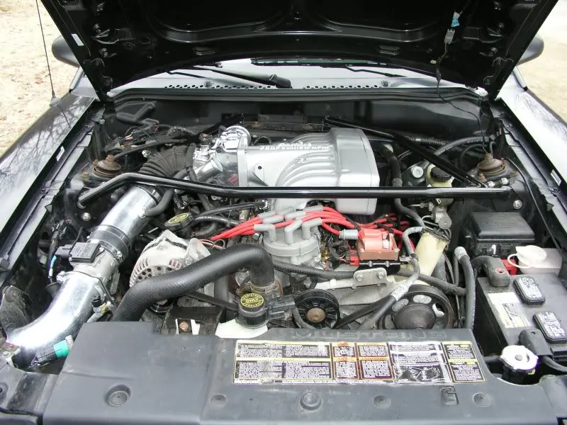

I found that I had change the wire routing a bit from MSD's instructions to make the wires fit better. They don't leave much extra room, but at least they won't get much in the way.
I also added the MSD wire separators and that helped clean things up a good bit.

There is no possible way I could route my wires like that. Each of them are turning tight just to get on the plug. You can see how they had to be stretched under the intake just to fit on the plug wire.

Yeah, those are the MSD 94-95 specific wires. Like I said, figure out the lengths to which plug yourself, not by that install sheet and you'll be much better off.
