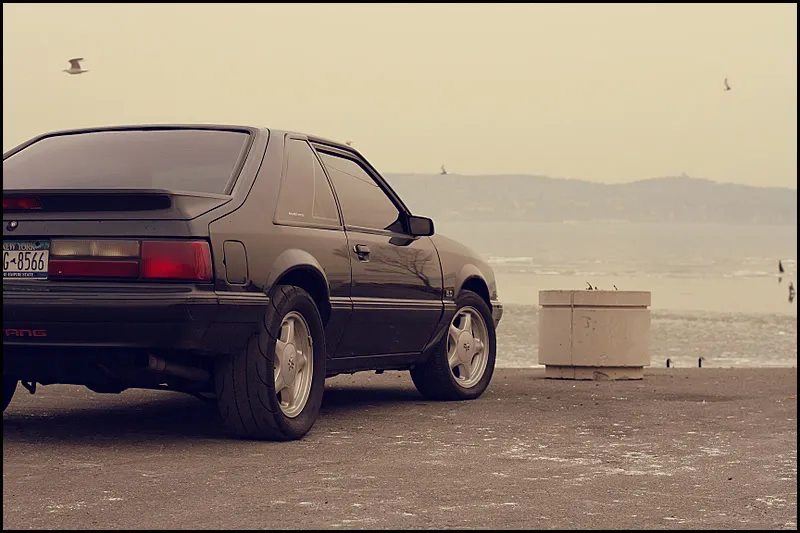

Those tires on Ponys will fit perfect.
They will not touch the quads even on hard turning and will not rub the fenders.
And if you are using a flowmaster catback you will have tons of room on the exhaust.
I ran the same wheels/tires for 6 months with no problems.
I've had the mickey 255/50r16's on pony wheels for a couple years now (don't drive the car much). When I took the wheels/tires off to work on the rearend, I could see slight rubbage on the quad shock, but nothing major at all.
Get the mickeys and have fun with them! Just be easy launching too hard on stock axles. LOL.
