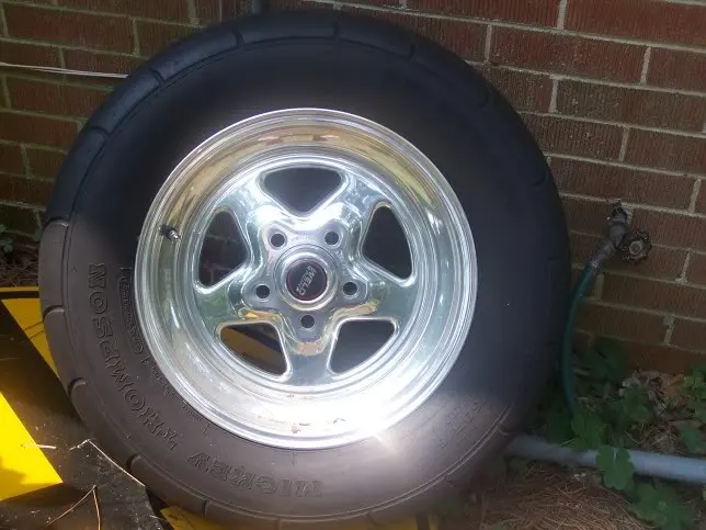

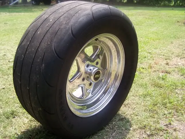

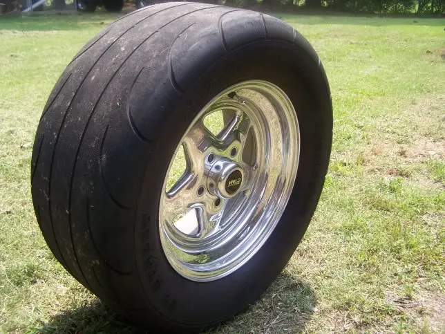

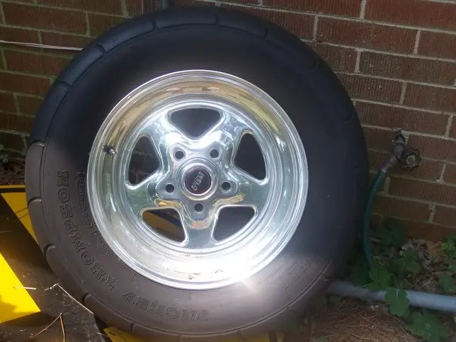

15x8 rims will be fine. i woudl rather have them on a skinnier rim running low pressure. it keeps more tension on the beads. they do run REALLY wide. my 275/50/15's on 8" rims are just as wide as my 295/35/18's on 10.5" rims
