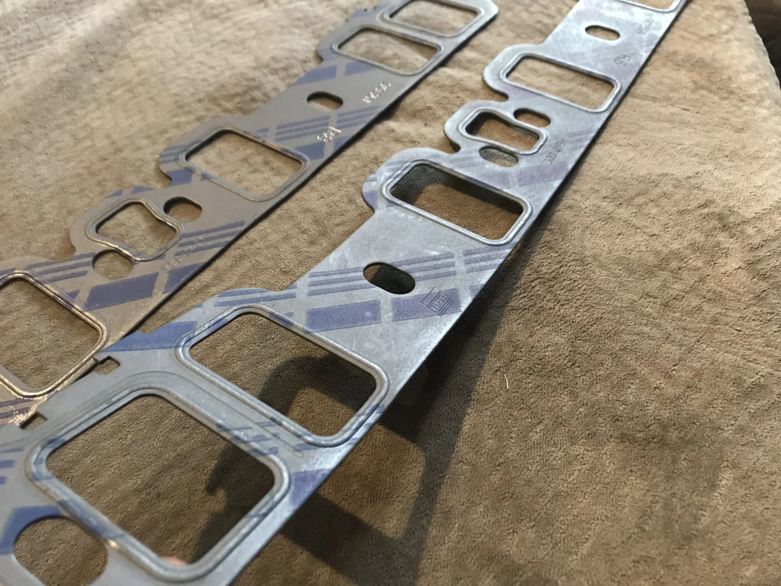

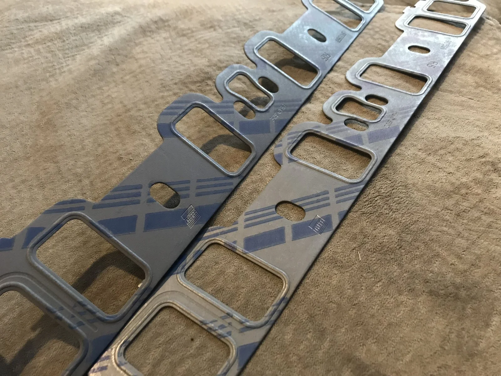

Ok sweet, I sure didn’t want to buy new ones. The new gaskets look wayyyy better, hopefully it will be a smooth install. I spent all day scraping with a razor trying to get the surfaces clean.

Whats the part number on those intake gaskets? I ask because they make them with and without a steel center layer. I recommend the ones made with the steel sandwiched in the the middle.
Those ones without the steel core tend to fail around the water jackets. The coolant then leaks including into the crankcase. If you cant return them, I recommend you take the loss on them and get the 1250s3 gaskets
