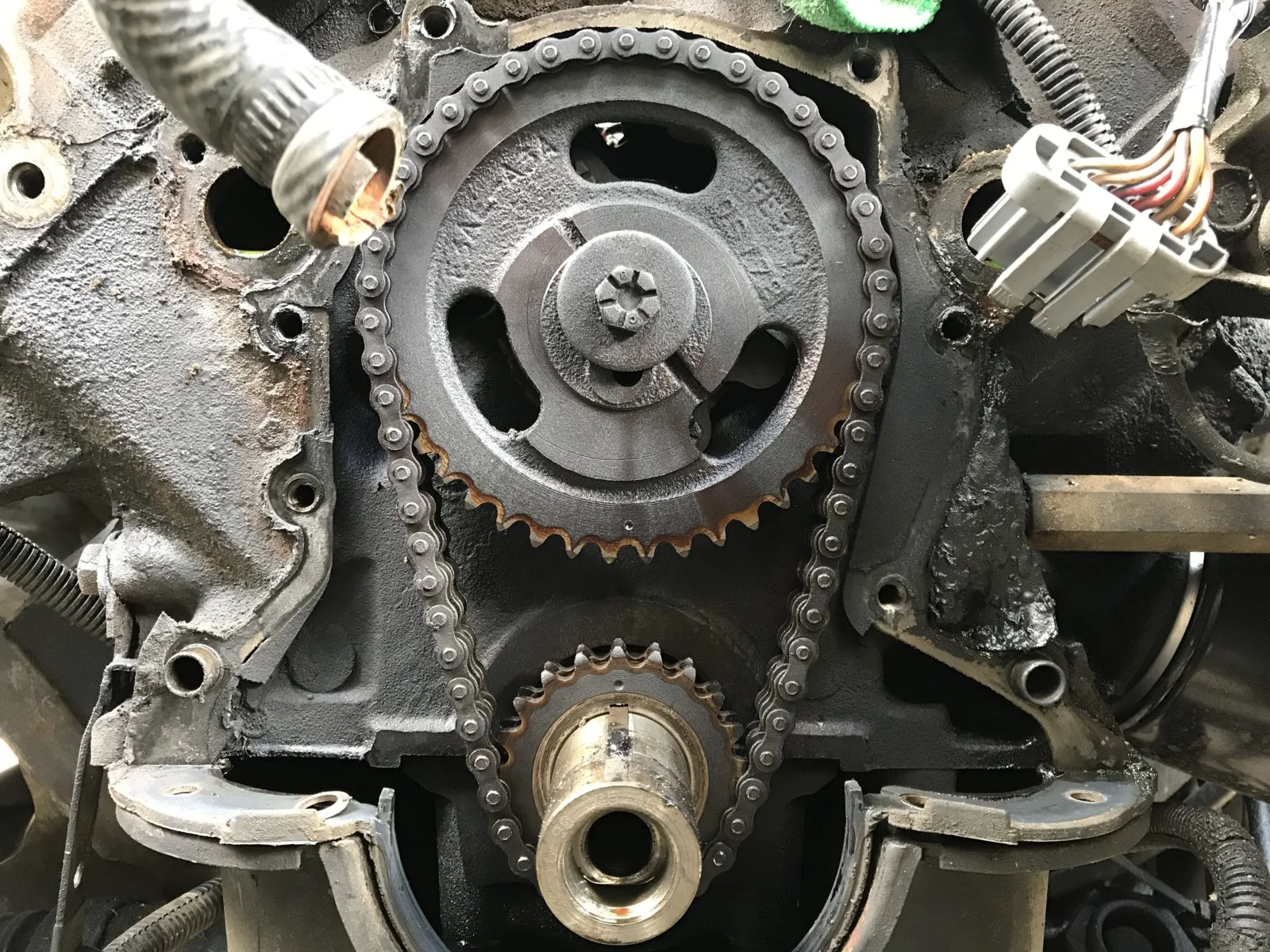

Since you have the timing cover off you should check for timing gear marks to see if they line up. You were going to do that right?

Here is a picture of the timing marks, it looks slightly off perhaps?

I just stripped mine down to the same point. Water pump went out. Had to cut the top three bolts from the timing chain cover.
My chain is tight. I think the service manual has a spec for this...
Rotate engine CW, then CCW, deflection no more than 1/2".
