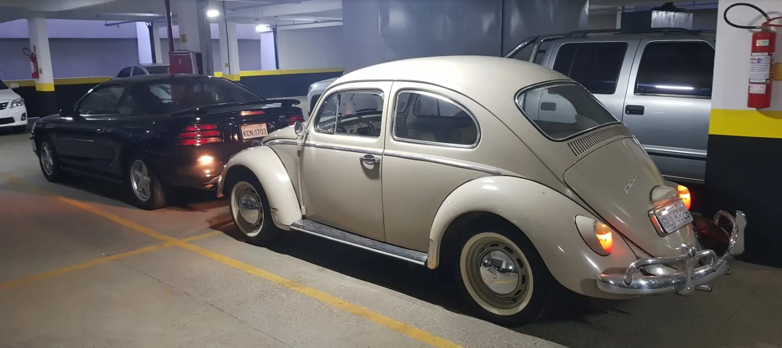

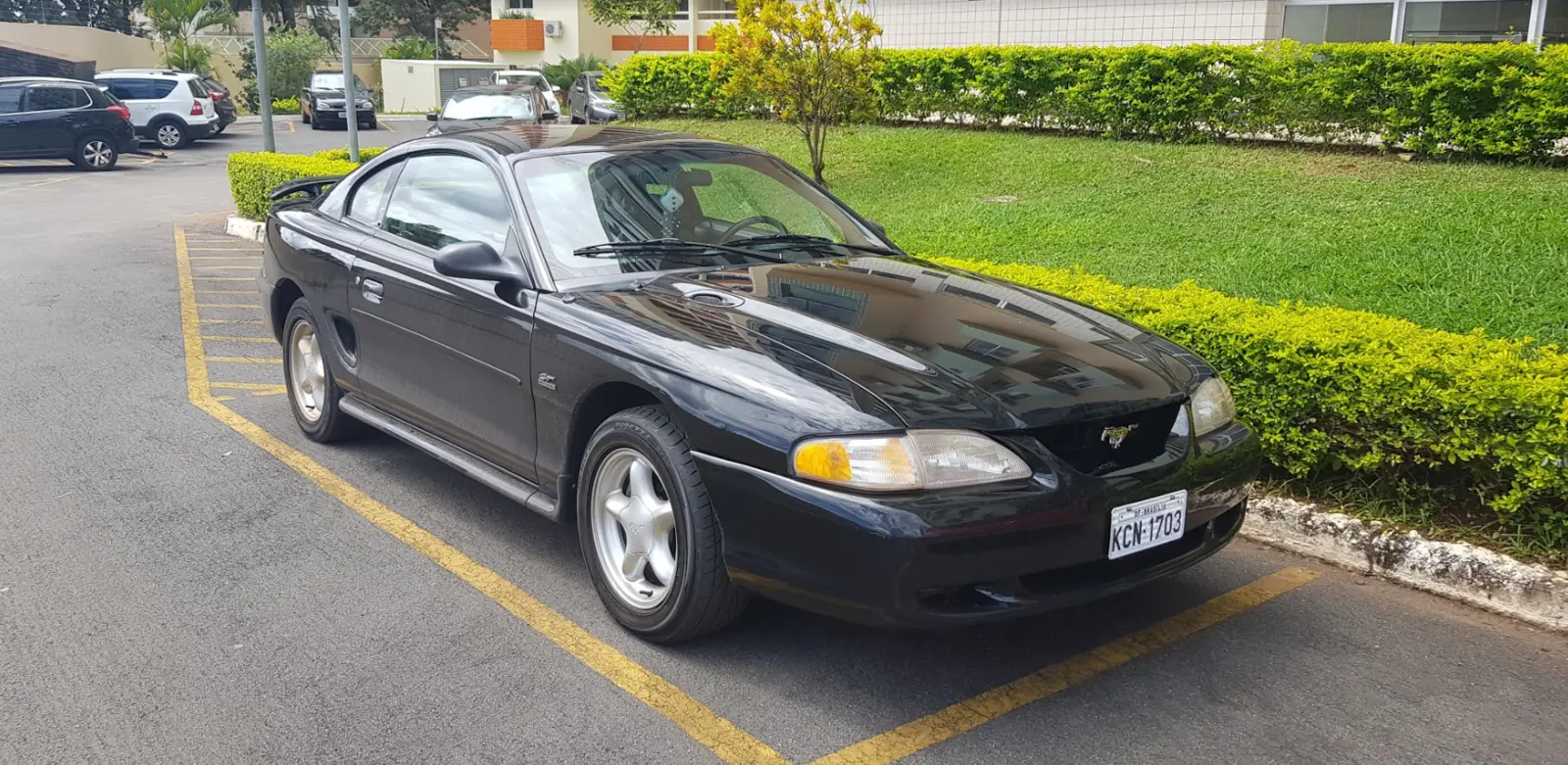

got any pics of your stang?
Thanks! I will check those threads later. Here's some pictures of the car:
