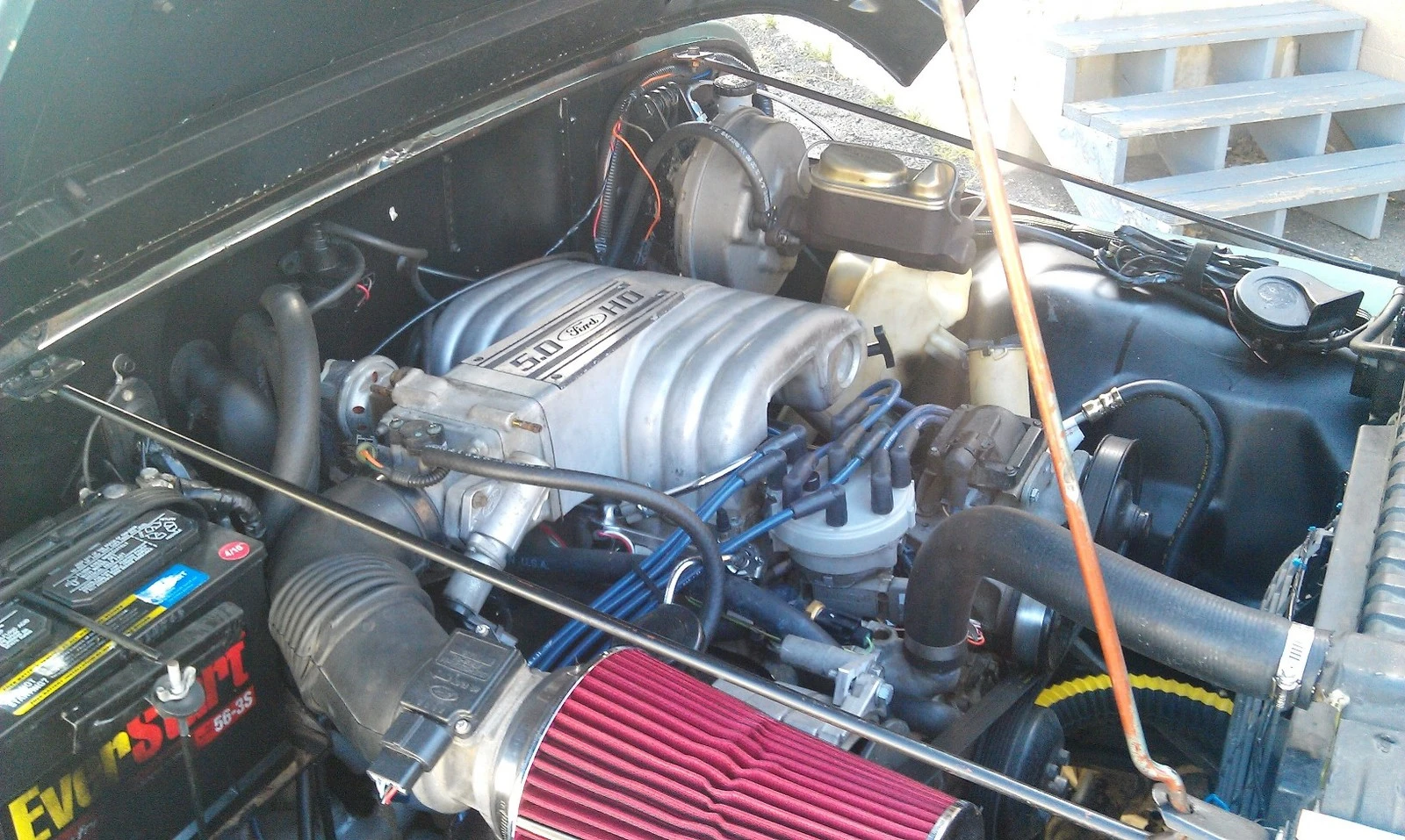

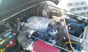

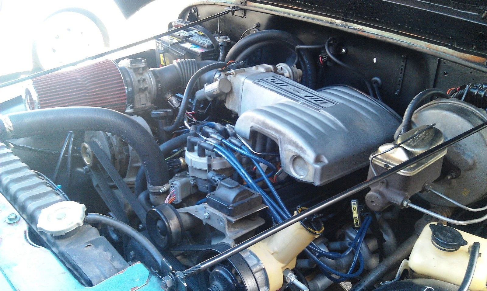

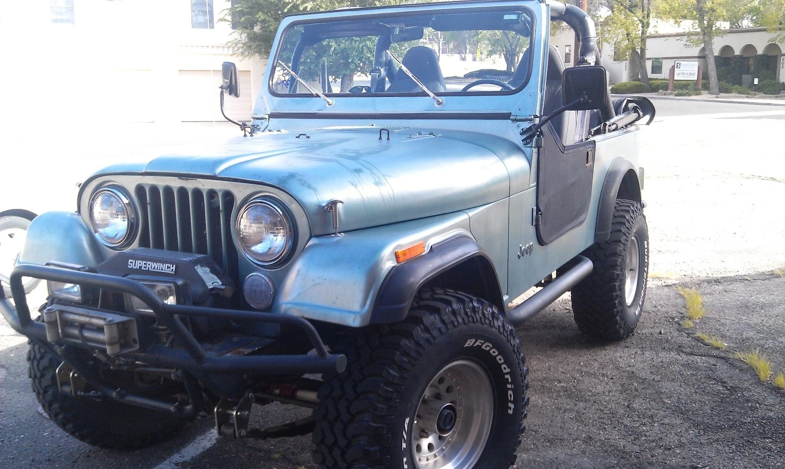

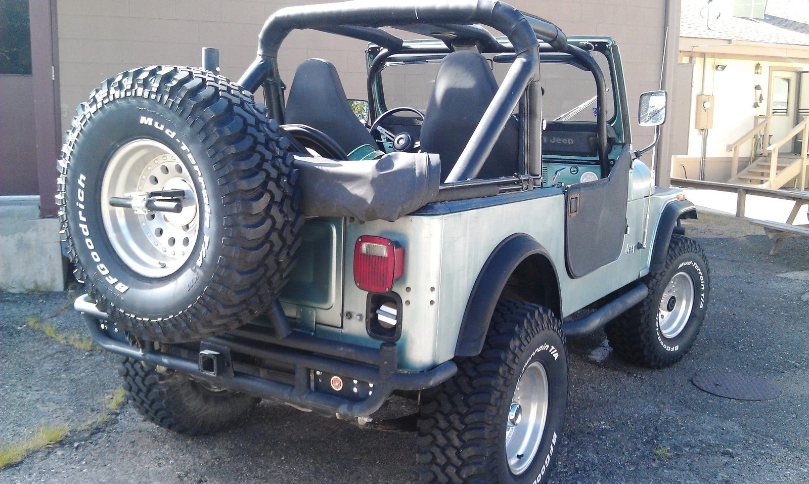

Ok guys, attached are some pics per your request. Now that the heart is solid, it's going in for cosmetic surgery on Monday. He's getting a face lift of gun metal blue and matte finish on all the black parts. Although it's going to look real "purty", he'll still be a dirt/mud/rocks/river explorer, but the paint job from 15 years ago is looking a little splotchy.
I'm sure everyone knows what "Jeep" stands for: Just Empty Every Pocket.
Reactions: Cory Berg
Not to mention it sounds sweet as H#ll.
You can see in picture #2 my recent class in the school of hard knocks on how much air a 5.0L draws. I use to be able to do this with my 258ci 6 cyl but learned that I can't do it with this engine. I typically put a gallon ziplock baggie over the filter to keep from saturating the filter when I spray degreaser in the engine compartment, then move it out of the shop (20 ft) to wash it down . Did this and it collapsed my brand new filter. Oh well, lesson learned.
Looks, great! Nice work
