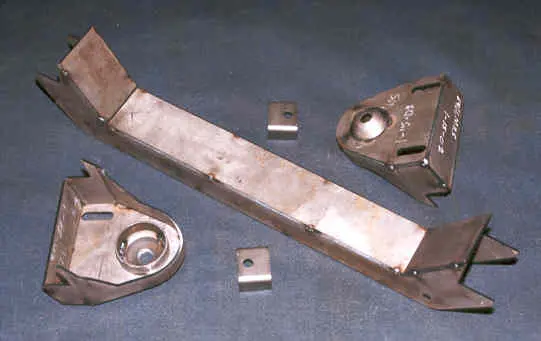

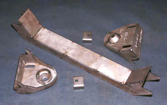

amartin725 said:
From my standpoint, the Granada spindle is much too tall for the MII, you'll have tremendous upper ball joint bind. Take a look at the difference in angles
11" brakes on the MII are cheap and easy. $40 Granada rotor (same bearings), $11 GM caliper, $25 Bracket. Done deal, IMO.
Which crossmember are you using? I had a Heidts crossmember in my hand the other day and was looking it over and had some opinions, but I want to take a look at the RC Motorsports version as well as this one from Full Tilt Street Rods before I make a purchase. You can save a few bucks by finish welding it yourself.
Al
FWIW, I will be ordering the full tilt MII setup for my 69 next week if you would like pics...I plan on taking pics of the whole car build up so I will make sure to post them up as I go...
