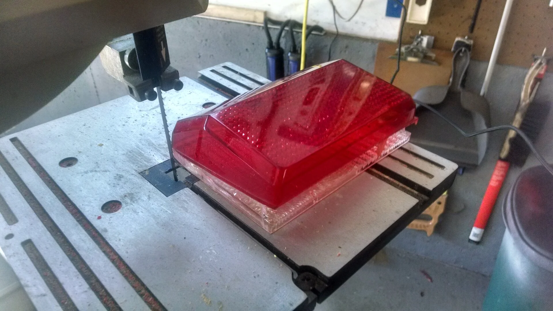

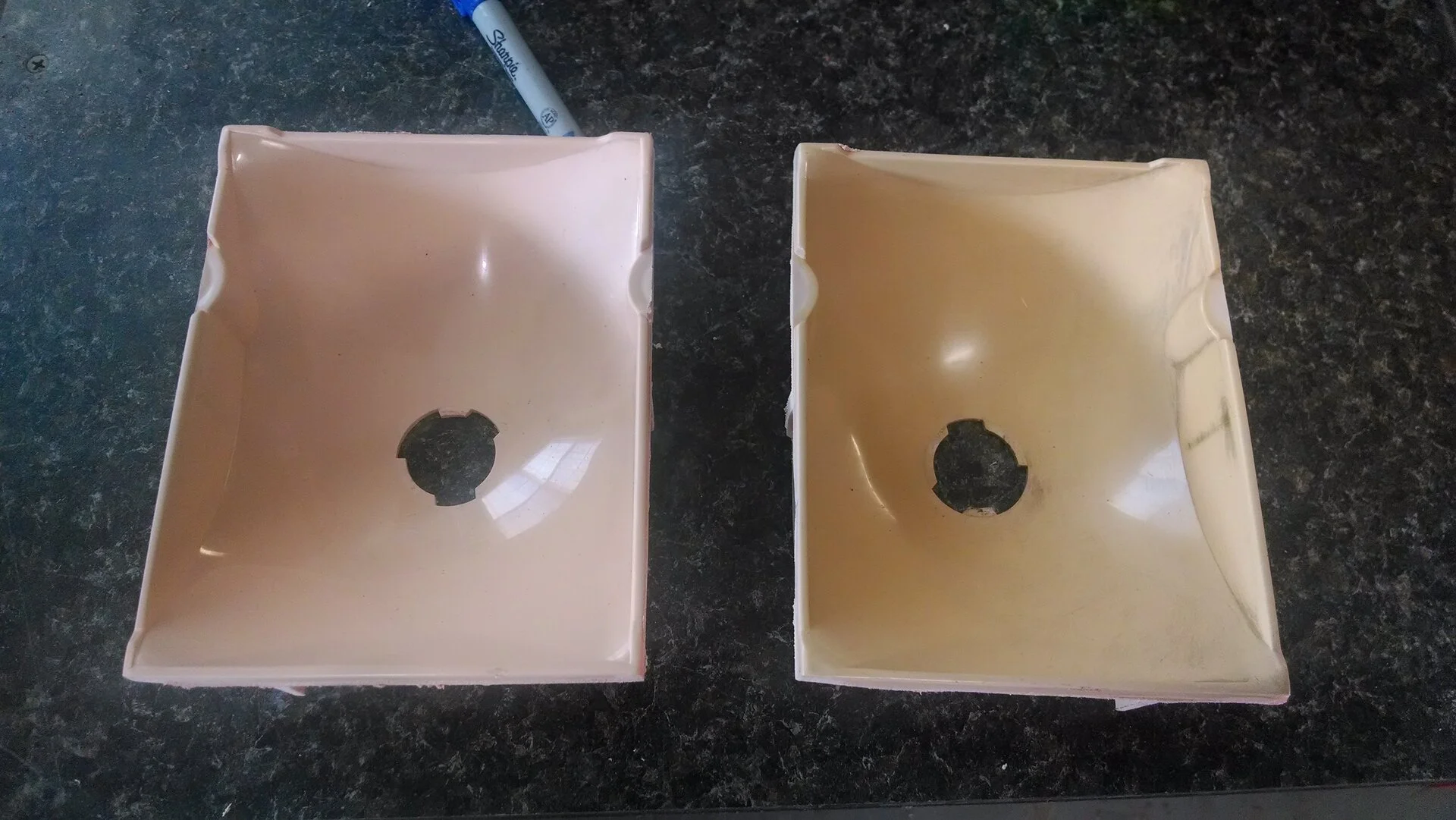

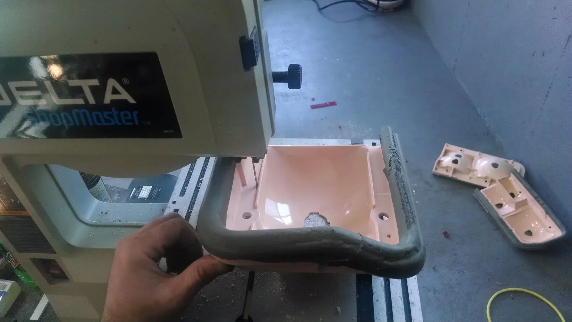

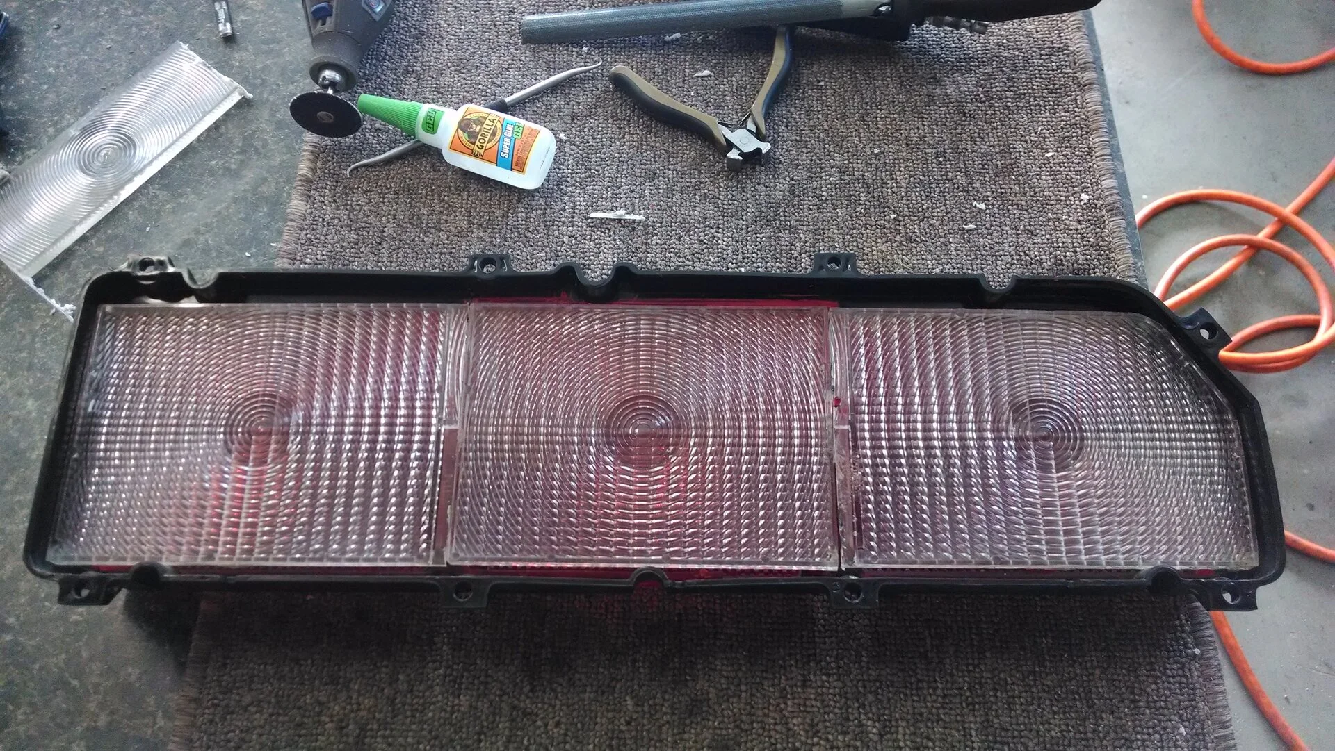

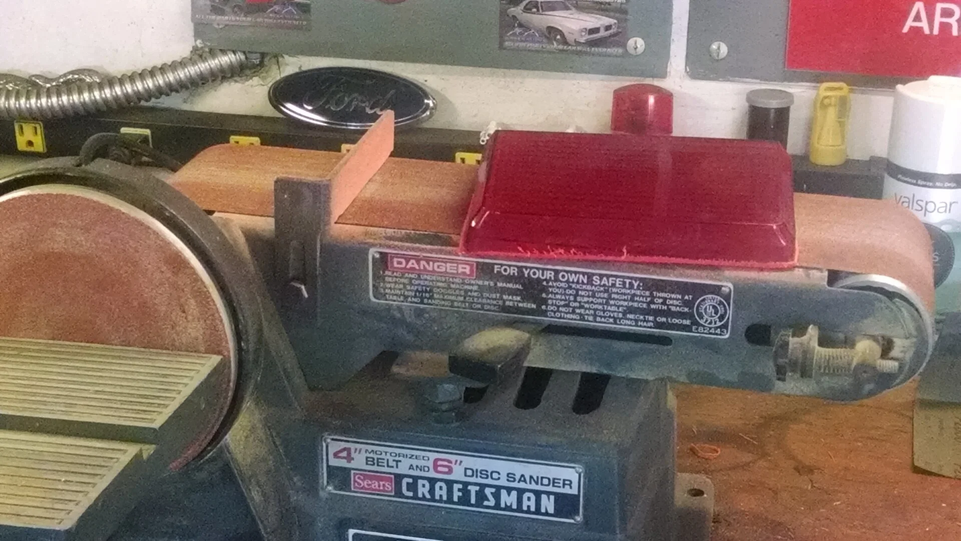

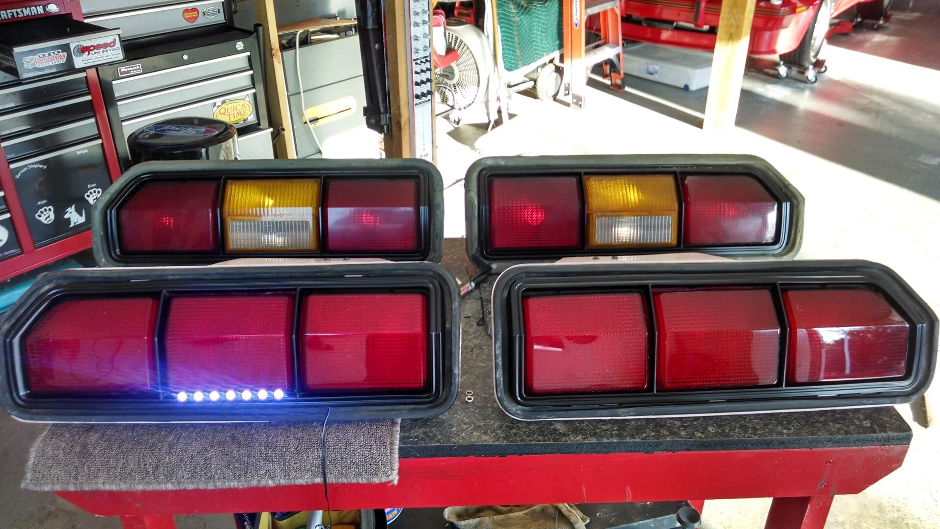

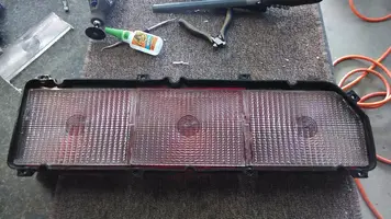

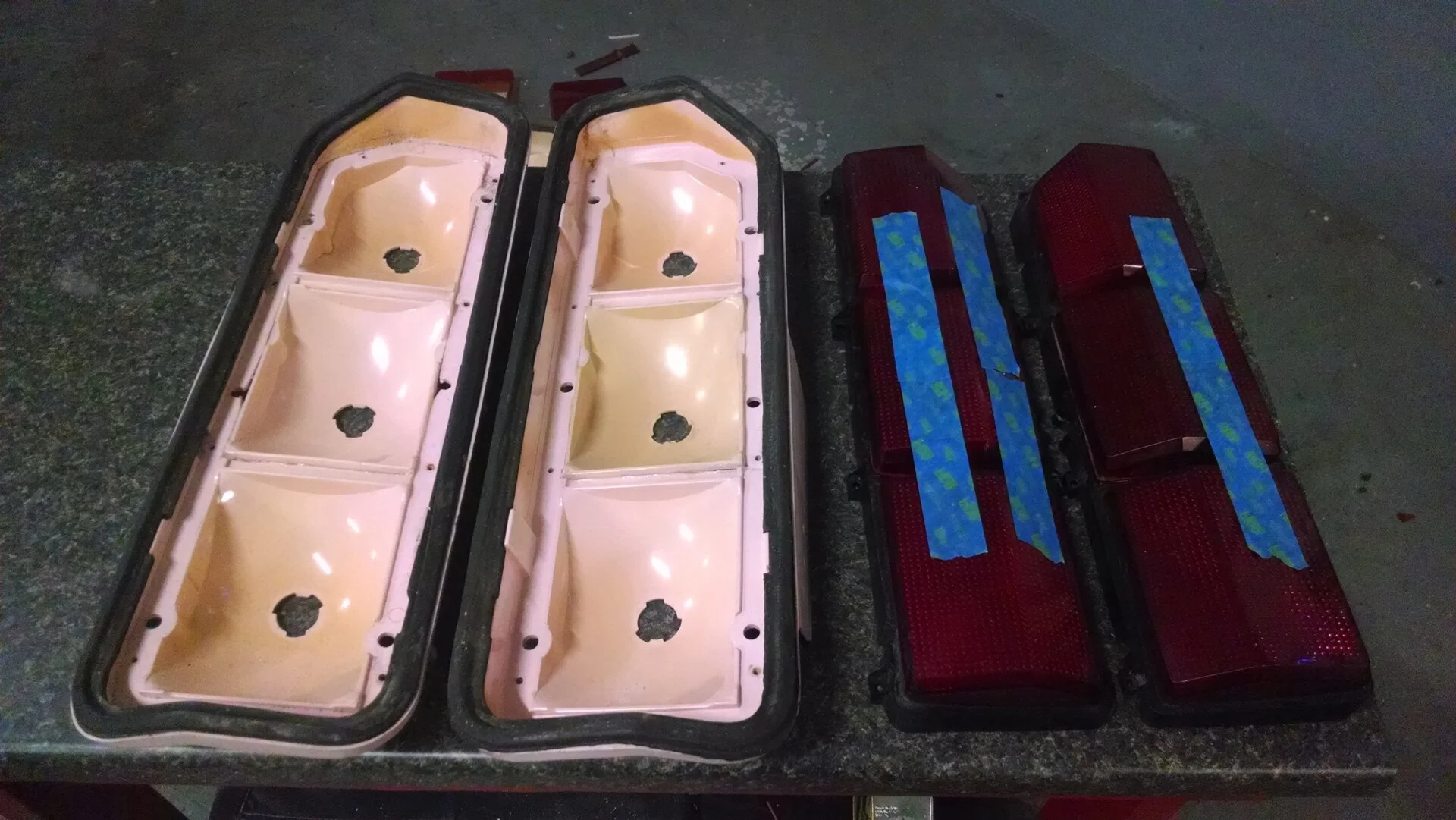

You need a second set of taillights to cut up. I did it on my car, there's some pics in my build thread.
not hard to do, I used a band saw to cut up the donor set and a belt sander to true up the lens.

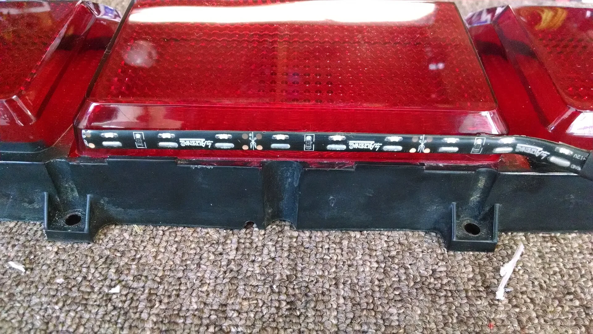

What do you do for back up lights? Do you just see red in the dark? First gen reverse lights are an easy fit on cars with a roll pan, but not here.
I personally just do without for now, with a 2015 GT reverse light planned for the tucked rear bumper when I do that. @StadEMS3 has LED strips for his if you look at his pictures.
