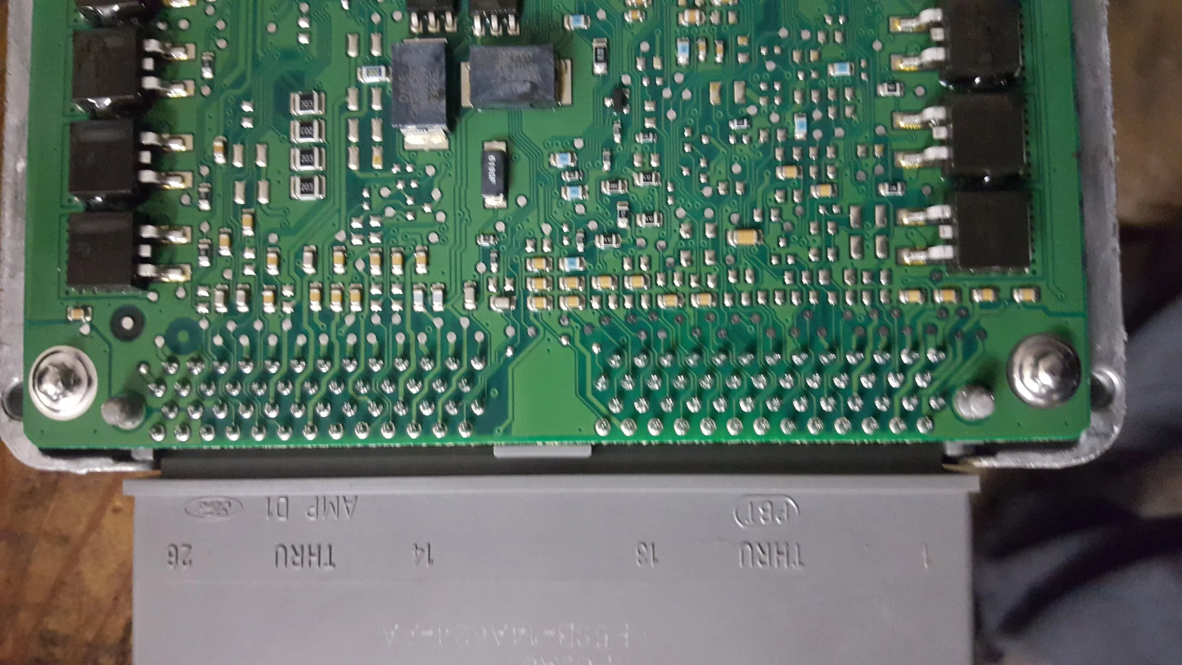

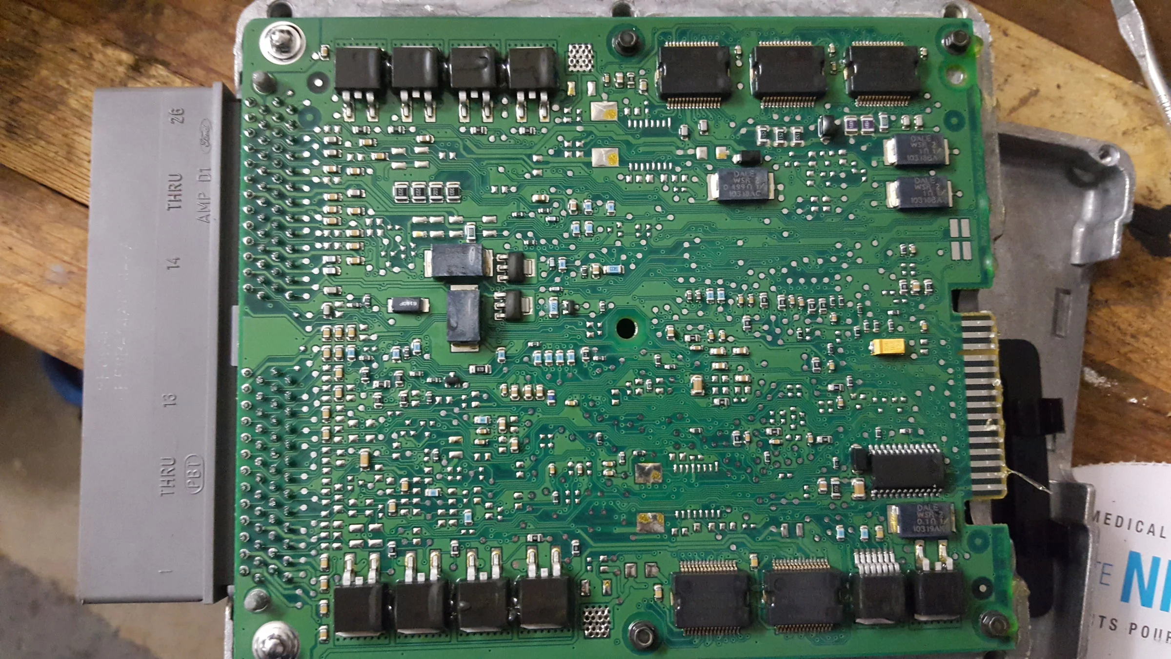

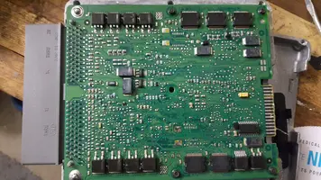

Yeah there is power and good ground I took the PCM out right trying to see if I can find any fried connections can't see to find the pin looking for the 3 pins 36 39 and 88. Do you know which pin is which the ones sticking out ? Also i see 4 souder connection's that are balled up

Okay so I checked the connection between maf connector and PCM connector and I have come to the conclusion that it indeed is the PCM that has short circuited somewhere but now I'm not too sure where to look on the PCM to fix it.
