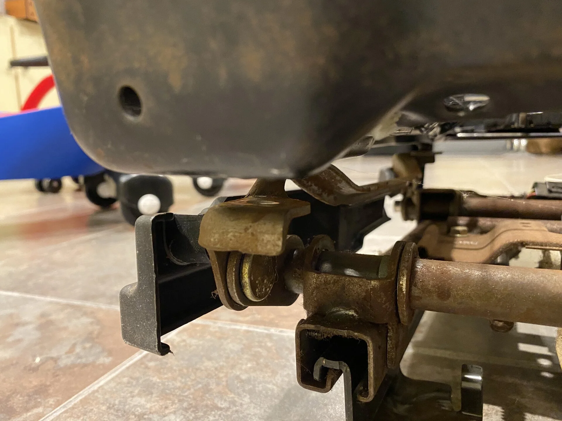

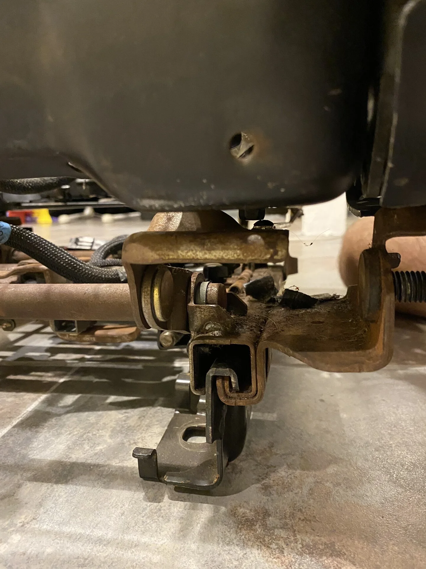

So, looks like a 3/4” spacer out back will get the job done with a 99-04 power track. The front two bolts will work, and then you just need an appropriate size spacer between seat and track and a longer bolt in the rear.
you can see the gap here
Unique view
the 99-04 tracks are 6-way adjustable, the 92-98 tracks are 4-way.
