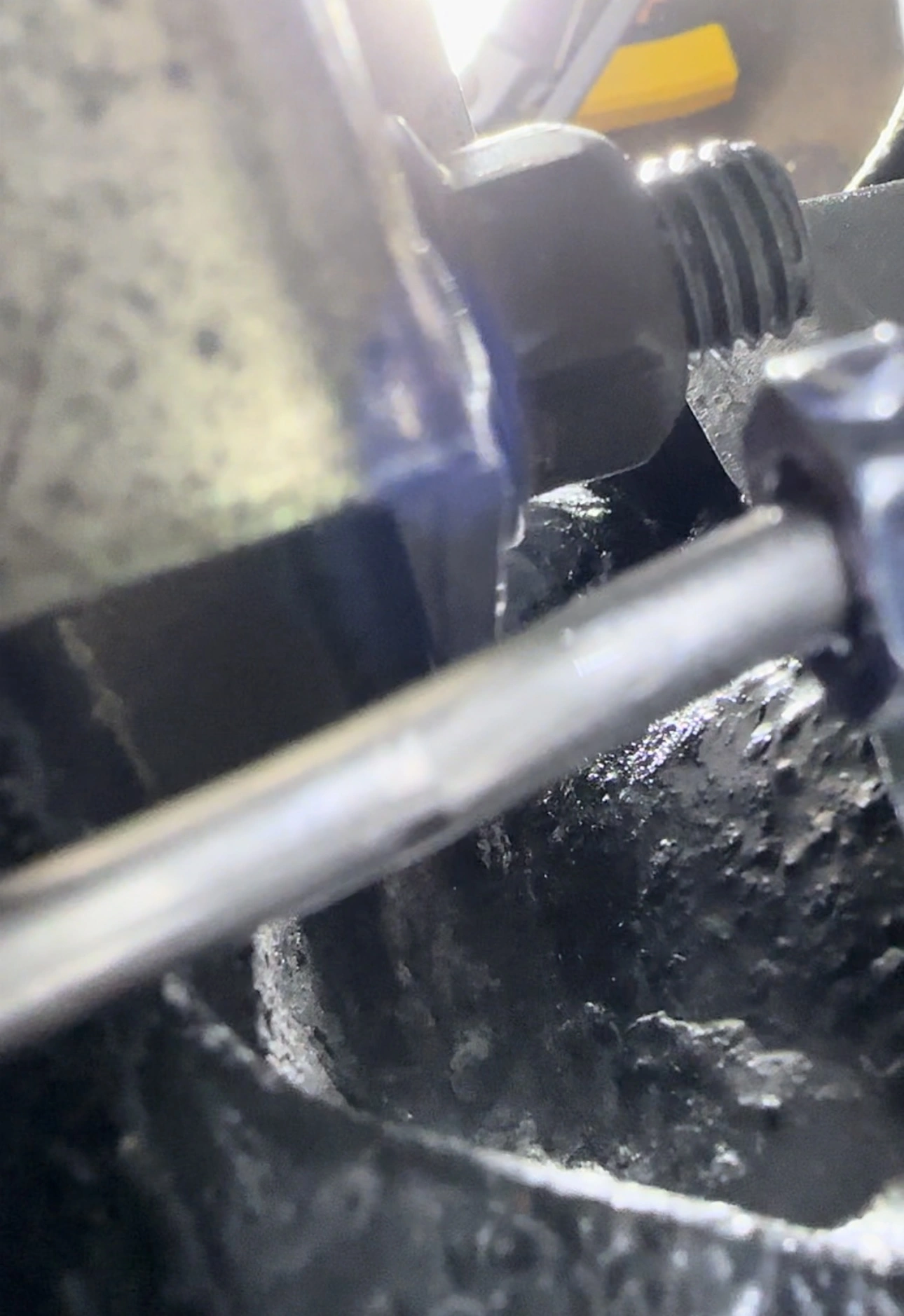

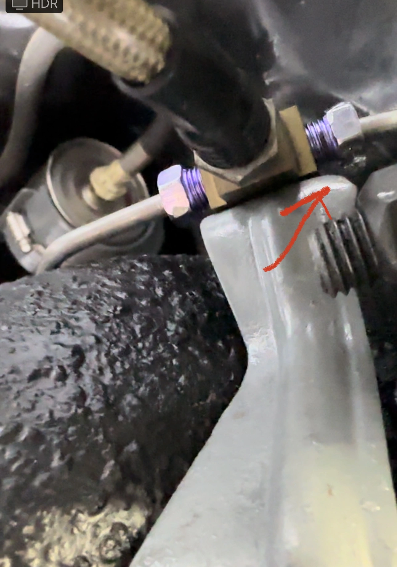

continuing to push forward.
Pulled the bar off and torqued the UCAs. Giant PITA doing that on jackstands. The PHB chassis mount didn’t make it any easier being right in the way. Think I had 5-10 degrees of swing on the torque wrench max
Bled the brakes. Proceeded to shoot brake fluid out the MC all over the engine bay. Had to grab a bucket and rags and wipe that all down before the brake fluid could eat my paint.
Finished bleeding and threw my wheels on. Pass side hit the tailpipe. Fortunately I used the clamps that can be undone. So I loosened the clamp and cheated the pipe over. I’m going to have to play with some offset calculators using these wheels as reference. Haven’t decided yet if I’ll go 18x9 or 18x10. Fit may be the deciding factor
Tested some 5mm spacers. I was still able to get 7-8 turns on the lug nuts, which according to MM is fine, but seeing the threads recessed slightly in the open style lugs is a little concerning.
Was all set to wrap up and found a big brake fluid leak on the differential.
Was pouring a lot of fluid to the ground. I tried tightening it a bit but same thing. Pedal sinks to the floor and lots of fluid comes out.
Took video all around and looks like the line is not seated properly.
Threw in the towel and called it a night. Gonna have to remove that line and inspect. Hopefully I didn’t damage it by tightening it cocked slightly. Doesn’t make sense because I assembled this with the axle off the car and hand threaded those all.
All that’s left to do is fix this brake line and install the driveshaft bolts. I ordered new ones. For some reason I line all my driveline bolts to be all new and not reused. Flywheel, clutch, driveshaft. Always new. Just my thing.
Damn! It’s always something, but I’m sure you’ll get it!
That line you’re pointing at does seem to have a lot of threads still exposed on that fitting. Maybe it just hasn’t seated all the way yet?

I agree. I bet I pinched the flare and didn’t seat it properly. Going to take the line off and inspect. Hopefully it’s not damaged. I wonder if I can use my flare tool to reshape it.

Pretty darn big leak. I suspect there’s a crack under the flare. This line is fully seated and I’m unable to rotate it, yet that’s a lot of fluid coming out.
I removed, inspected and reinstalled the line 3 times, and same gushing leak.
Off to contact LMR

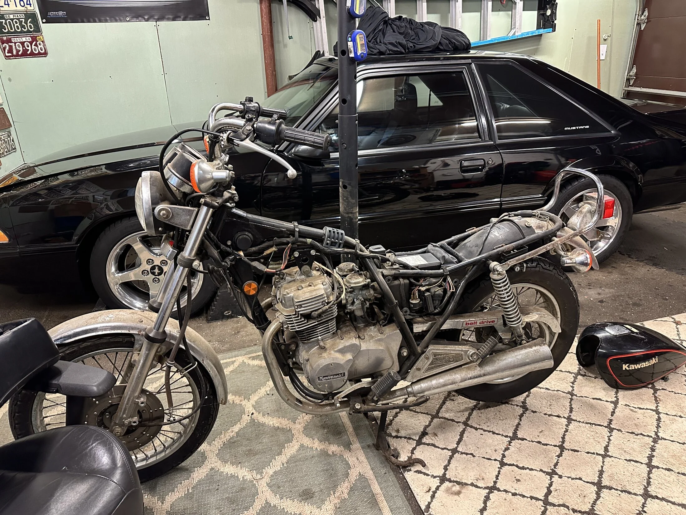

there is a you tuber called Brick house builds and he has accumulated alot of old bike parts stock... Might try contacting him

Looks like a cool project for sure…… but what is your end game with the bike? I’m sure it won’t be cheap to get it where you want it.
I think right now, the goal is just to be able to call my dad up, have him come over and hand him the key and let him fire it up and take it around the neighborhood. It’s his bike and he hasn’t heard it run since the mid 80s.
After that, I think just elbow grease polishing is all I’ll do. I don’t want to put a whole lot of money into this beyond getting it running. You guys know how crazy I can get, but last thing I want to do is put $1k into cleaning up a $500 bike. I think I can get it up and running for $100. I’m fine with that.
