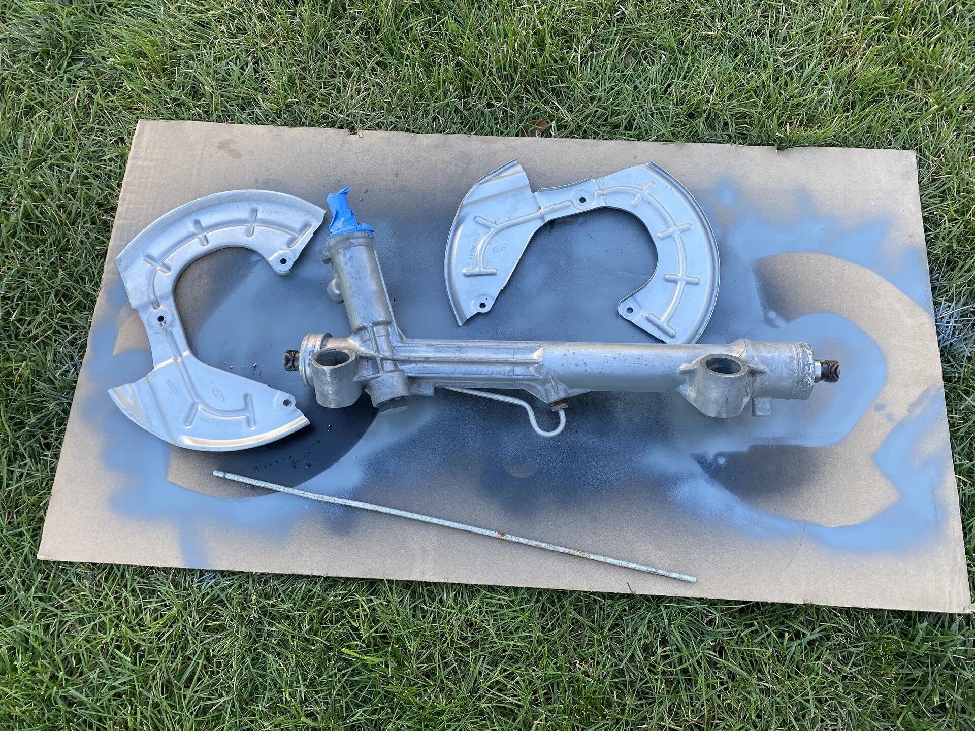

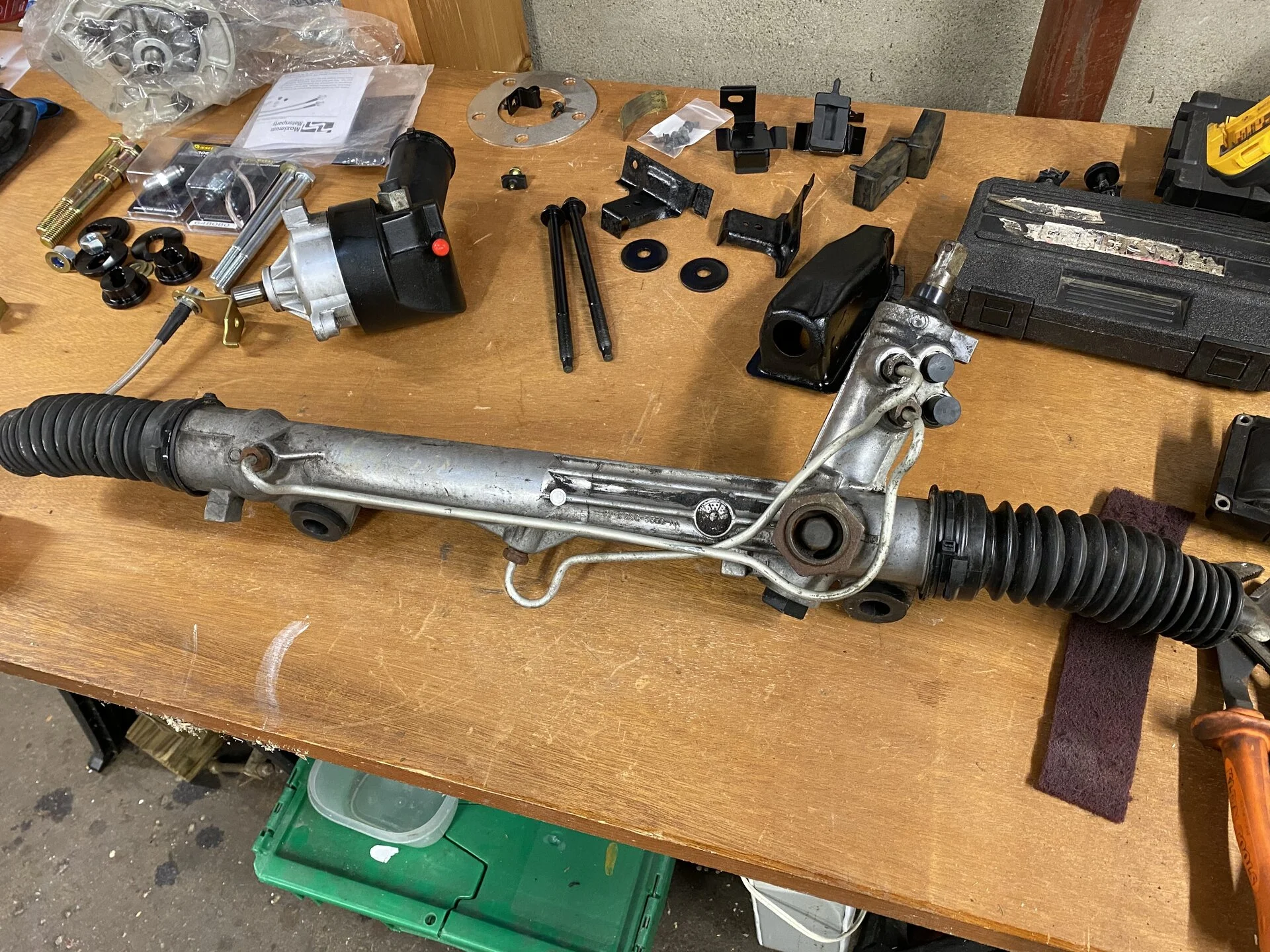

it’s an 04 GT rack. According to a new revelation from Jack Hidley over on the corral, all 99-04 racks are the same. No more chasing those unobtainable expensive cobra racks.
I’m more pissed about having to move my tie rod inners over and realigning everything.

Might be worthwhile if it was an 00 R rack, but in this case I have an equivalent rack on the shelf. Easier just to swap them

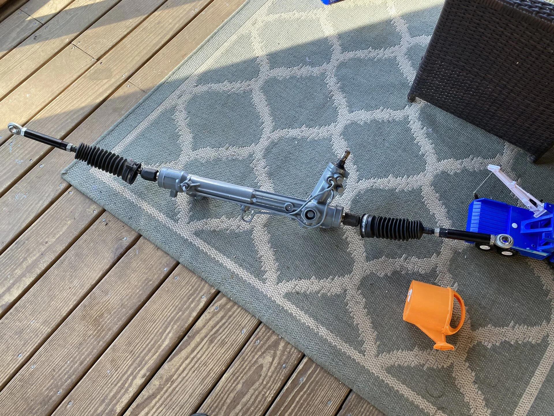

Spare rack cleaned and painted on. Removed the tie tod ends and transferred over. I’ll tighten them once on the car.
onve I receive my new Teflon seals, I’ll install those with the rack off the car, and then install the rack.

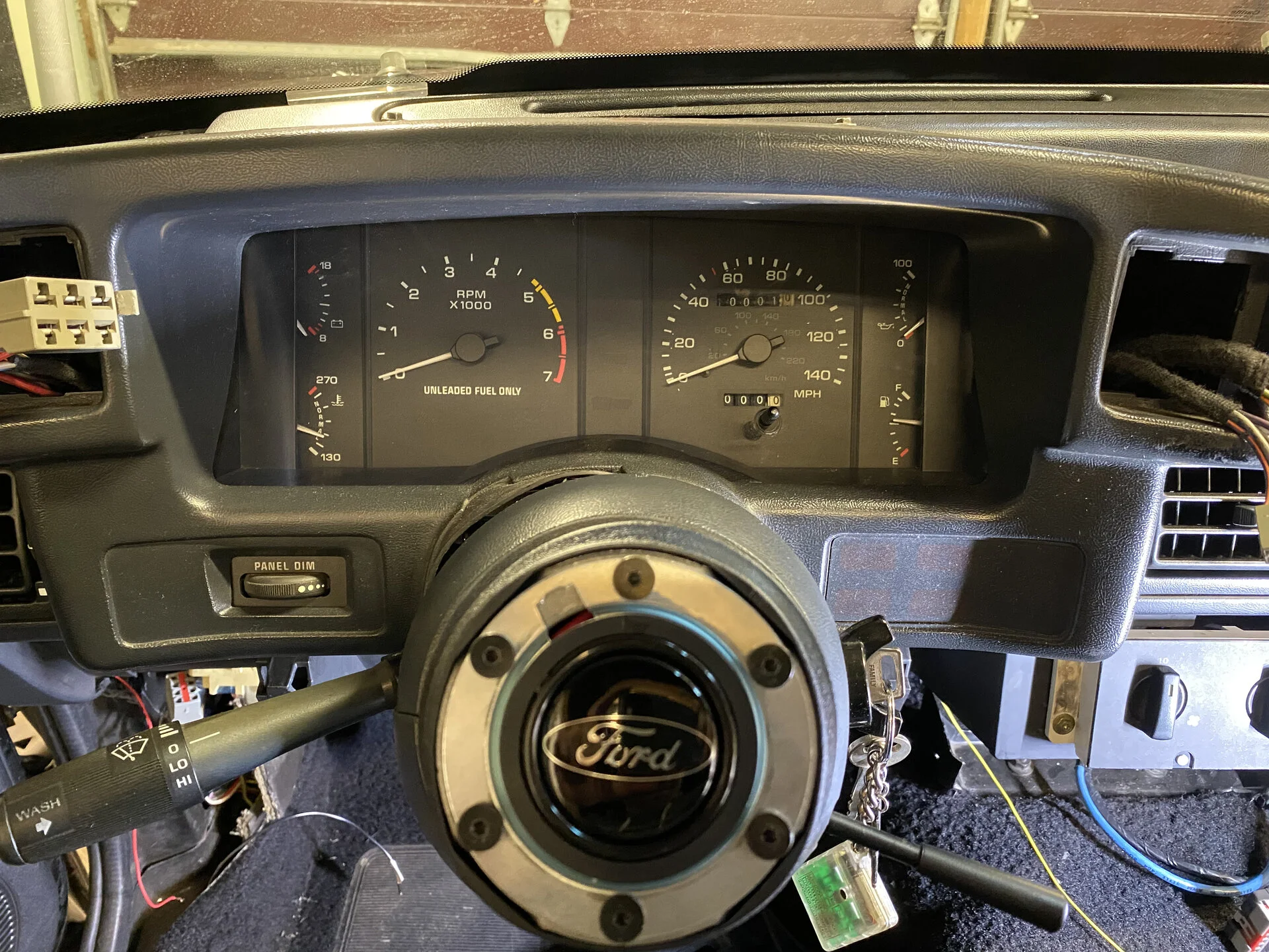

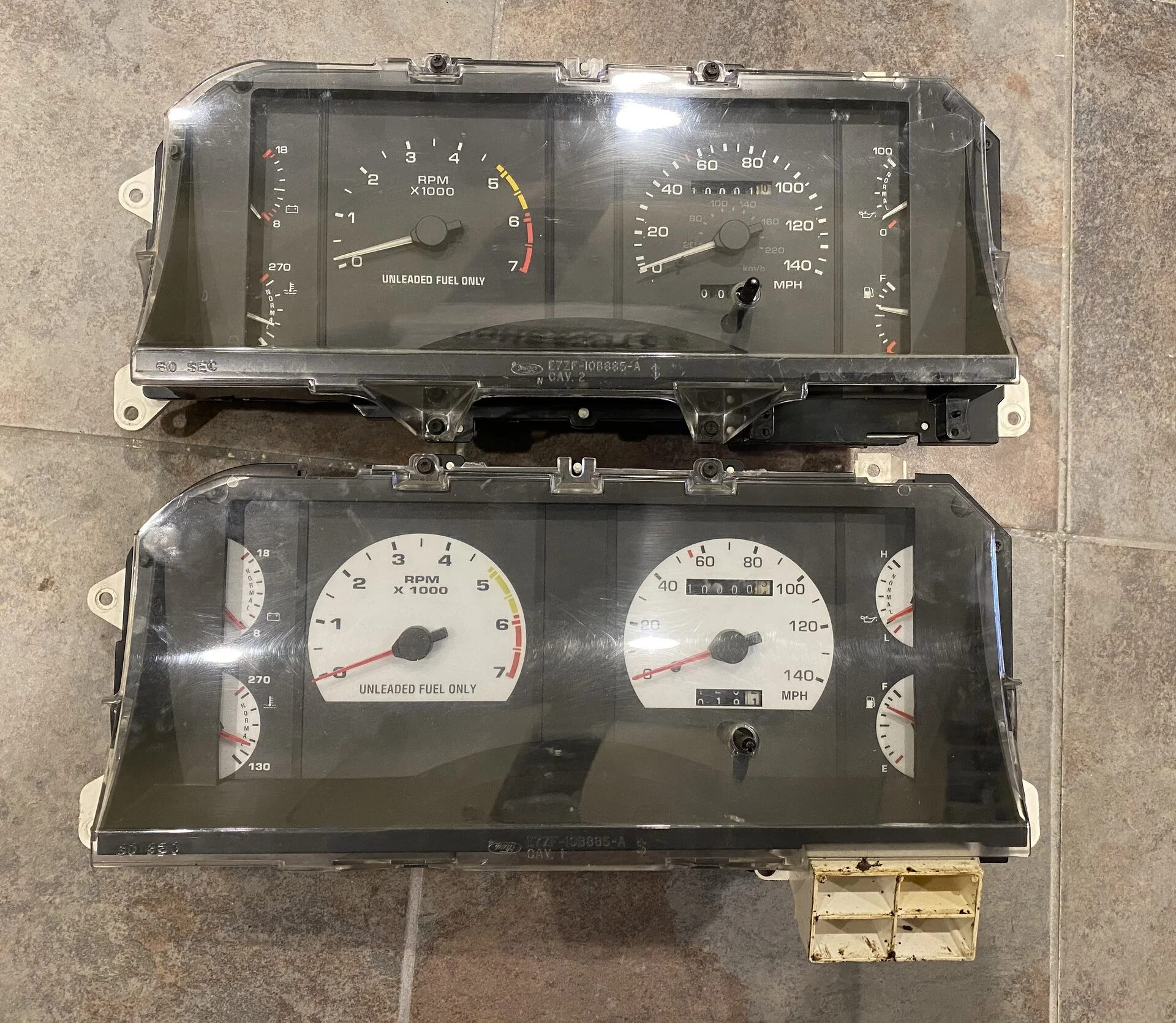

I kinda dig the white face gauges, some have trouble with the back lighting though.
these do have trouble. It gets annoying because I like to drive with the parking lights on.
Anyway, I chose black. Put some of the interior together. I took the black ‘89 cluster apart and matched up the mileage. I moved my LEDs over as well. No idea how well this cluster works, but I have two of them so I’m sure I can get one working well. I won’t tighten up the cluster surround for now.
looks so odd to get in my car and look at oem faces. I did those white faces around 2000-2001 or so.

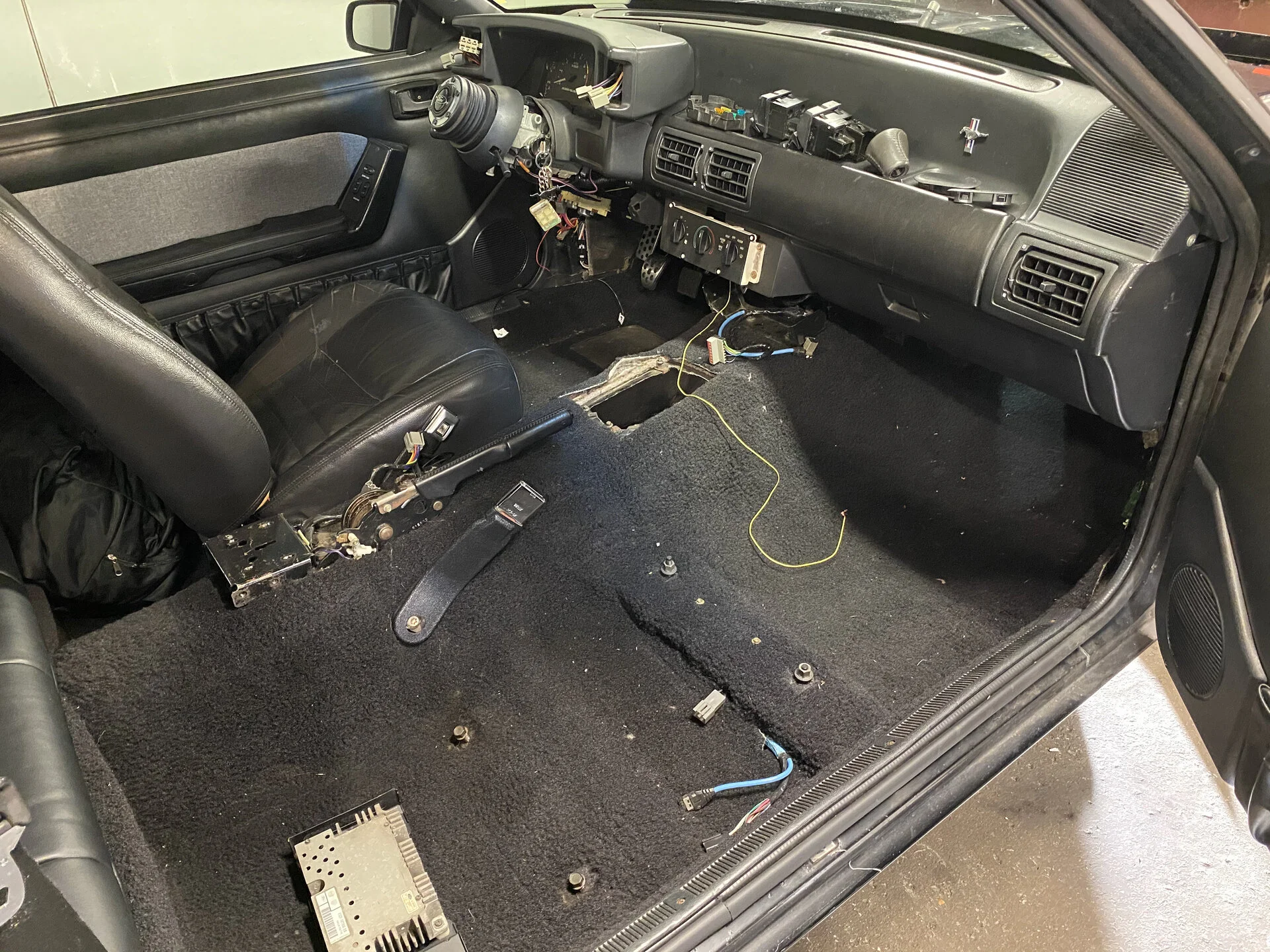

Didn’t put the console in. I’m likely going to pull the carpet anyway for the subframes and some sound deadener
I’ll squirrel this away somewhere safe

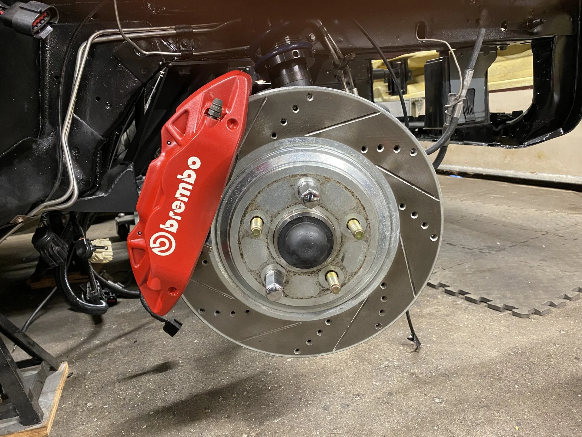

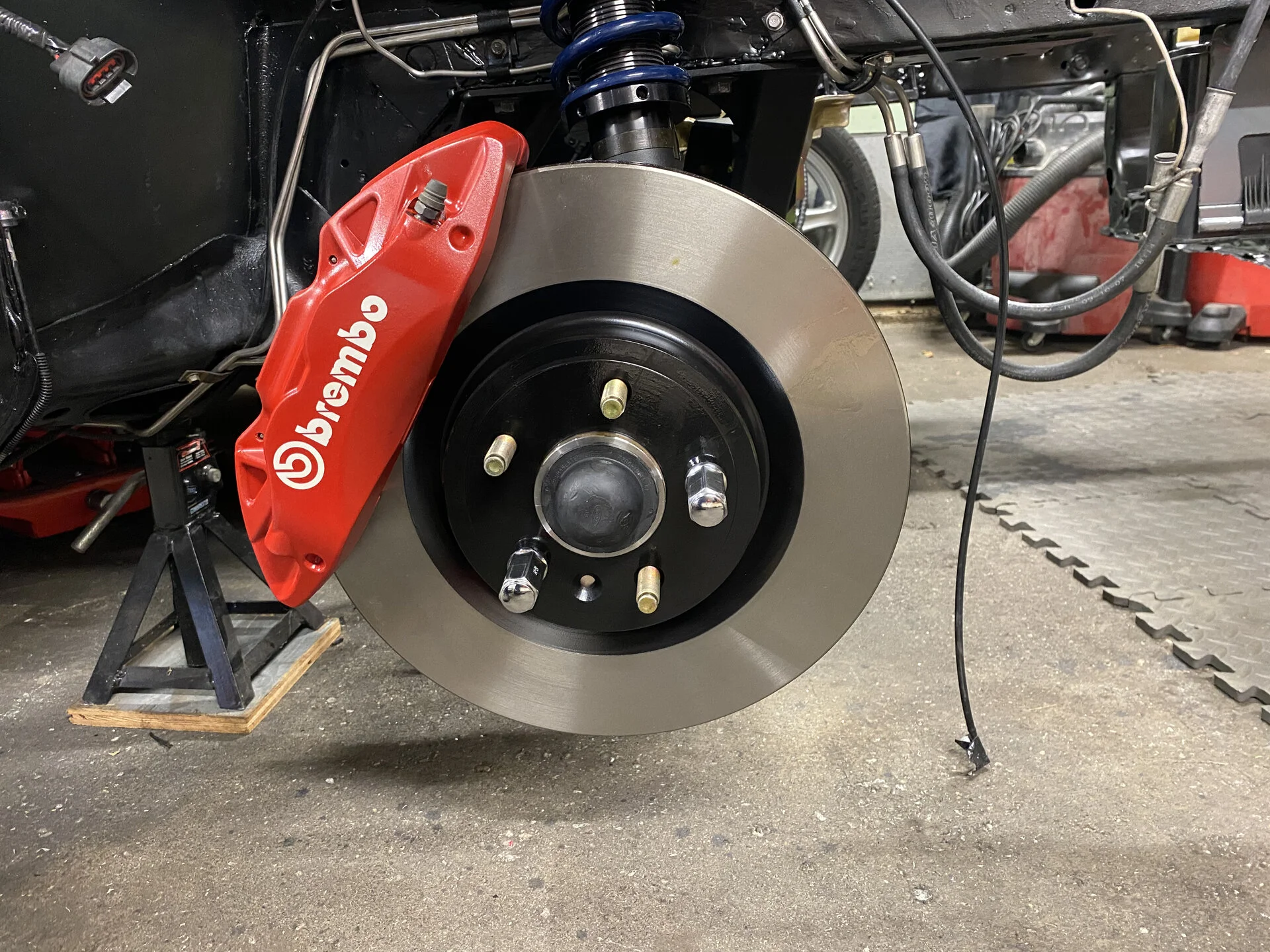

I also messed around with a ‘11-‘14 rotor to see if it fit better with the ATS brembos. It didn’t. The cobra rotor still fits the best. I have sboit 1mm of pad overhand, so I’ll likely just remove that material somehow
‘11-14 GT
vs Cobra
I like the originals better too. Cars coming along Mike. Cant wait to see what the engine looks like back in the bay.
