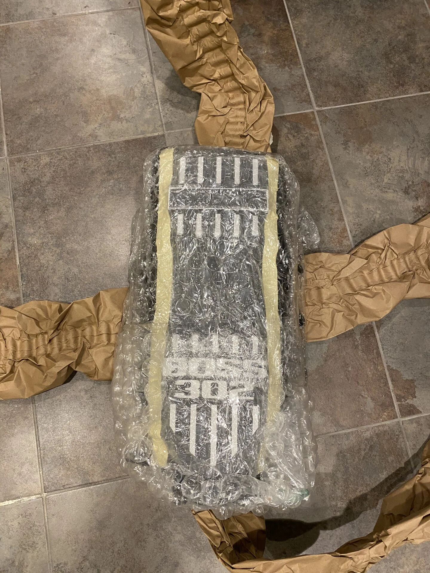

I love this intake on coyote swapped Fox bodies, especially in a black car. I had to get one and squirrel it away. $200!!
2012-2013 Ford Mustang OEM NEW 2012-2013 Ford Mustang Boss 302 Coupe GT Intake Manifold Cr3Z-9424-A CR3Z-9424-A | QuirkParts
OEM NEW 2012-2013 Ford Mustang Boss 302 Coupe GT Intake Manifold Cr3Z-9424-A - cr3z9424a. Genuine Ford® Parts & Accessories. Manufacturer Warranty. From the Dealership to your Door.

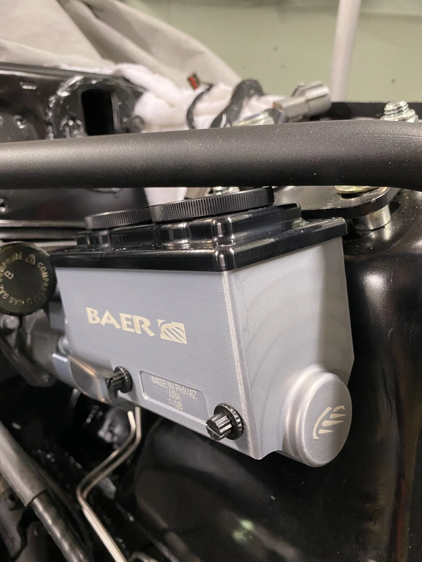

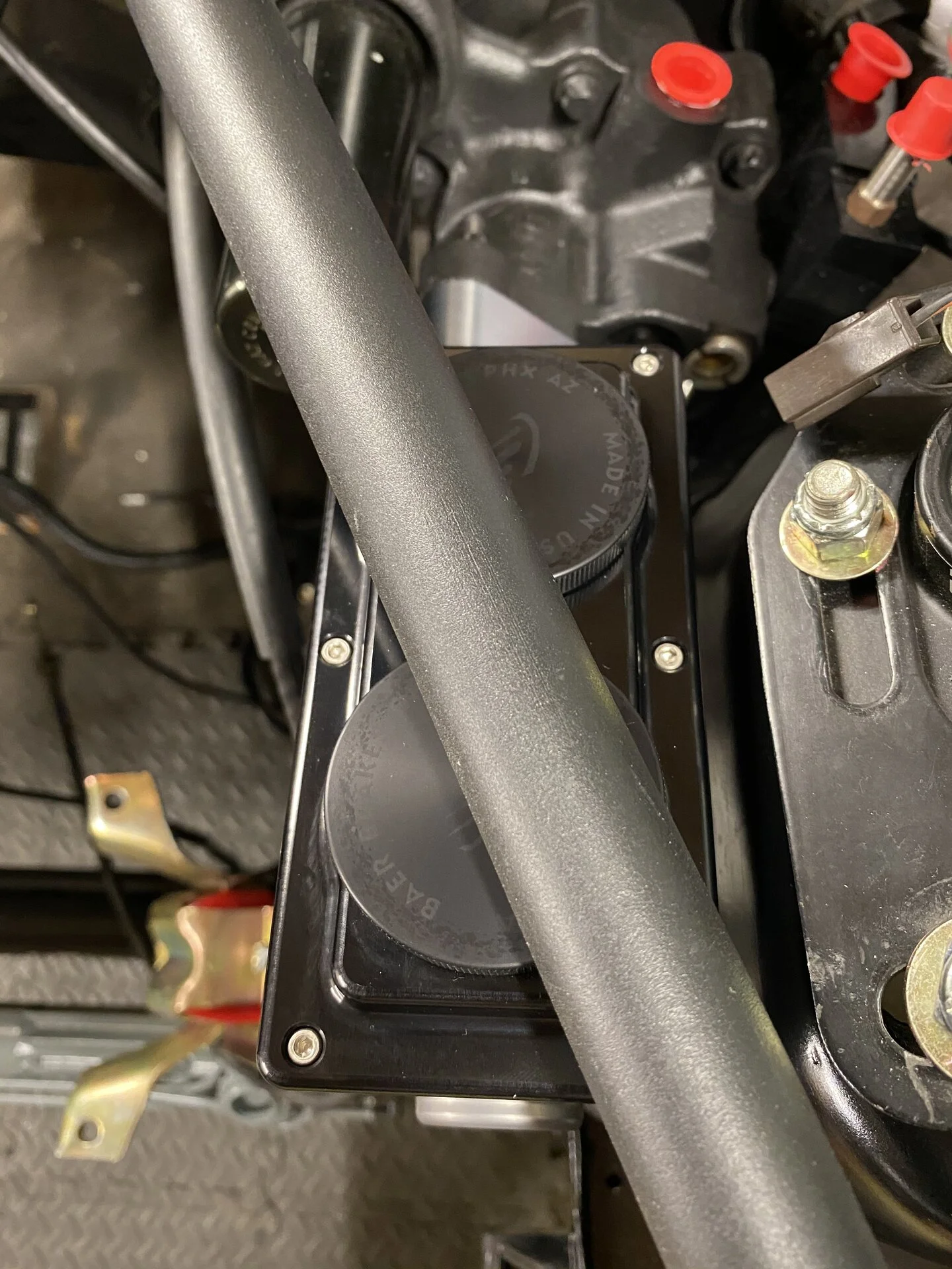

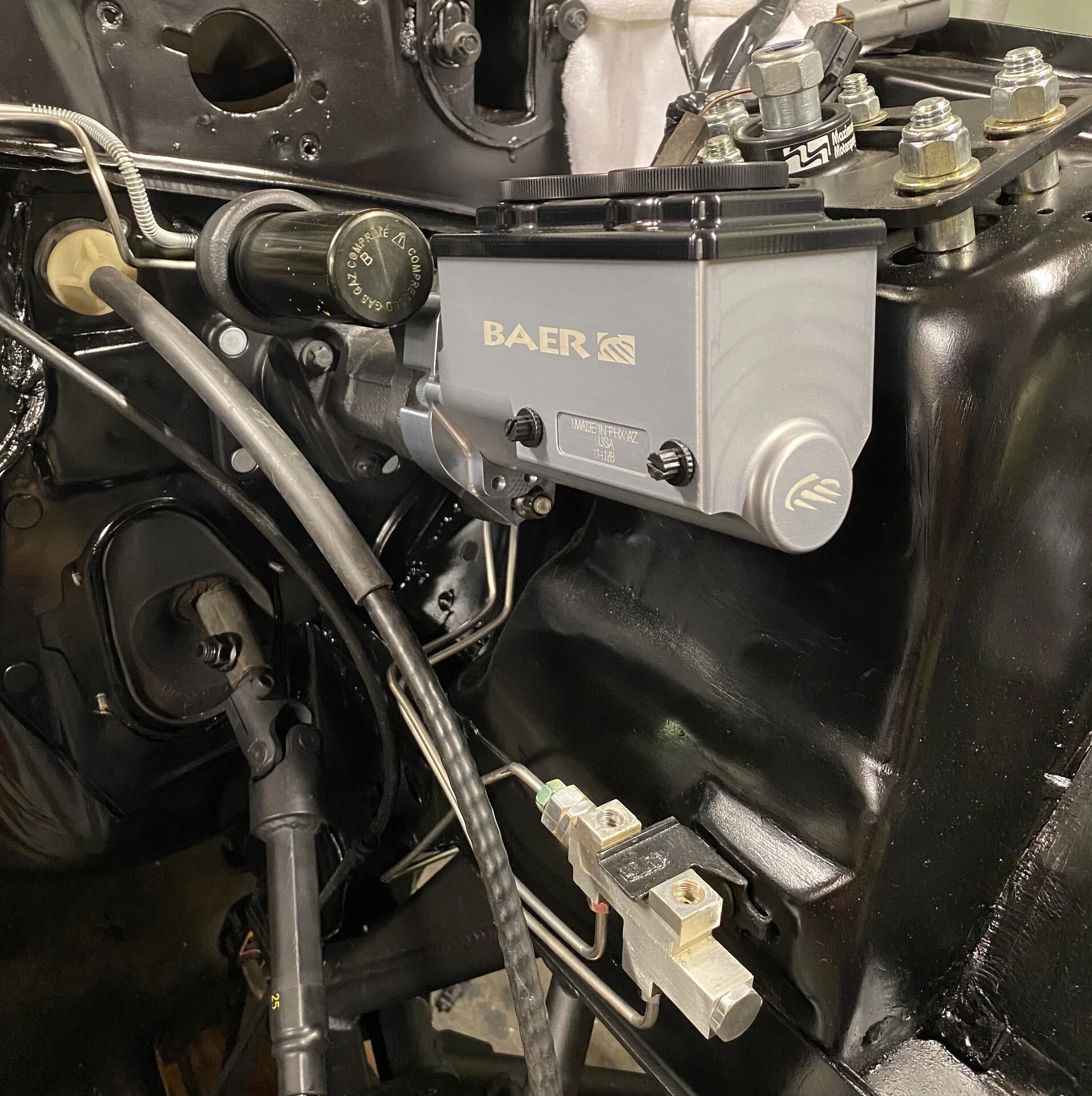

I test fit the strut tower brace. It’s close. Real close. I can work with this though. The oem MC interfered much more.

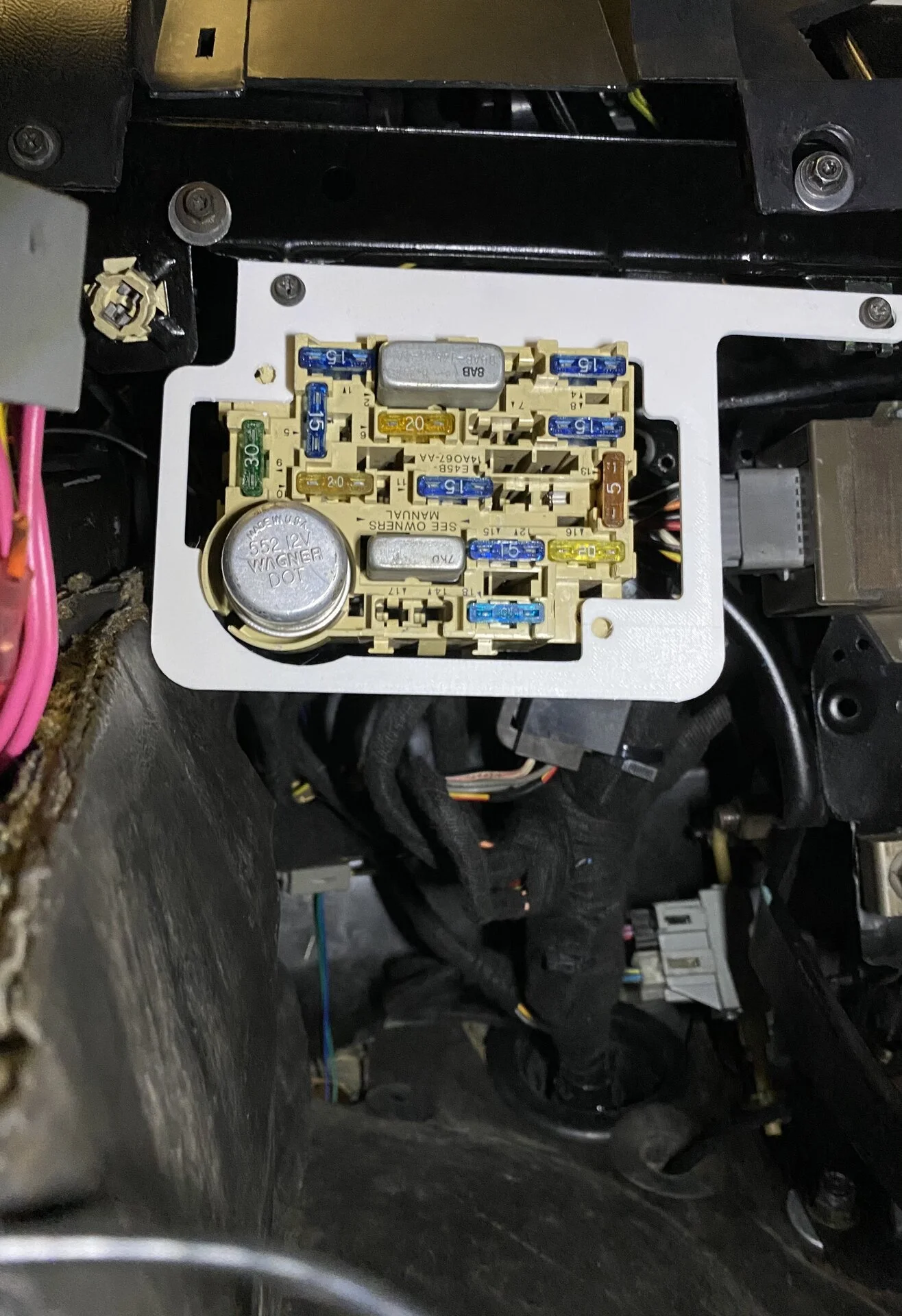

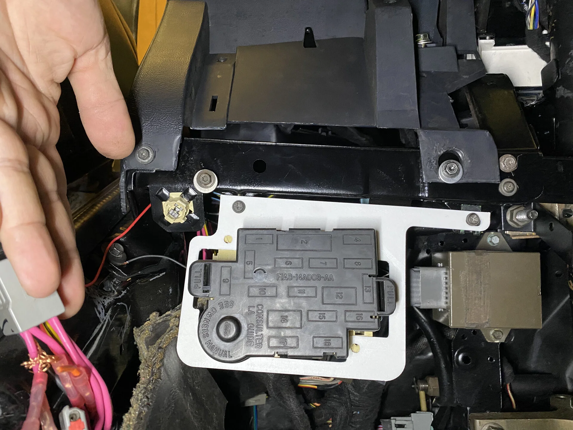

I know I’m jumping around a bit, but a busy night trying to mock up stuff.
I test fit my 3 d printed. prototype fuse block holder. This will work. Now to cut one out of metal.
with the fuse block cover on. The fuse block itself is not screwed into the mount, that’s why it’s crooked

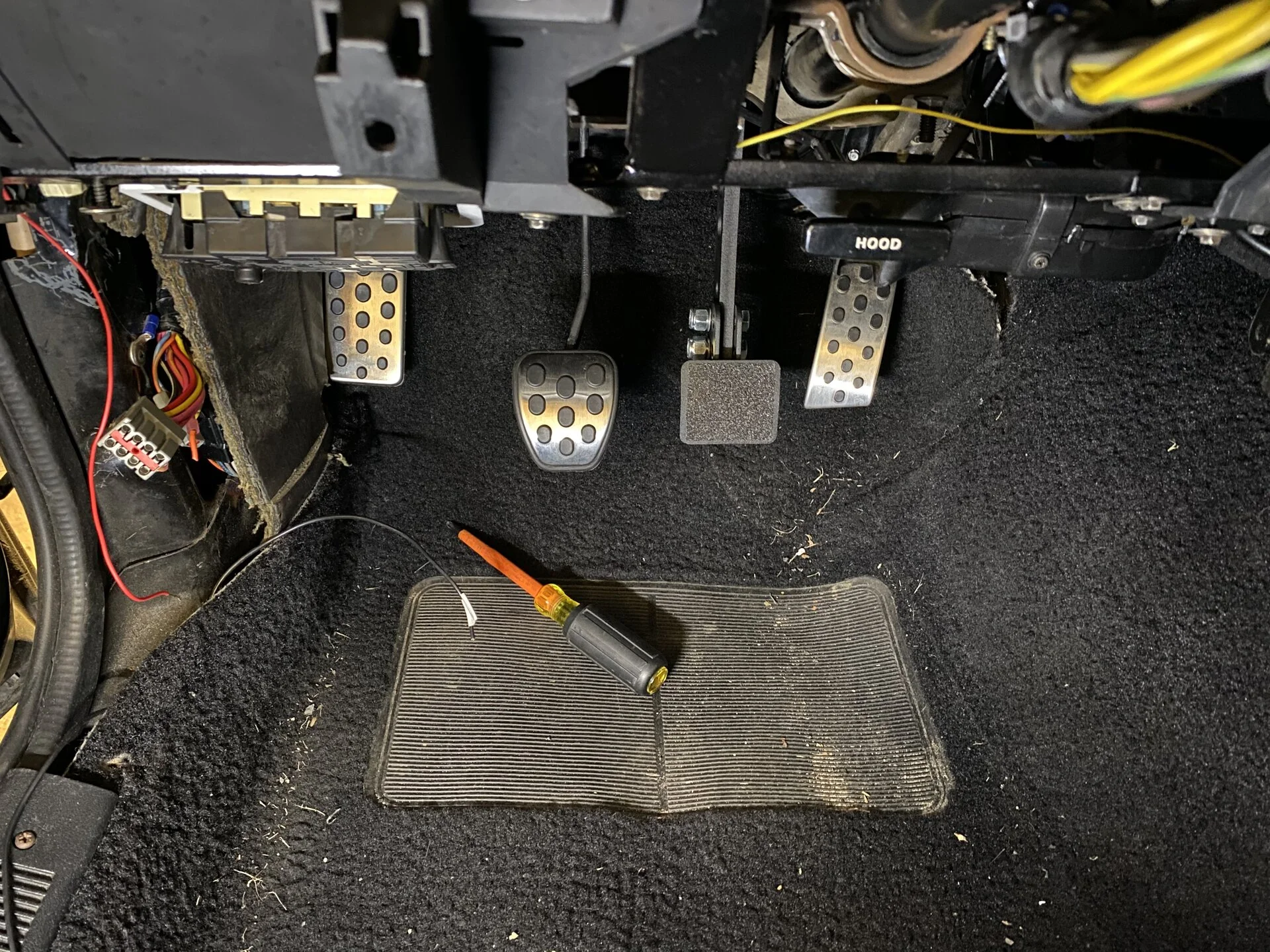

View from the drivers seat. Missing the lower dash panel which will slightly block it

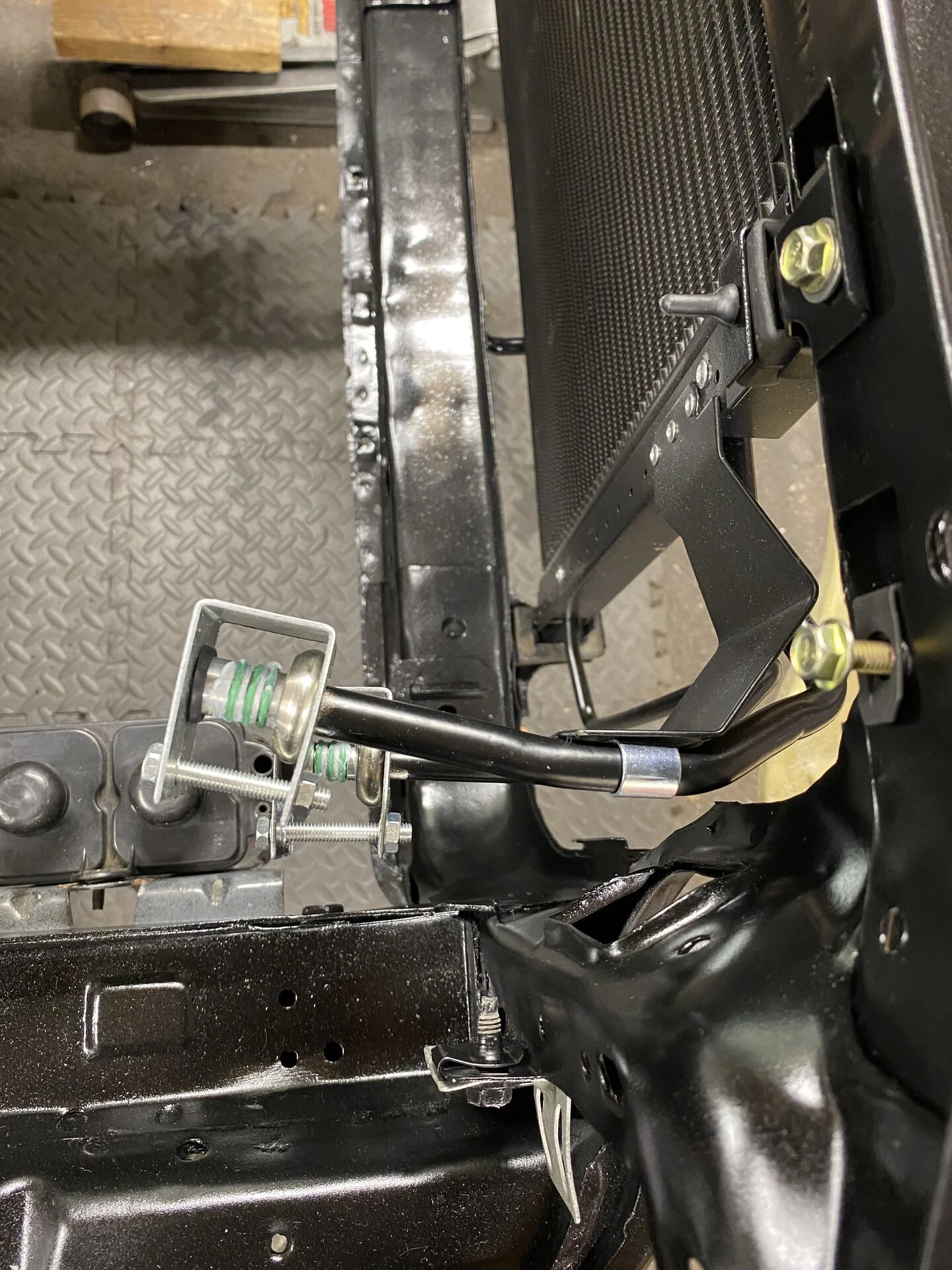

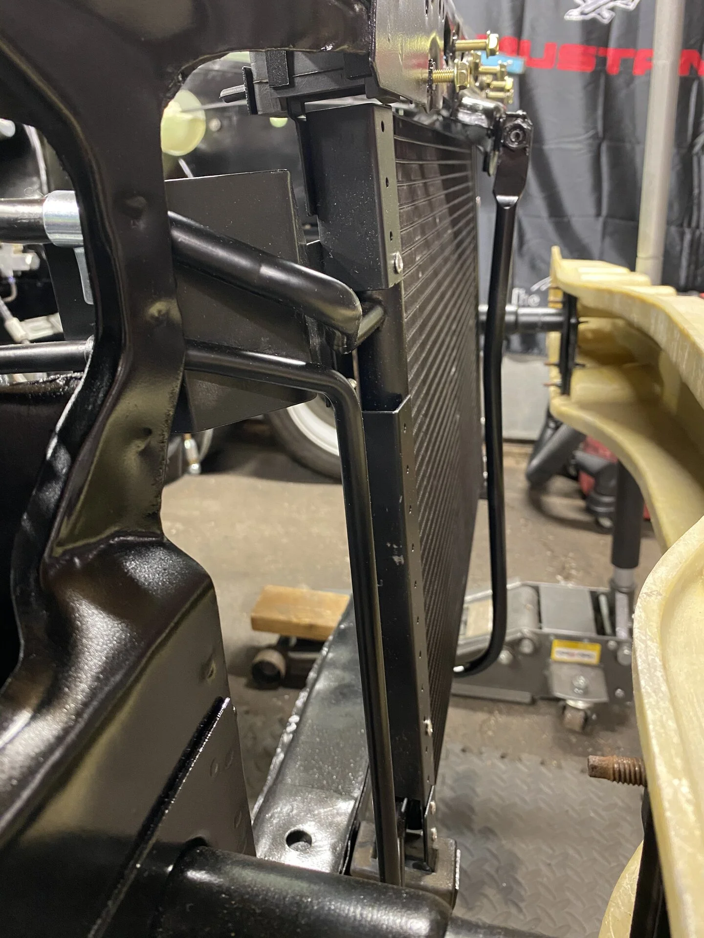

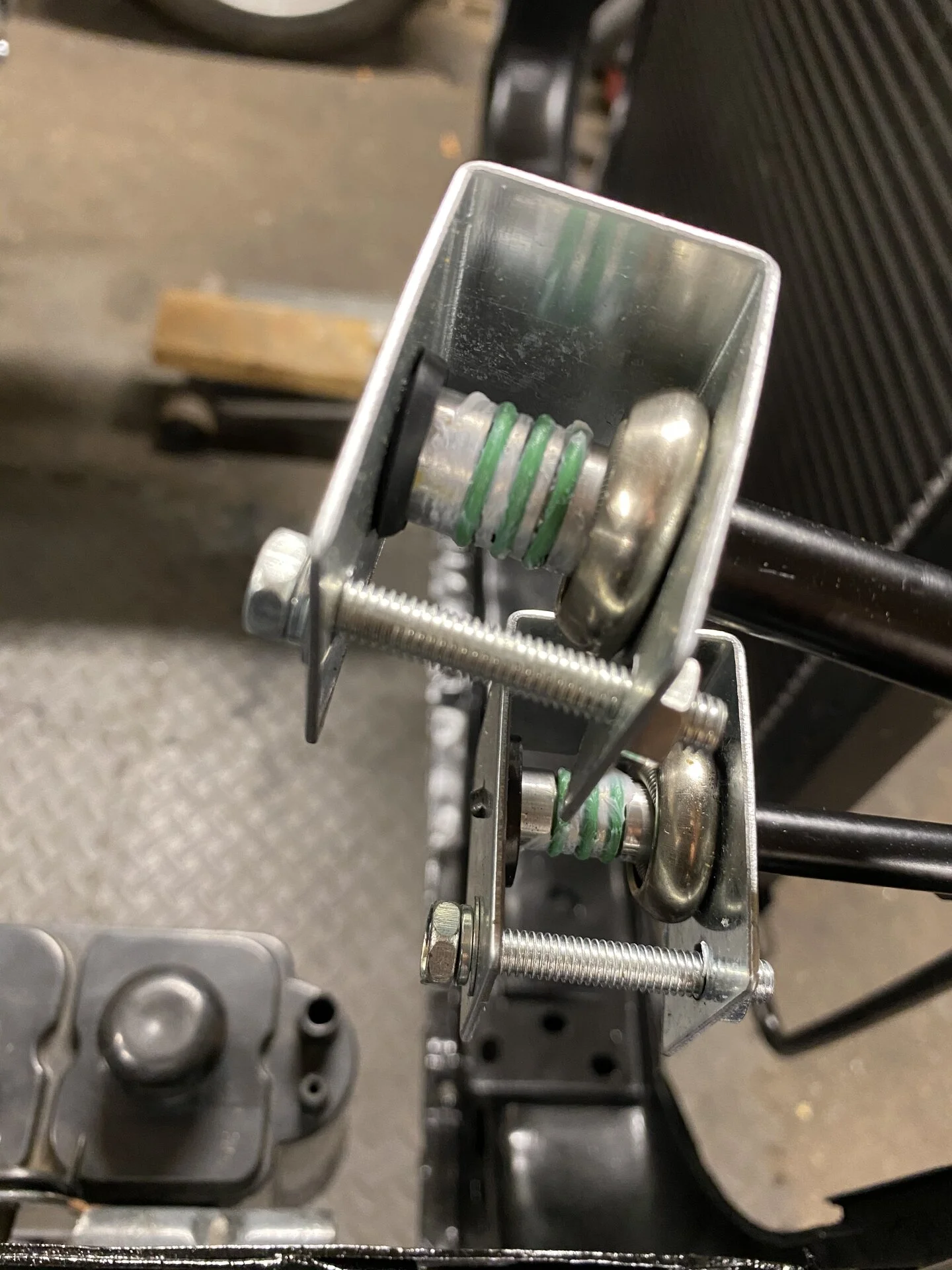

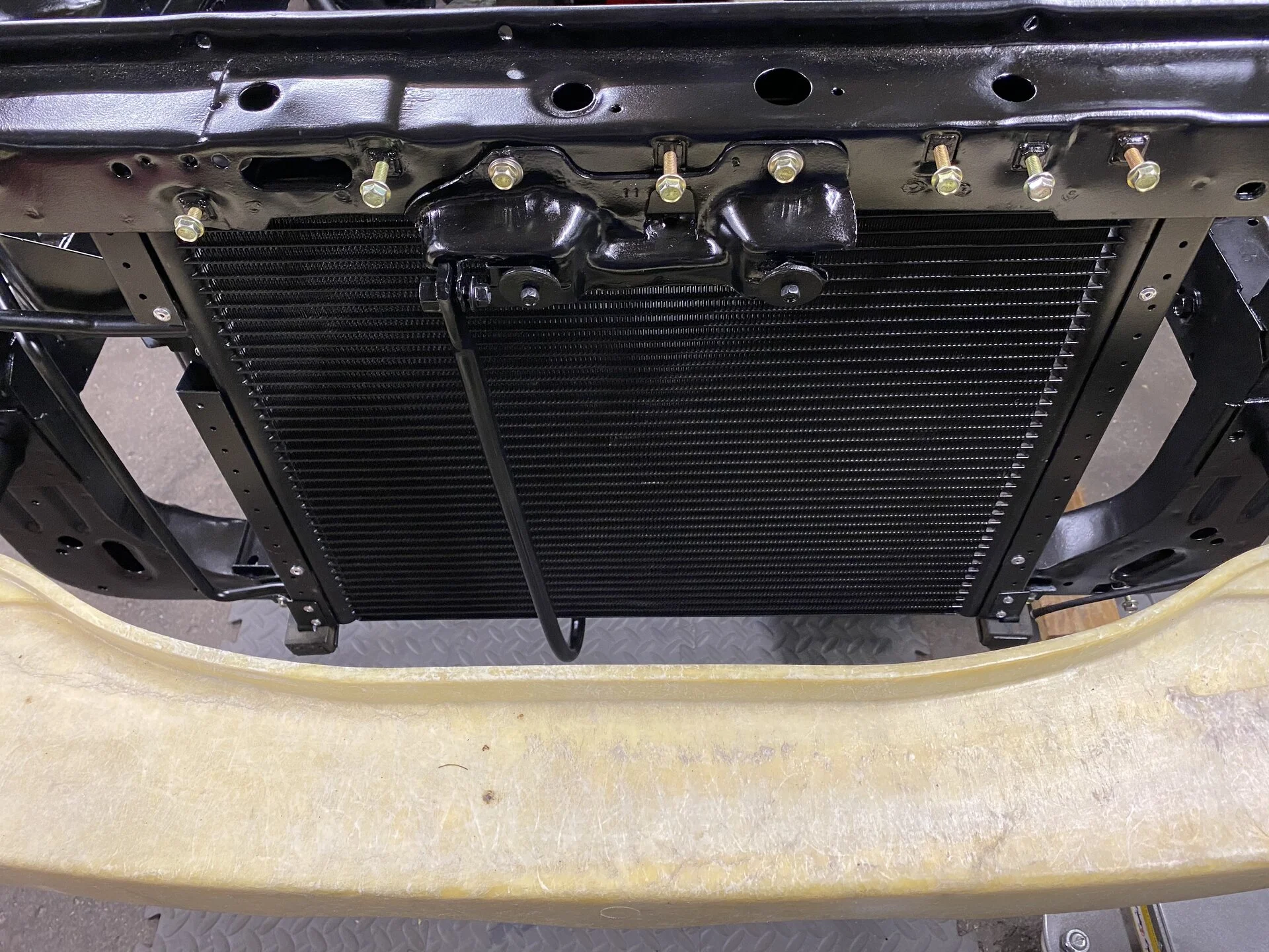

Ac condenser mock up. Happy to report it bolted in without any modifications needed. Even clears the weird hood latch support bar that some cars get, and some don’t
its been a while since I’ve had my hands on a condenser, but is this kink in the line supposed to be there? It looks to be an intentional kink. I’ll have to wait til I can fully mock up to see if I need to bend it back.
also, I never mentioned it but I restored all the condenser brackets with a Evaporust bath, followed by new paint, new speed clips and new 10mm bolts. Nice and new in the below pic.
I do like how they protect the ends.
my 94 cobra finned power steering cooler is in the mail. I want to see if that unit fits, since the 03/04 cobra cooler won’t. Ac condenser will go back in the box once I see potential interference with the cooler.
Condenser part number: spectra premium 7-4453.

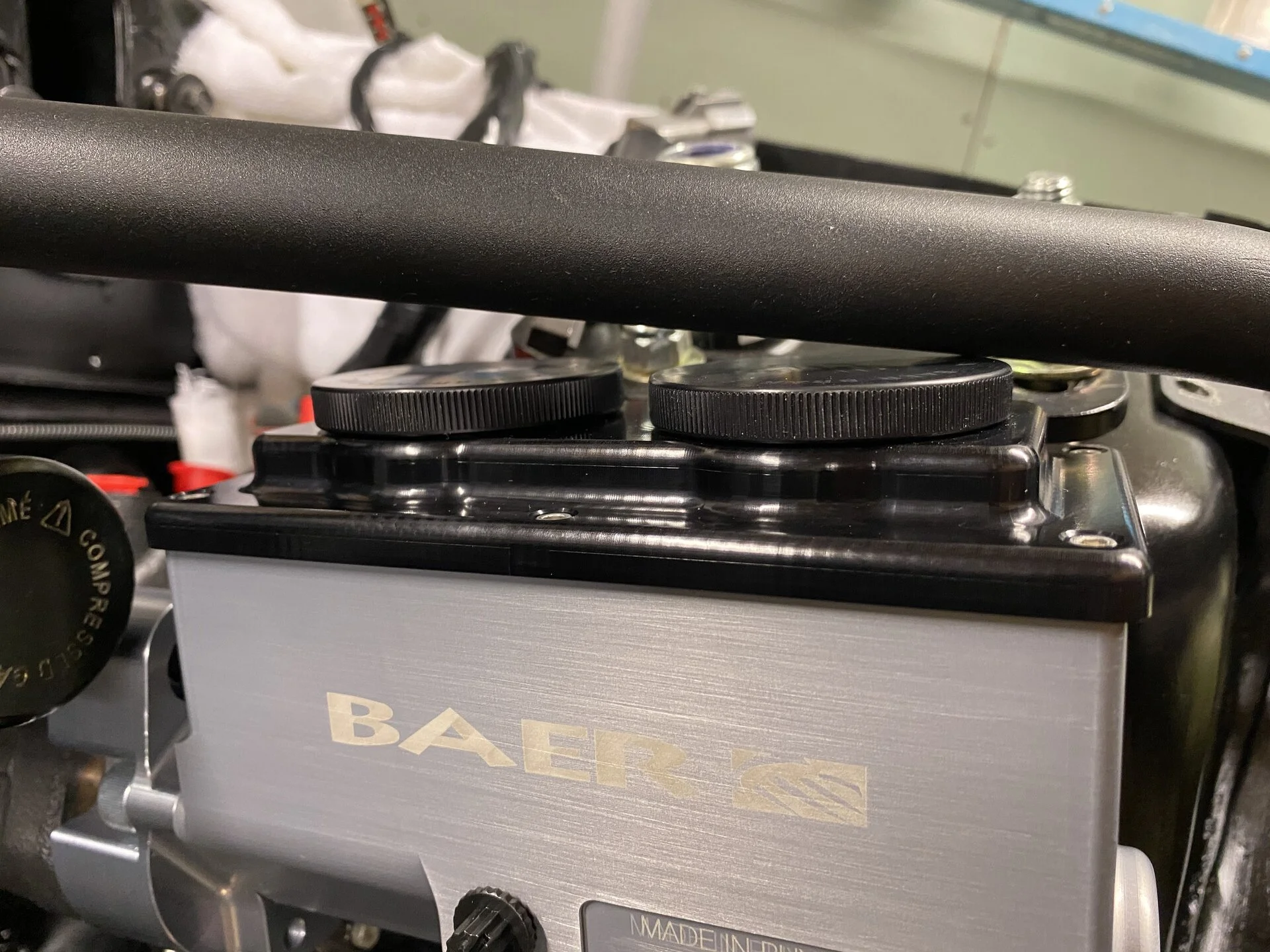

You going to be able to remove the cap to add fluid if needed once the brace is installed?

Back one comes off fine. Front one....I’ll need to modify the brace a tad
