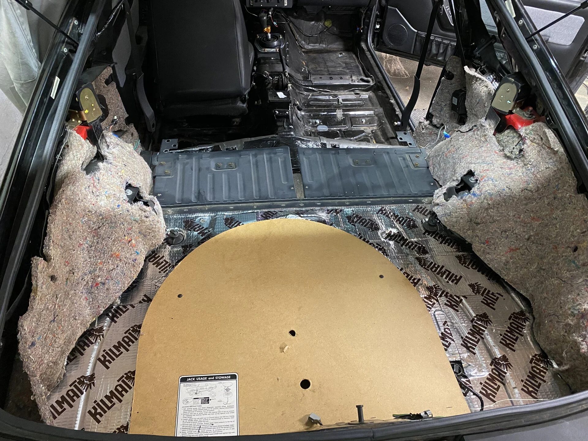

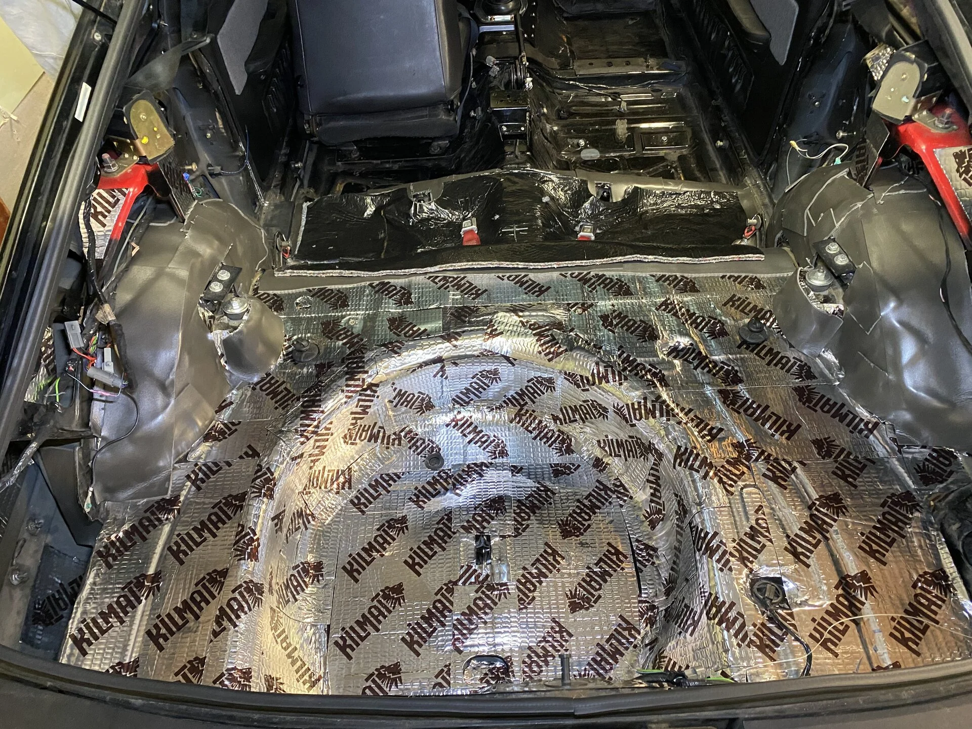

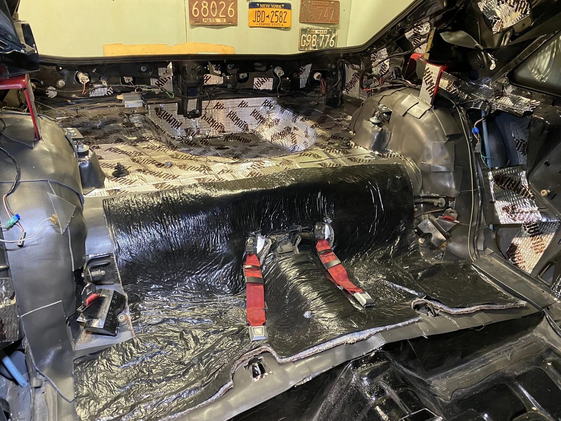

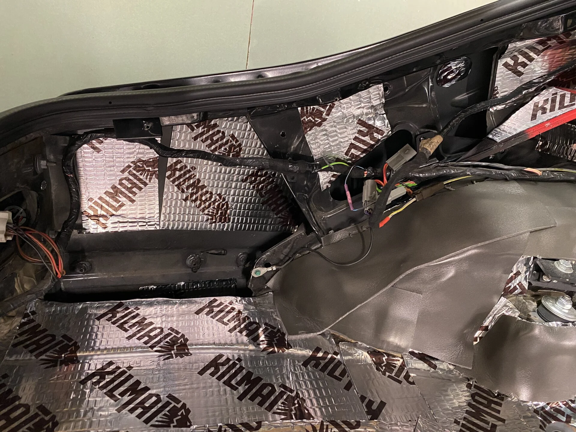

All done in the rear
Kilmat everywhere and foam on the arches and under the seat area. Even stuck foam in the quarter panel “pocket” area

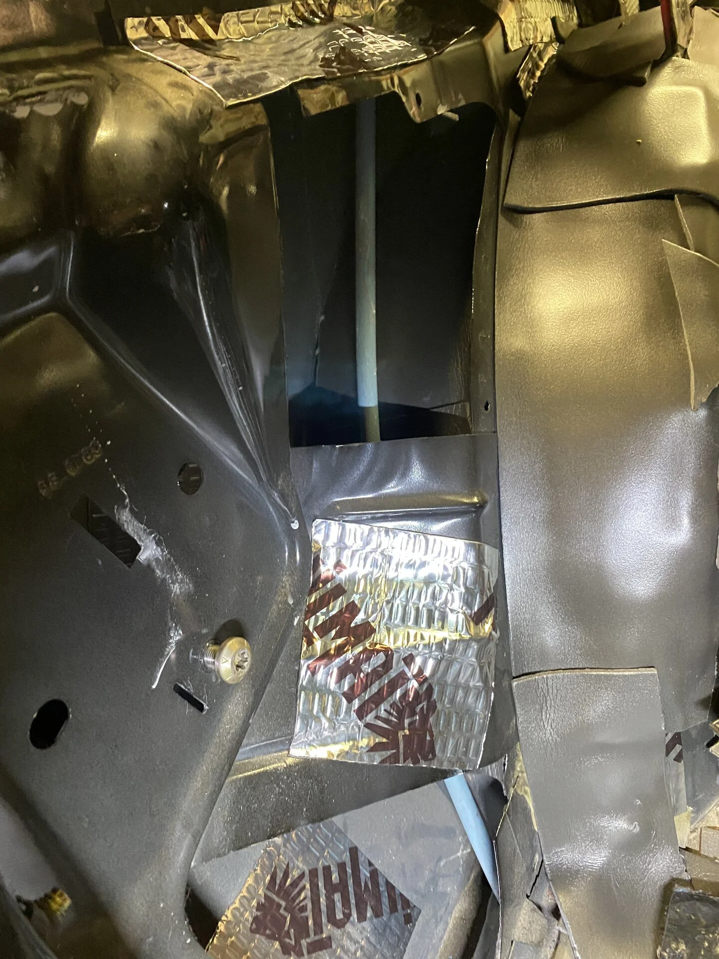

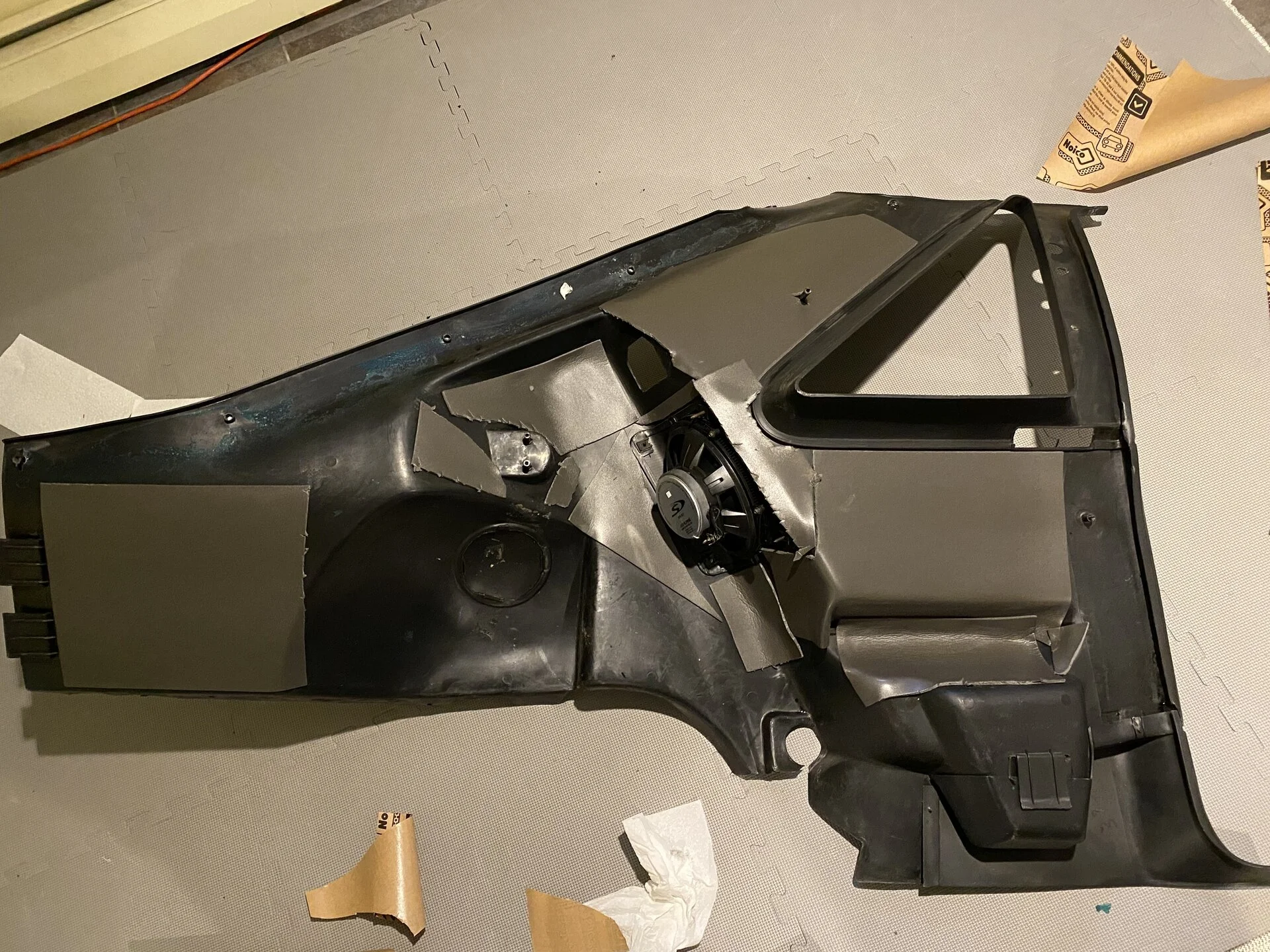

Debating filling these with something. Not sure what yet
Lots of empty space here that can sound insulated.
Other than that, ready to put the interior back in.

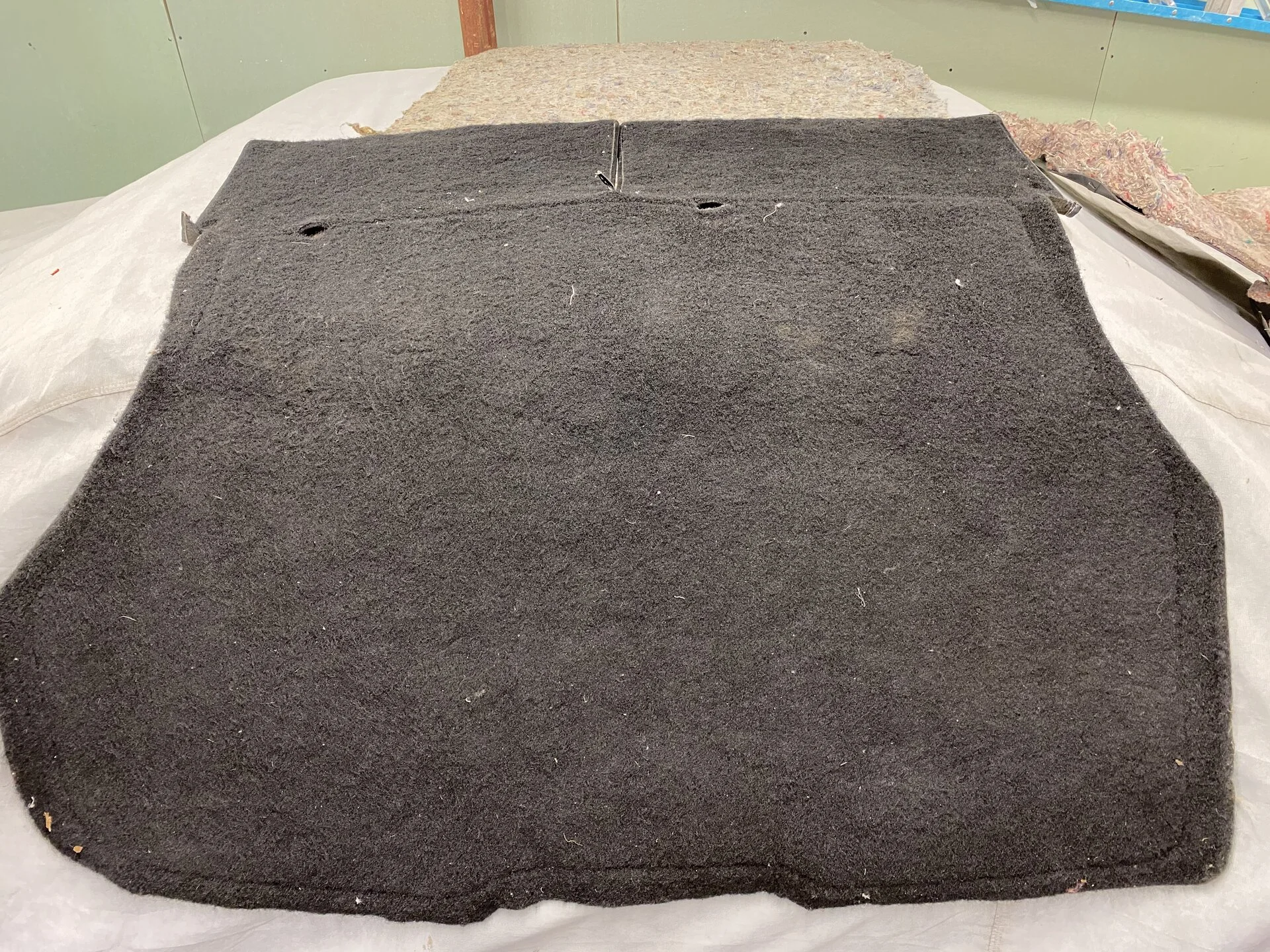

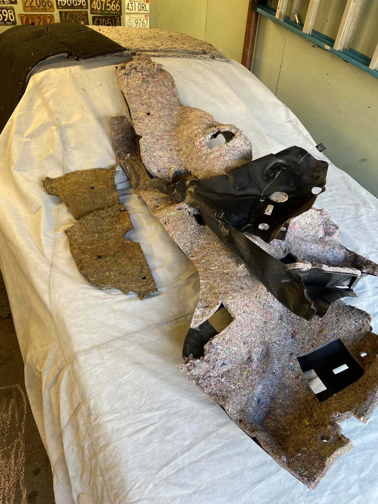

The side panel juke is going back in.
However not a fan of the two big OeM juke carpets in the hatch area. It’s just a big dusty shedding mess that weighs 30 pounds. I might replace it wiTh one big sheet of Mass Loaded Vinyl
I might test the flammability of this and maybe cut it up and stuff it in the open areas. Or is this something that got chucked in the garbage years ago and I can get $1k for now on eBay?
As for the rear carpet. It’s tired. I might get a new rear ACC carpet
Almost too pretty to cover up.
HEY! I said ALMOST!

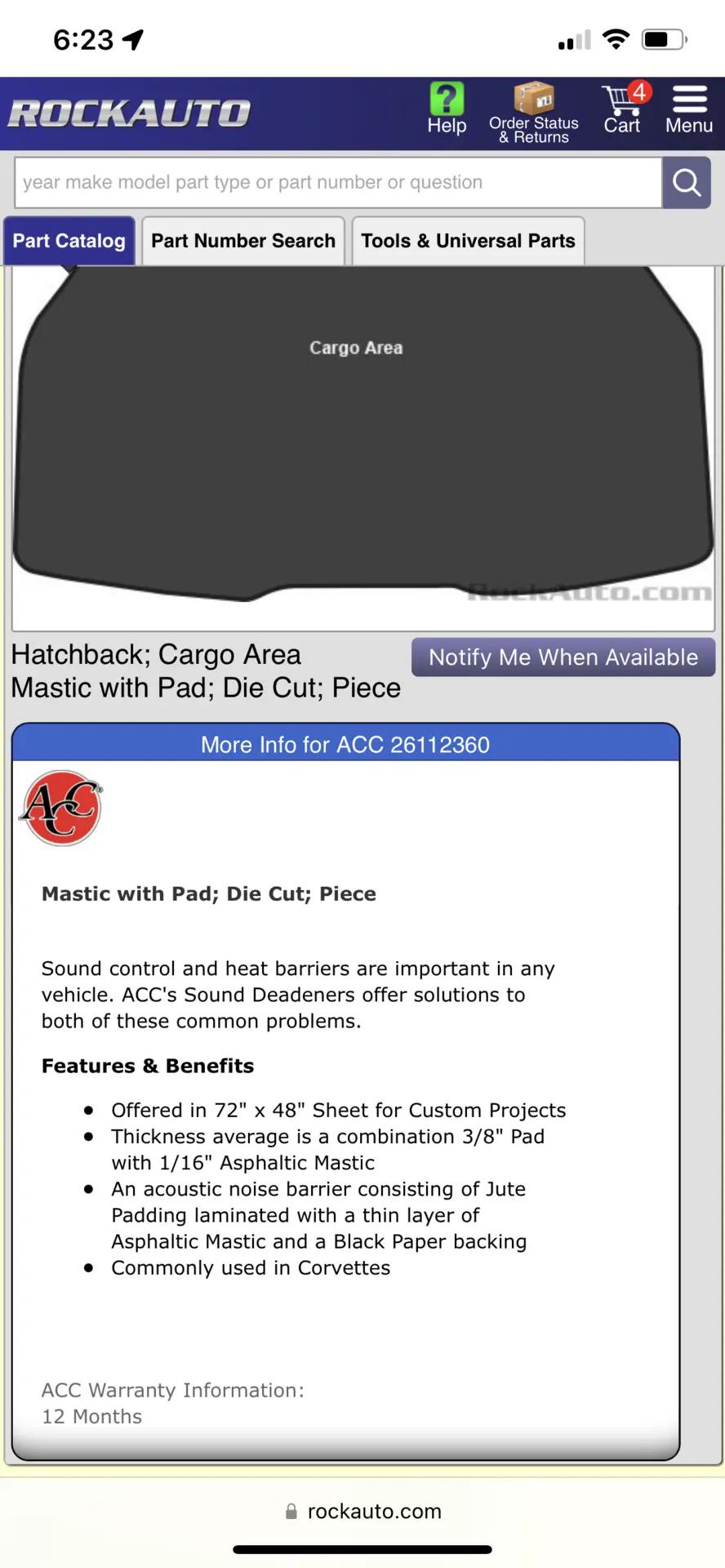

I found this from ACC. Out of stock but looks like it’s a modern alternative to the jute insulation
I think I’m going to order a new ACC carpet from Rockauto. The oem carpet is sunfaded and crushed down. It doesn’t look fresh at all.

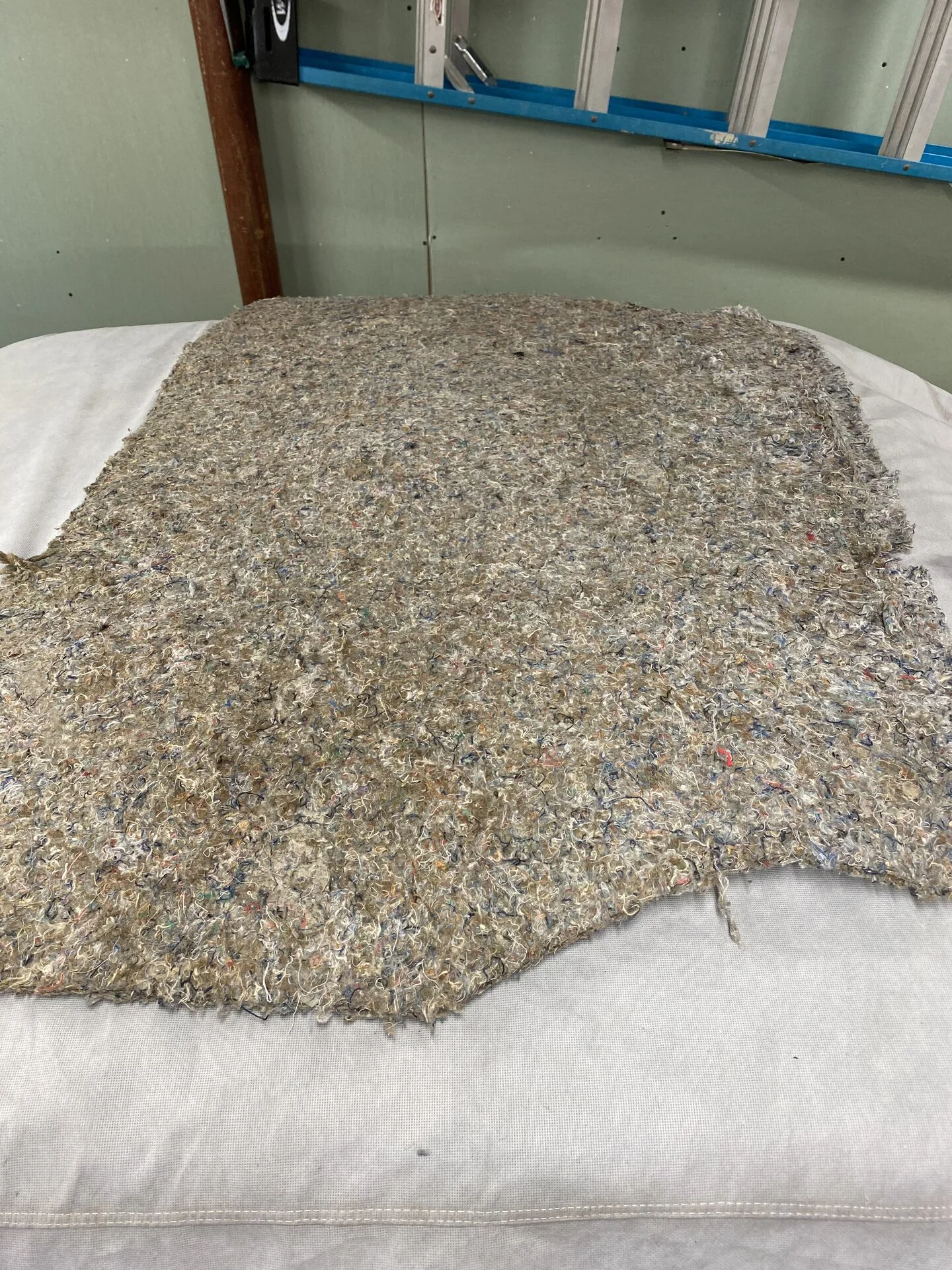

Well, the hatch jute carpet is no more. I decided to break it up and stuffed it into the crevices in the quarter panel. So in a way even though I ditched it, it’s still with me.
That thing was a dusty mess that was alsways shedding fibers. No idea how I held onto it for 20+ years and didn’t ditch it.
I ordered the Essex style ACC hatch carpet with the mass backing. We will see if that’s enough, or I can buy the ACC sound deadener panel as well.

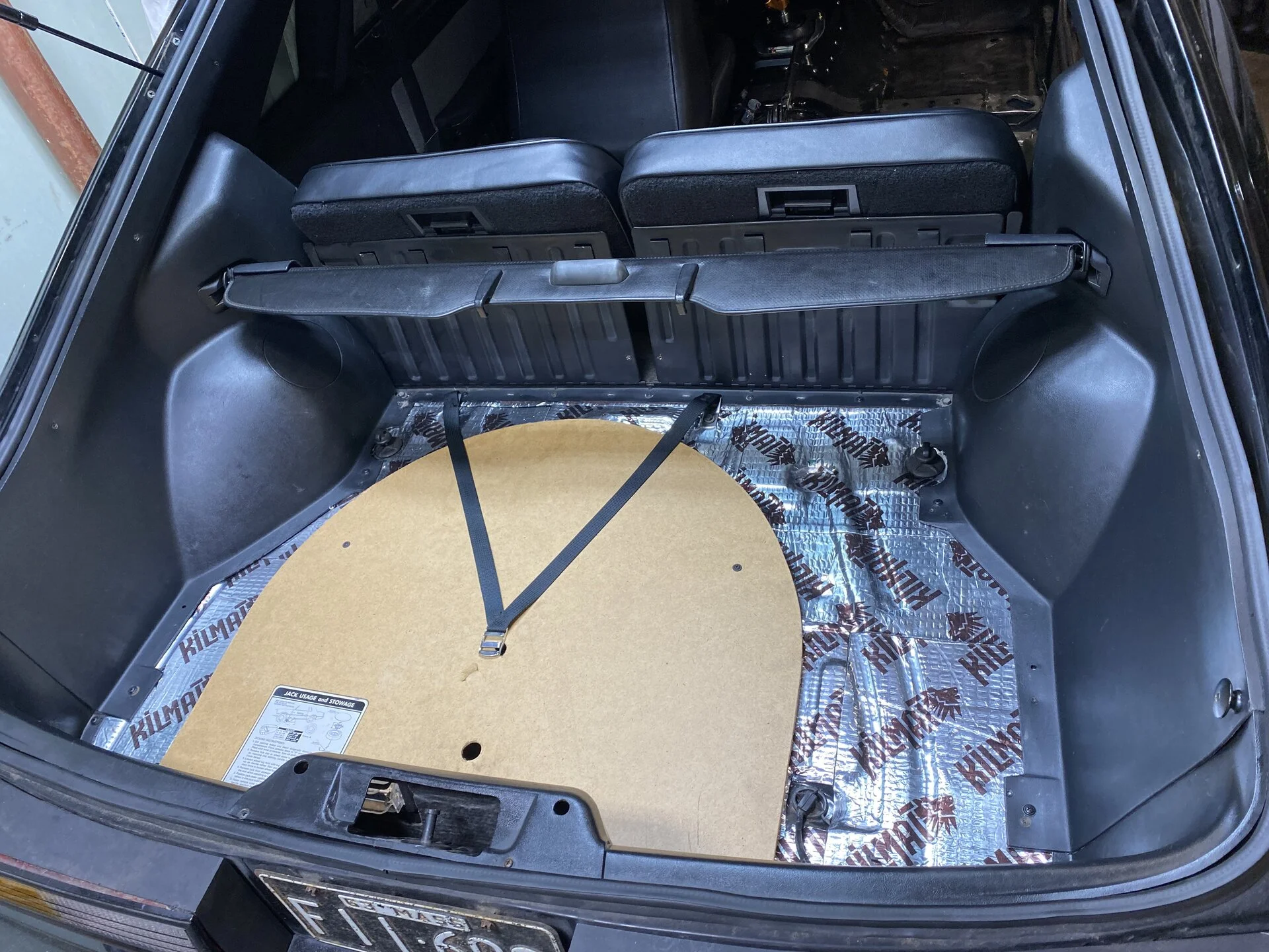

Couldn’t sleep, went in the garage and buttoned it up.
spent some time making sure the panels were properly aligned and used some foam on contact points.
I also put some foam on the plastic hatch panel trim piece and put that in place. I’m almost out, need to buy some more
Also installed new hatch struts.
Now just waiting on my new hatch carpet. Hope this was all worth it.
Gonna drop my headliner next. Need some sound deadener on the roof, but I want to rip off the faux suede I did back when I was young and do the correct vinyl.
Btw the new 92-93 hatch latch is so much better. The hatch locks tighter and it also latches easier. Hopefully the tighter hatch means less rattles.
