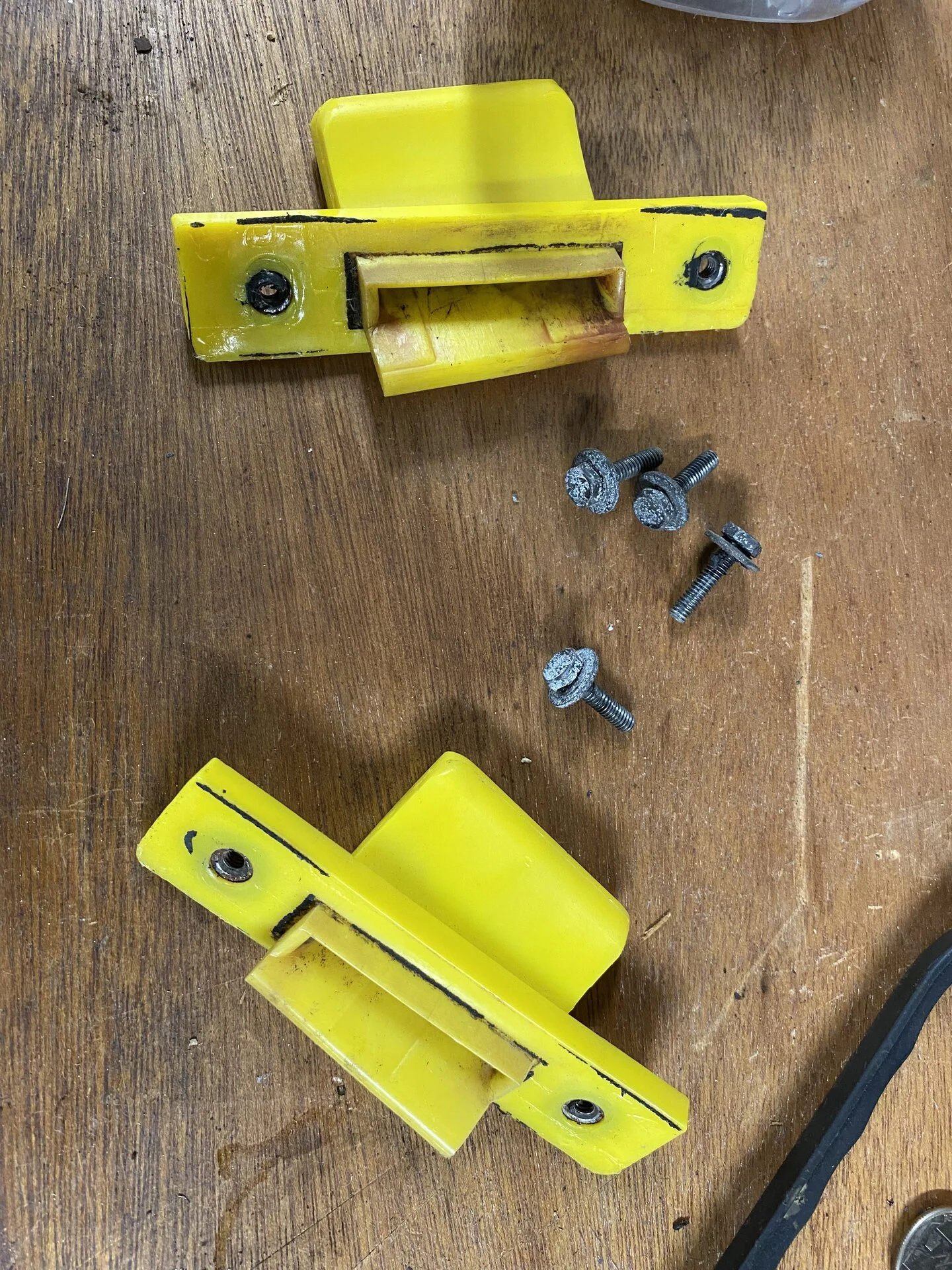

For instance, pulled my headliner off tonight, cleaning out the drains and such and was cleaning the sunroof pockets. The hardware is corroded. Since this is visible with the sunroof out (which is all the time when I drove it) I want to see if I can find some more visually appealing bolts….or just ones that are clean and fresh vs these

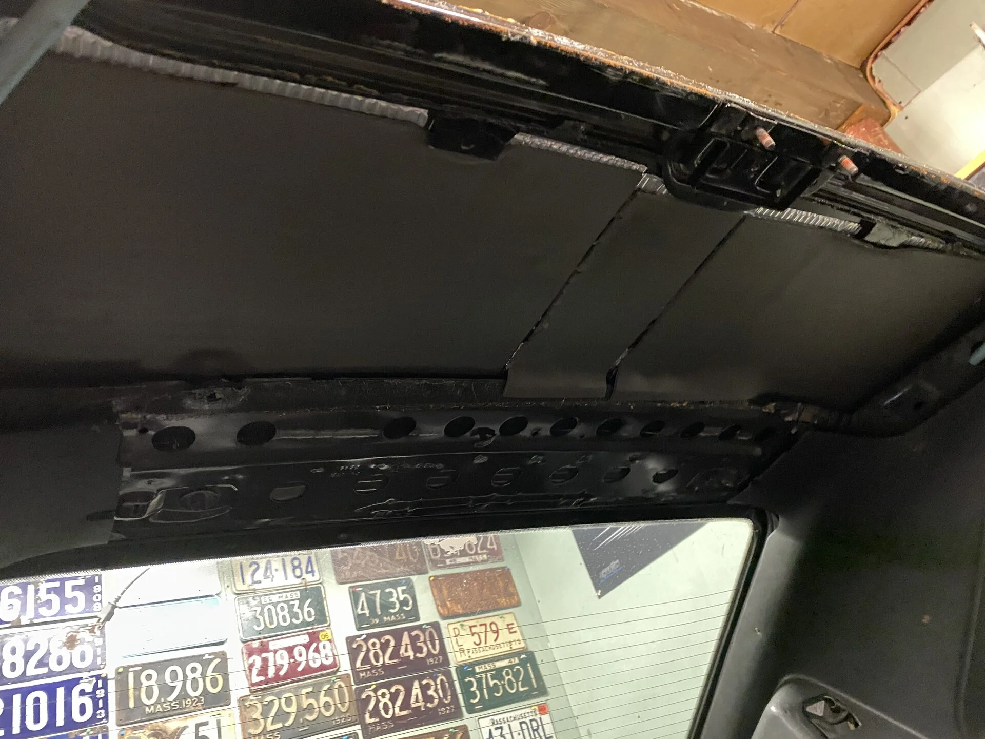

Pulled the headliner out. 2.5 sheets of kilmat and foam to fill the space behind the sunroof. Couldn’t really put it elsewhere. Too much sunroof structure. You do NOT want to apply the foam to bare metal. The adhesive is strong. It will not come off ever! You want to stick it to the kilmat only, as a little heat will get it to peel off like it was never there.

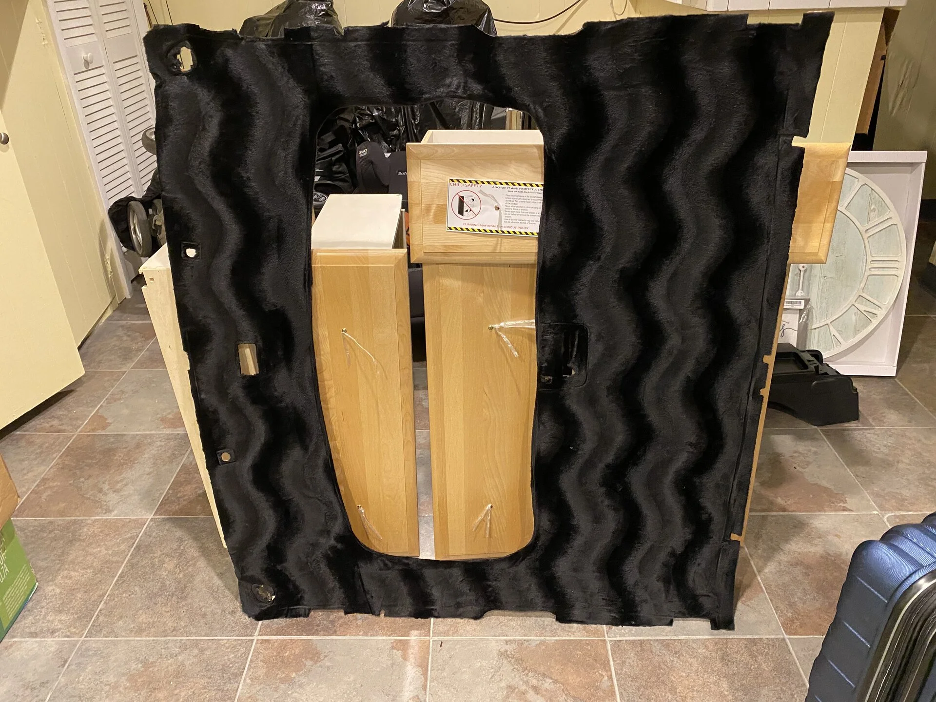

Thanks for posting the pics. Now that I see yours, i am not sure if I can use a solid roof hatch headliner board and turn it into a sunroof headliner board. From my rough measurements using my Saleen, I think the dome light opening from the solid roof car is going to be in the sunroof opening or it is going to be pretty darn close. What I didn't take in account of is the map light location in relation to the sunroof dome light. That looks like it is going to be a problem.
You won't be able to. the map light fits exactly there the sunroof dome light is, and the non-sunroof dome light sits partially in the sunroof opening and where the handle cutout is for the latch.

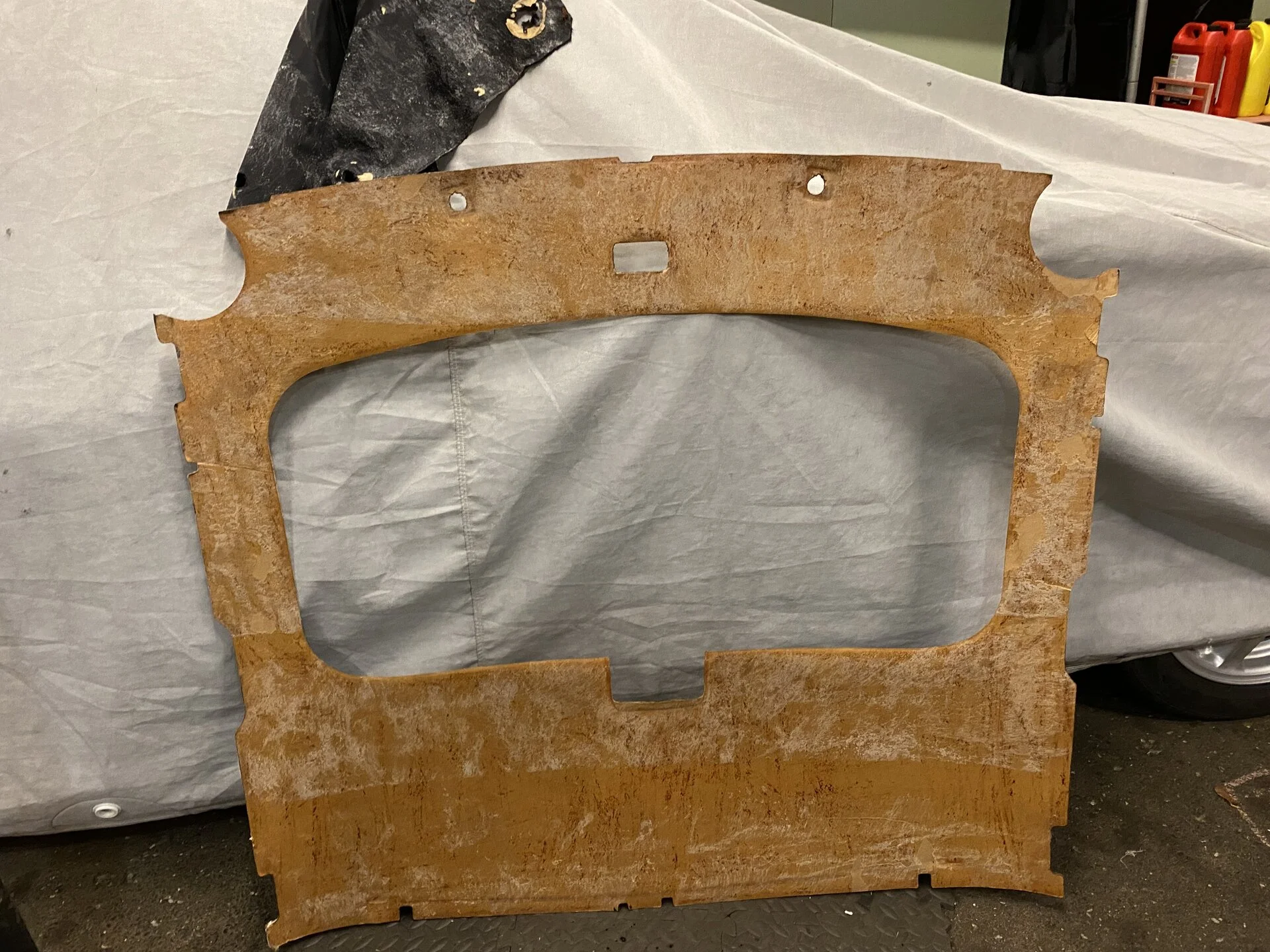

I tried to remove it so i could toss it in the firepit this weekend.
3M Super 90 spray adhesive....that :poo: works. I'm having a difficult time peeling the headliner away from the backing board. It's really stuck on there and I put this on 20+ years ago.
If anyone argues that these spray adhesives dont work, I would like you to come try to help me peel it off. It's inch by inch slowly to free it.
