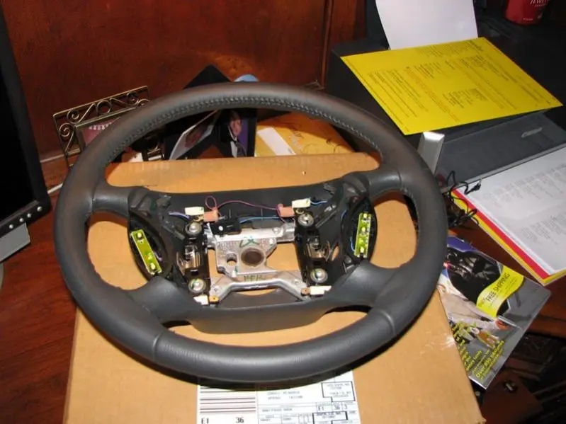

but here is the steering wheel, I got the air bag from a focus couldnt find a black one :-(

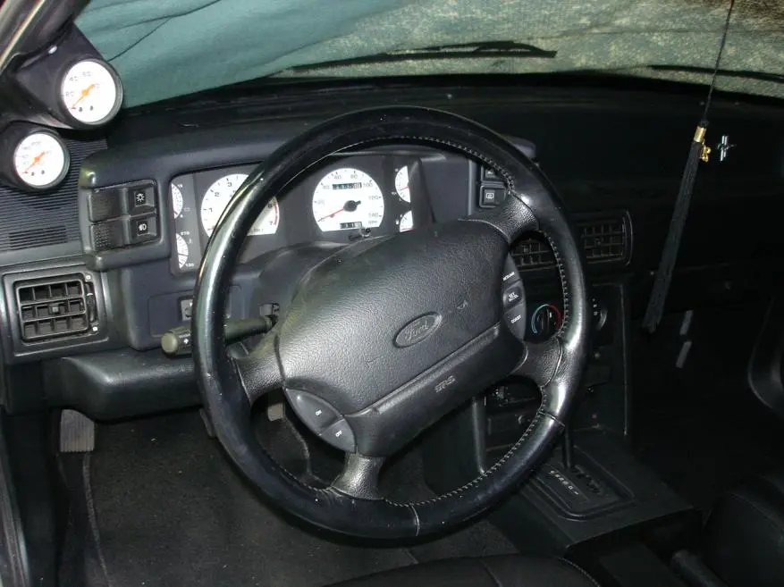

Pic of my wheel, got it new for $80 from a friend that sold his Cobra before he replaced it!

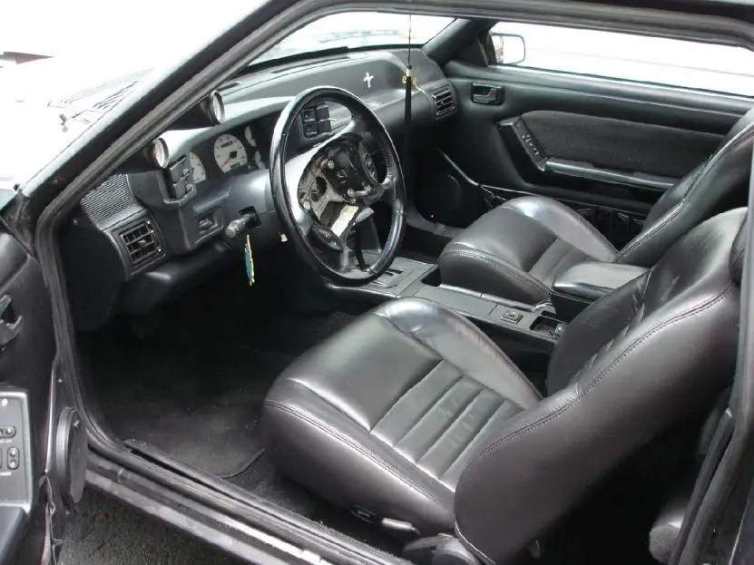

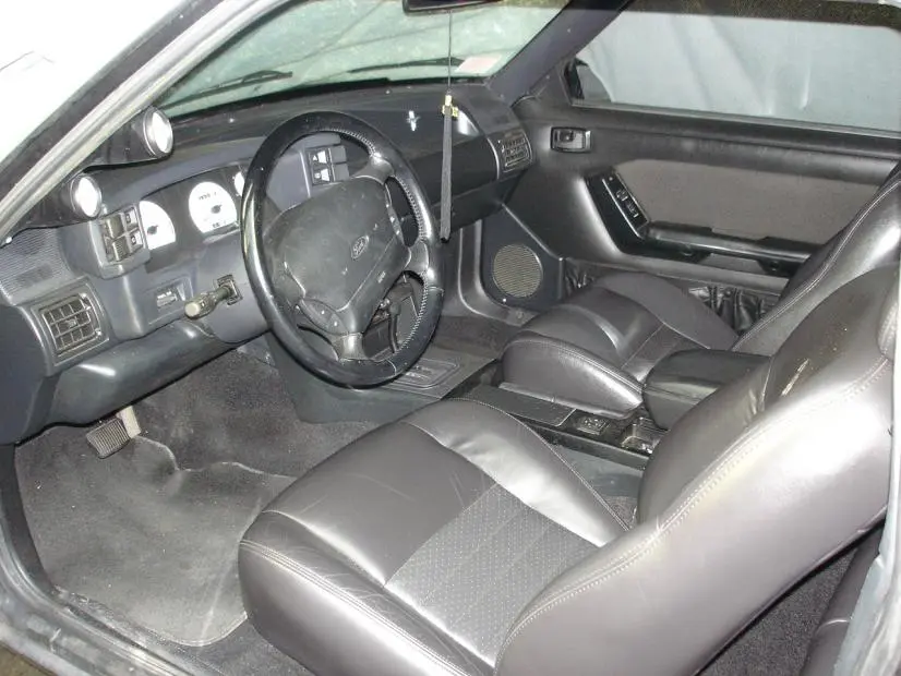

Seats are in, and I started working on the steering wheel.

Is that an original black carpet? I have the ACC one in mine and like it. Although when me and my friend installed it somehow the passenger side wasnt lined up and theres a nasty gap where the carpet doesnt cover... Annoying, but without buying another carpet I cant do anything about it?
Also I find it funny how close the charcoal seats match the original fox black color. A bit lighter, but not too bad.
My ACC was the same, a gap right at the kick panel. I ended up reusing some of my original padding to raise the carpet level up a bit, and now it barely makes it to the kick panel.
Yes, it's an original black carpet. I was going to change it when i first put the interior in....but impatient me didn't want to wait :)
It's not bad. I could prob take it out and just clean and shampoo the hell out of it and it would be fine. There aren't any burns or anything on it.
But then i like the look of brank new carpet.
Yes carpet works miracles in making the car feel better inside.
trbkrb thats exactly where mine was short. Maybe its the carpet and not the install? It annoys me seeing the white metal under there. I think I will try something to get it behind the kick panel.

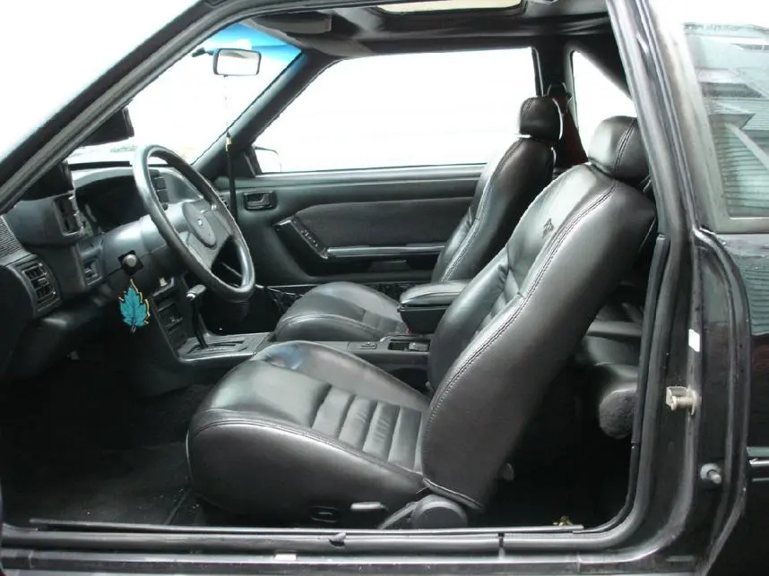

I lied, i did take pics. Wheel not fully installed as i don't have the horn wiring hooked up yet, but this is how she looks. Airbag is a Ford escort airbag i paid $10 for. I want a pony bag, but they all go for $$$$. I'll just have to wait til i find one in a boneyard or something.
Ignore the grubbiness of the wheel. I tackled this AFTER working on my rear end, so my greasy hands made the wheel dirty.
Also, notice the ashtray console is darker? That's because it's painted. It's the only painted part of my interior because i can't find a black console with working ashtray. Notice how it DOESN;T match? Drives me nuts :(

I actually really like that wheel/bag on there :shrug:
You should have kept the stock black console and got the repair kit for the ashtray door. Thats what i just did for my project because finding a BLUE console is going to be near impossible!
