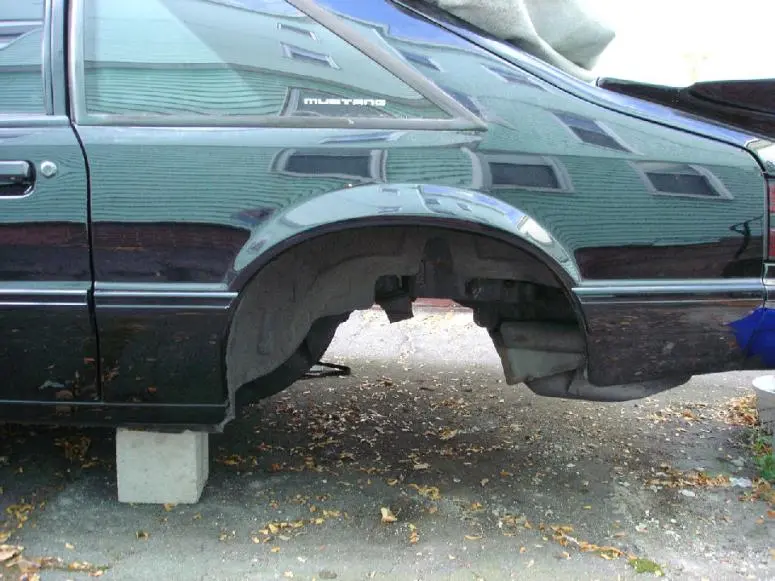

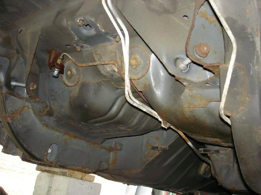

Well, big emtpy spot where the rear is. Was pretty easy. I spent the day cleaning up underneath and removing misc brackets and such so i can sandblast and paint them up.
I will be POR-15in the entire underside. This is really not that bad for a 20-year old New England car that WAS driven in the snow. Minor surface rust at the seams. No rot or serious rust anywhere. Before the rear goes in, this will all be taken care of.

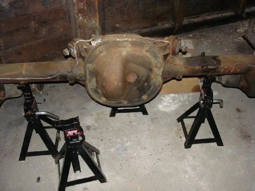

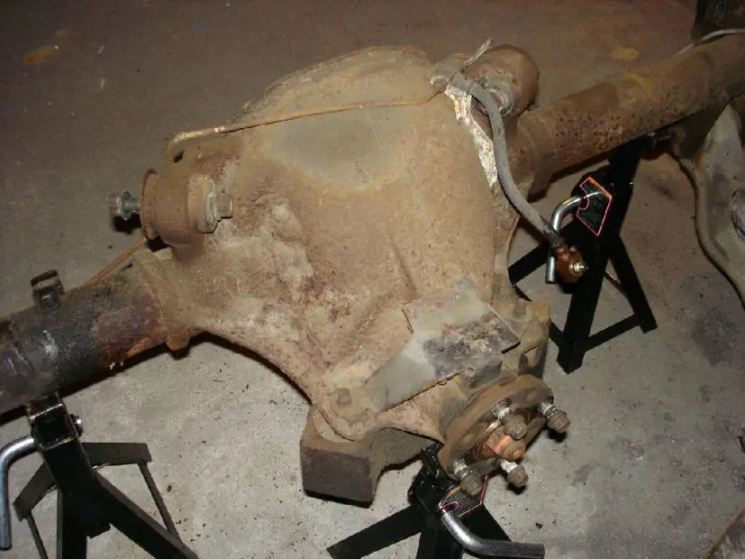

And the rear. It's hideous. I decided to take it out rather than try to make it look nice on the car. Gonna repaint everything, replace the bushings and run near brake lines as well as my SN95 cobra disk brakes on the end.

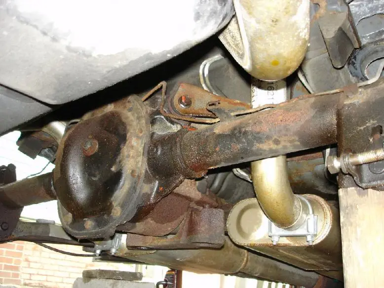

My starting point. The wet spots are PB blaster that i sprayed everywhere to loosen the bolts.

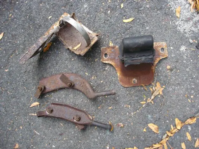

Also, several of the brackets to be sandblasted and painted.

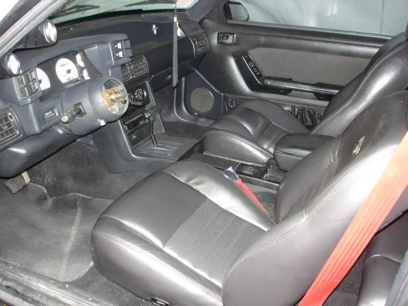

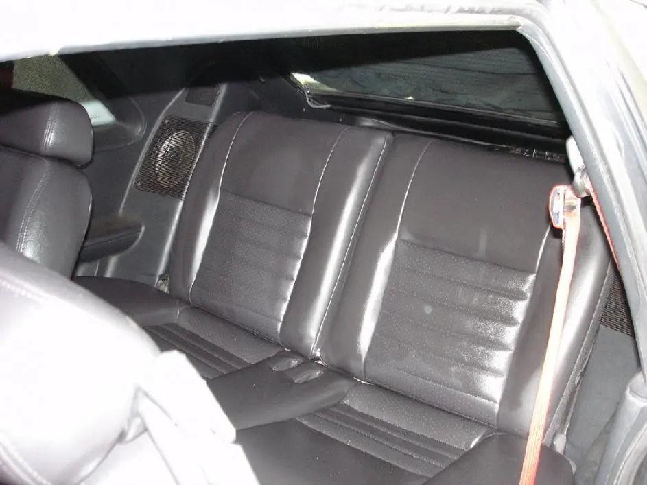

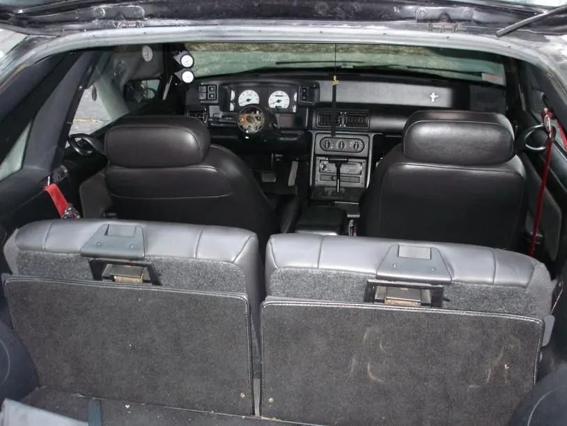

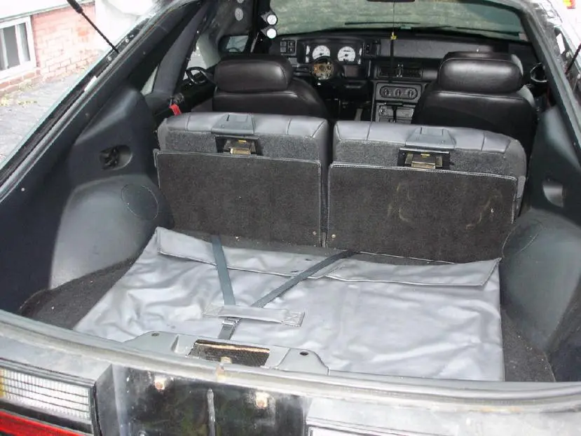

And i did some more test fitting of the steering wheel today. Not ready to be permanently installed. I just needed to measure where to mount the contact ring for the horn. Couple more interior shots. Needs a vacuum badly....and some new carpet and headliner
