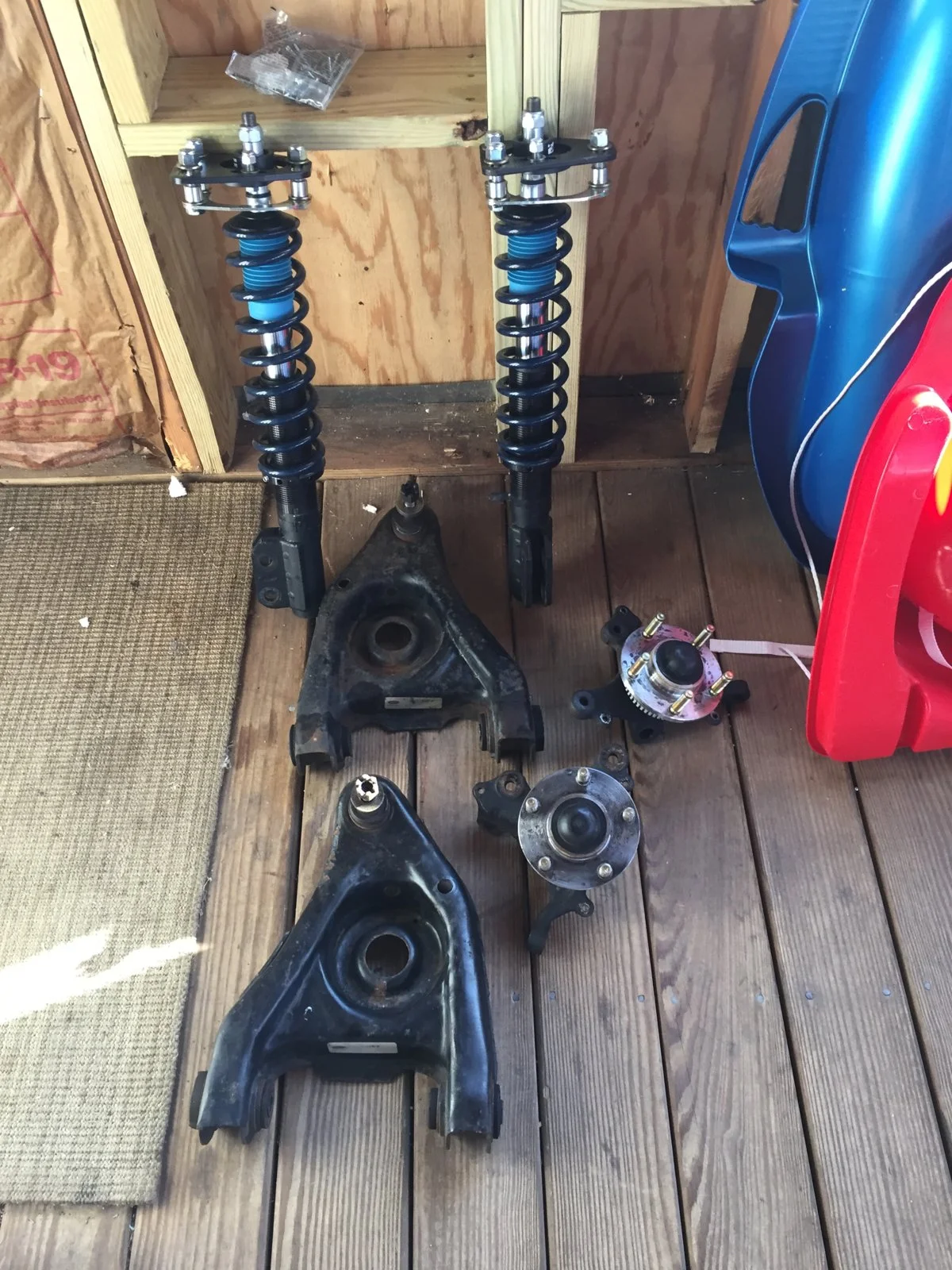

Going rate for these front arms? Figure I don’t need them anymore.

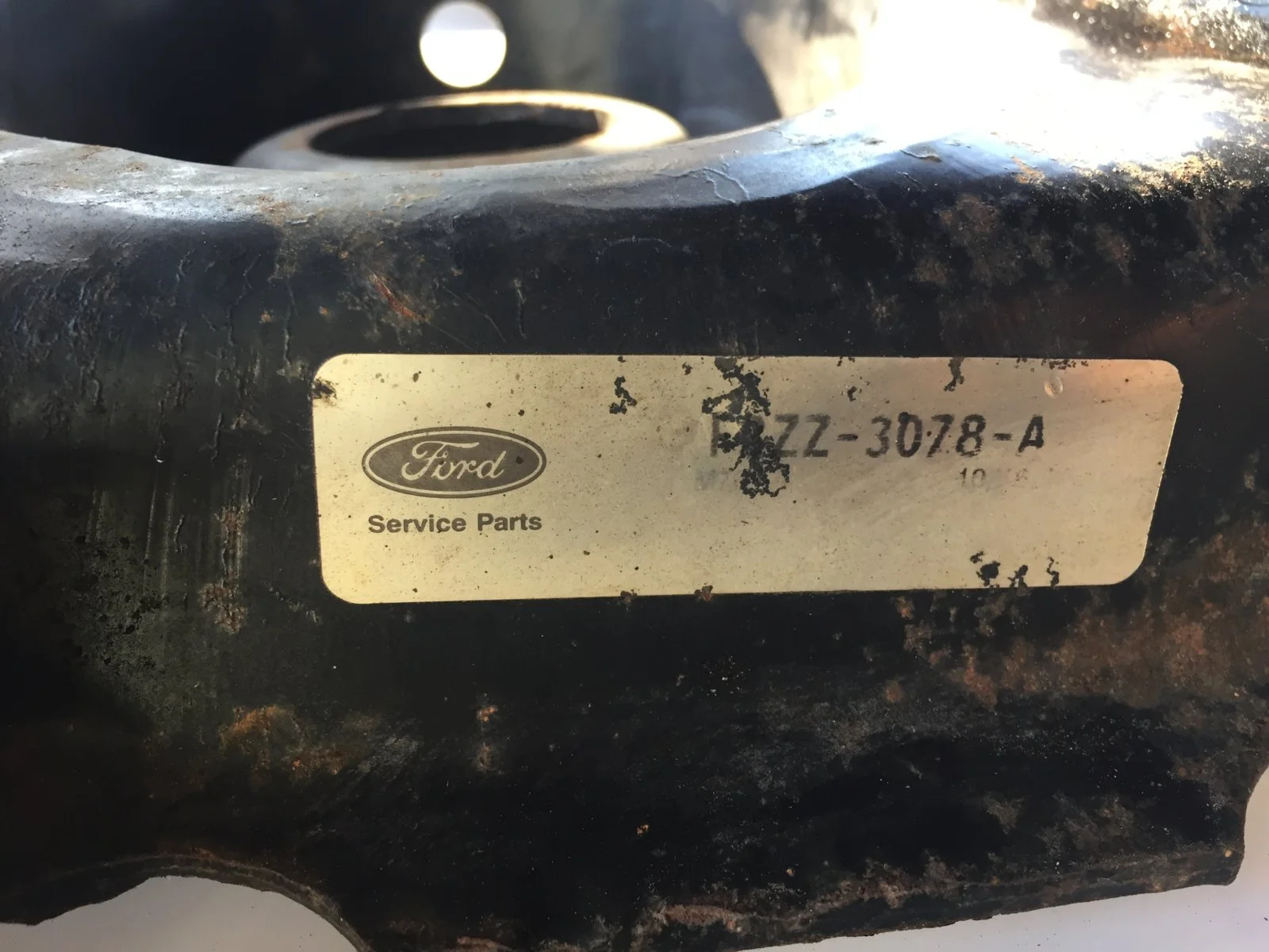

The old F3ZZ-3078-A /F3ZZ-3079-A upgraded front control arms. These had the better bushings and bslljoints and more reinforcement. Would anyone even buy these?
I’ve got maybe 2k miles on them. Put them on back in 2009.
I might squirrel them Away
Sell for $320ish new

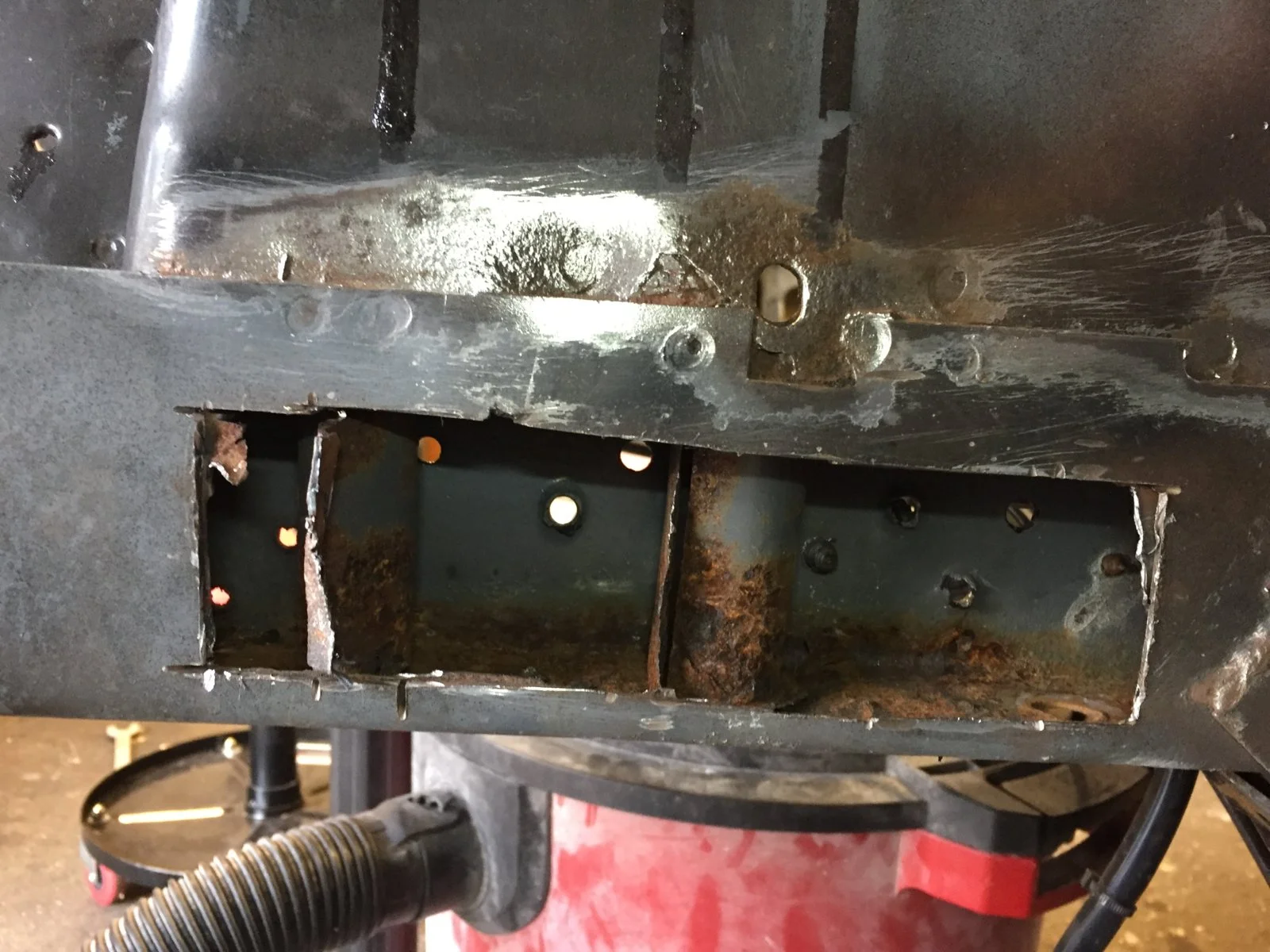

Well, needed to distract myself so went in the garage. Started cutting up the “good” frame rail. Stopped at this point.

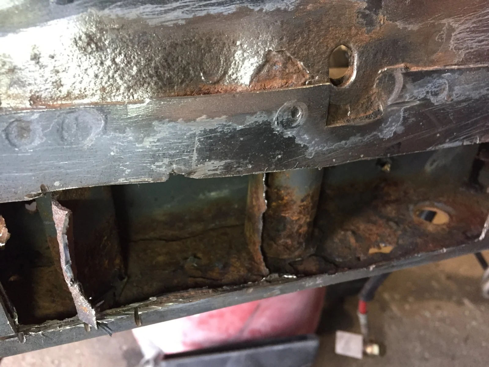

Looks like the rust occurred from dirt going into the gaps on the top plate, and then getting wet and staying wet. I pressure washed the car a week ago, and inside I found wet dirt/rust still.

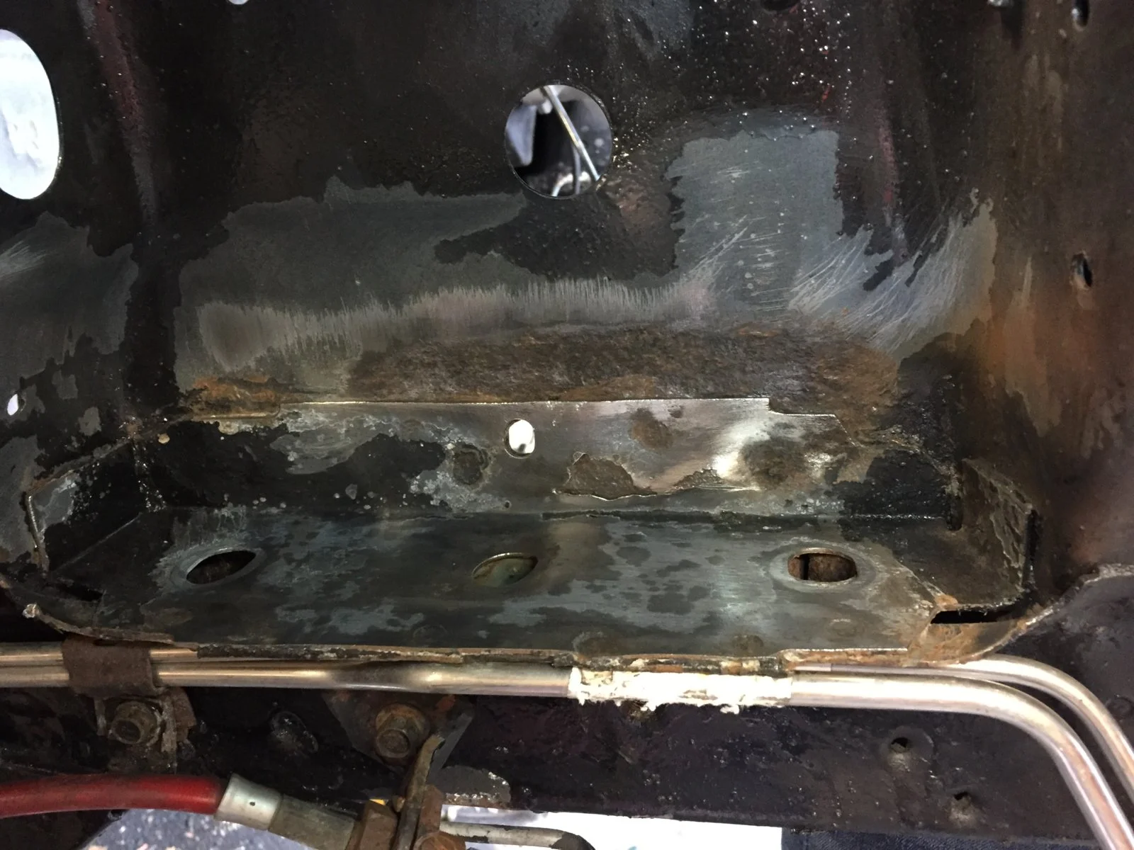

Outside frame is solid. Top plate is solid. Inside was mostly solid but I had to cut out to access the rusting bottom/bolt supports. Still can’t get the front one out:
What should I do about the bubbling on the strut tower? It’s solid metal. I figure I just wire wheel it down and grind it smooth. Well see.
Need to do a little more cleaning up and figure out how ill patch in new metal
Ideally Mike, use a small sandblaster and clean the rust completely out.
Try a wire wheel, it’ll get most of the crusty crap off.
If you don’t want to try to sandblast, use your wire wheel and then some rust converter.
