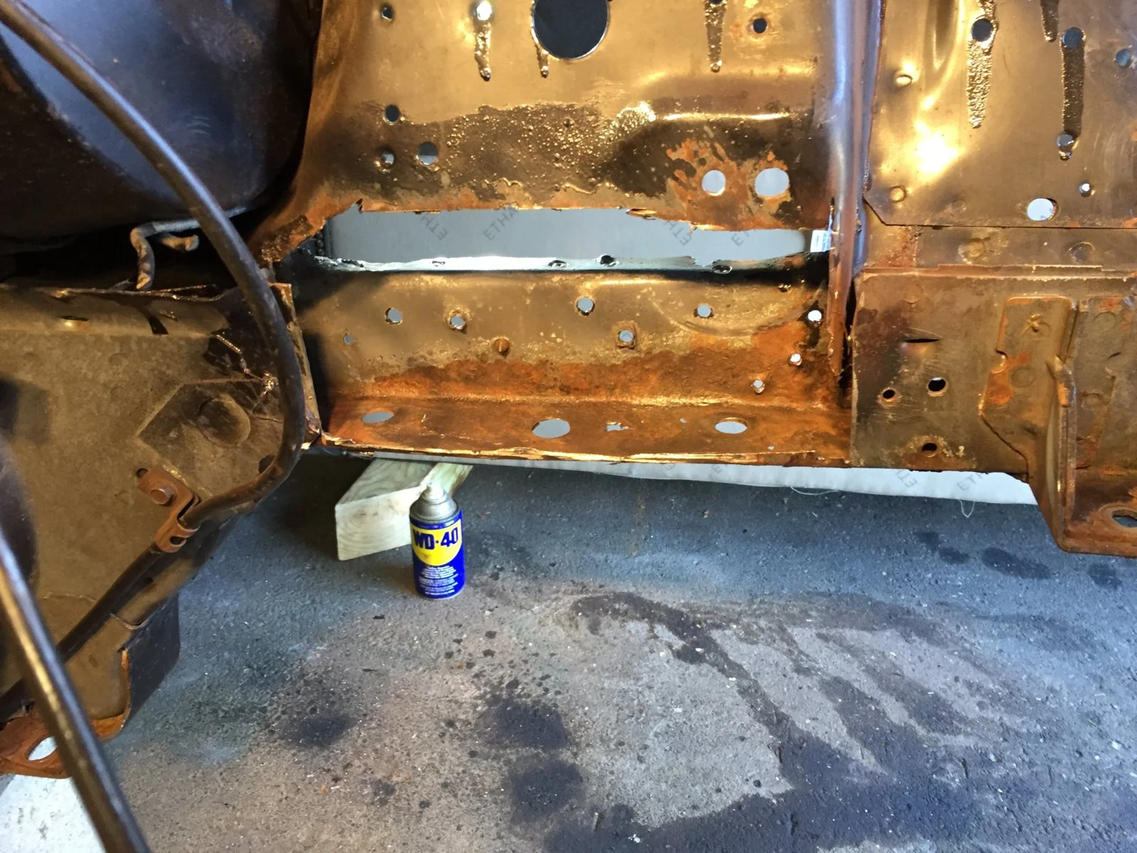

Chipped away at the bad side a bit. Drilled the spot welds out and took the top plate off.
Going to cut the bottom bar out, but not until I have my replacement parts ready to go. Need to clean up the surface rust and see what else I need to cut out. All the rot is gone now, this is all surface rust. I believe I need to cut more of the strut tower out, but I want to mark my cuts when I have the repoacement panels in hand and can mark it.

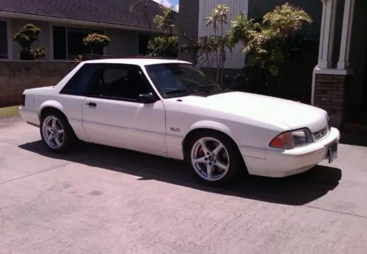

Hows the paint work on the 98 Cobras held up? They look great in these pics, but have they been used much since refinished?
I'm on the fence if I want to sand/refinish my set myself, or just have the powder coated.

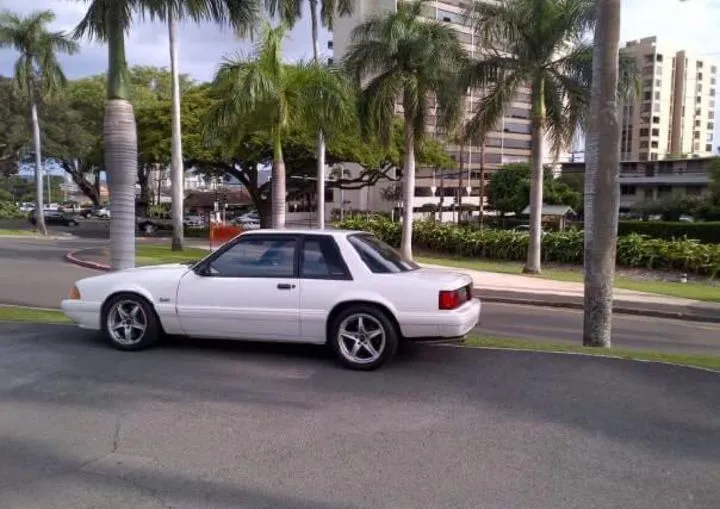

Those aren’t the ones I refinished. I never mounted tires on those.
When I was searching for two more rims, I ended up buying an entire set. These are two of those wheels from the set I bought
I have 6 total. I was going to take one, have it narrowed to 5” or 6” or so, mount a tire, and use that as my spare to clear my upcoming brembos. I want it to sit low in the hatch and a full size rim sticks up too much

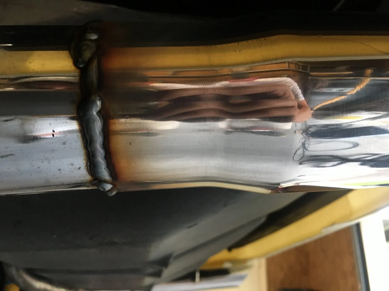

I bought this one last year when my Miller 140 bit the dust.
Haven’t use flux core or had it on 240 yet. This welds thinner sheet metal and exhaust tubing way better than the Miller. In fact, welding exhaust was fairly easy. The Miller would either blow through or spatter. I could actually get a bead going with this welder.
Whatever you choose, I highly recommend inverter technology. Way better than transformer.

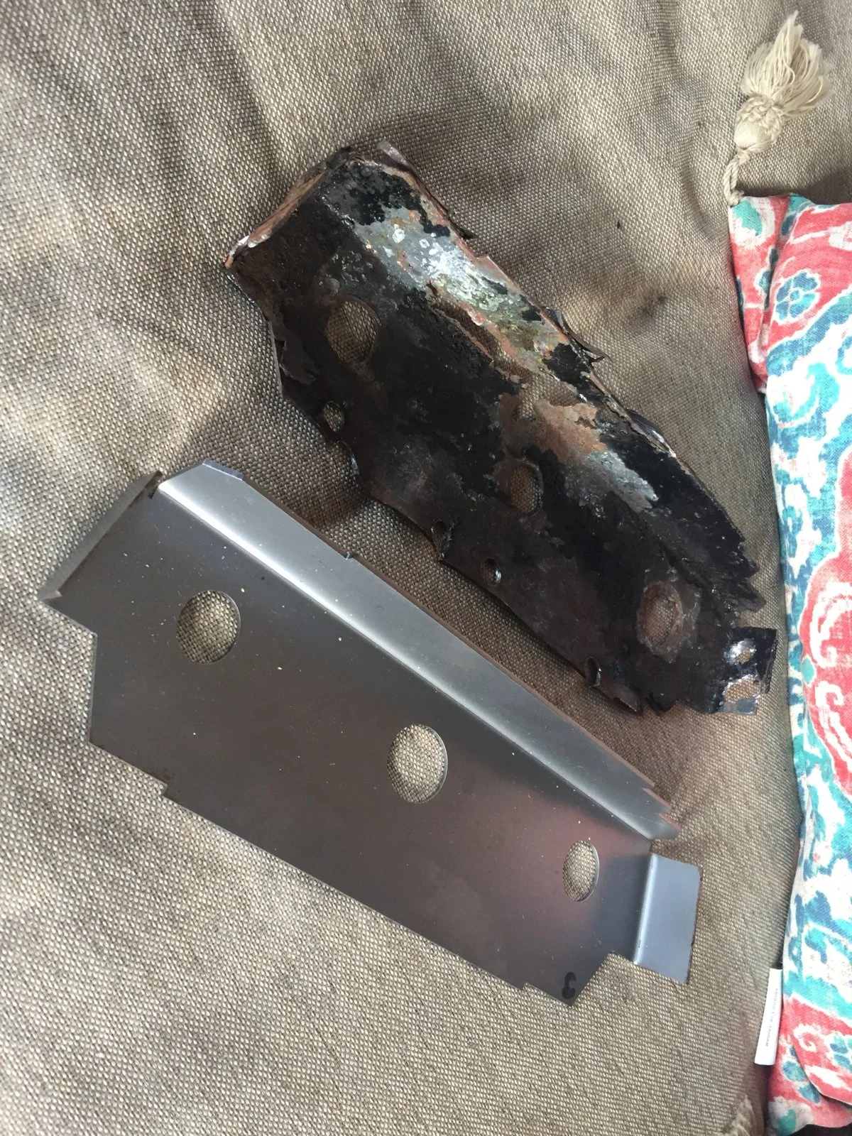

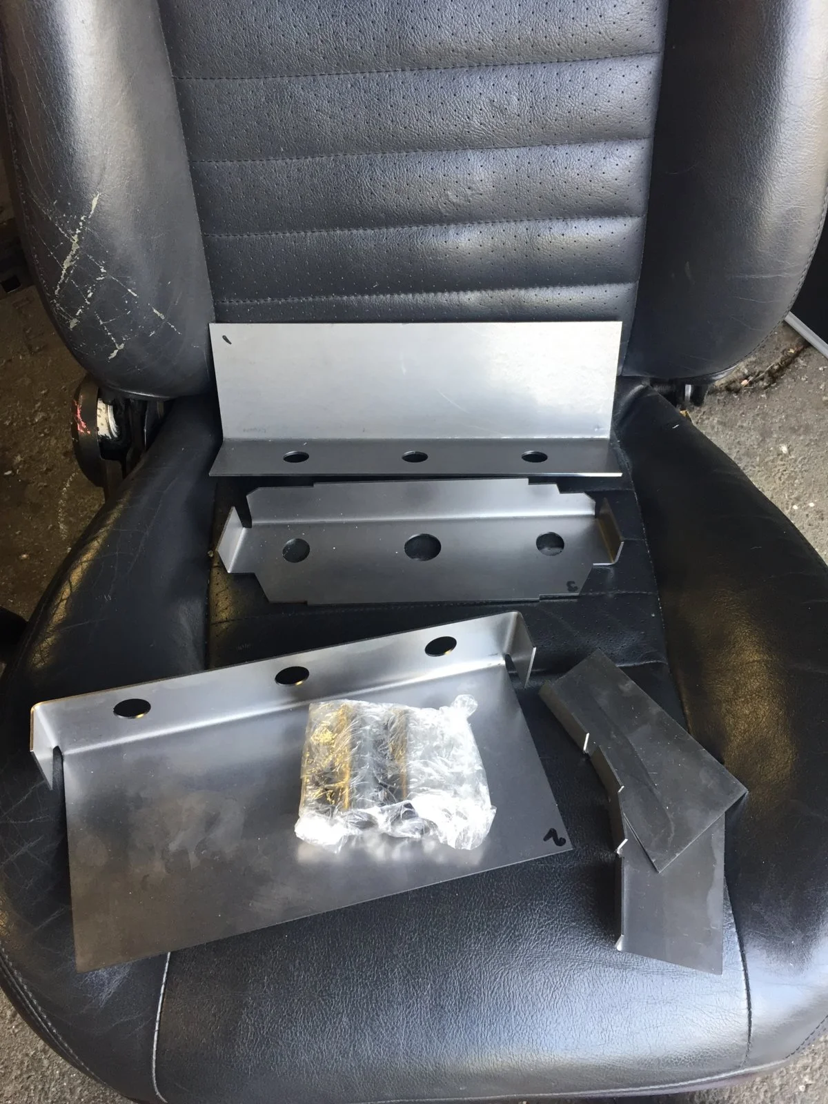

Spent the day cutting out small bits of metal to allow me to patch in the Scott rod panels. I burned my spot weld cuter tip out so new one in the mail had to stop. Slow progress I know. Really getting the itch to get this motor in but I need to slow down and do this right. I’m just slowly cutting and figuring how I’m going to stitch these panels together to make it strong.

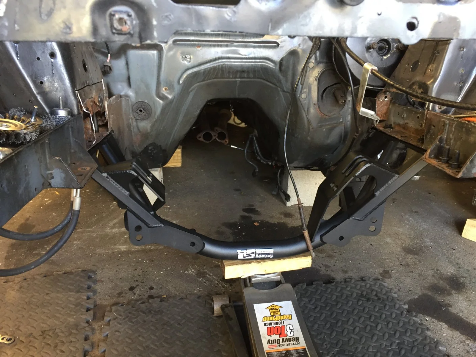

I test fit the k member. Since the oem k member was bent, I wanted to see if any of the mount points were bent. They weren’t

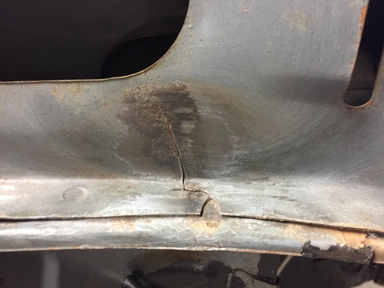

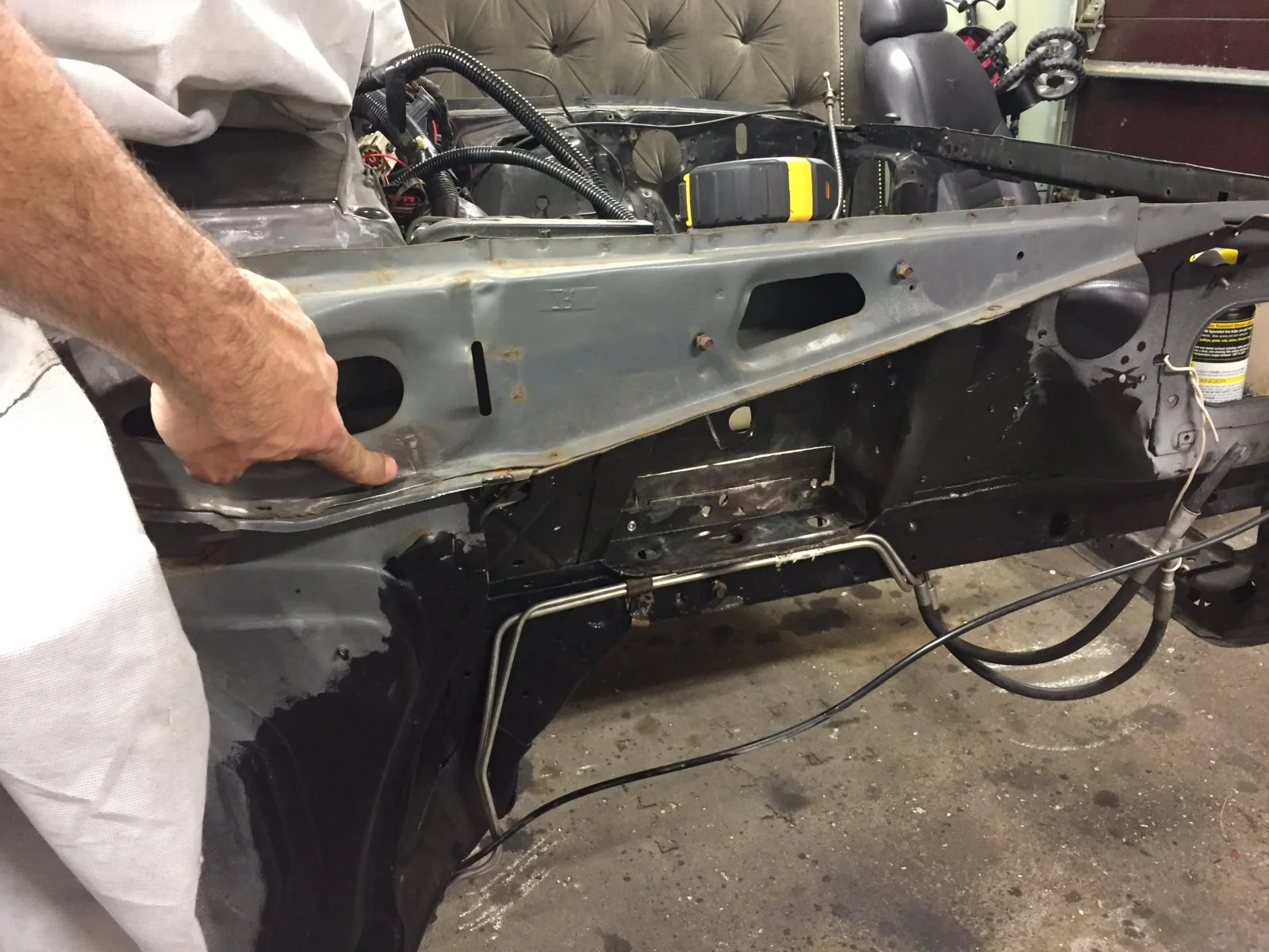

Also, found a small tear in the sheet metal under the fender. Unsure if this formed from flex, or was a defect when the panel was originally made. I’ll repair it
Where it is so you have an idea
