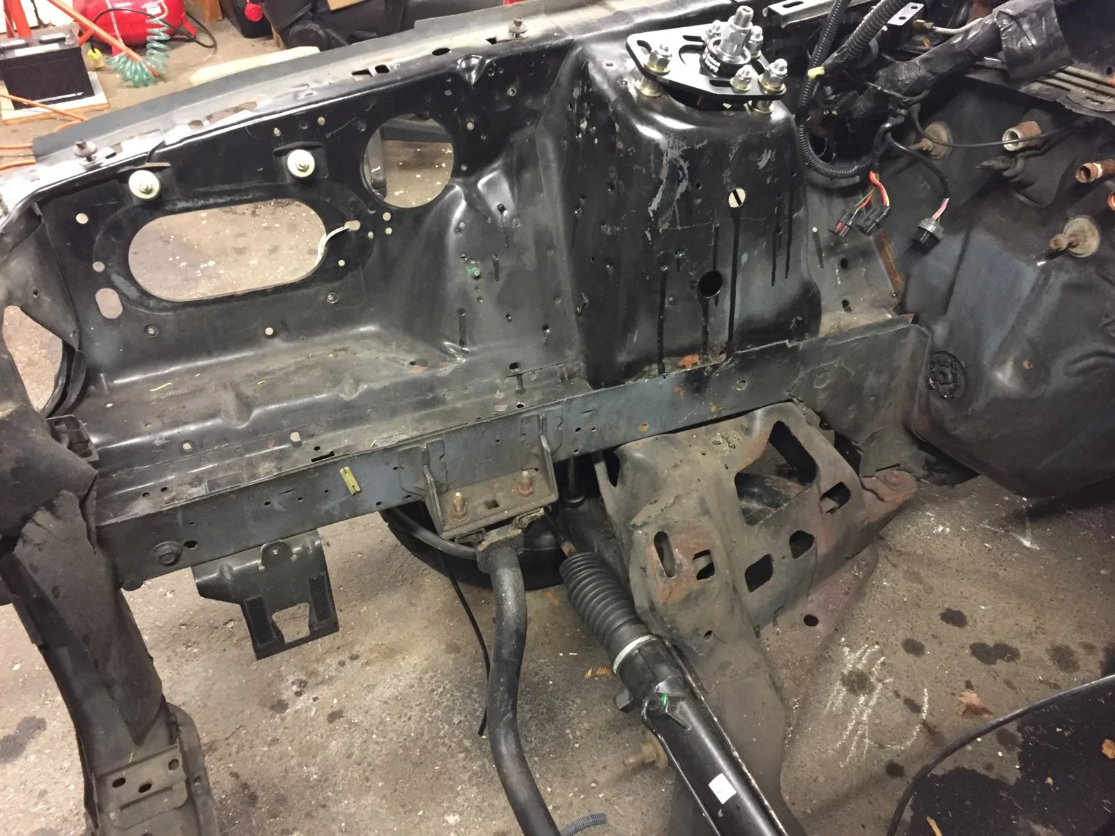

How ya going to fix that crack ?
Open to suggestions from those with more experience.
I've stick-welded in the past to repair trailers and such. I also perform automated welding with Laser and TIG at work so i'm familiar with penetration and how speed and power affect penetration.
But this is my first time MIG welding, but i'd like to say i have above average fabrication skills and am a quick learner. I have scraps i'll be testing some techniques out prior to working on the car.
At this point, i'm just dissecting out the rust and using cardboard to fit and trim my patch panels back in. I'm taking my time as i want this to go back together as OEM as possible and look factory. One thing i'll note from searching online is that everyone takes a different approach to repairing these. Some have been very good (in my opinion) repairs, and some have been poor and don't really do much to reinforce structural integrity.
One thing that did surprise me was that my pass side frame rail looked "fine" when I began. If i was looking to buy this car, I would have looked at it and thought it was in good shape and thought nothing of it. Only when I cut a small bubble out did I find the rot mixed in with wet sand. Fortunately not much made it past the side structure of the strut tower which localized the corrosion to that region only. I had power washed the bay about a month prior to cutting it out, and this sand was still moist!
Both sides were filled in with sand. In our region, sand is sometimes mixed in with salt that they lay down on the roads. The salt washes away, but the sand is still common to see until after a few major rain storms well into the summer. What i assume happened is the sand got kicked up by my front wheels as i drove and landed on the "shelf" where the k-member nuts are. This plate is open around the edges so the sand fell into the rail and accumulated. It got wet, held the moisture, and rusted out the internal structure. SO even though i avoided all the salt, looks like road sand is something i'll need to avoid as well. I think i will seal up this top plate with seam sealer when i am done to prevent this from happening.

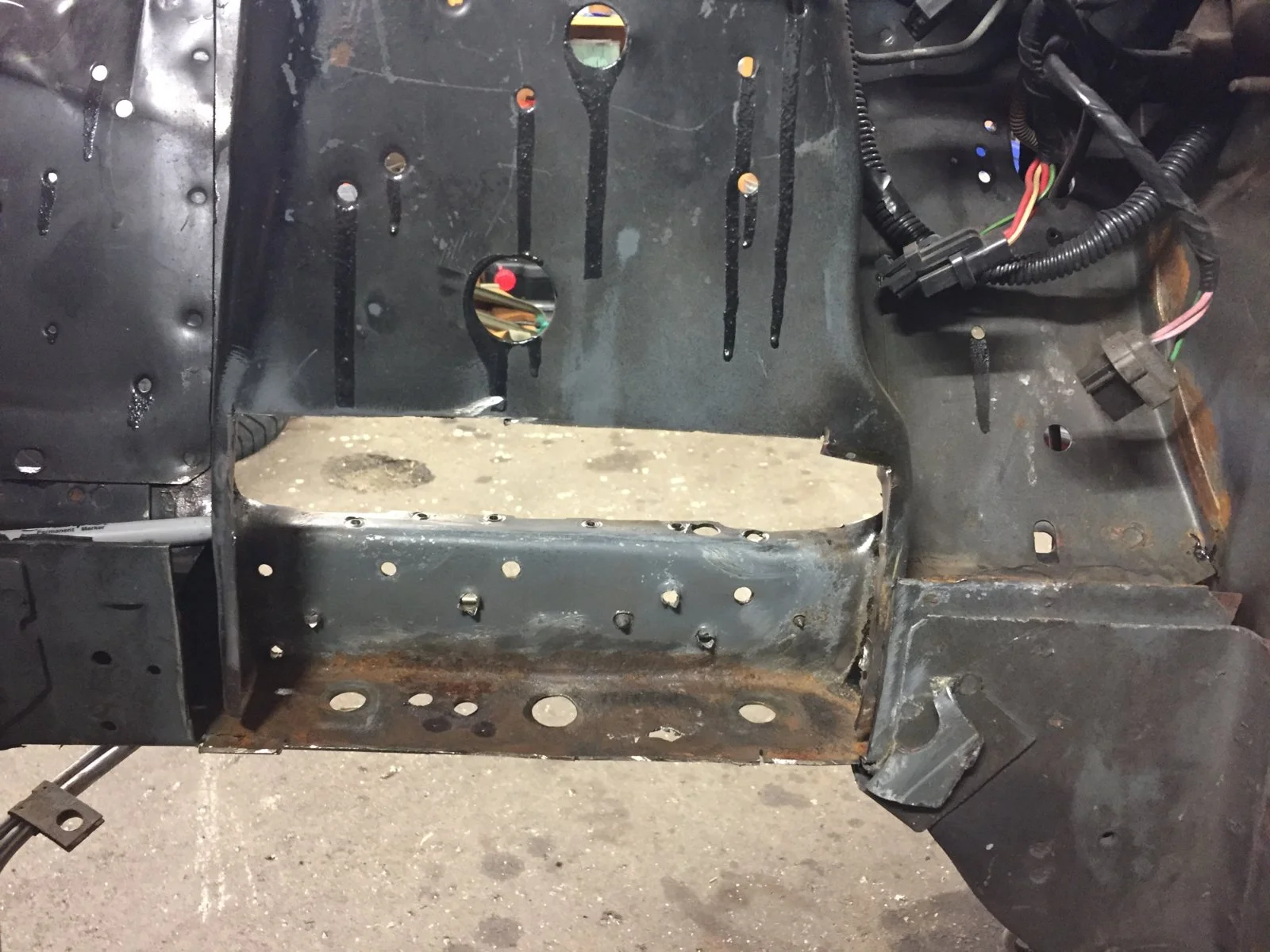

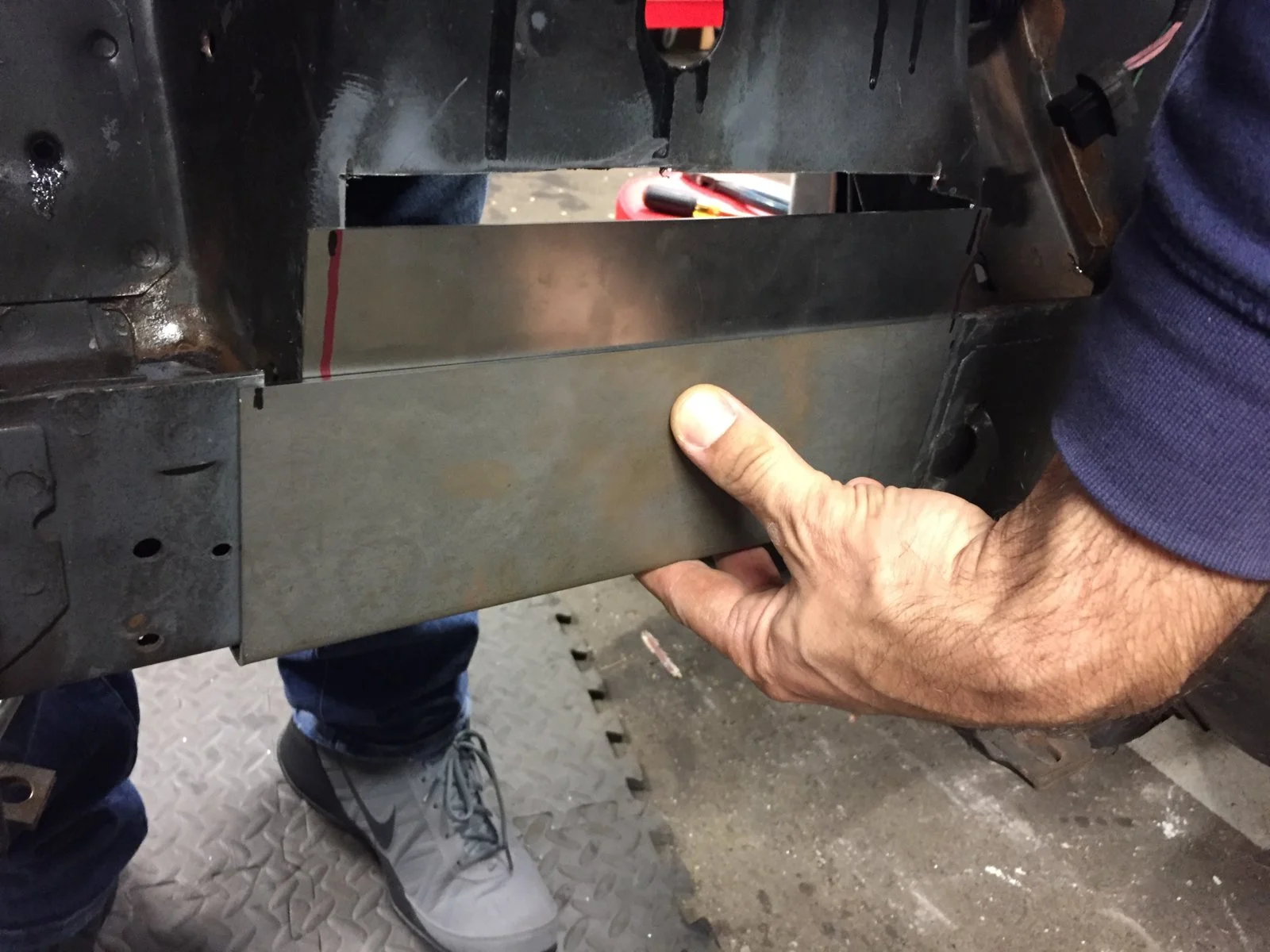

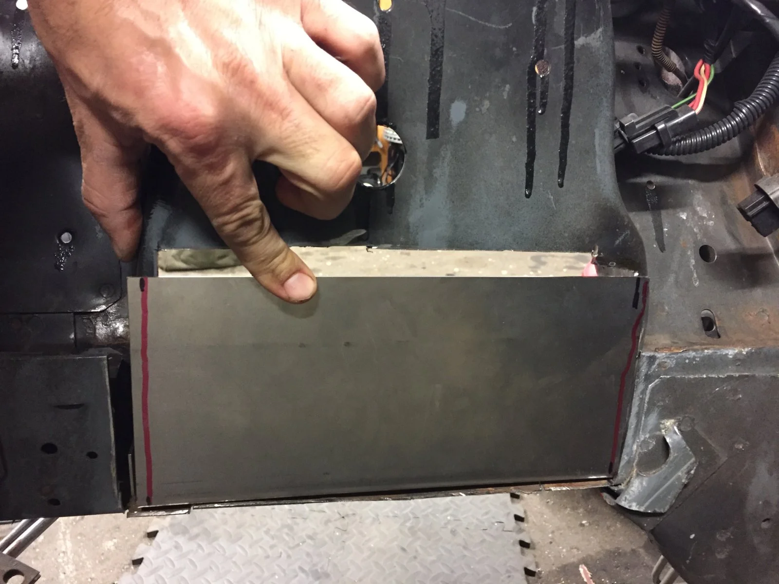

So I started cutting in the panels. I figure some would want to see how I do this.
First off, this is where I started. Doesn’t look too bad right? Except the insides were corroded.
When I stopped cutting, this is what I was left with. The bottom of the rail needs to come out too but I’m using the bolt holes as reference for now.

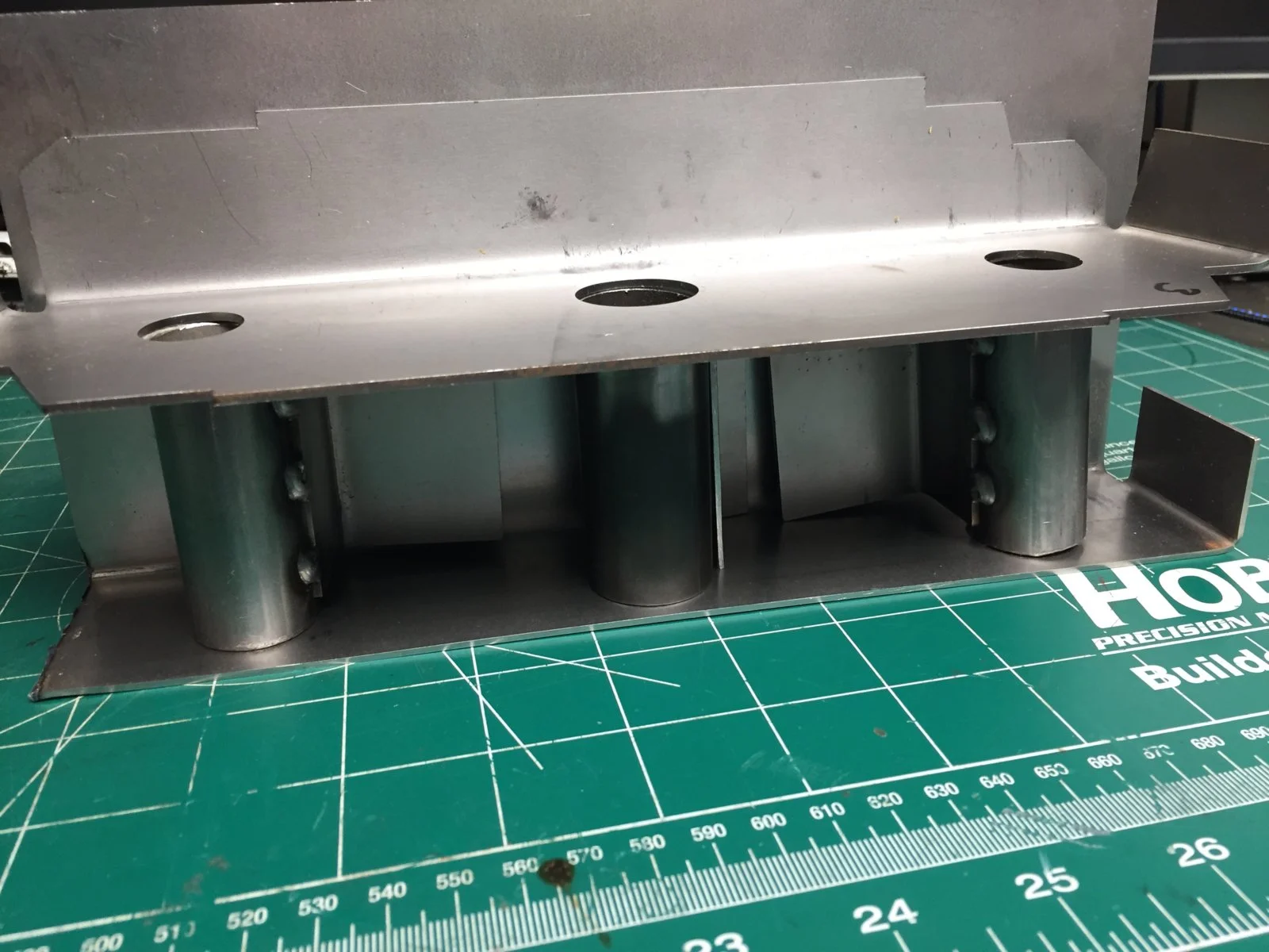

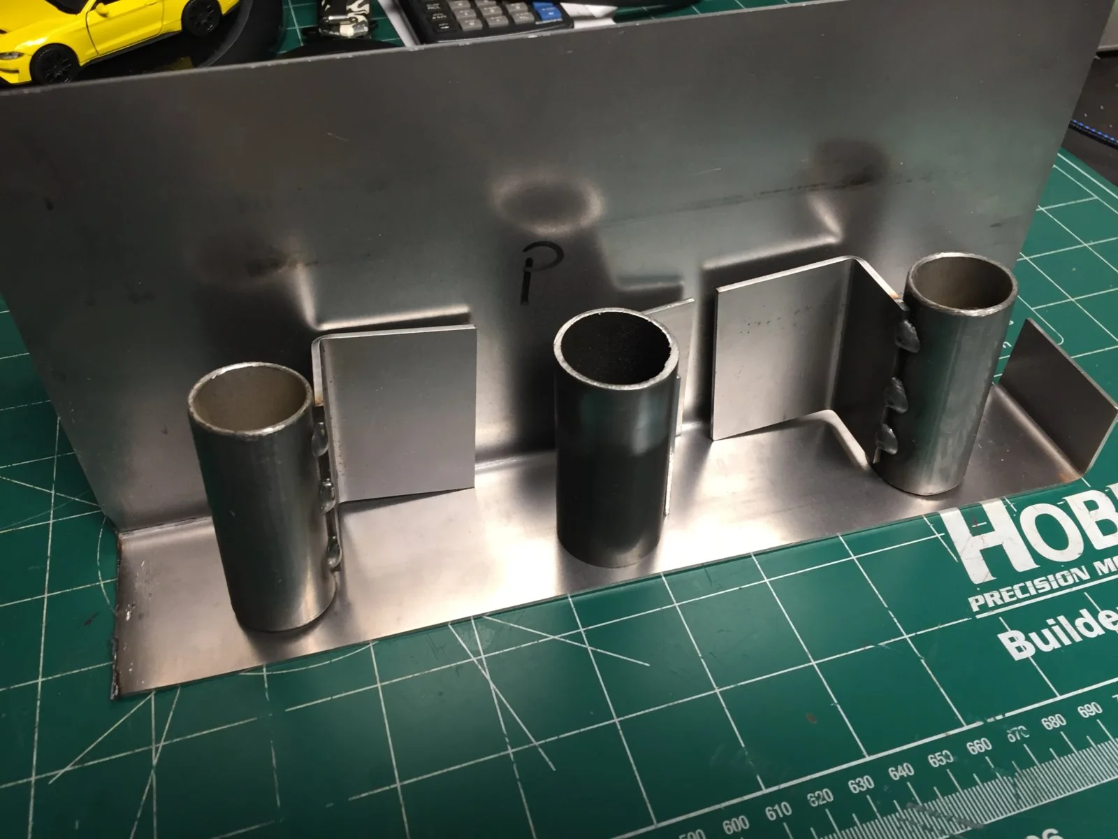

Here’s how the inner supports will be configured. The scott rod kit didn’t come with the middle one, so I got some 1 1/8 tube and made my own. All this will get tack welded in place before I weld the strut panel in.

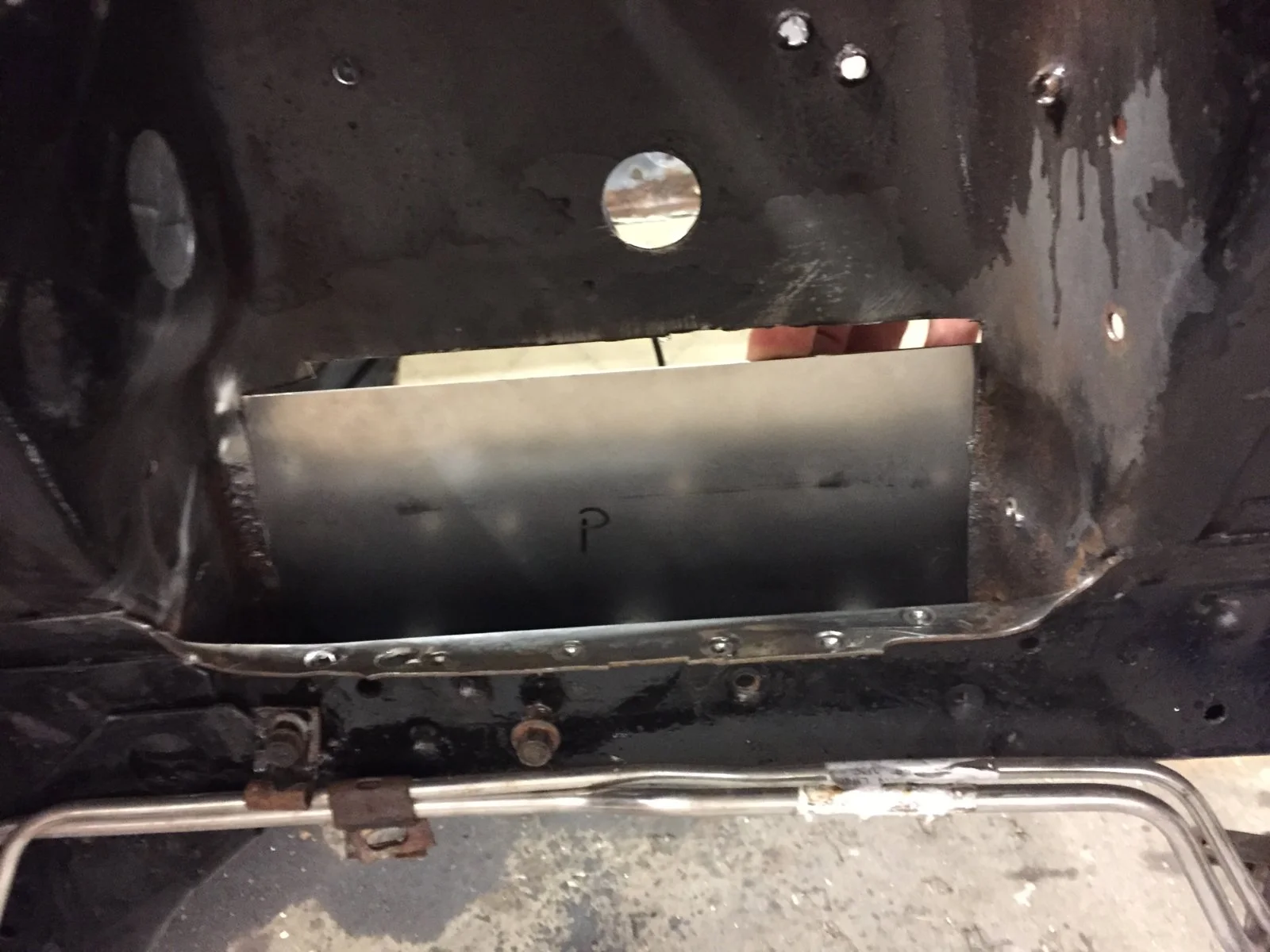

And then how the top plate will lay in. Last piece.
Seems easy. Welder shows up tomorrow along with the MIG spot weld nozzle. I’m actually looking forward to this.
