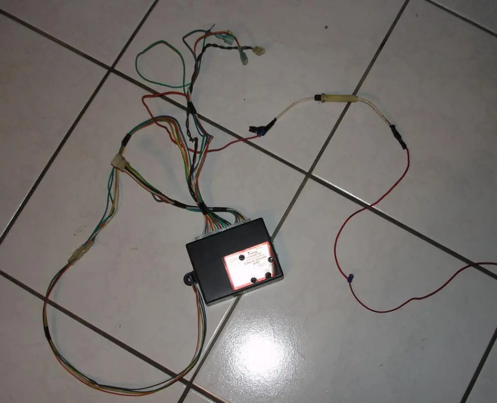

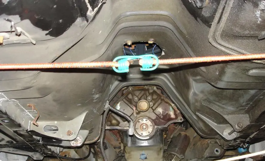

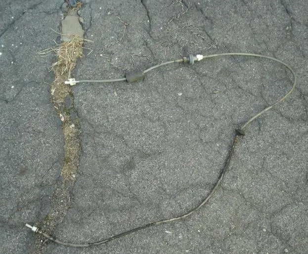

Okey, this is why i had to get a new speedo cable. My car did not have cruise control. So i guess it had this dealer installed cruise dohicky. I removed it a long time ago, but a lot of the wiring was buried up in the dash and i could finally get it out now.
I guess the VSS for the cruise attached to the speedo cable up top as you'll see by the wires and the weird UFO dohickey.

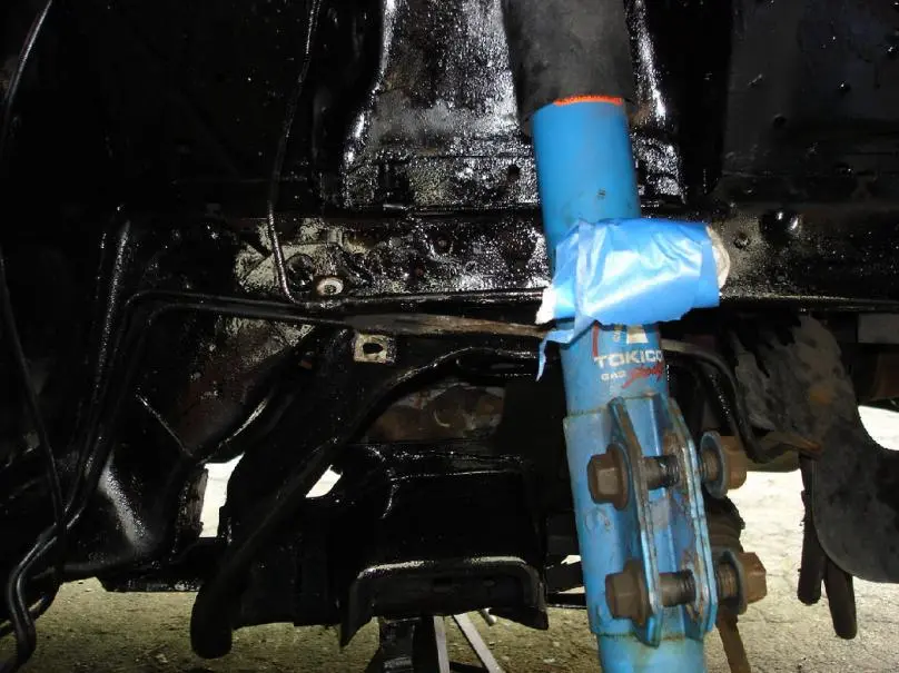

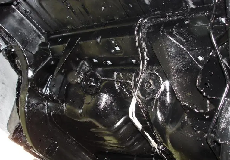

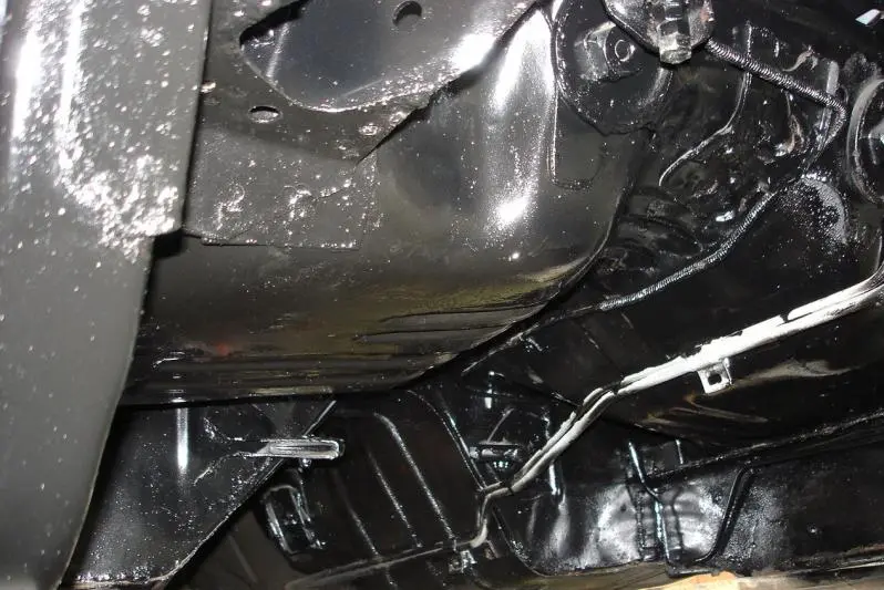

I finished with the POR-15 in the rear axle area. I did that area, where the mufflers were and as far up into the driveshaft tunnel as i could go because the AOD is still in place. I need to drop the AOD, degrease the hell out of the trans tunnel and then i can finish POR=15 on the underside.
I also yanked the front fender liners out and did the POR-15 in the front wells as well. I didn't snag any pics of it however.
Next up is remove the AOD, and remove the fuel lines since i have replacement lines for those. Anyone remember what size A/C disconnect tool i need for the fuel lines up front??
Downside is my engine. I really need to take the engine out and give it the same treatment as i did the rear end. brackets are rusty, it needs degreasing, and the bay needs to be cleaned up well. Unfortunately i can't pull the engine out at this time, so it will have to stay as is for now.
I'll get to it eventually.

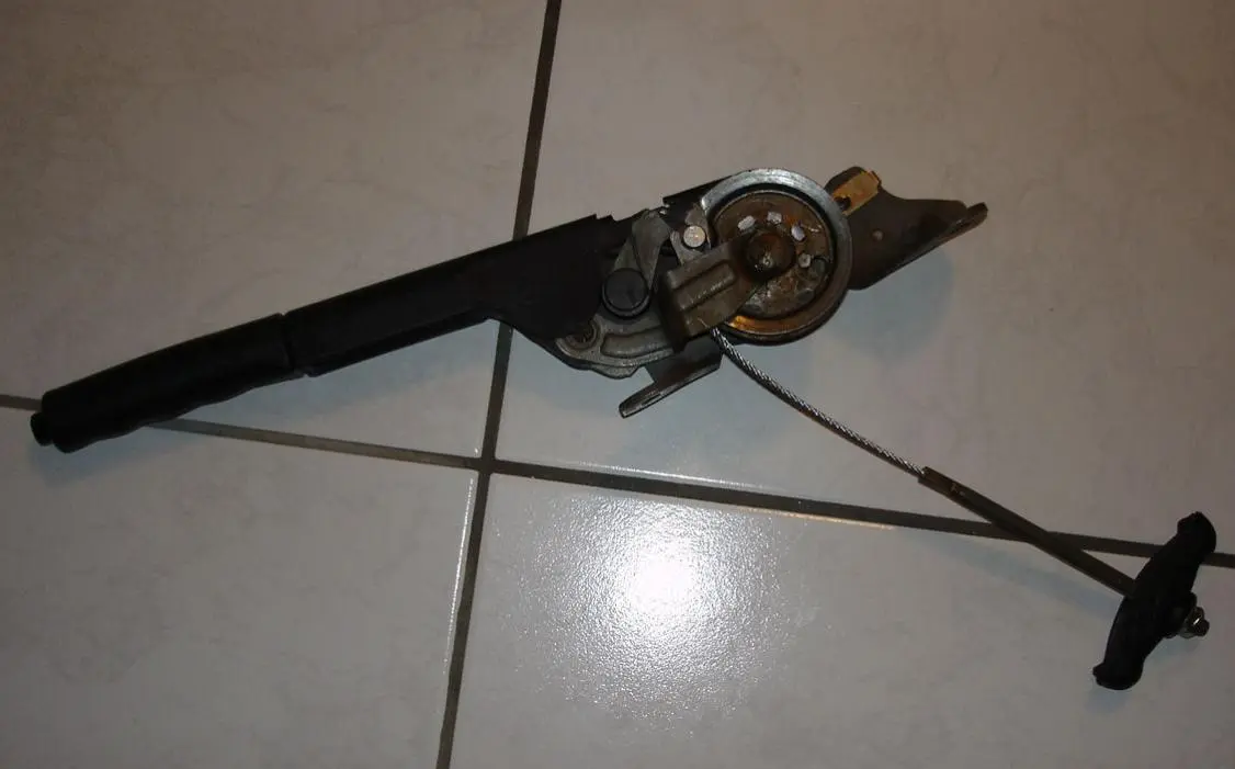

Ordered my E-brake cables. I took the handle to work and cut the spring and welded up the pawl and installed the Ford Racing adjustable cable. Also i got the two cables that run out the calipers

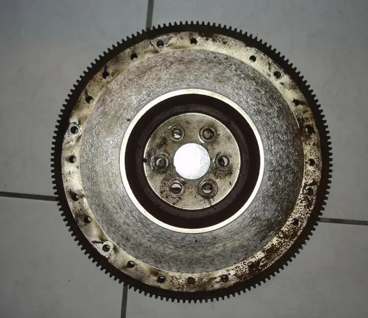

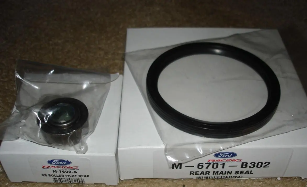

Got myself a new pilot bearing and rear main seal.
Also a friend gave me his flywheel out of his '94 GT. I figure i'd go resurface it and see if it's in good enough shape to use.

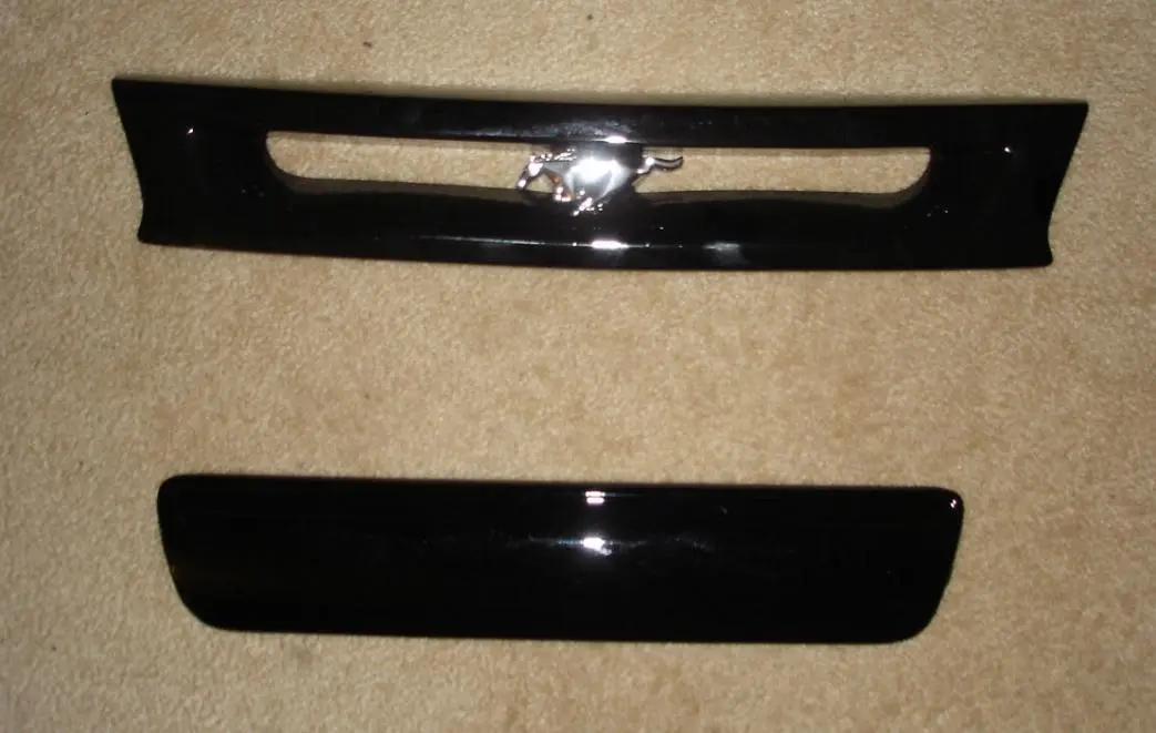

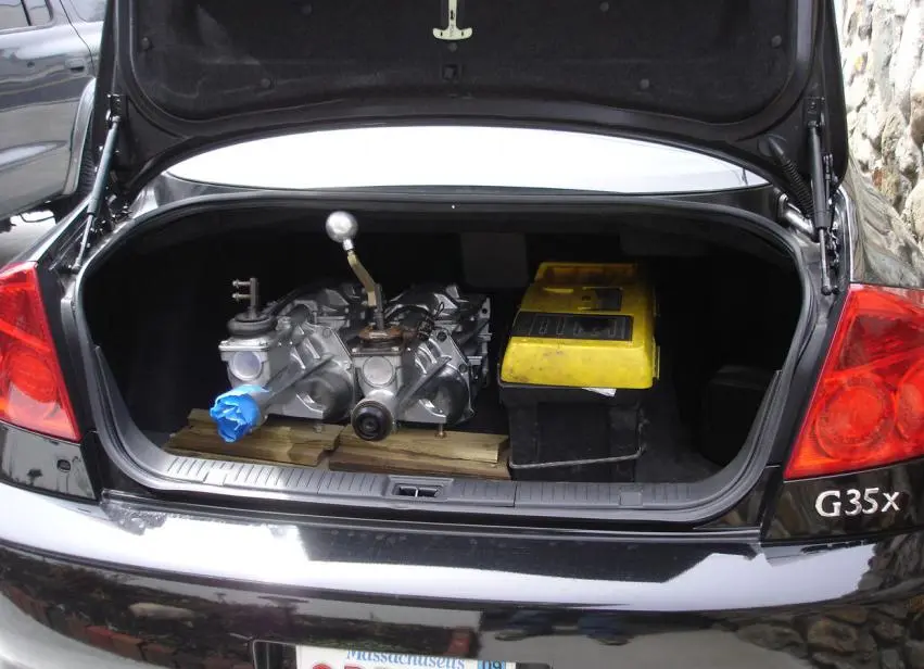

Transporting the rebuilt T-5's to the car where one of them will be getting installed soon hopefully. I've got all of next week off of work so i' getting everything ready for an install orgy
Also, buddy of mine painted up my Cobra grill insert and front Saleen molding for me

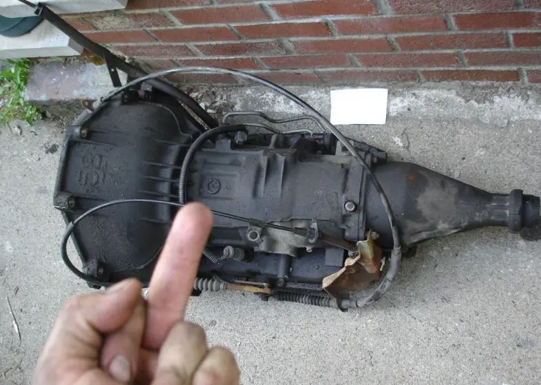

Suck it AOD!!
It actually came out pretty easy. I was surprised. I did it all alone with just me and a normal floor jack. 2 hours and it was out
I'm glad as hell i'm not putting this thing back in! It's heavy!!
I also found out it's not the original AOD. It's got 1989 engineering numbers all over it and my car is an early 1988. Guess that means it has less than 100K on it since that's what my car has.

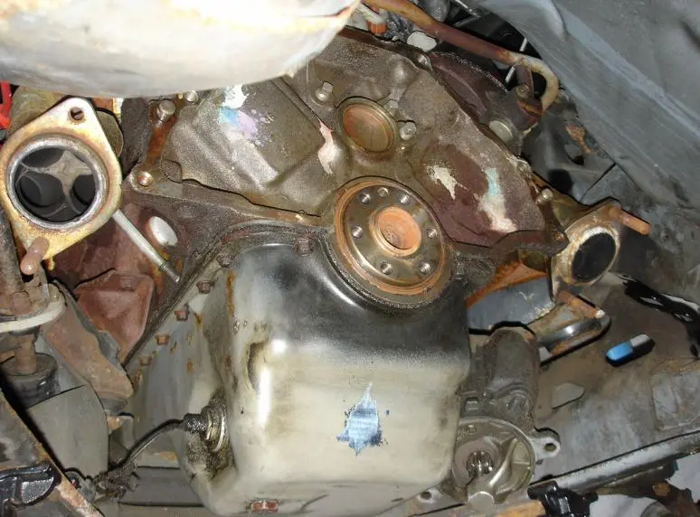

So, nothing AOD left in the car. Time for the fun stuff, putting the T-5 stuff back in. Unfortunately what's holding me up is i need to go resurface my flywheel and i need a bellhousing.
Not bad under here. The engine has leaks. The rear main was def leaking and it looks like the oil pan gasket has some seepage. I'll have to address these when i yank the motor out at a later date.
But i need to degrease the underside and POR-15 everything before i can slap the t-5 stuff in.

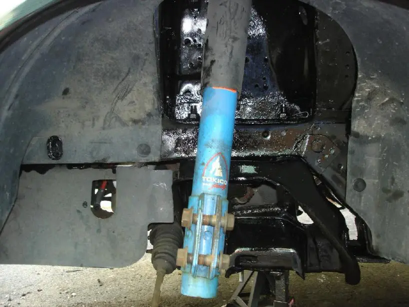

I finished POr-15 the underside today. I didn't snap pics though cuz i cleaned up and realized i forgot and didn't want to crawl under again.
I got the front wheel wells all set too. Then i ran out of POR-15 so i might pick up a small can to do the interior floorboards later.
I'm not going for a concourse style paint job underneath. I just wanted to protect everything from harsh New England conditions for as long as possible.

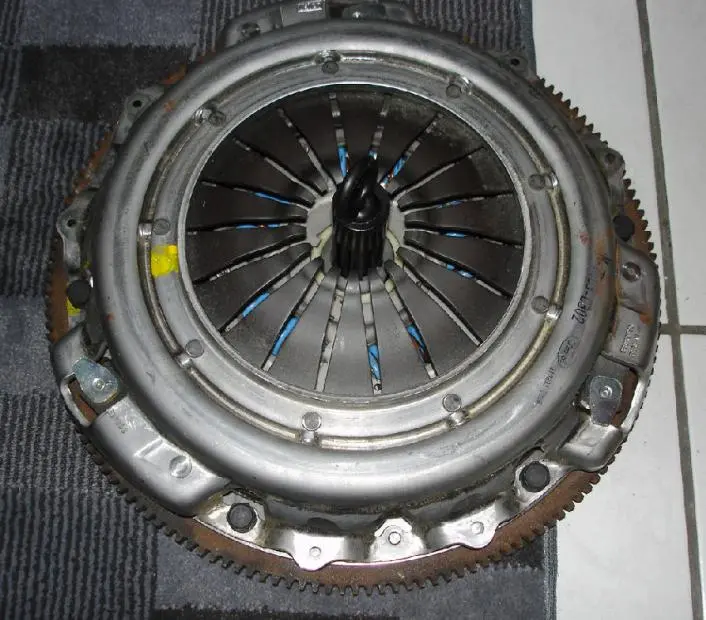

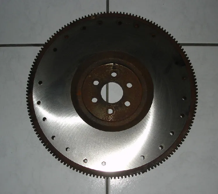

Flywheel cut. I'll be installing the pilot beating, rear main seal, flywheel and clutch tomorrow!

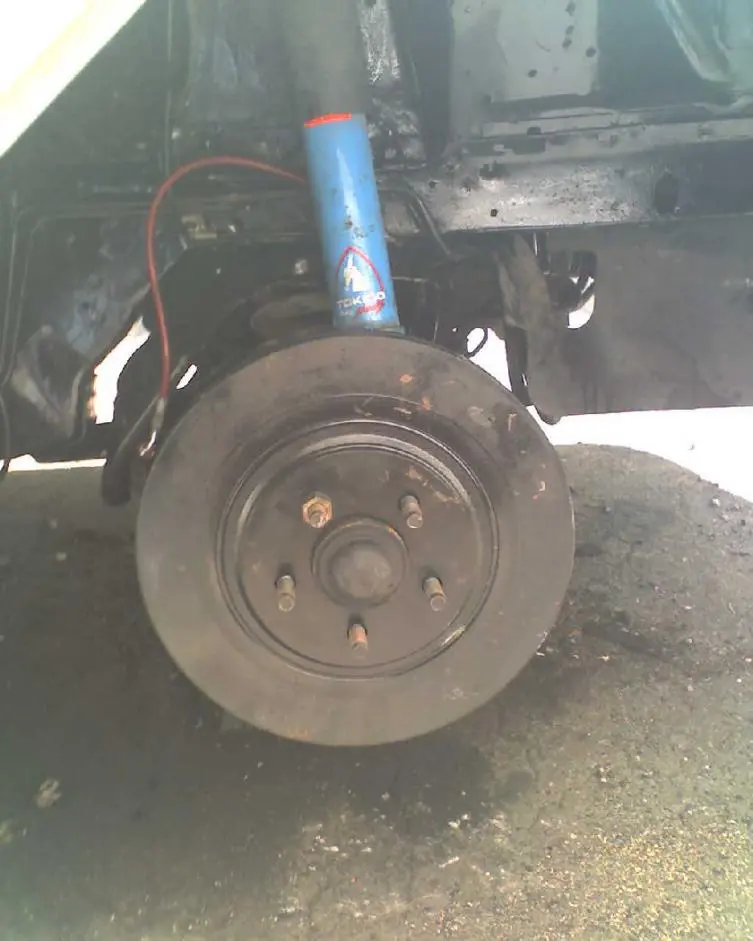

Excuse the crappy cell phone pics. I forgot my camera today. Don't know why i bother posted them they look like crap

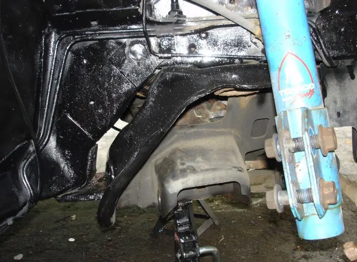

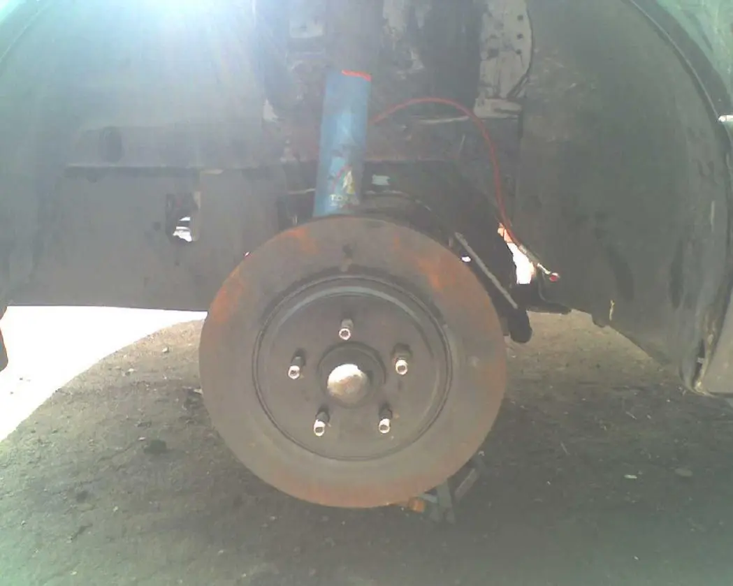

I got most of the front suspension put back together. Ford Racing A-arms, 94 spindles, Ford C springs, Tokico shocks.
These are NOT the rotors i'll be using. They are just some junk Cobra rotors a friend gave me as "roller" rotors so i don't grease up, ding or rust up my good brembo rotors yet. I'll swap them before I drive the car, so ignore the ugly black rotors.
I didn't do much today because it got too hot. 90 in Boston in April is unheard of!
