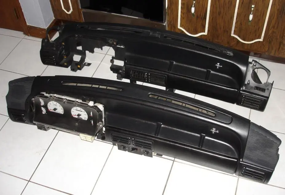

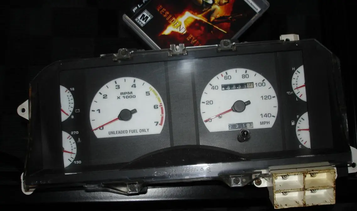

Undecided what to do with this. They are BBK white face gauges. Look good in the day but suck monkey ass at night.
However, i am not sure i'll be doing much night driving when this car is done, so maybe i'll leave alone for now.

Amazingly, i already found a buyer for some of the AOD stuff i'm taking out. I was just gonna junk it. I should sell the dash because I just discovered the flywheel I have is for a 10" clutch. I need to buy a new flywheel. Summit has them for $100 for a stock replacement. Not bad. I've been buying a lot of new parts lately so i'm trying to recoop whatever I can by selling what I take out...even if it's cheap money for stock stuff or the couple of goodies I do have and don't need anymore.

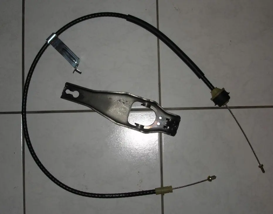

I was about to install the clutch cable I had...when it cracked!! SO i figured I wasn't a poor college kid anymore (i was in college 6 years ago when i started gather my 5-spd swap parts) so i chucked it in the trash and decided to go new.
This is where I don't understand Ford. You go buy a clutch cable and it's $100+ for a new stock cable. BUT, if you order it in the M-7553-A302 kit, it's $40 and it comes with a new Clutch Fork!!
So why not right? Now i have a new fork and can sell off the used Fork that i was going to use!

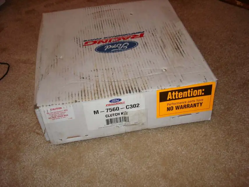

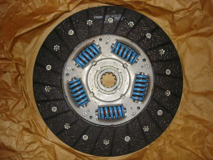

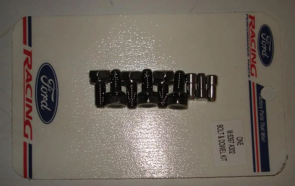

Anyway...pics of the cable kit, fork, clutch and clutch bolts.
attachment.php
attachment.php
I need a new flywheel now. I discovered the flywheel I have is an 81-85 flywheel for a 10" clutch. :( I bought it back when i was a broke college kid, so I took what I could find. Now it will sit in the junk pile along with the 83-85 T-5 bellhousing I can't use either :(
But since i'm now a young professional and have a new "F used parts" policy when it comes to things that spin rapidly and could chop off my feet, i'll be ordered a new OEM flywheel, flywheel bolts and my e-brake cables perhaps next week. :)
PS: If anyone wants an 81-85 flywheel, 83-85 bellhousing or 86-95 used clutch fork...PM me.

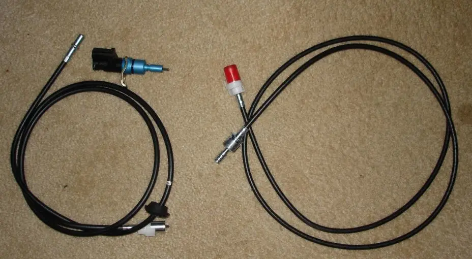

Got my new speedo cable. I didn't want to use my original for reasons of which you'll see in later pics when i yank it out this weekend.
I wasn't sure which to get. My car does not have cruise control and is speed density. To convert to Mass Air, I found out it's highly recommended i install a VSS. So the cable on the left and the VSS are what is going in.
I ordered the cable on the right before i knew I needed to put the VSS in, so i might send it back...or just might hang onto it. Was only $20.
