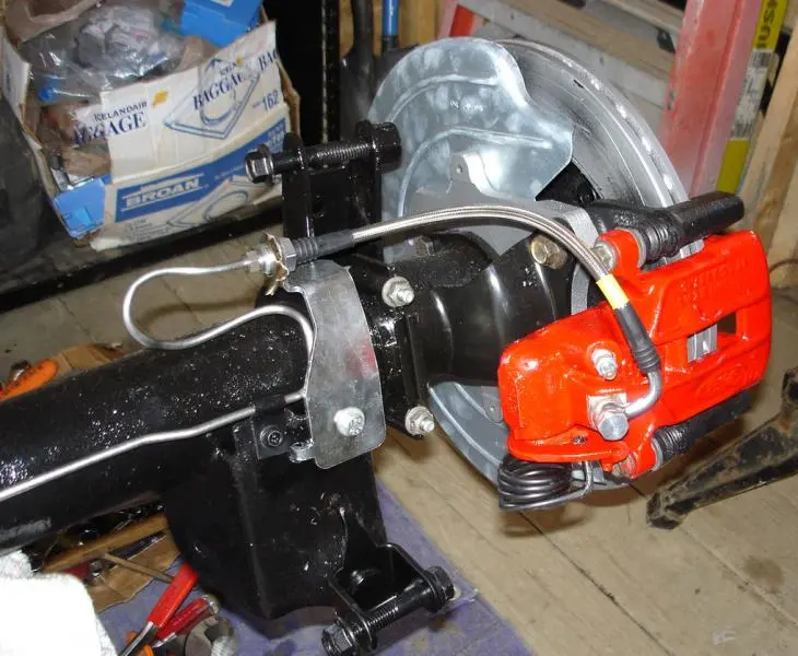

Shot of the caliper, Max Motorsports Stainless line and bracket and how i had to route the brake line.
It sucks. I am losing sleep over this. I do a quality job on the rear and then hack the lines like this??
Plus i think the outer bumpers will hit
Gonna rent a double flare tool this weekend and cut and reflare it so it goes in cleaner. :nice:

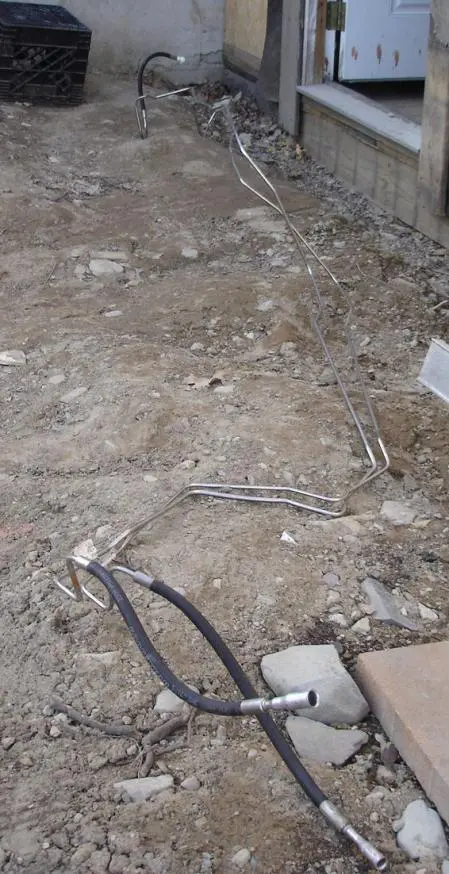

More parts too. Buddy gave me BRAND NEW SS fuel lines. I'm gonna install these after i strip everything off the bottom of the car and POR-15 it!

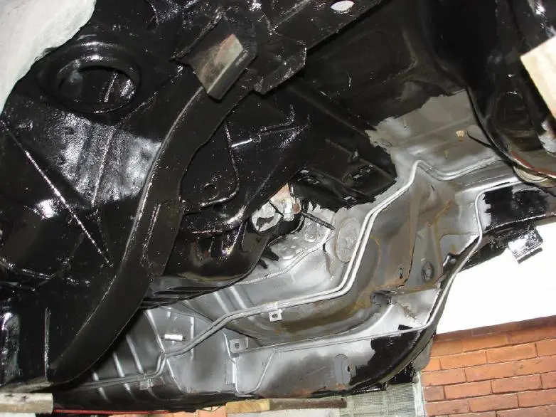

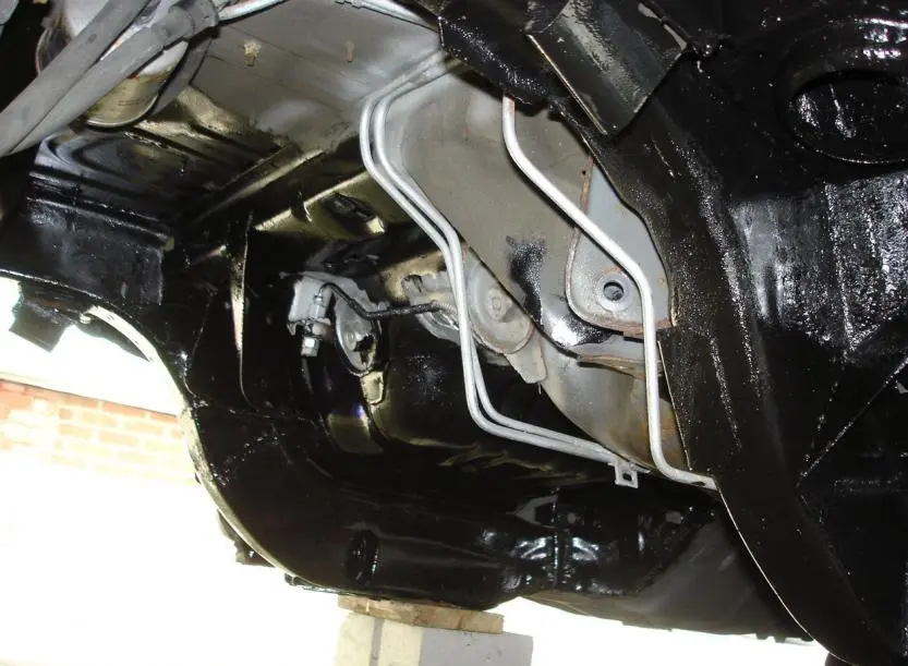

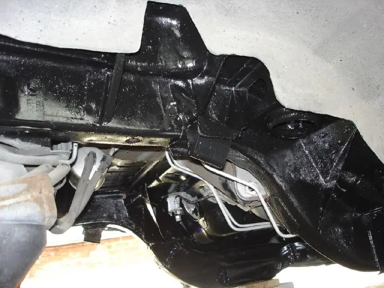

Started POR-15 the underside of the car. I didn't quite finish though as i wanted to remove the fuel filter and lines since I have new lines. One more day and the rear area of the car will be complete.
Notice barely any rust on the unpainted areas?? It;s amazing since this is a 21-year old New England car!

I plan on painting in sections. I'm just doing the rear axle/muffler area for now. Next i'll do the transmission area and floor pans. At the end, i'll drop the gas tank and do all under there AND the gas tank.

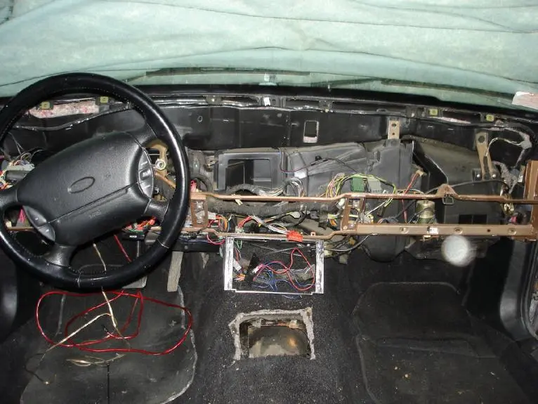

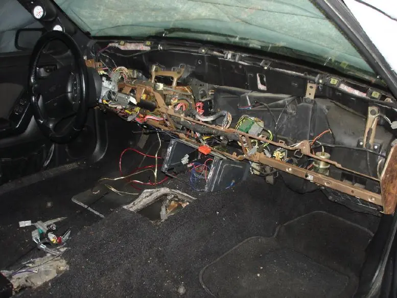

I also gutted the interior. I figure this will be easier to swap the pedal assembly, run the clutch cable and reroute the speedo cable. Plus i got a new dash to replace the one that was in there. The new one is in MUCH better shape. See post #223 on page 6.

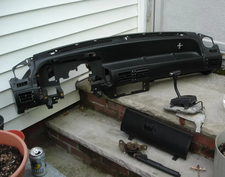

Here's the old dash I yanked out. It's in decent shape, but a couple tabs are broken which is why i am replacing it. See where the gauge console bolts up?? See the two two tabs? They are busted and i could never tighten my gauge cluster pod all the way and that ANNOYS me :D
Unsure what i'll do with this dash. I might sell it, i might hang onto it for a while.
I also ditched the AOD shifter. 5-spd here I come!!

For now i'm gonna hold the dash. Never know if i need to put it in temporarily. I don't want to put the new one in til everything is done since it's virtually brand new. I plan on doing a complete interior resto with dynamat and the whole shabang

I think mine will be 10X easier because i have no exhaust or rear axle in place. I want to remove the stock lines, POR-15 over the area where the lines run and then install the brand new lines. That way i don't have to remove them to paint when i move up to the trans area and inner front fenders.

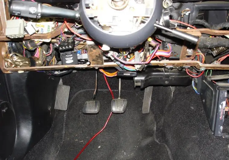

I decided to go inside the car today and hang the 5-spd pedals. Lemme say even with the dash off, the seats out, the steering wheel off and the column dropped....WHAT A PITA!!!
I had the whole interior stripped and it took me 4 hours!!!
It was easy to unbolt, but wiggling the AOD pedals out was a PITA and then snaking the 5-spd pedals in was even harder!
Eventually I got them in! Then i had to spend 45 mins searching for the damn clutch safety switch wiring so i could plug them in.
But all done. Was gonna route the clutch cable but the one i had is used and looks questionable so i chucked it in the trash. I need to order a new cable, manual trans speedo cable and a VSS sensor (my car doesn't have one since no CC and i need it for the MAF conversion)
