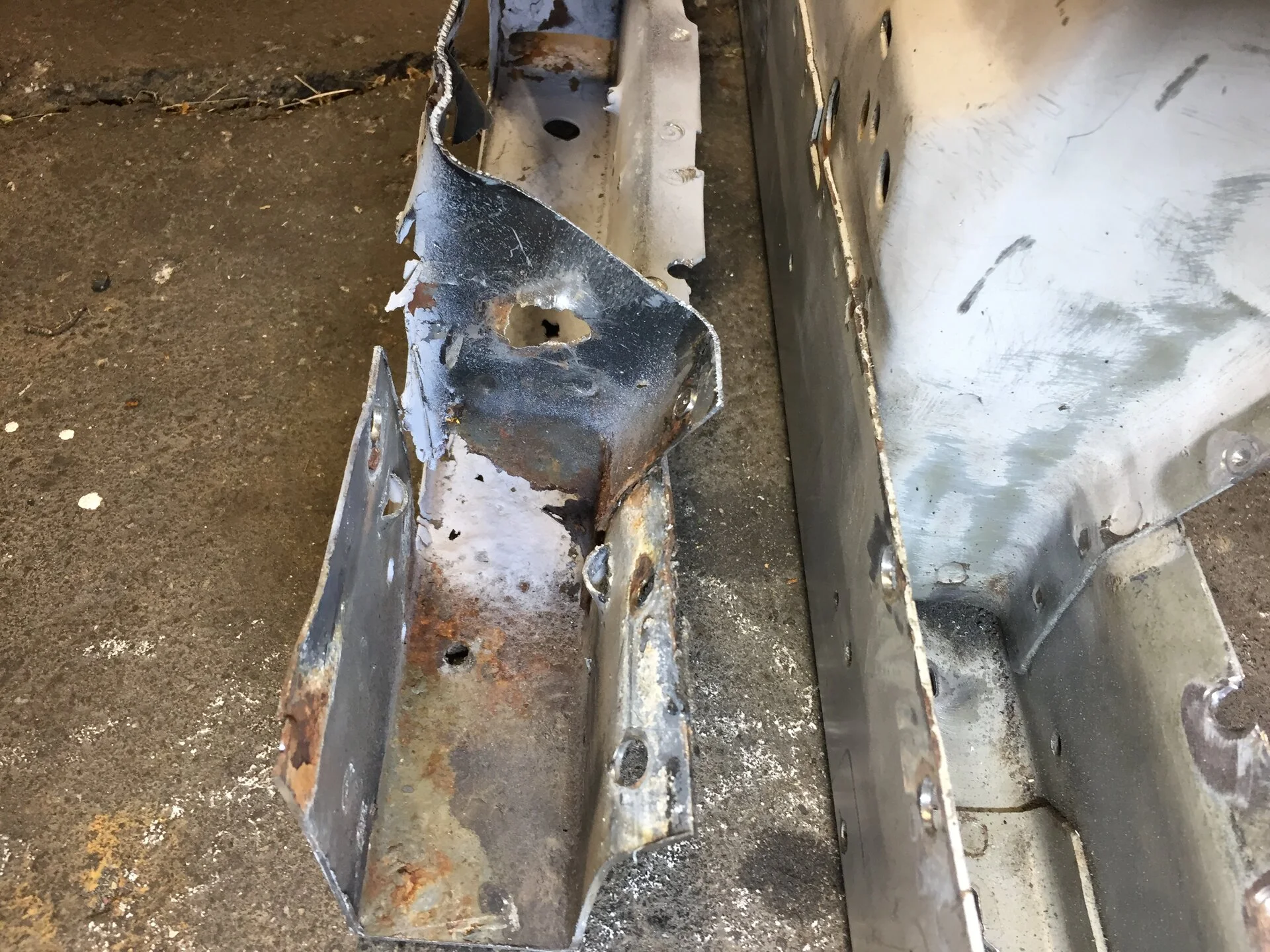

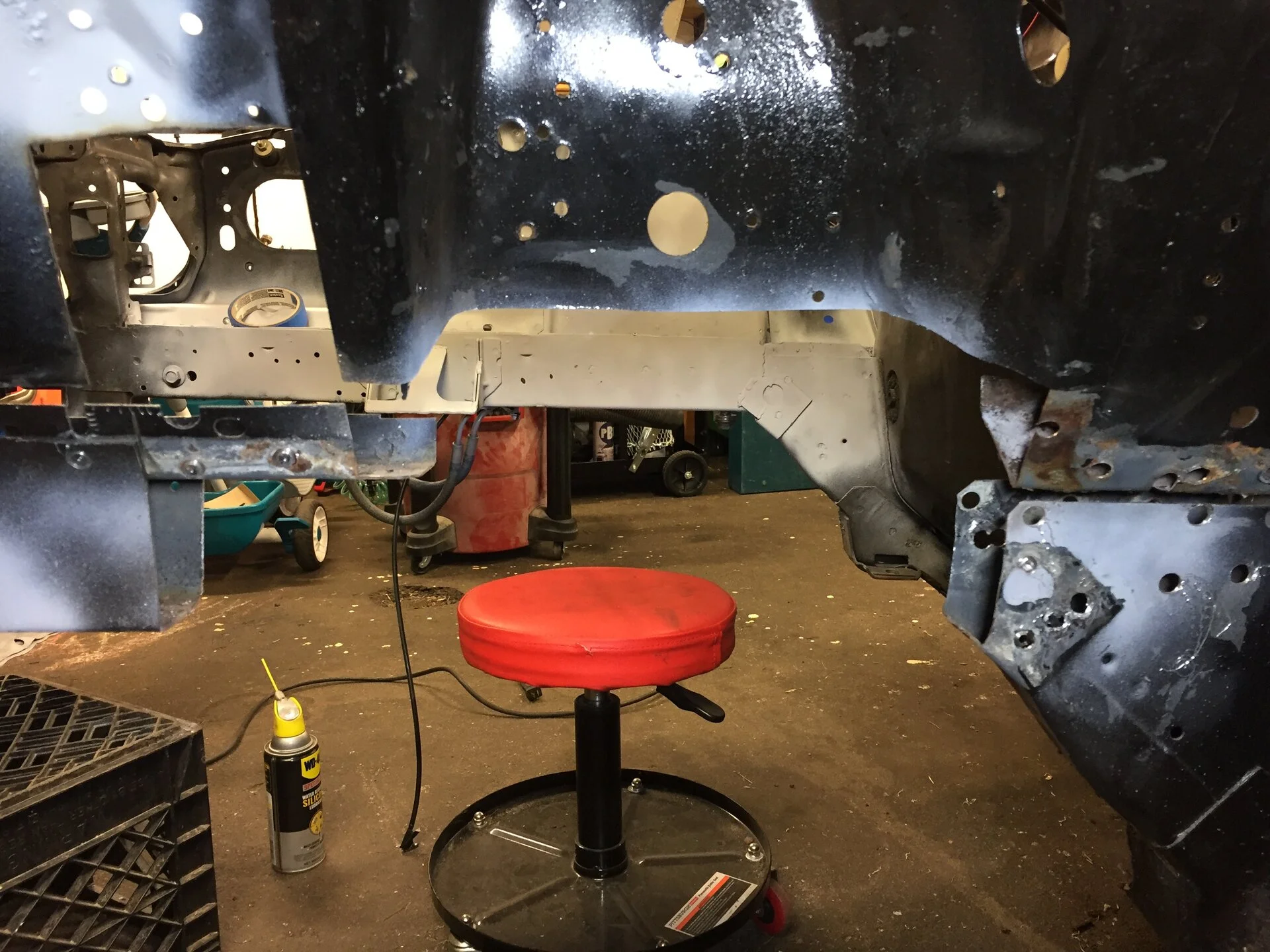

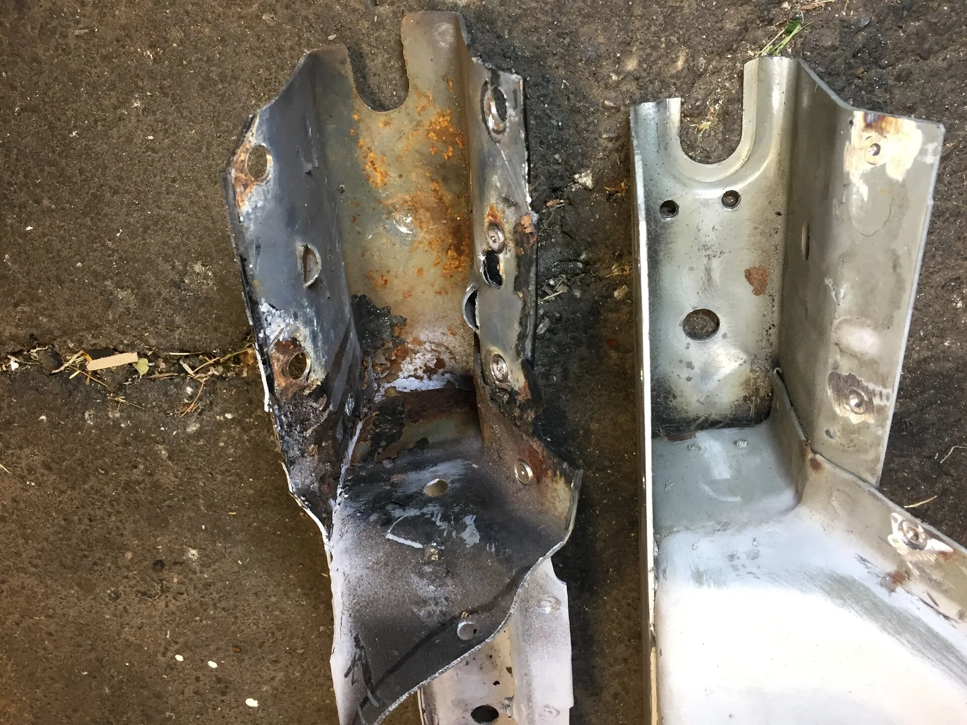

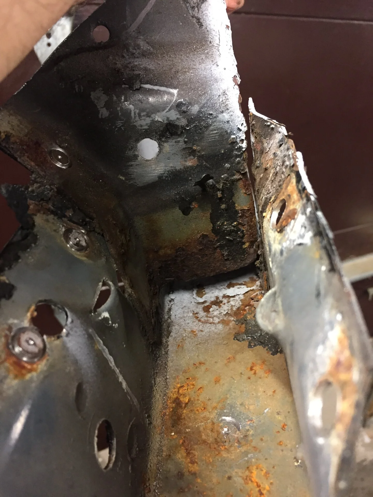

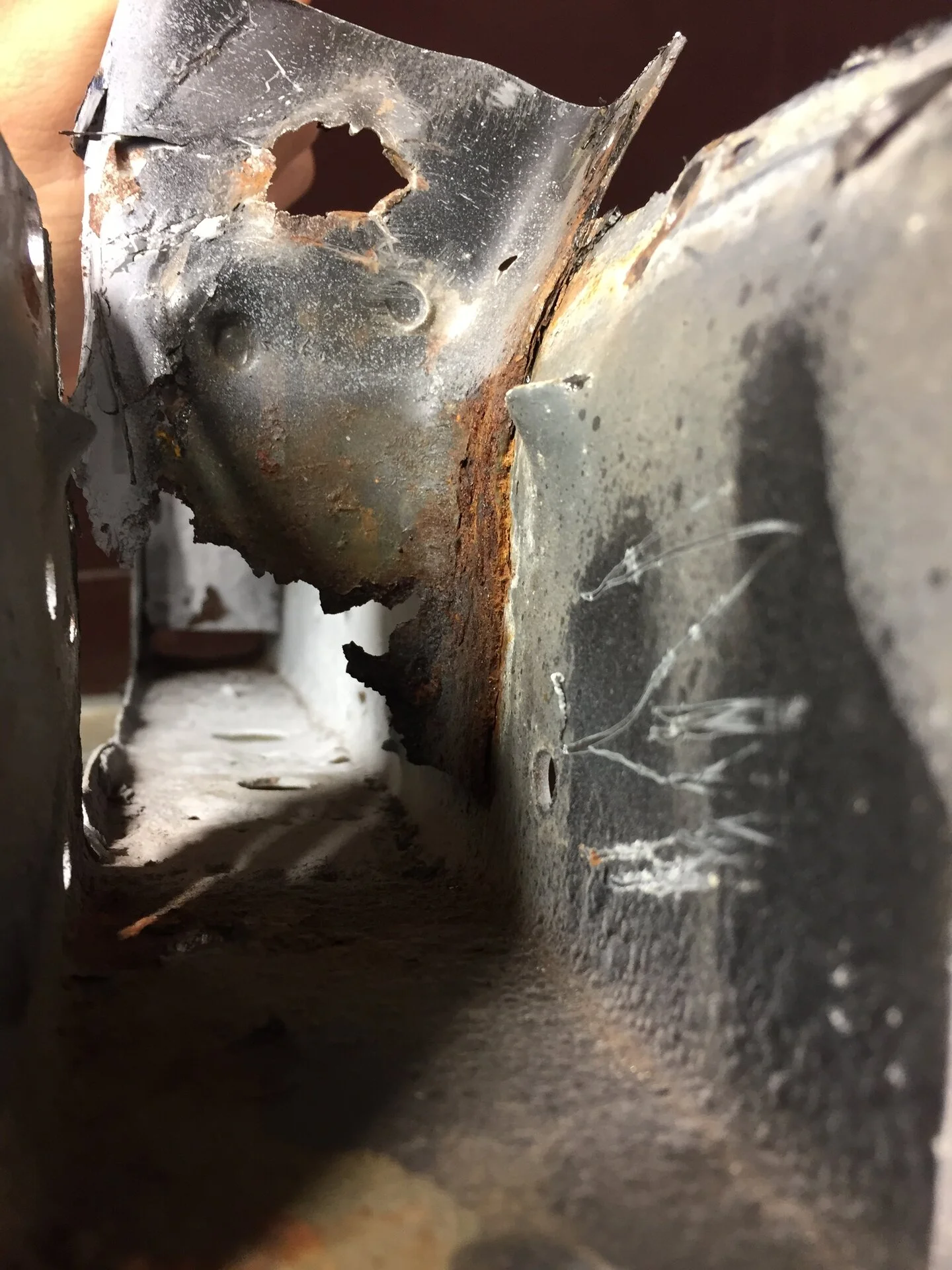

Good news is the crust stops right at the strut tower area.
Bad news is it was starting to rust though to the outer rail in the strut tower area. So I chose to use the donor part
Strut tower was rusted on the outside as well. I couldn’t get to it.

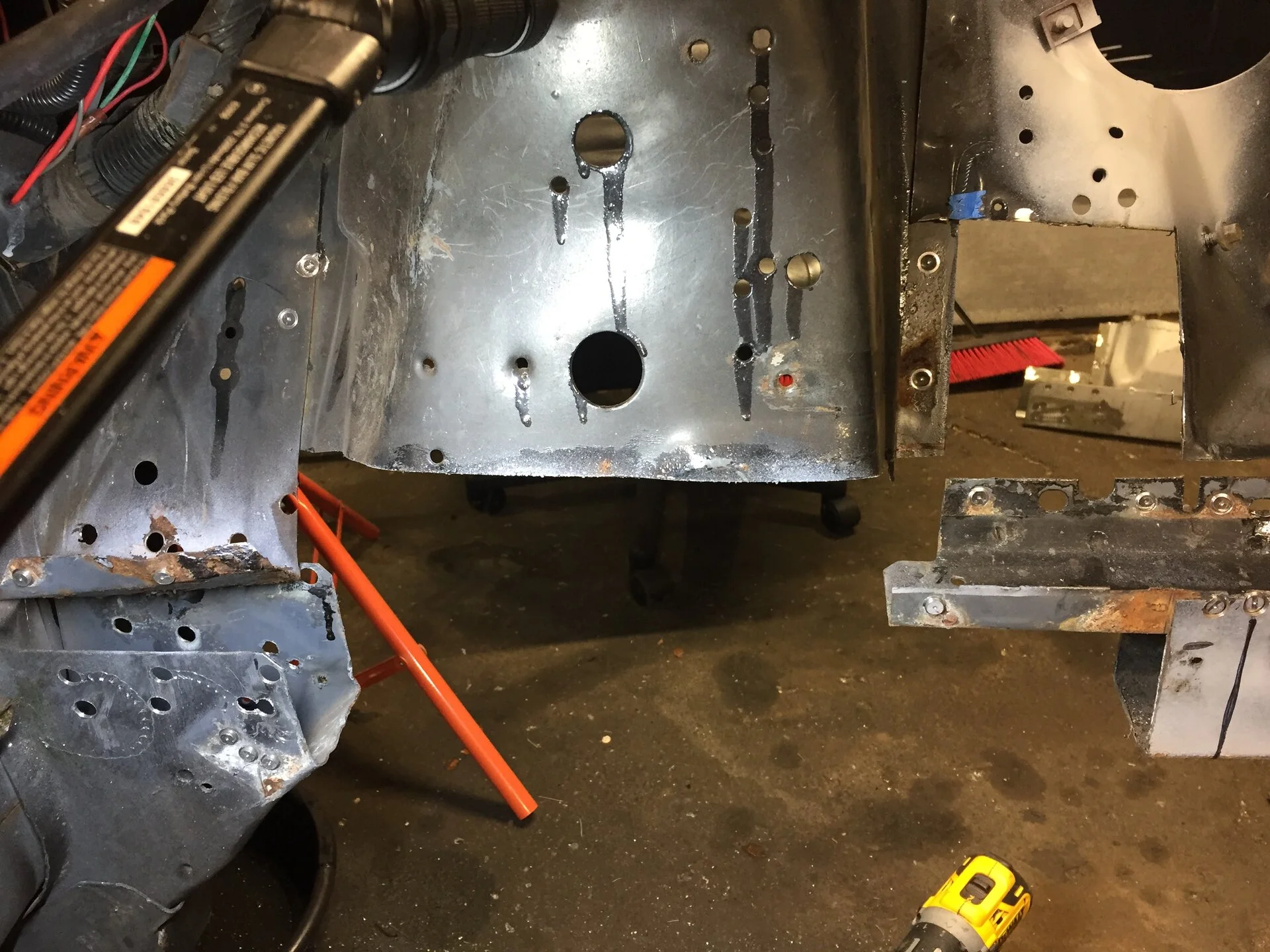

Anyway. Time to start trimming the donor piece to shape. I need a small cutoff wheel to trim the top cap and rear apron out of the way. Then I need to cut the rail in the car square right in the middle of the sway bar mount. The plan is to make in inner sleeve to plug weld in place, but weld the rail, and then spot weld the sway bar mount and MM sway bar reinfornebt in place. Should make it strong. I may also do a staggered butt weld on the rail

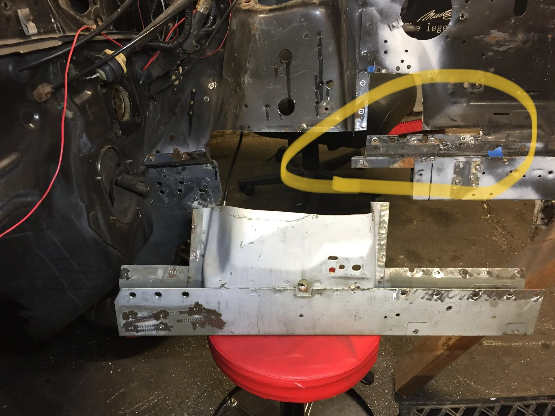

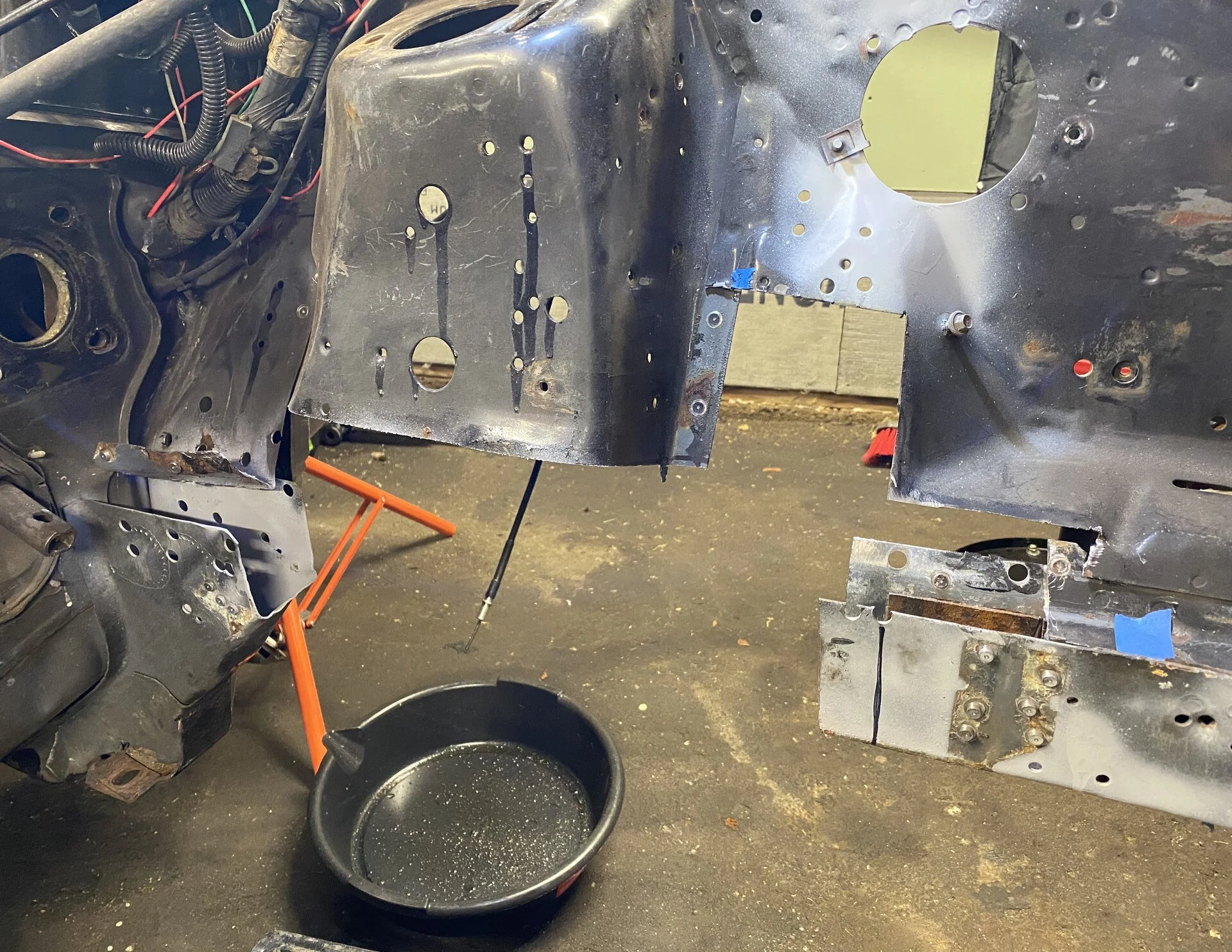

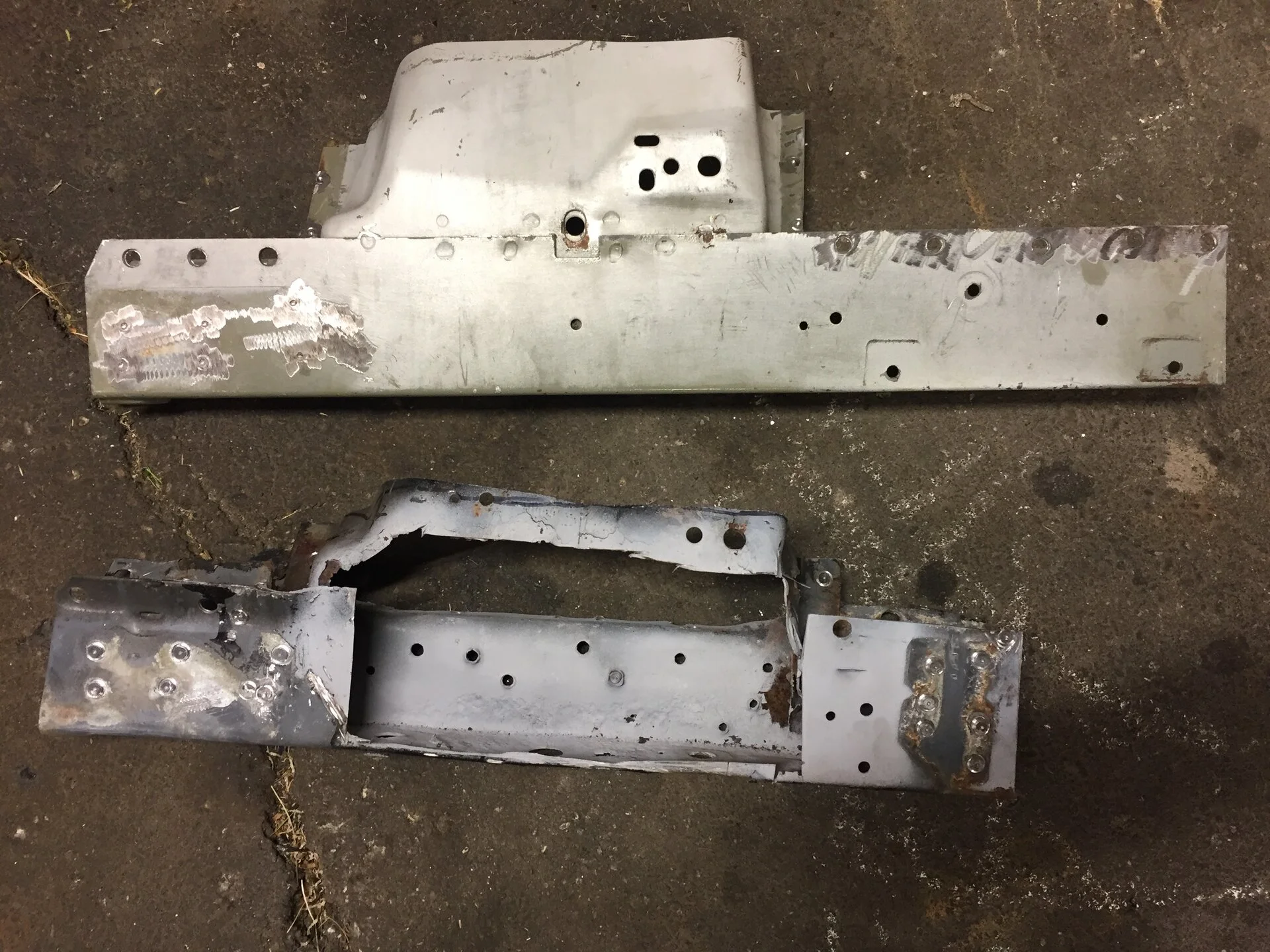

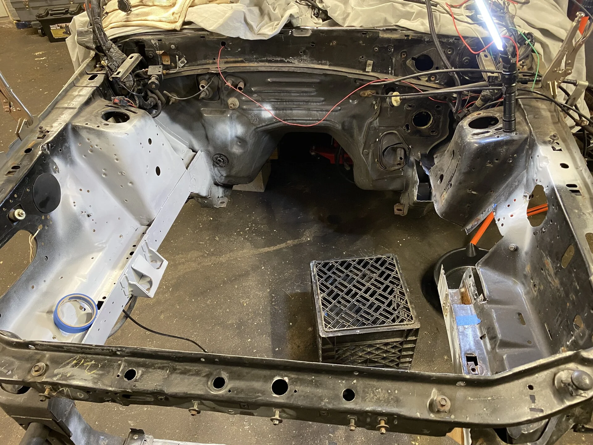

None right now. Before I can start trimming it in, I need to remove the rail top cap. I've got the metal for my inner sleeve. I need to trim it to shape, and bend it in the brake I have at work. I'm basically making two L-shapped brackets to plug weld in on both sides, and then finish off with a butt weld of the original rail. That's the plan at lease. My final cut should be where the black sharpie mark is on the rail. Then the sway bar mount will be additional reinforcement.
I neeed to trim it at the blue tape. It’s a U shape so I need a small cutoff to get in there. That’s all that it holding me up right now. Searching for something I can use. I have an air powered cutoff with 2” disk but my compressor isn’t big enough to run it continuously.
I also need to trim the rear apron back slightly, but thinking about where i want to make my cut as the brake booster reinforcement box slightly interferes.
I also need to cut the spot welds on the SN95 sway bar mount plate inside the donor rail and remove it. There's a pair of holes on the bottom that I want to fill.
I should have some time this weekend to sit and stare at it and make some progress. This is purposely going to be slow as I want to do this correctly and have it look professionally done. Way I see it...I have one shot at this.
At some point i'll go back and clean up the banter. This 180 page (with my settings) thread could probably be shortened to 100 pages.

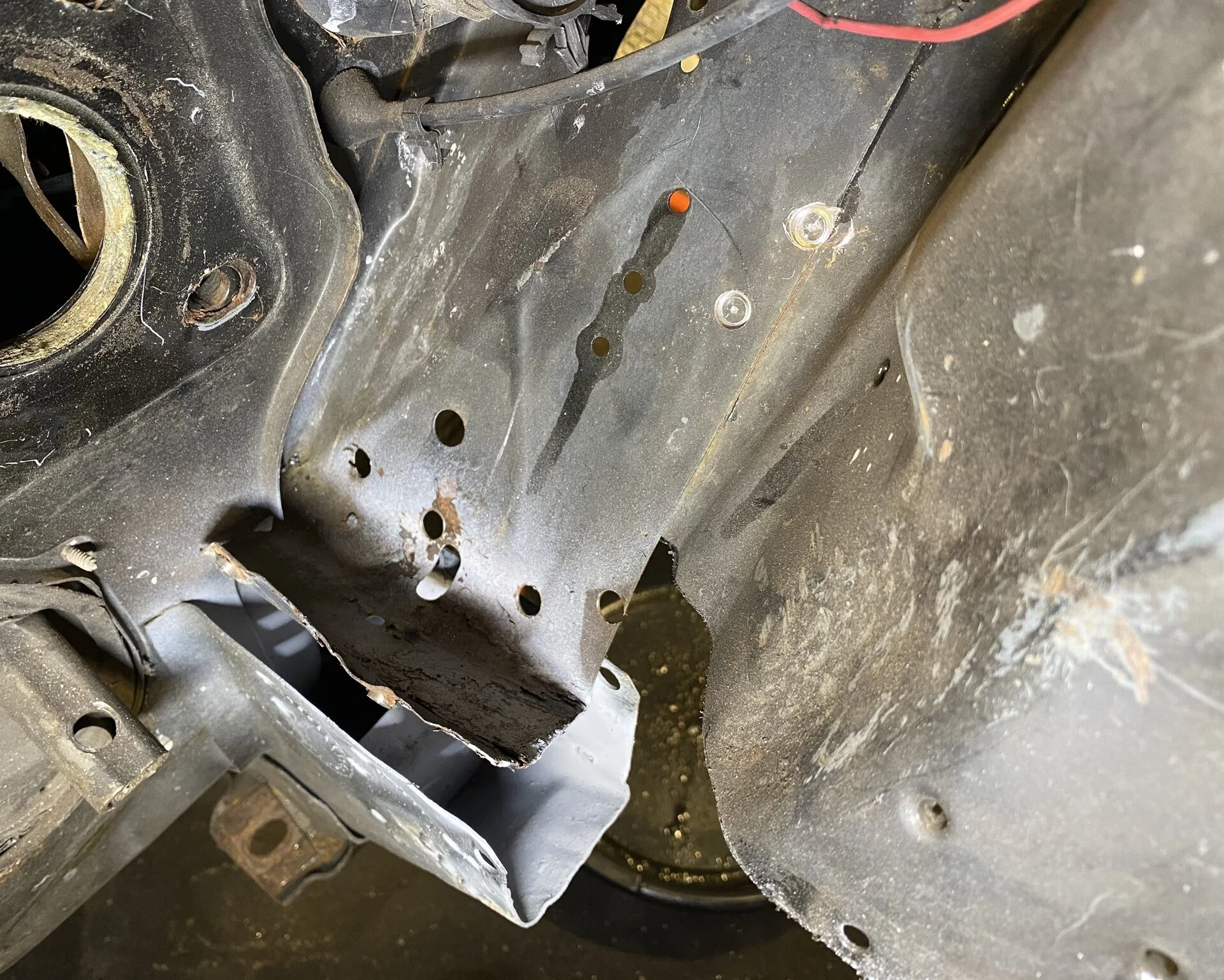

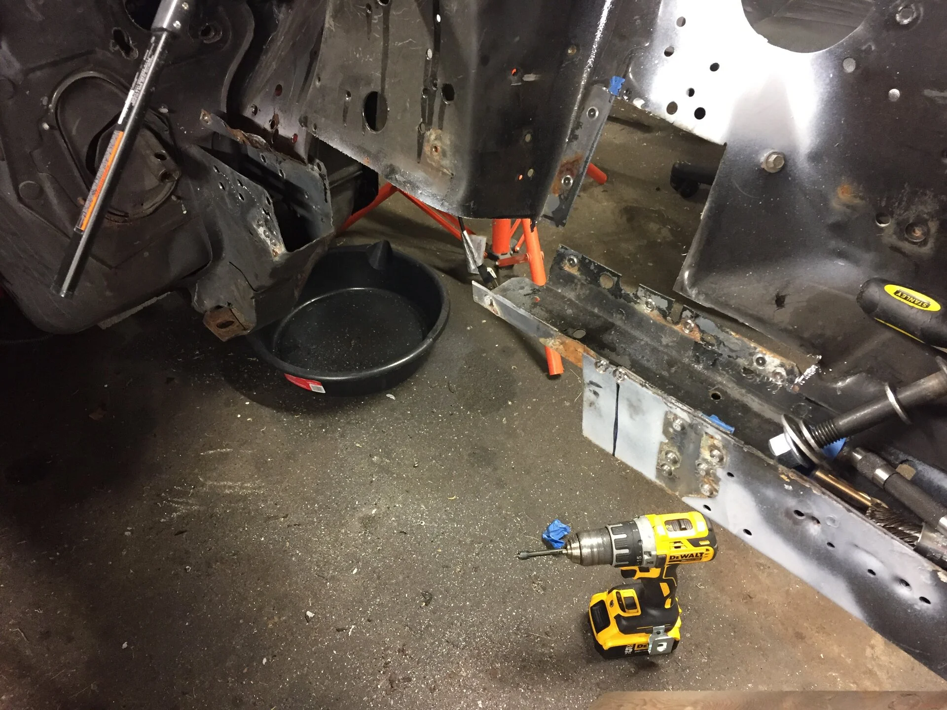

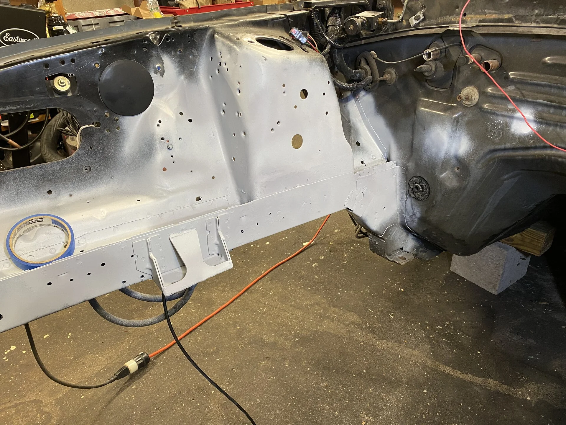

Ok, top cap removed. Now I just need to carefully trim out the rear apron and im ready to start fitting the donor piece in.

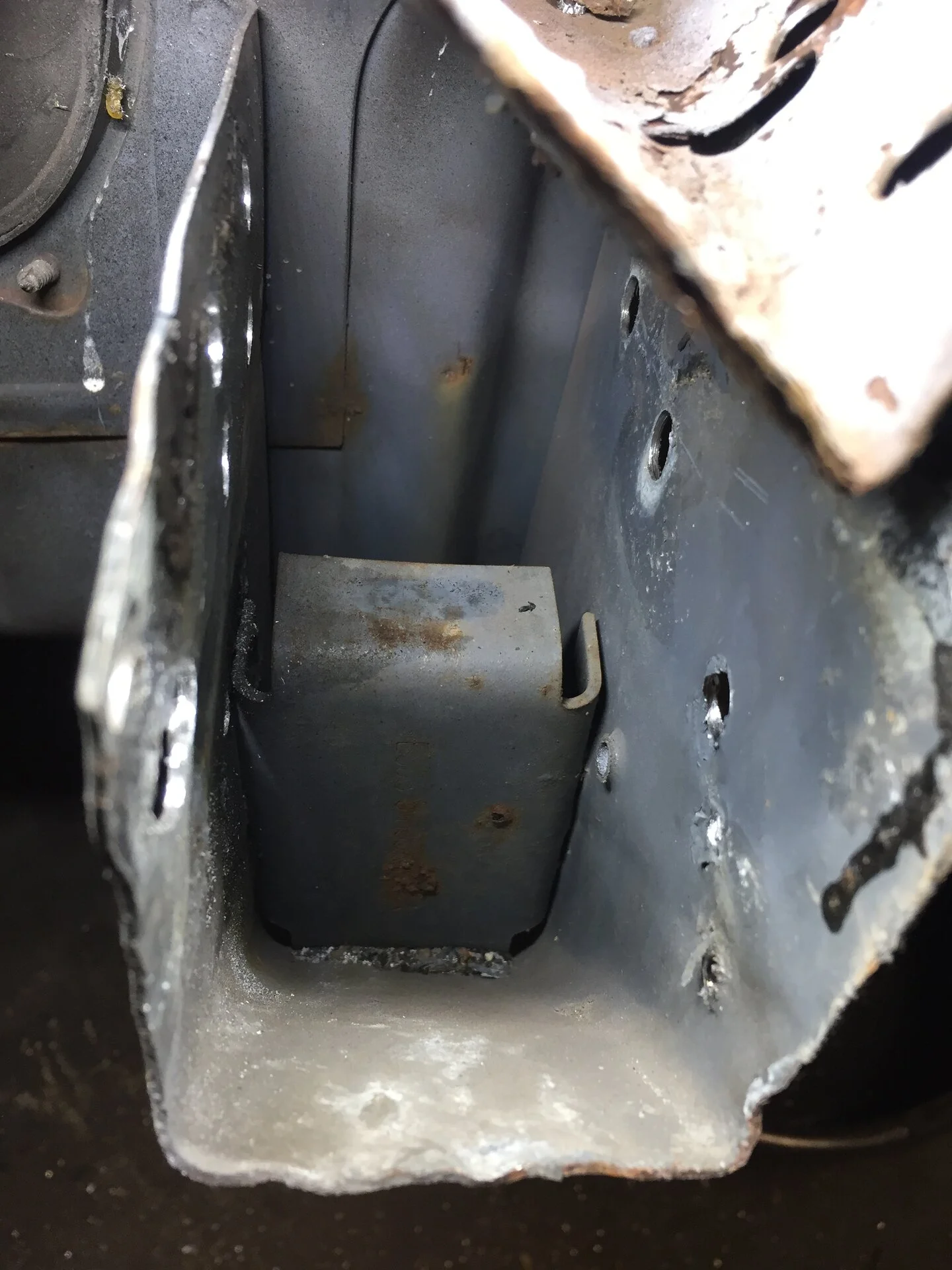

You can see in the rail that inside, there is a reinforcement plate for the front tow strap tie down point. This may interfere with my sleeve so I need to think about how I want to section that part. I may have to have my butt splice up about 1" towards the firewall than originally intended to sleeve around that. I def need to think this all out before cutting the rails to final shape.
Now to trim out the rear apron. I need to cut it up near the two cut out spot welds. As you can see, the brake booster reinforcement plate makes things tight on the inside. I need to carefully cut it out somehow so it can easily be rewelded later.
Also, I just upgraded from an iPhone 6 to an iPhone Pro. Difference in picture quality is absolutely amazing. You think?
Can't wait til the driver's side looks as good as the pass side does.
