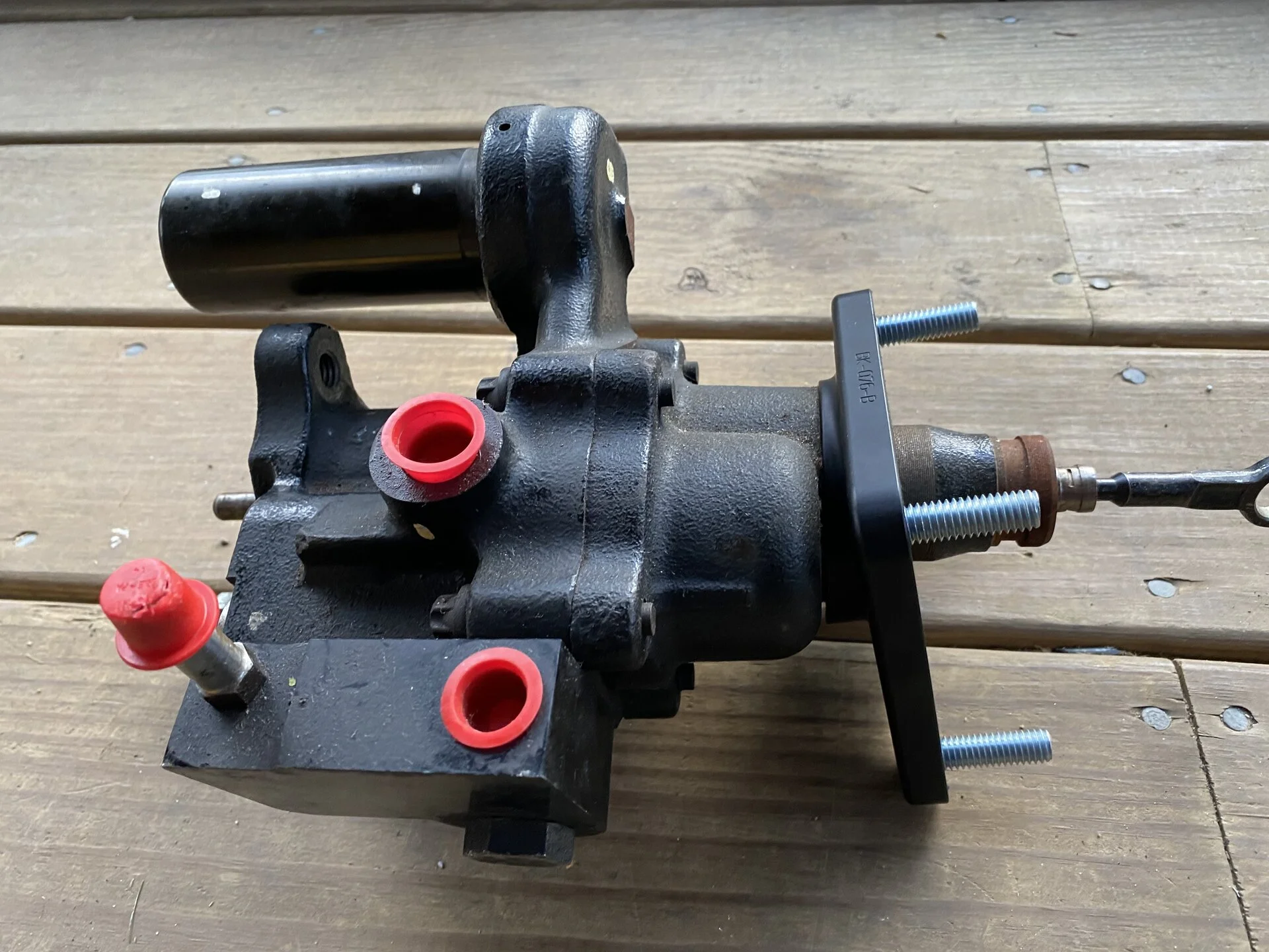

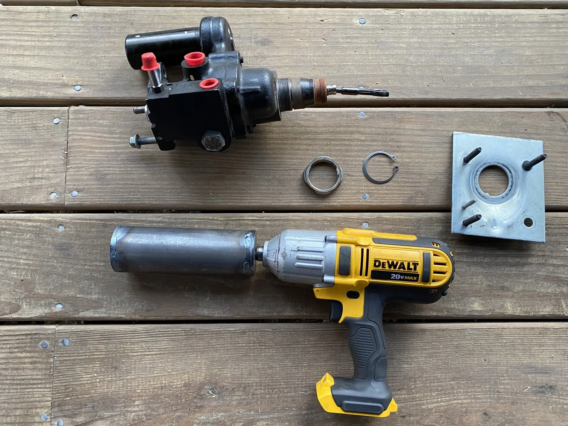

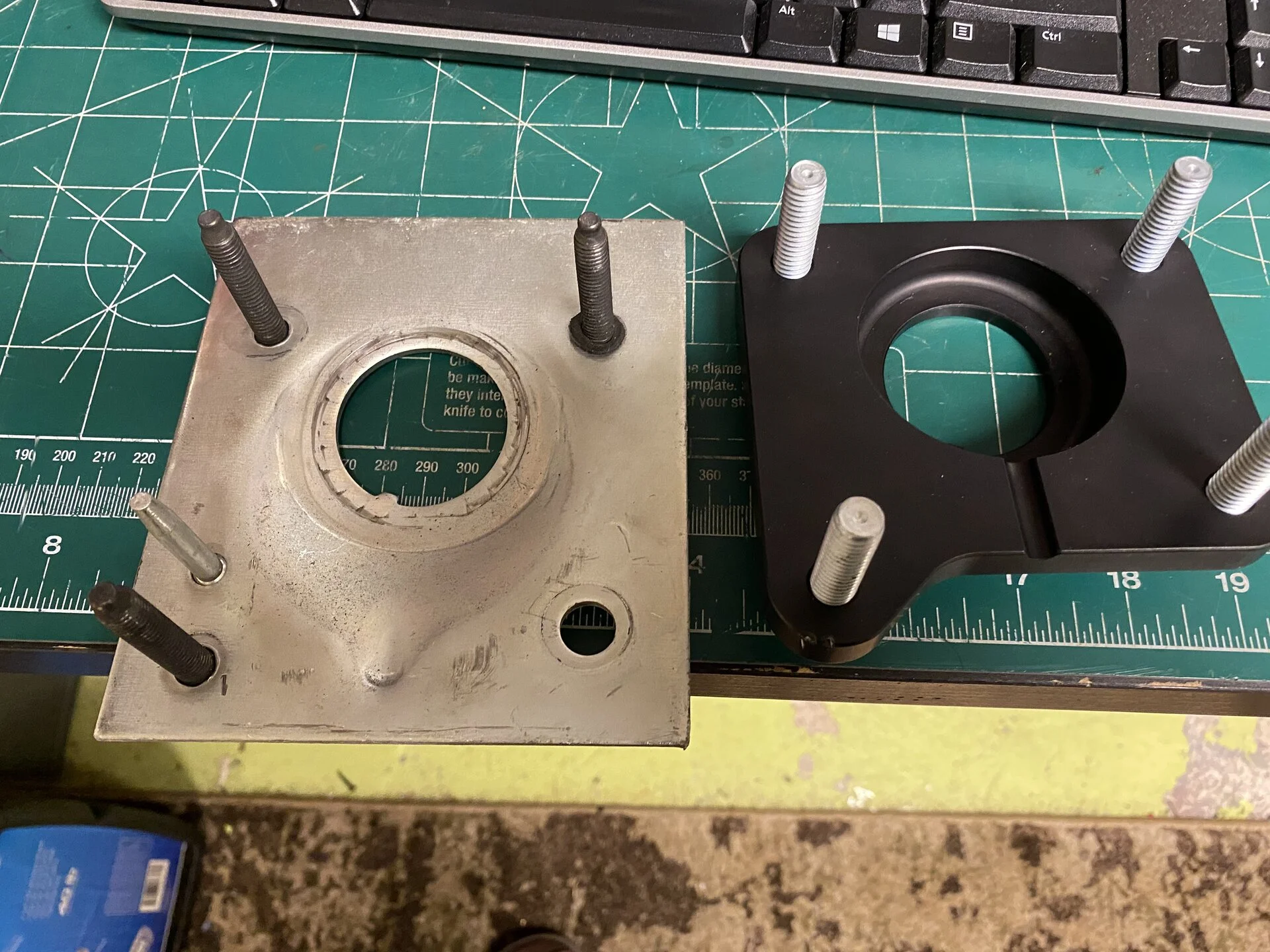

Deciddd to play around a bit with it. MM supplies the socket to get the nut off. I used an impact and after removing the snap ring, it zips right off.
difference in the oe mounting plate and the MM plate
mocked up. Not torqued just yet.

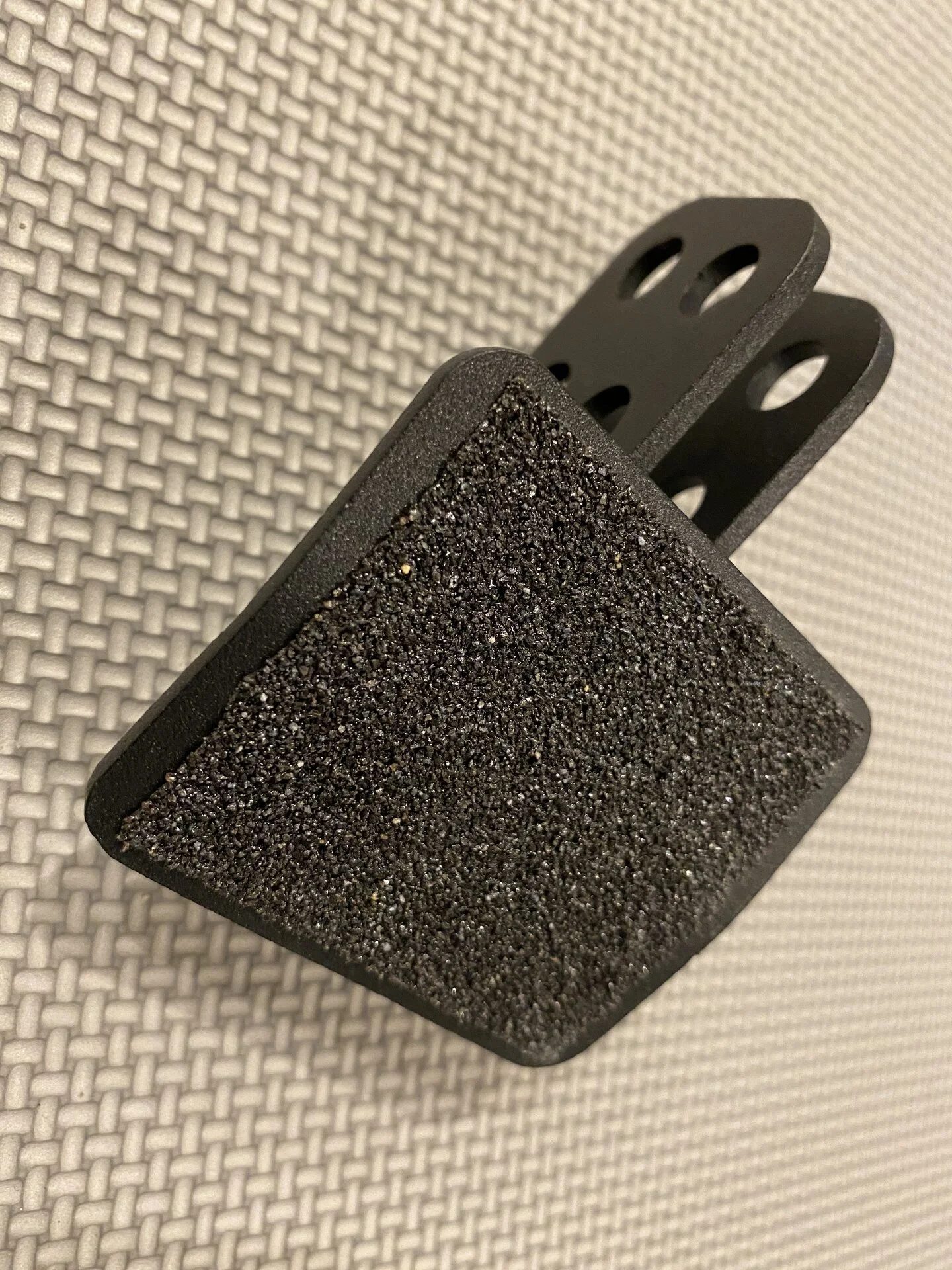

well, LMR indicated I might be waiting a while for my pedal. Looks like MM has a huge backlog due to people working/staying at home and ordering stuff. I also got the impression LMR needed to "buy" the pedal from MM, which seems unfair because the box I received was a redirected MM package, so it left the factory without the pedal pad. Good thing car isn't going anywhere, but I wanted to start to play with it to see if I can get the Bullitt style pedals mounted.
Anyway, given the backlog, I went ahead and ordered a bunch of MM stuff from LMR that I will need this fall. I figure i'd rather have it in hand, vs potentially waiting a month or so. Just browsing around, their K-member kits are not due in stock until Sept according to LMR's site.

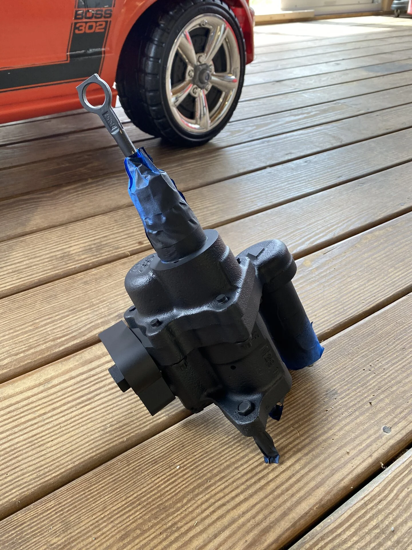

Anyway, i'm degreasing, taping off, and painting the hydroboost. Then I will assemble is and do a test fit perhaps. My priority this weekend is to finish prep of the frame rail, and get that welded in. I took Mon off to accomplish this and will use some time on the weekend to complete prep. I need to adjust the tower fitup a bit to get it tighter for welding, and drill some prep holes to spot-weld my frame splice tube ahead of the tower. Another hour or so, plus a quick sand down to bare metal and i'm ready to weld it in.

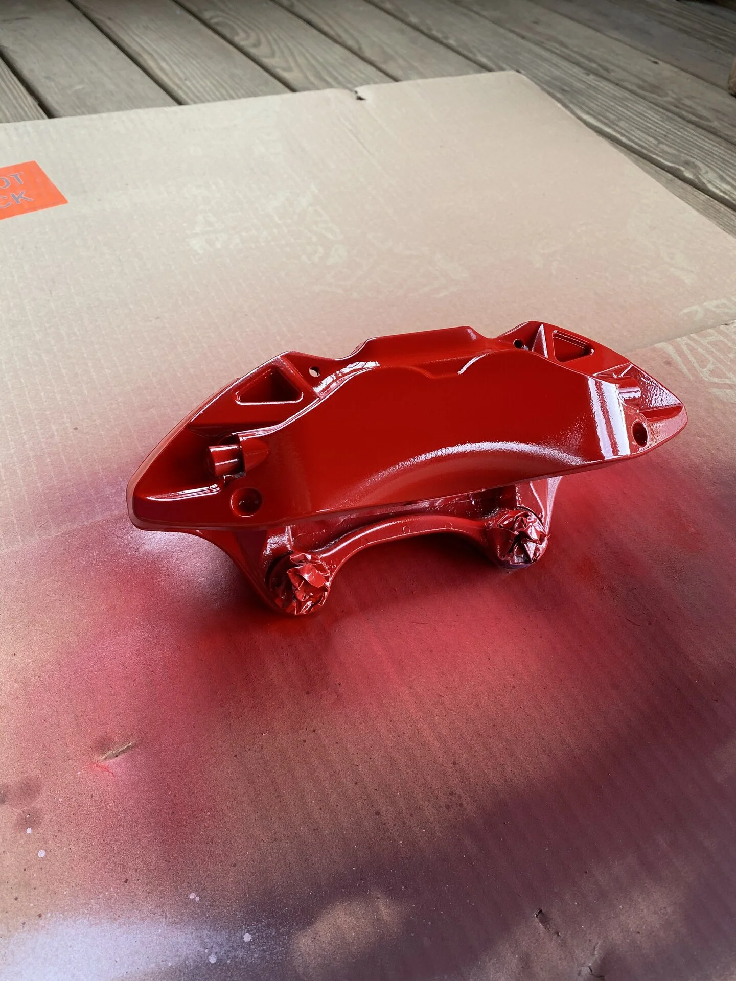

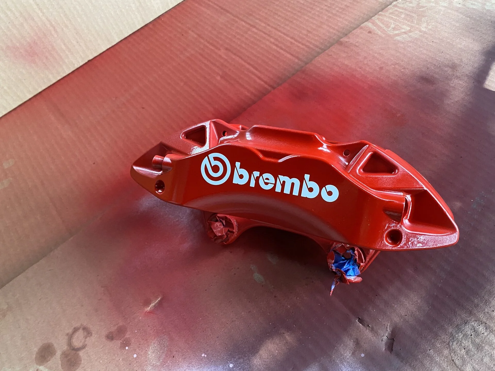

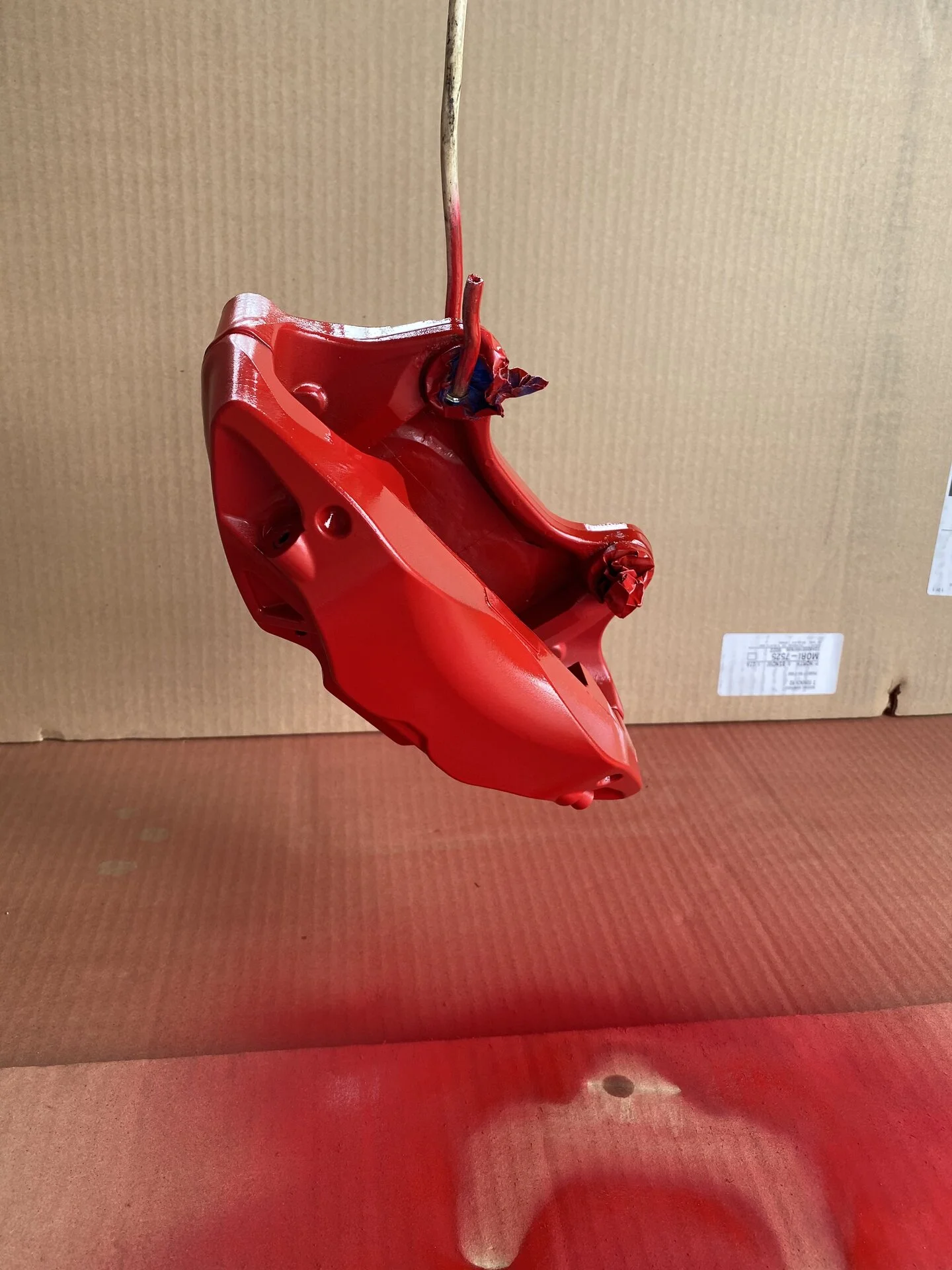

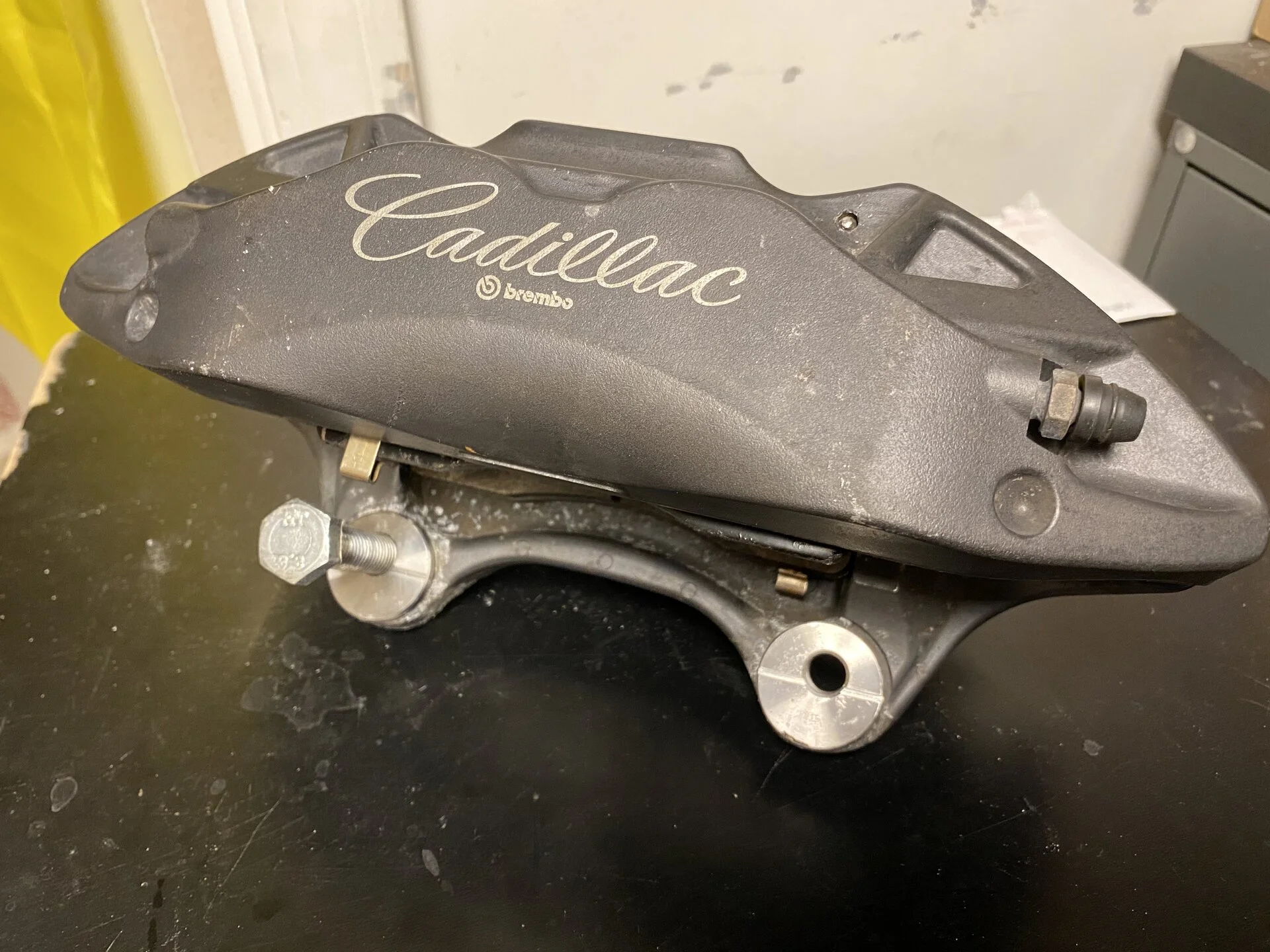

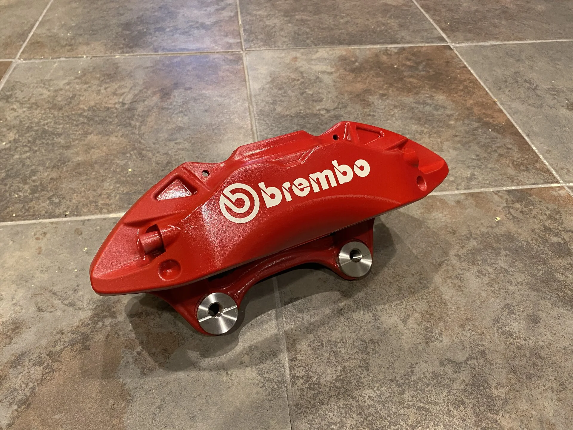

anyway, was feeling better today so decided to paint up one of my ATS brembos. I used the same technique as my current calipers. Clean, scuff, base Red, apply decal, clearcoat over, let dry several days before handling.
I should have put the pony on, with a small a Brembo under...but too late. Or is it.
Yes, I like flashy red brakes.
Throw a rubber pad on from the "HELP" section of your favorite Brand X local parts store.
it’s not the pad, it’s the entire mount. It’s adjustable.
LMR got it sorted out. They dud all the legwork and kept calling me to update. Was actually pretty impressed. MM sending me one next week.

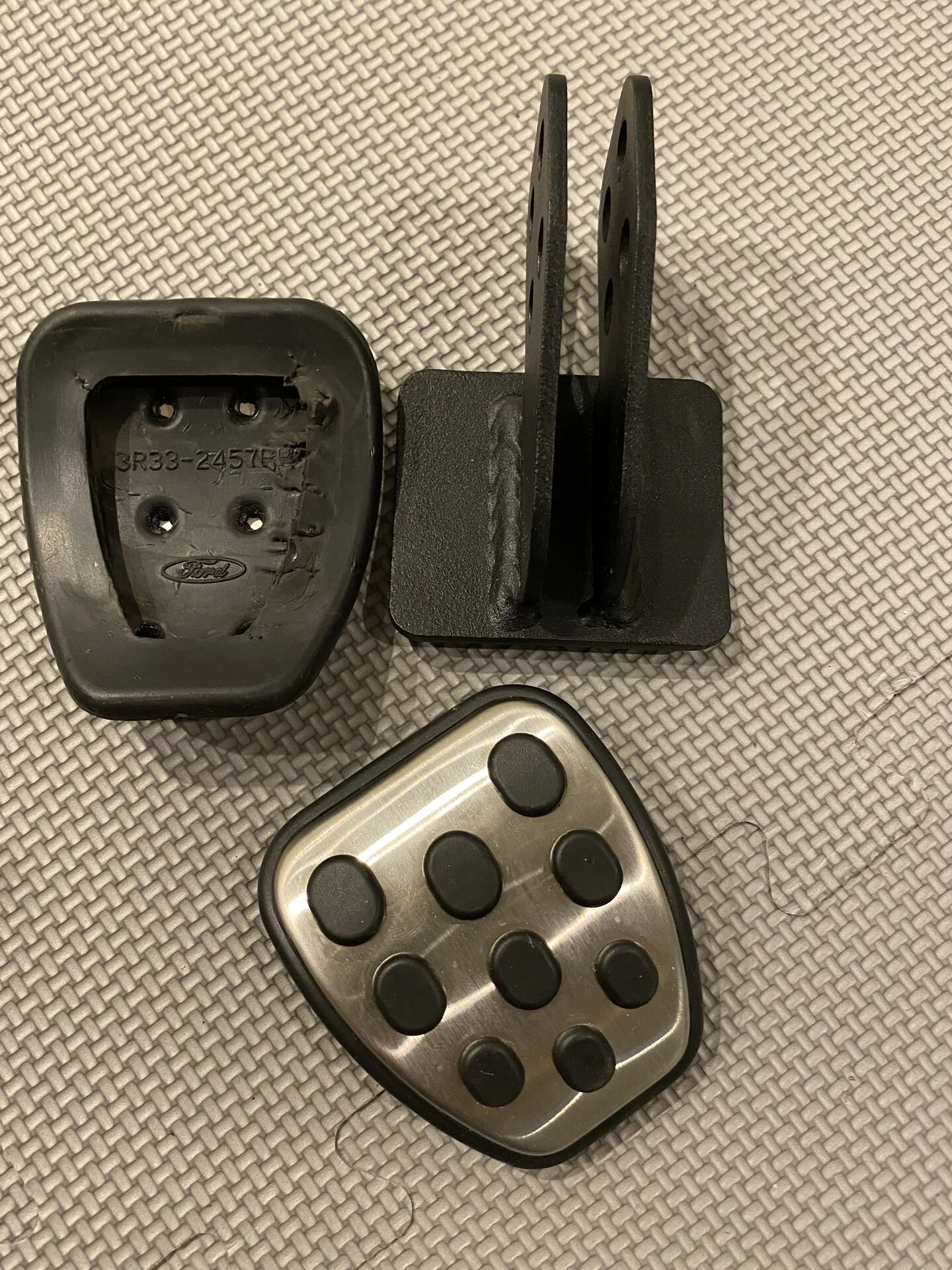

BTW, I did score an SN95 pedal cluster, so I’m hoping the clutch pedal will swap with the fox pedal so I can properly install my bullitt pedals finally

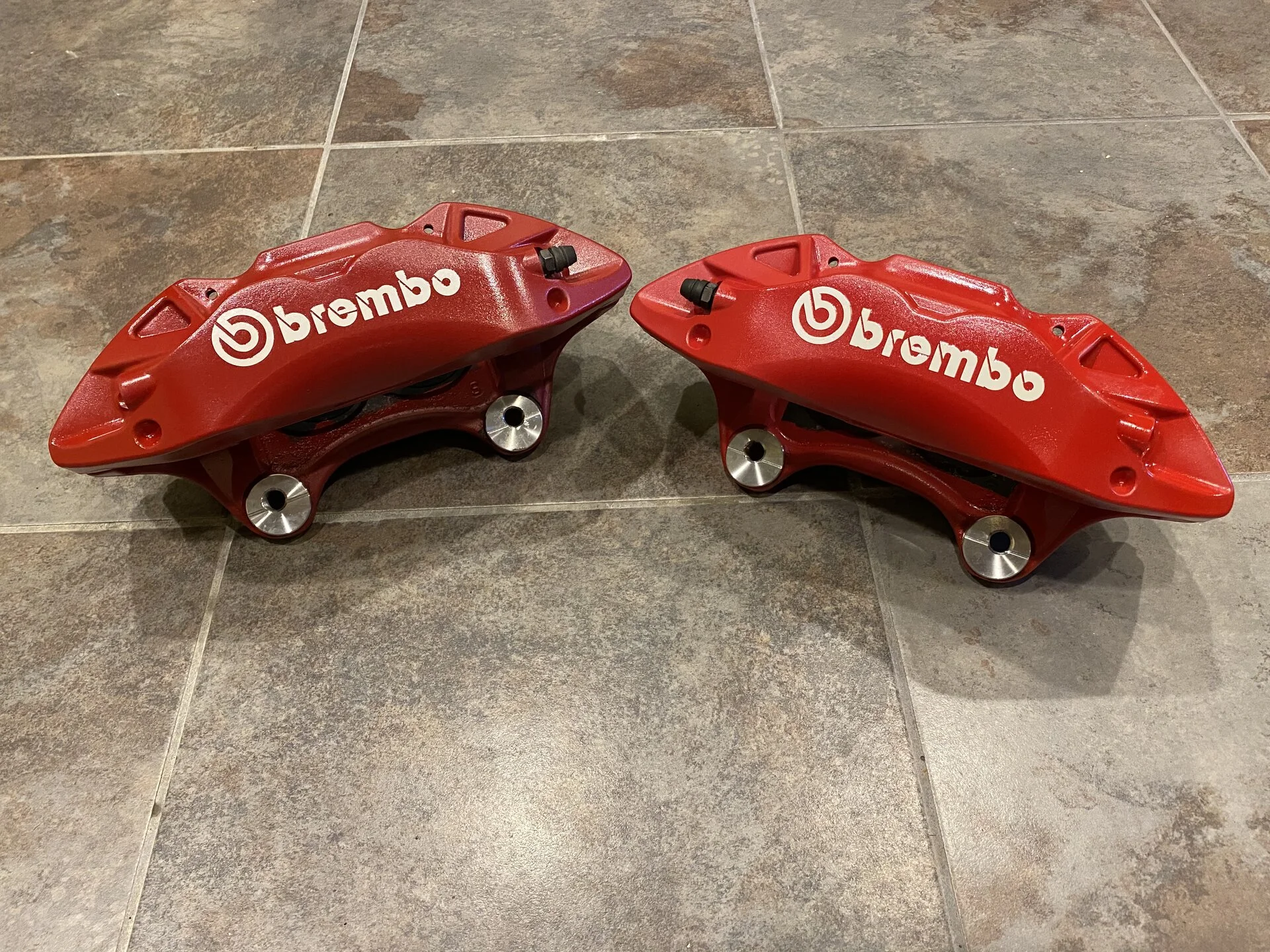

Did the other one. Used a fresh cam of paint. Same exact color, but didn’t notice til side by side they are slightly different.
yeah...I’m just gonna let that go.
If somebody notices that from one side to the next, they’re on another level. I’d let it go too! Lookin good nonetheless!!

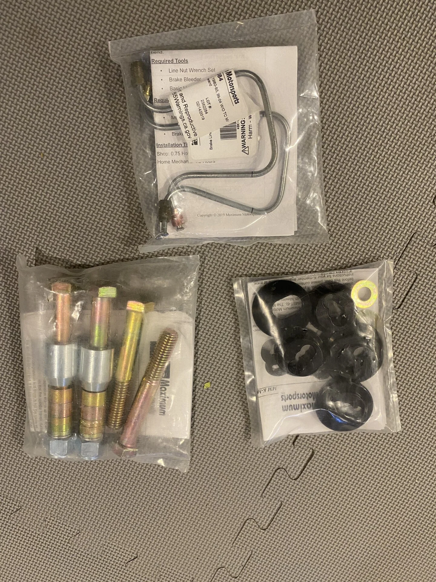

Also, some new parts showed up. I didn’t want to get caught up in the MM backlog so I ordered these now while they were in stock.
brake line adapters from hydroboost MC down to stock prop valve.
steering rack bushings for the mm k-member
bolt through bumpsteer kit conversion. I still need to ream my 96+ spindles to fit these.

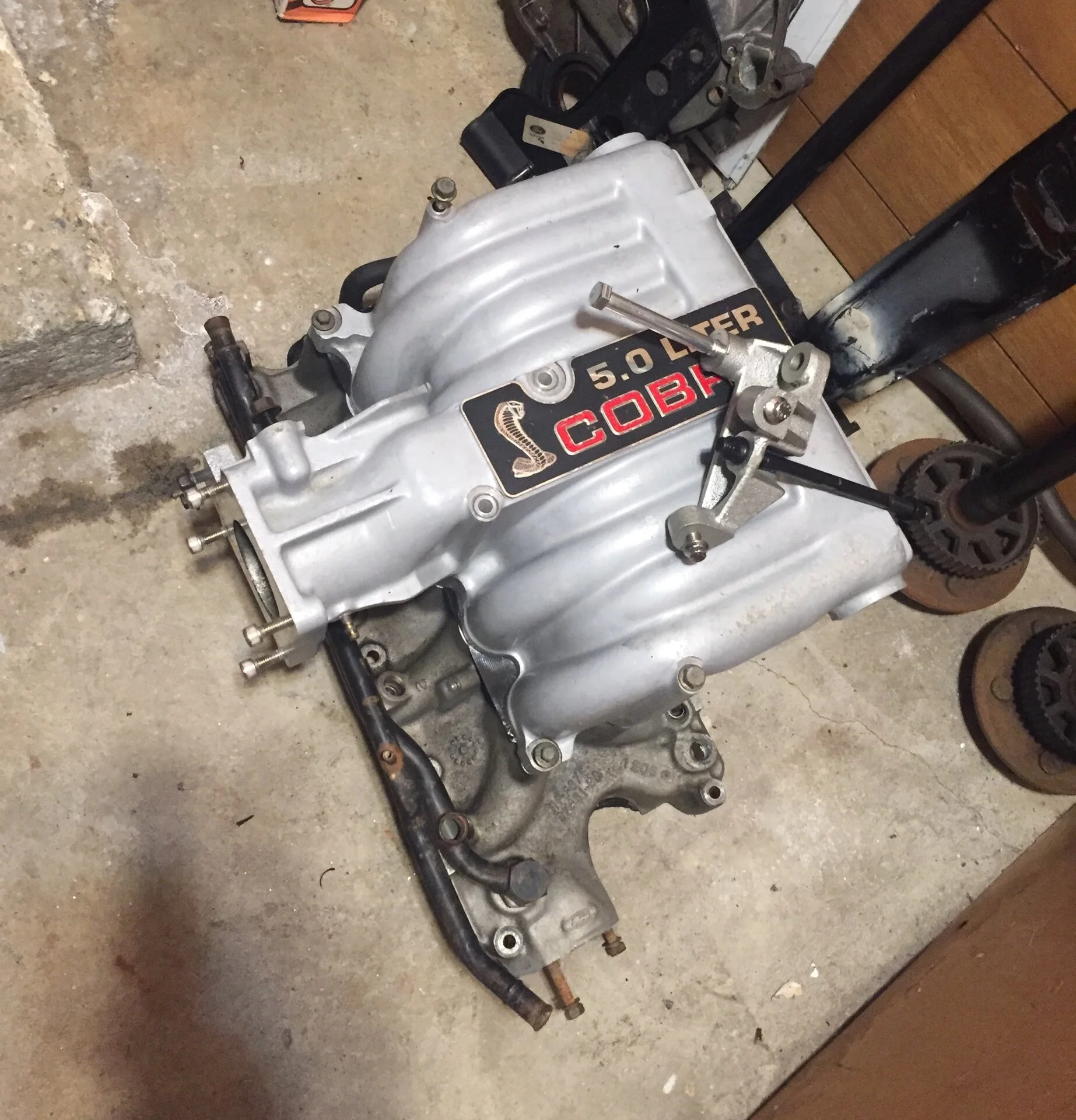

After much debate....I think I’m NOT going to run the Explorer intake.
I think I want to run this
Obviously it needs a refinish, but I think this intake needs to be on my car. I installed it when I was 18 years old, and it was the first mod I ever did. It’s been on the car ever since, and kinda bummed to see it just sitting on the floor.
Ive also been reading on other forums that there is a difference in flow in the upper plenum, and the explorer upper isn’t that good.

I can see the sentimental value there.
