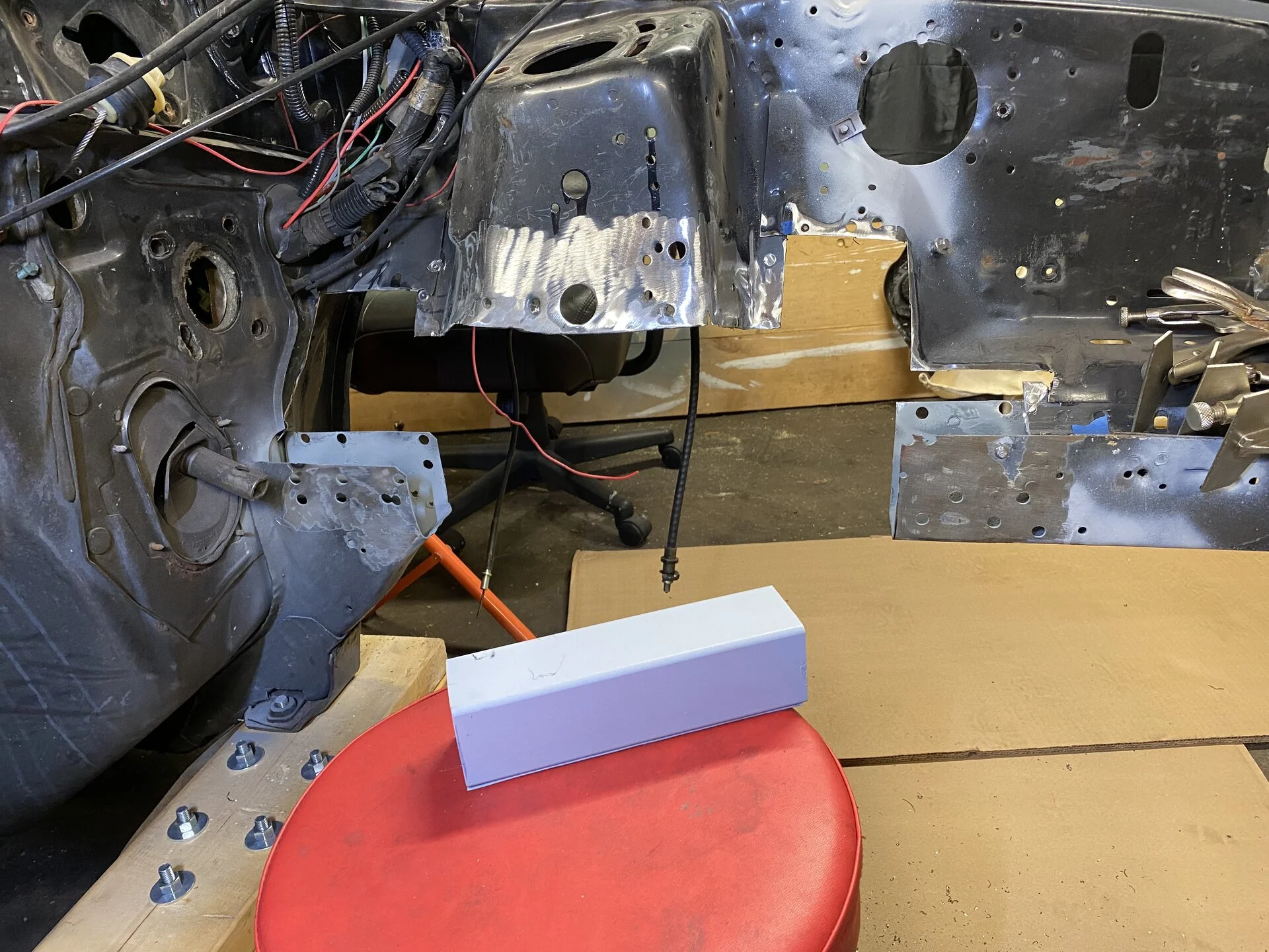

Ok, prep work done. Weld thru primer sprayed where it needs to be, and strut tower formed as close as it’s gonna get. I prepped my splice tube, and drilled out the 3/8” spot weld holes for it.
I’m taking Wed off from work and getting this done. Next time you see this it will be welded in.

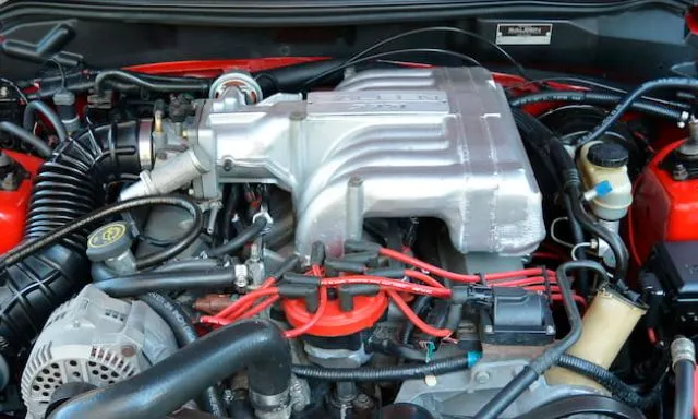

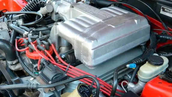

Here are some pictures of the S351 Cobra intkae with the expanded plenum volume. It's not super noticeable at first glance, and pictures of these engines are somewhat far and few between.
What did you gain by doing that? In my head, I see the extra volume creating a larger demand/force on sucking air through the throttle body and inlet tract. This should only happen at part throttle unless the TB is too small or the inlet tract is restricted. The only thing that comes to mind immediately is an increase in throttle response?
It still seems like the runners would be the limit unless you were getting uneven air to some cylinders.
I probably just missed a thread somewhere. :D
In my cartoon mind I picture the expanded plenum offering a larger volume of air available and moving the torque/hp around in the rpm range, not sure if it moves up or down, I would guess with a larger engine the numbers may move up
:shrug:
guess I could look for some dyno test.
Nah, busy today.
He didn't do it. Saleen did it for use on their S351 Mustangs. The extra volumn was needed to adjust the powerband. I would imagine with a standard cobra intake, it fell on it's face at higher RPM

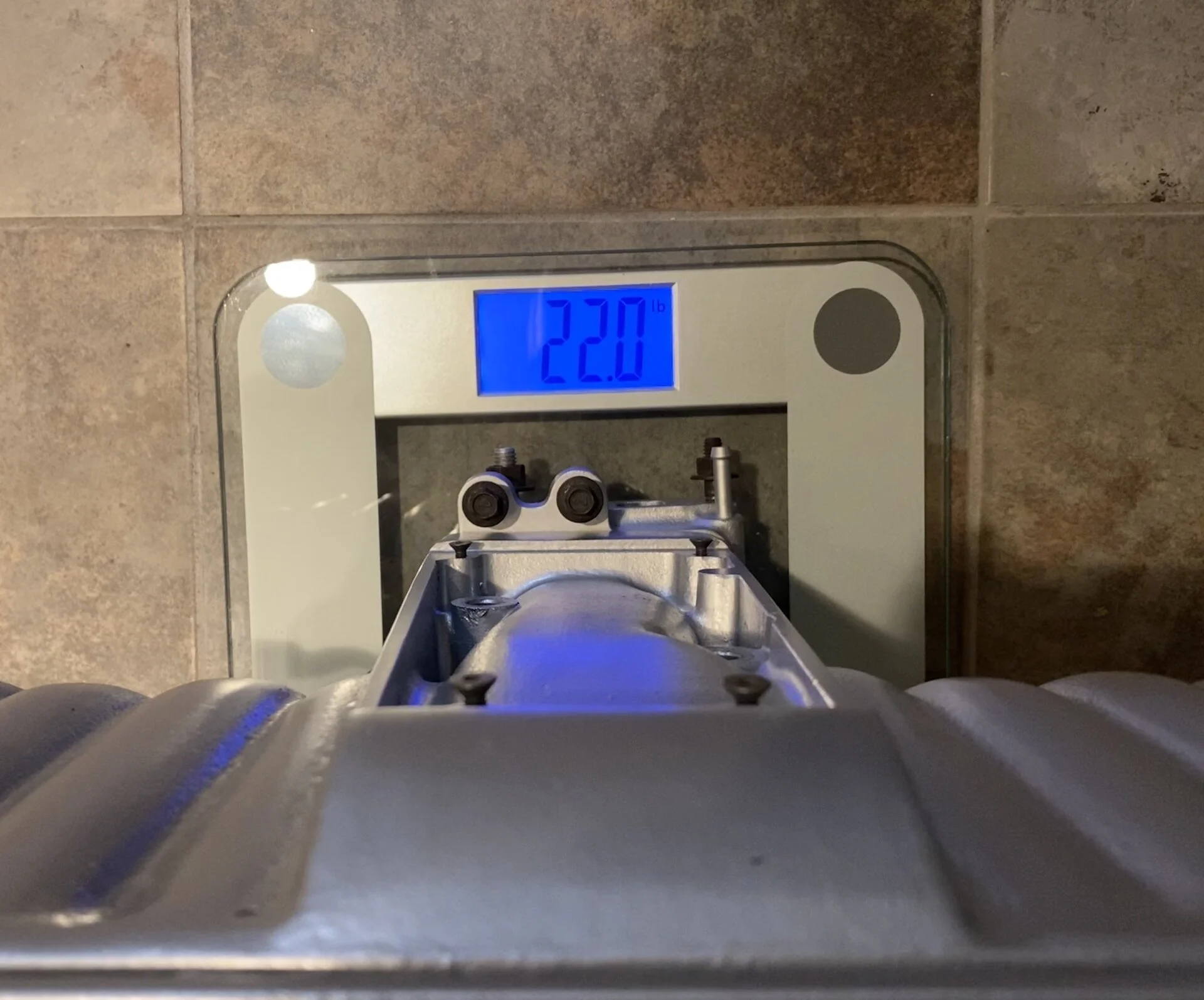

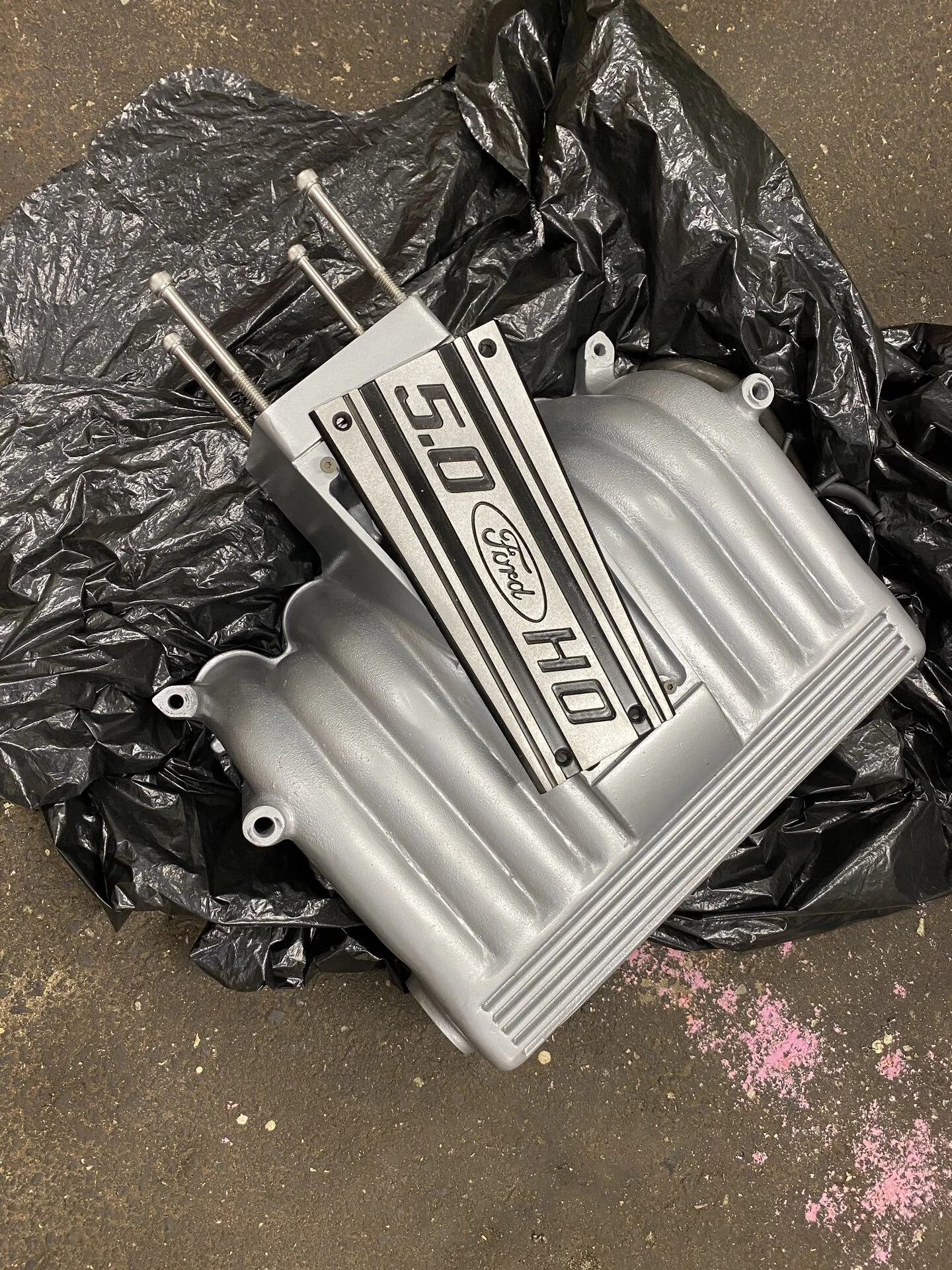

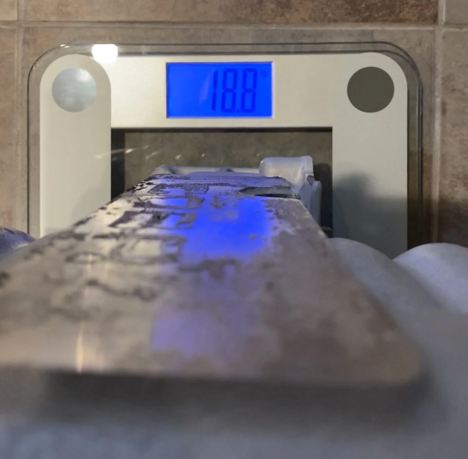

Decided to weigh the uppers.
Took them down to similar stages of "dress" in terms of fittings and lines. I weighed the explorer upper with a 75mm EGR spacer, since the cobra intake has it's own built in EGR.
Explorer upper plus EGR: 22.0LB (realized i didn't include the 5.0 HO plate)
Cobra upper : 18.8 LB.
SO there is a 3.2lb difference. Not significant.

More than likely has to do with adjusting the Helmholtz resonance of the intake. Essentially adjusting the volumetric efficiency of the plenum when equalizing the flow between the cylinders. Increased airflow demands in each runner due to the increase of displacement in each cylinder will effect the Helmholtz resonance of the plenum due to a increased high pressure reversion pulse that occurs when the intake valve closes. This is assuming the runner size/length has not been changed. By adjusting plenum volume, you can "tune" the intake to deliver as much air as possible through existing runner size by optimizing the VE of the intake.
EDIT: Annnnnd, I just realized @WhiteCobra95 already explained this a few posts back. :doh:

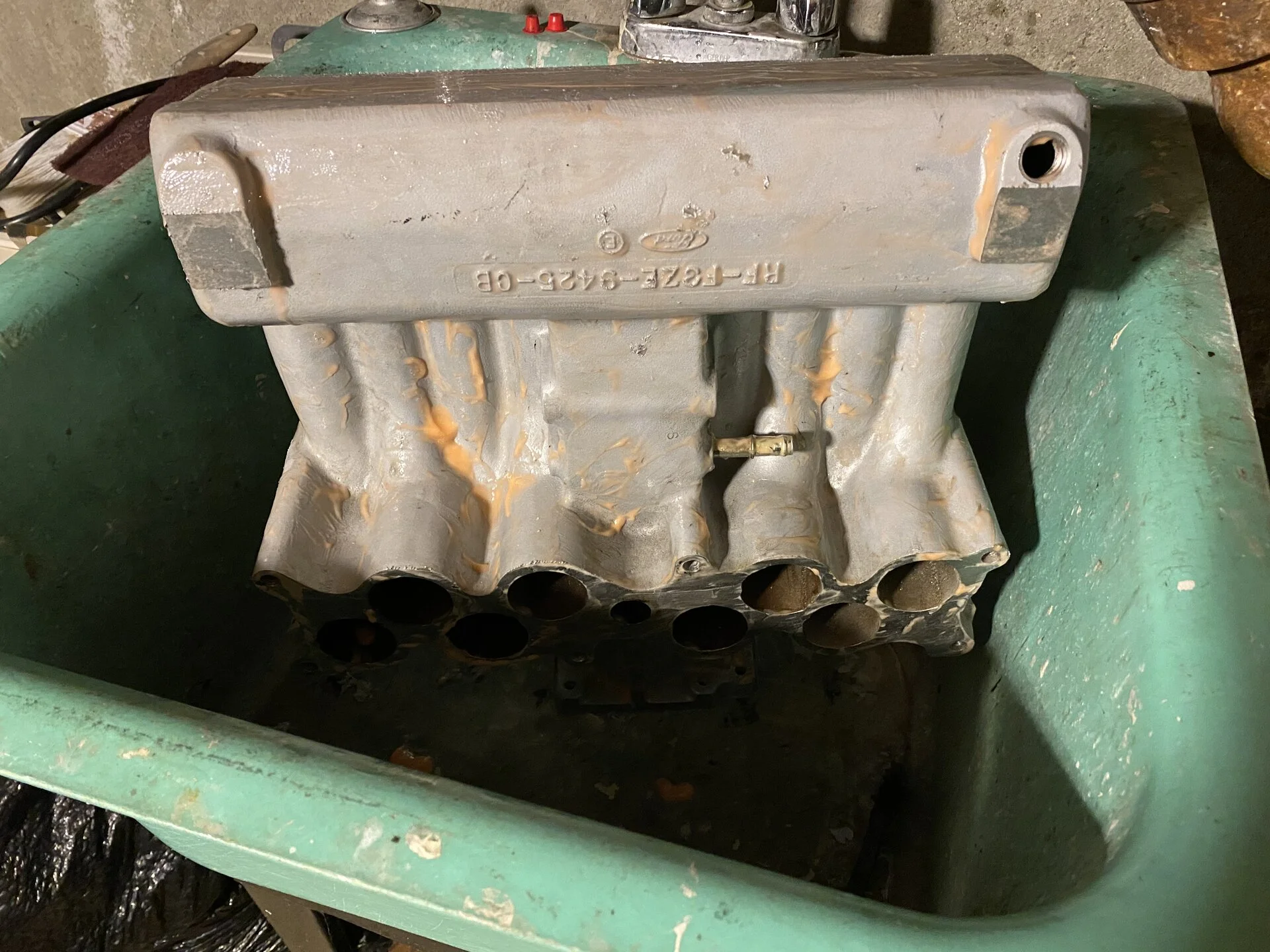

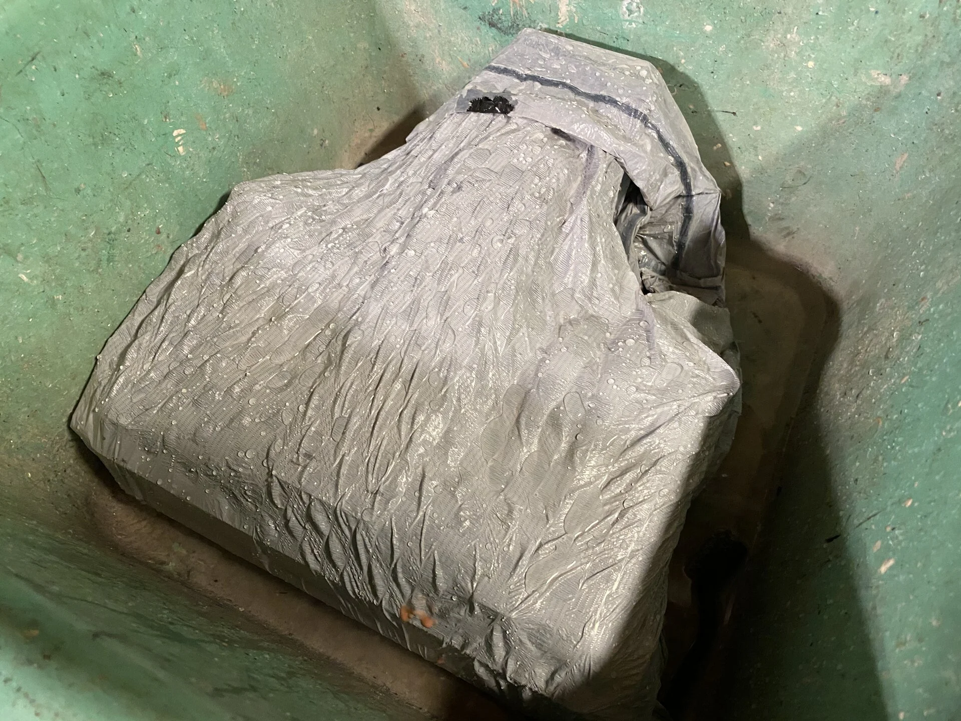

Ok, well I committed to running the Cobra. I’m likely going to powdercoat it, but can’t decide color. I want something a little different than argent
anyway, stripping the intake down. Lather it in Citristrip, bag it up (to keep it moist) and let it sit.
welding day has been moved to Thurs due to my job actually needing me to do something on Wed that I can’t pawn off. Burning the rail in is something I want a full day to focus on to make sure it’s correct.
