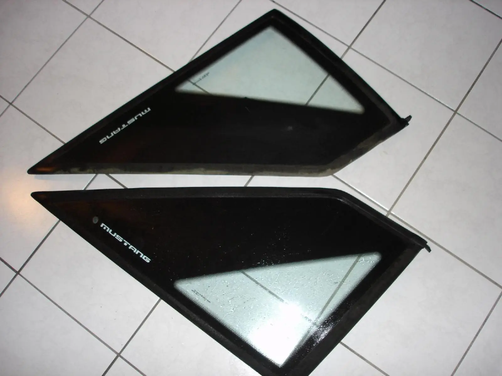

Spied these on CL for peanuts. Guy happened to live right next door to my work. So i swung by and picked them up.
They aren't in bad shape, but I don't need windows, so they won't be going on my car...but at least I can practice refinishing on them so I can do my own windows. I feel more comfy trying it out on these first vs my own windows. After that, who knows what I'll do with them.
(bottom window is just wet from cleaning)

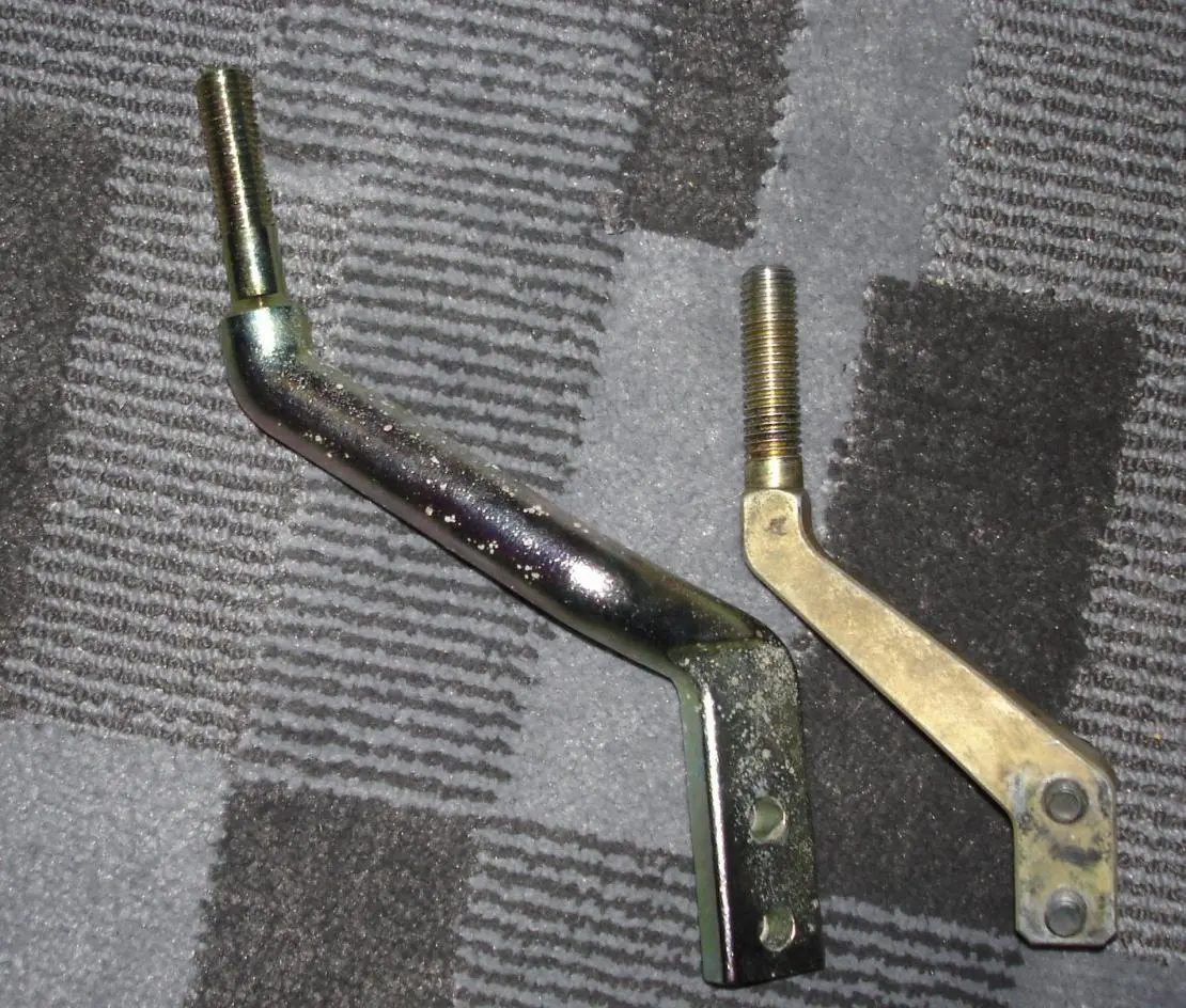

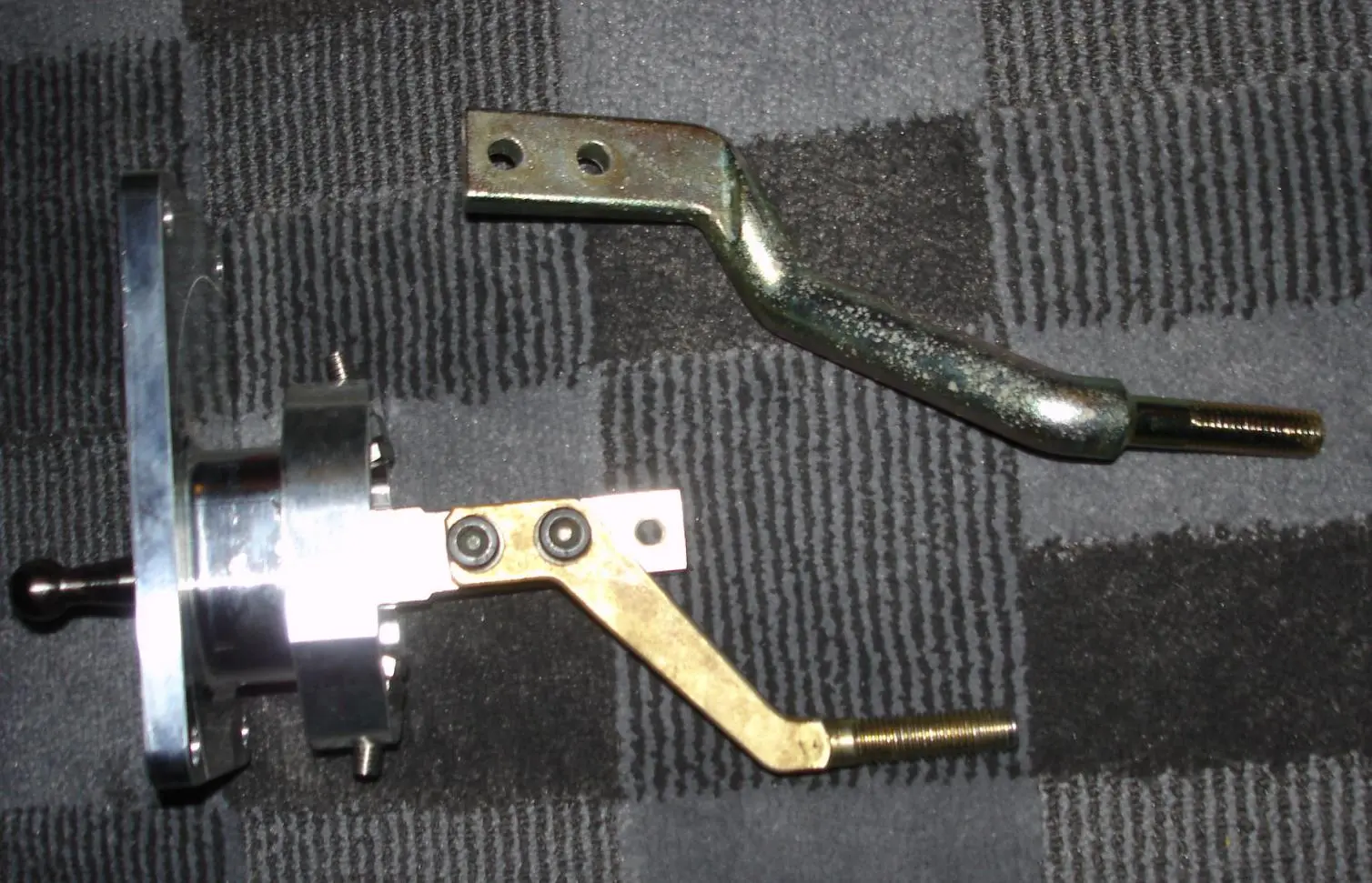

Anyway, i had $200 in summit cards, so i bought a Steeda Tri-ax shifter with it. Honestly, i prefer the MGW shifter...but the shifter was basically a gift so i can't complain. Later on, i may be interested in traded for an MGW if anyone is crazy enough to do that.
Also, don't get the "comfort performance" version. Summitt is fuzzy on the description, and basically it's a tri-ax with a HUGE handle for comfort! :( Luckily I had a short handle that is prob the same as the normal tri-ax handle. So i used that.
Throws are short, but MGW throws are much shorter. :(

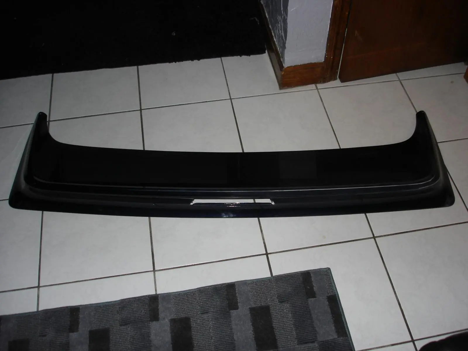

I also picked this up. stock LX wing. Bye Bye Saleen shopping cart wing! :nice: OEM = :nice:

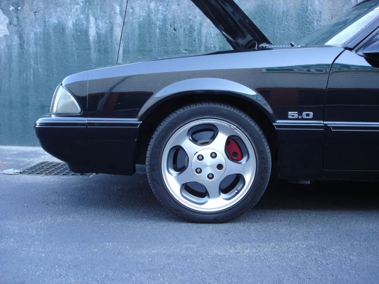

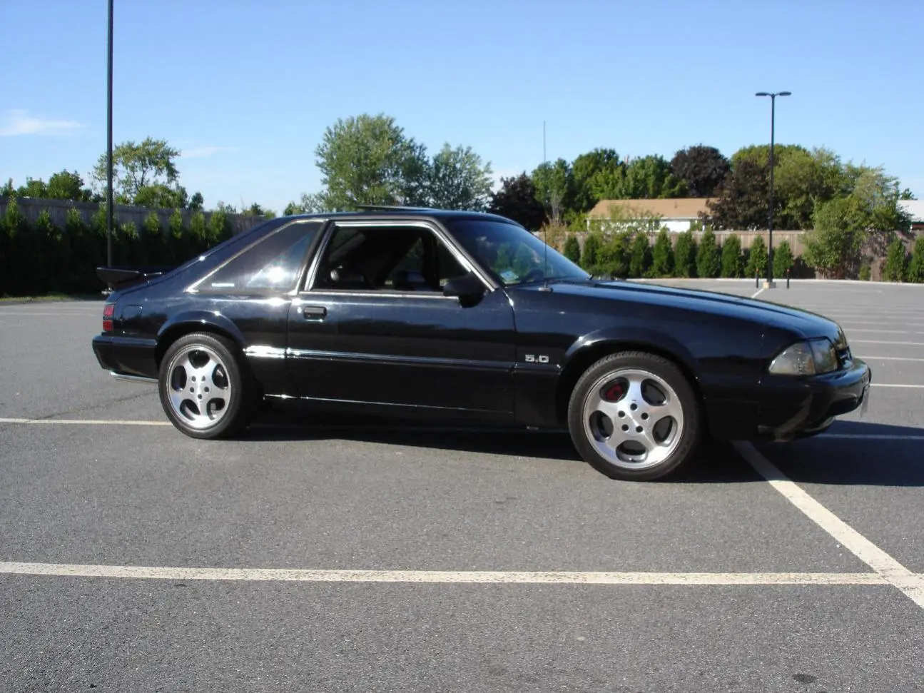

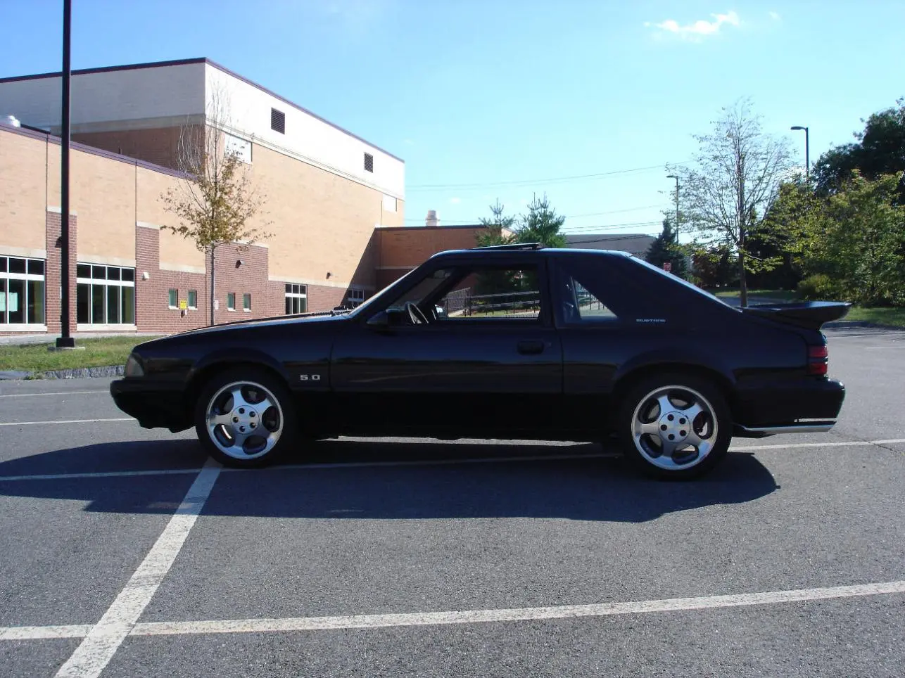

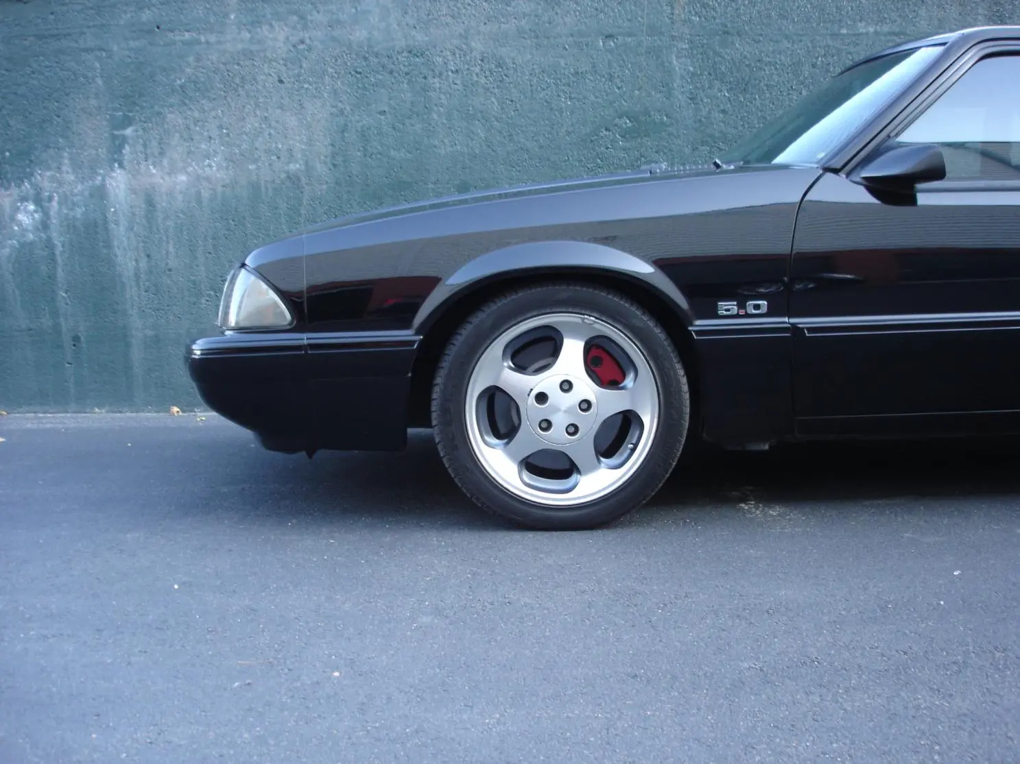

Okay, here are pics. Car is dirty, havent had a chance to wash it.
Uncut Mach 1 springs up front, no isolators (still rides softer than C's with isos). Mach 1 rears with full isos and adjustable rear arms controlling rear height.
Could use a tiny bit lower up front. Might trim off 2" or so of spring lenght next time to see if i can get it down maybe 1/4-1/2". Ride height is 26.25"to both front fenders.
attachment.php
attachment.php

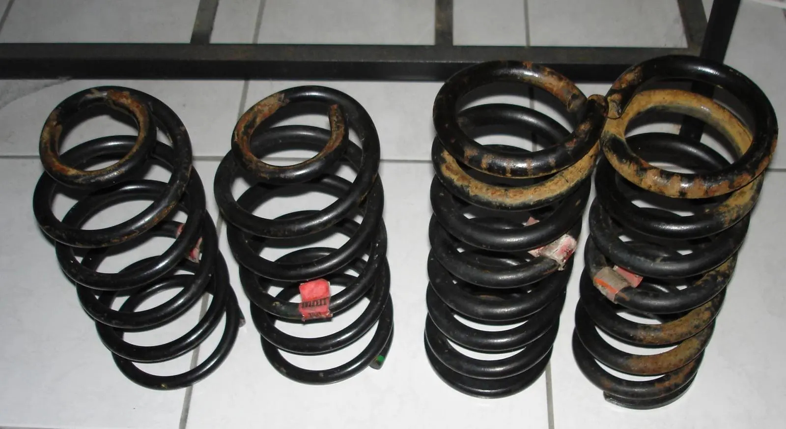

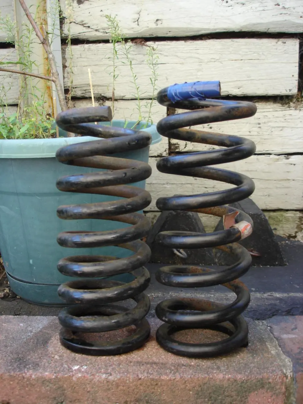

And front spring visible difference.
C spring on left, Mach 1 spring on right
C spring 650 lbs linear
Mach spring 600 lbs linear
You can notice the C spring is shorter, but has fatter coils and more of them
attachment.php

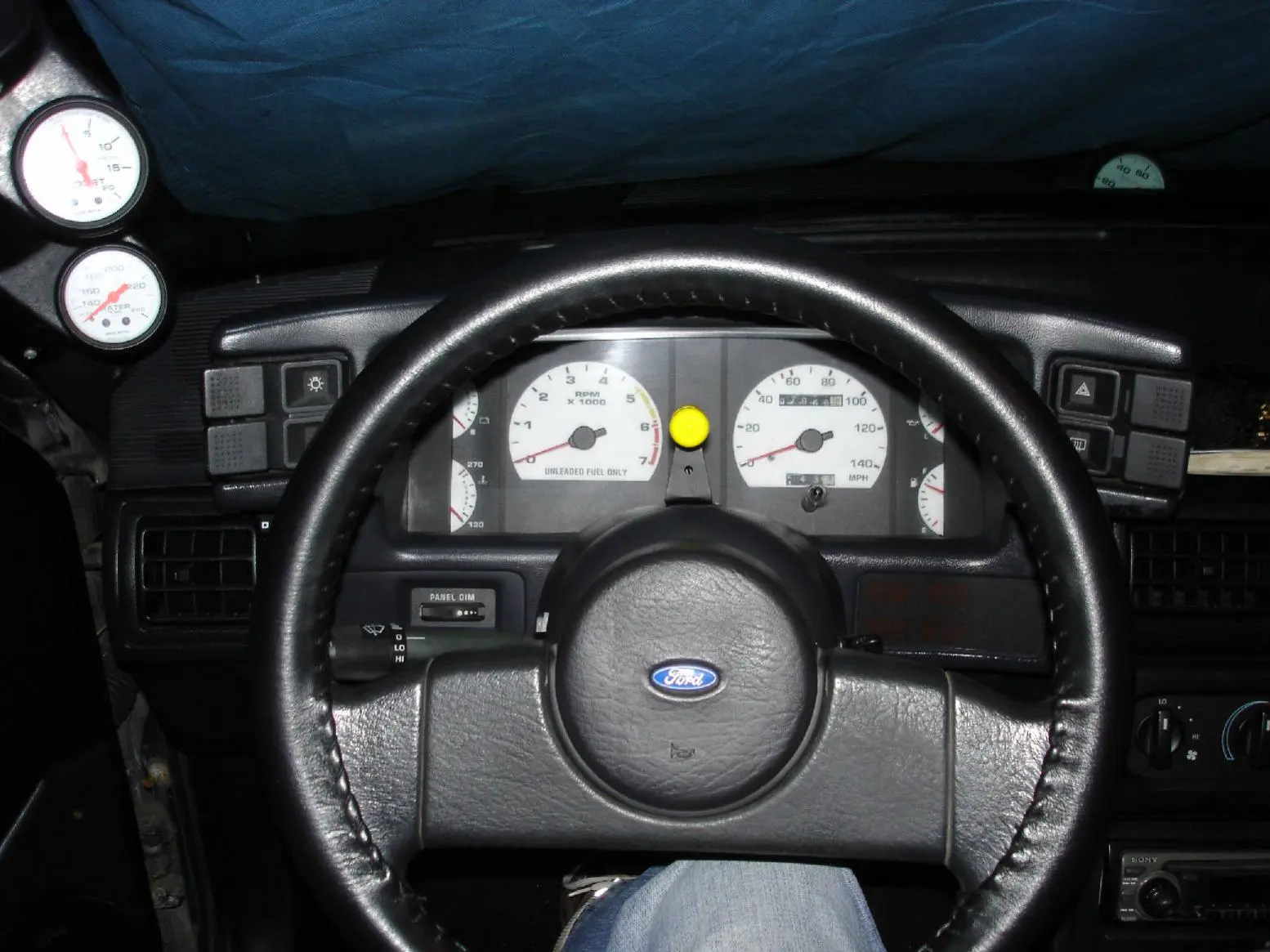

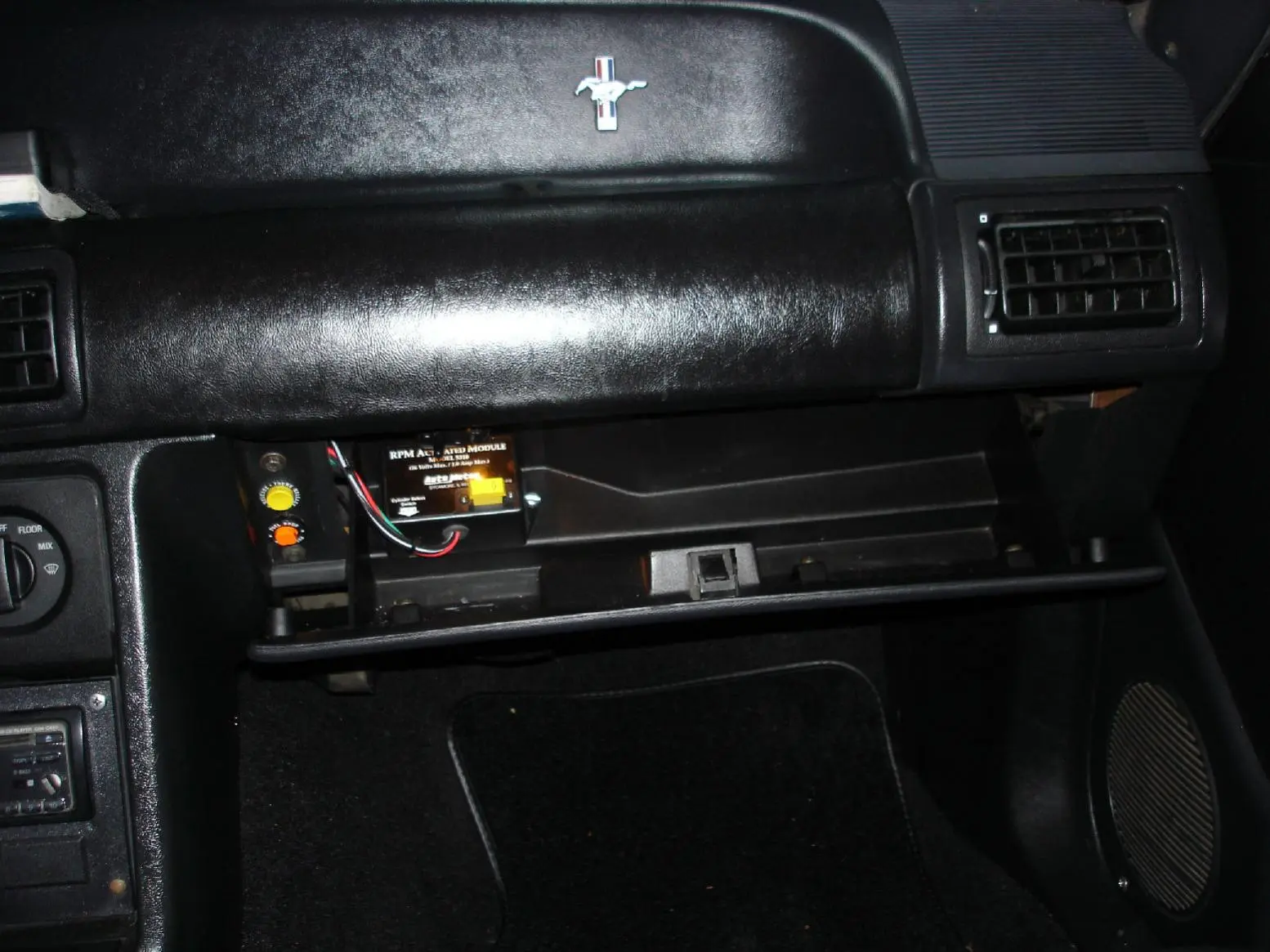

Put my gauges back in. Said i was going to do them under the radio, but couldn't convince myself i could actually see them. Also, you can see my cowl mounted fuel pressure gauge and the new shift light i installed.
I put the boost gauge in temporarily because i wanted to see how my vacuum behaves how i drive. The only one who is gonna see it is me...so why not it it does what I need it to do. I ran the line for the oil pressure gauge and when all done, will swap them out.
Also, you can see where i mounted the control box for the shift light. Using the 3K pill for now for daily driving...but have the 5000-6000 RPM pill kit

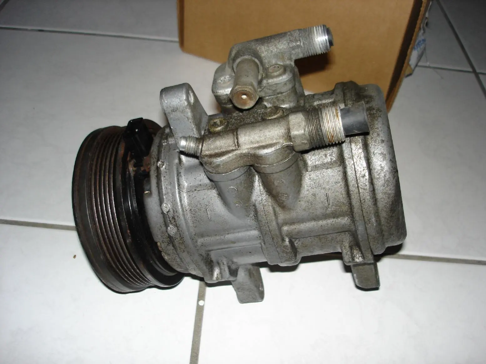

Friend gave me his compressor. He recently took it off his car which had a working R-12 system. Dumb, i know, but he's making a race car. Unfortunately i already had everything else new, so i couldn't take his entire setup. But good working compressor full of oil and freshly removed. Will clean it up, paint it and then seal up the ports until I do my install.

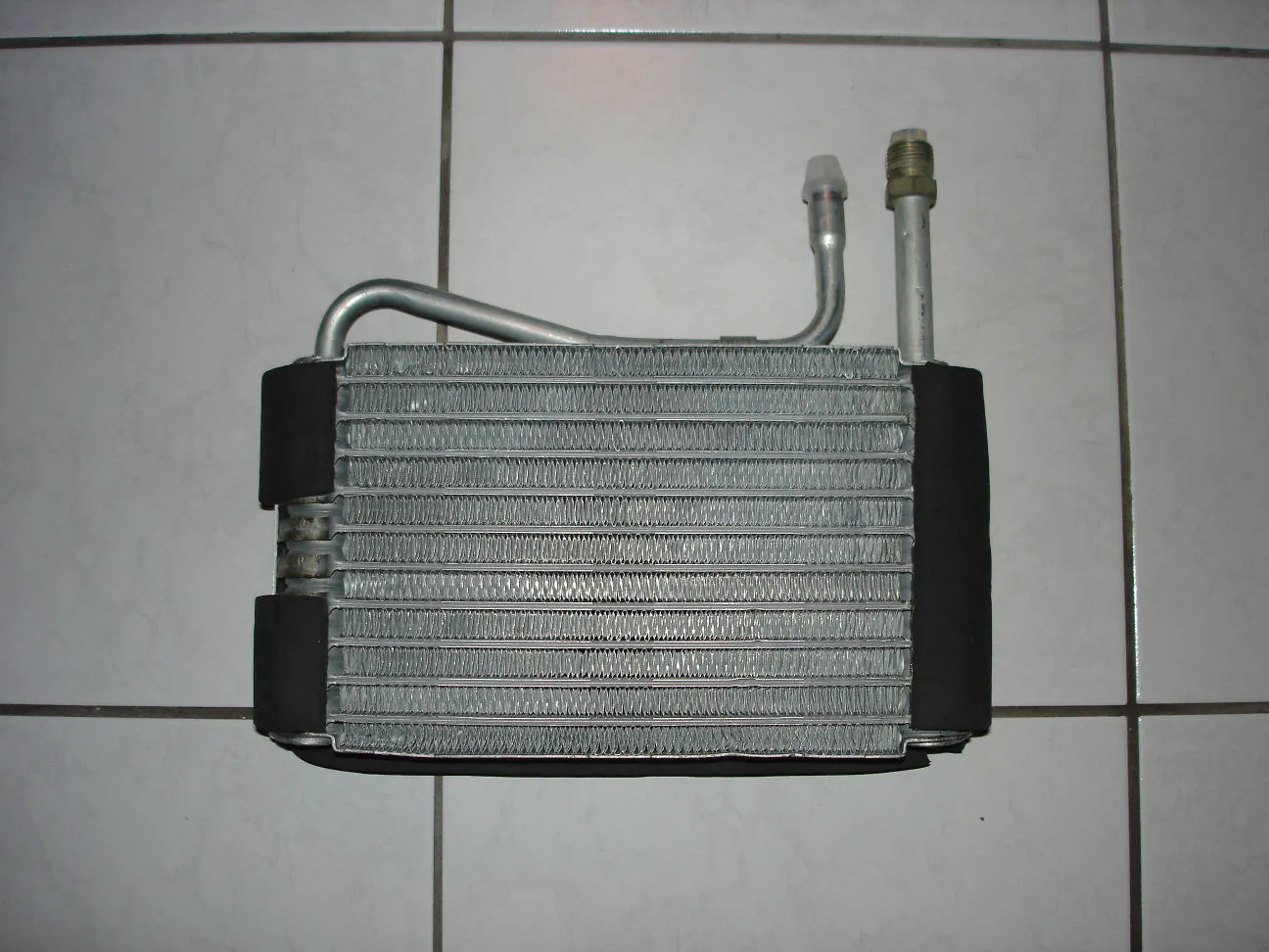

I also bought a new evaporator core. My current core has been sitting open for 8 years. i didn't want to take a chance even though a solvent flush might save it. I figure with an all new A/C system, I don't want to take the chance. Tried to get a Motorcraft unit, but no longer made. I've found new Evaps were in the $60-70 range. 4 seasons makes them P/N 54531. Found one for $25 new, figured why not. I got it, opened it up and the BEST part was on the bottom it was stamped "Motorcraft" :nice:
So maybe i scored because if you google the p/n they are all $60+ new. It came in a 4 seasons box, but the part has MOTORCRAFT stamped on the bottom...for $25 new? :shrug: Not gonna complain
Of course...now i gotta pull the dash *again* to install it :(

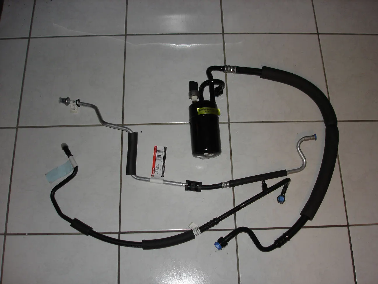

In addition, i already had these parts. Got these about a year ago when rockauto.com was closing out it's Motorcraft A/C stuff. Think i paid about $80 for all 3 lines.
All Brand new Motorcraft A/C stuff :)
Accumulator and line
orifice line
return line

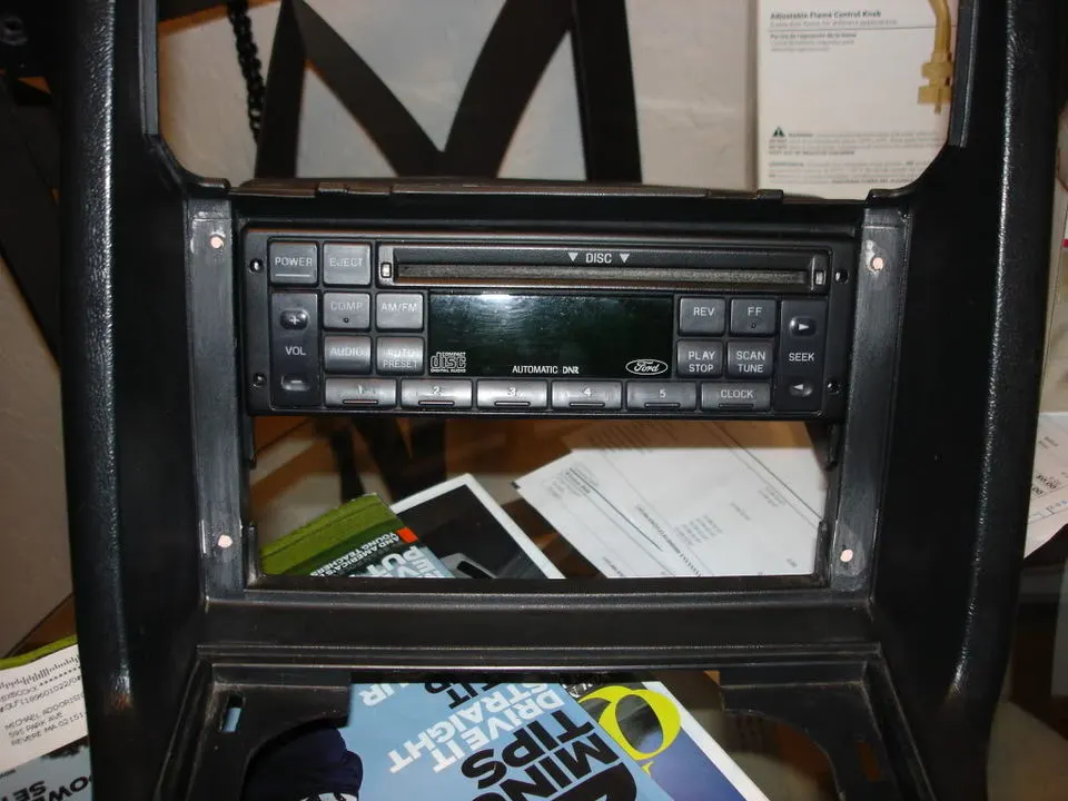

Change of plans. The 6-disk Mach 460 ended up being a huge pita to wire up.
Going for something a little more plug and play. Had the console out so I can fill and paint the radio mount holes
As for what's going underneath it...haven't made my mind up yet. Always thought the cubby was wasted space
