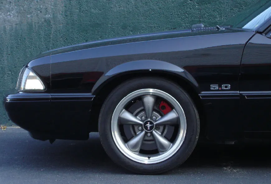

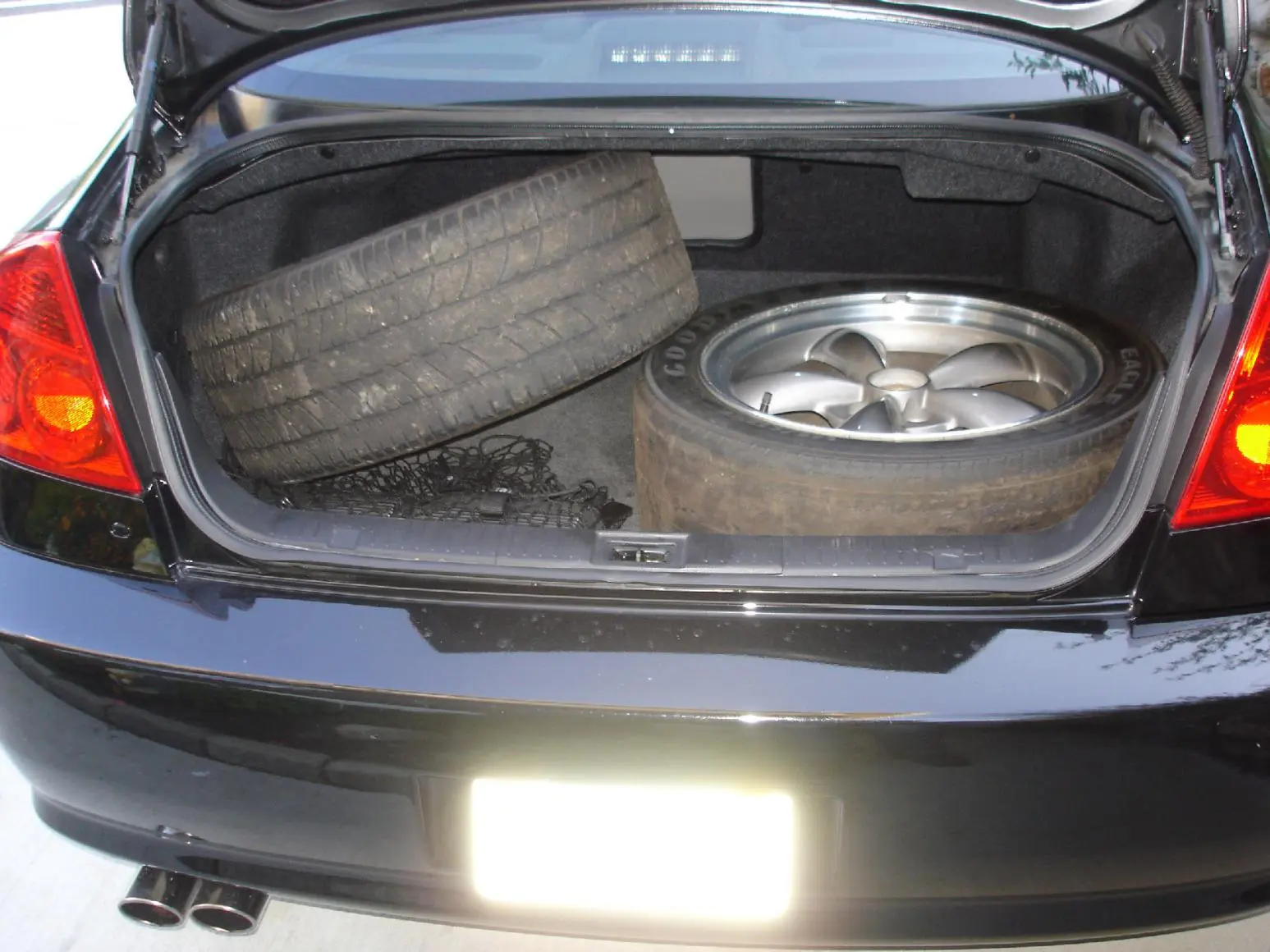

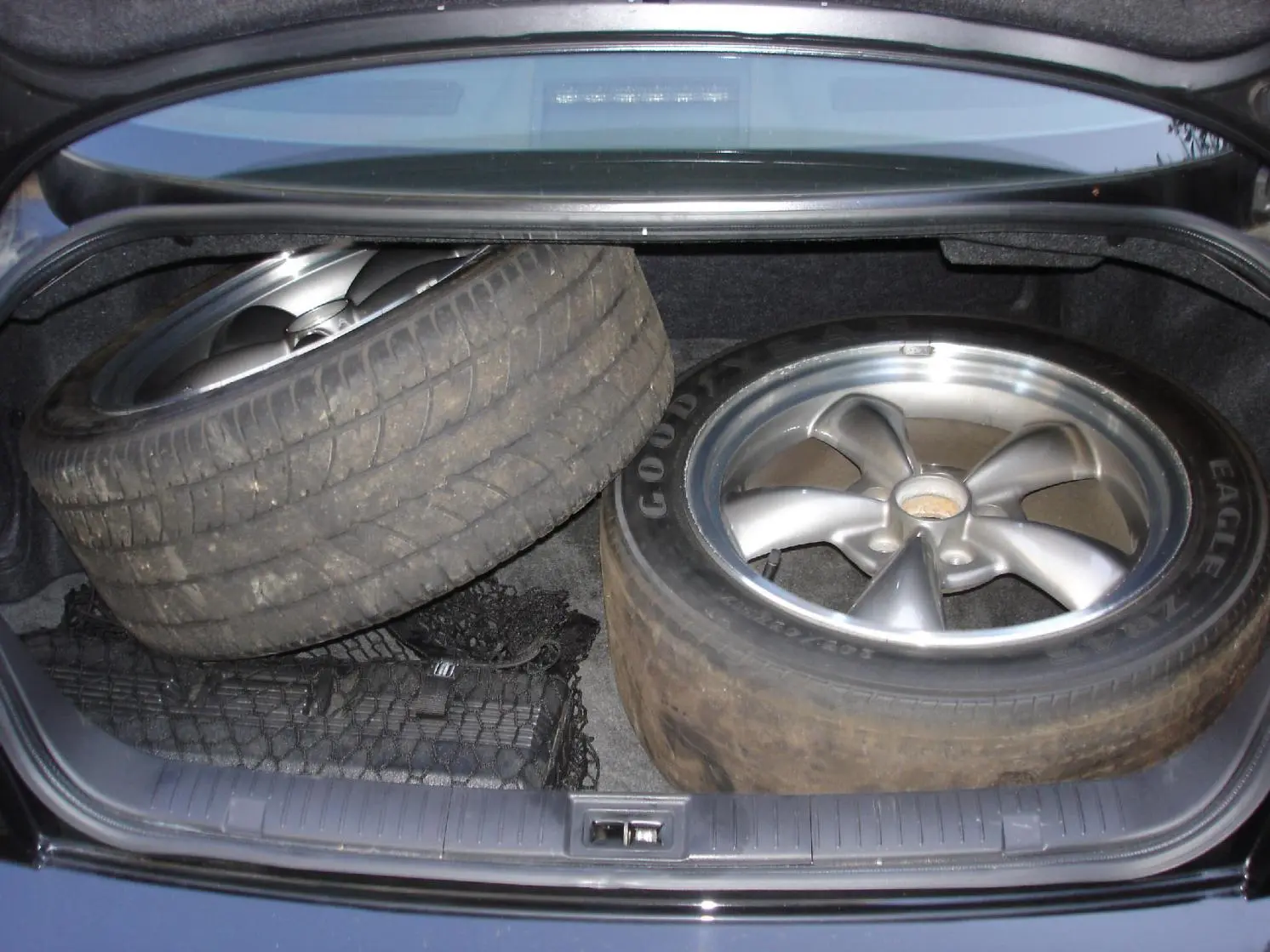

Scored these off craigslist for dirt cheap! Tires are junk and i need center caps, but they are pretty damn clean '03 Gt wheels!!
Now all i need is 1 more bullitt wheel unless i want to use the brand new Ford OEM wheel i have still NIB....which i really don't.

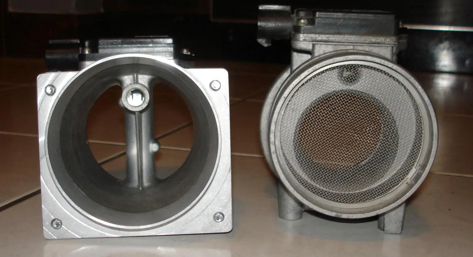

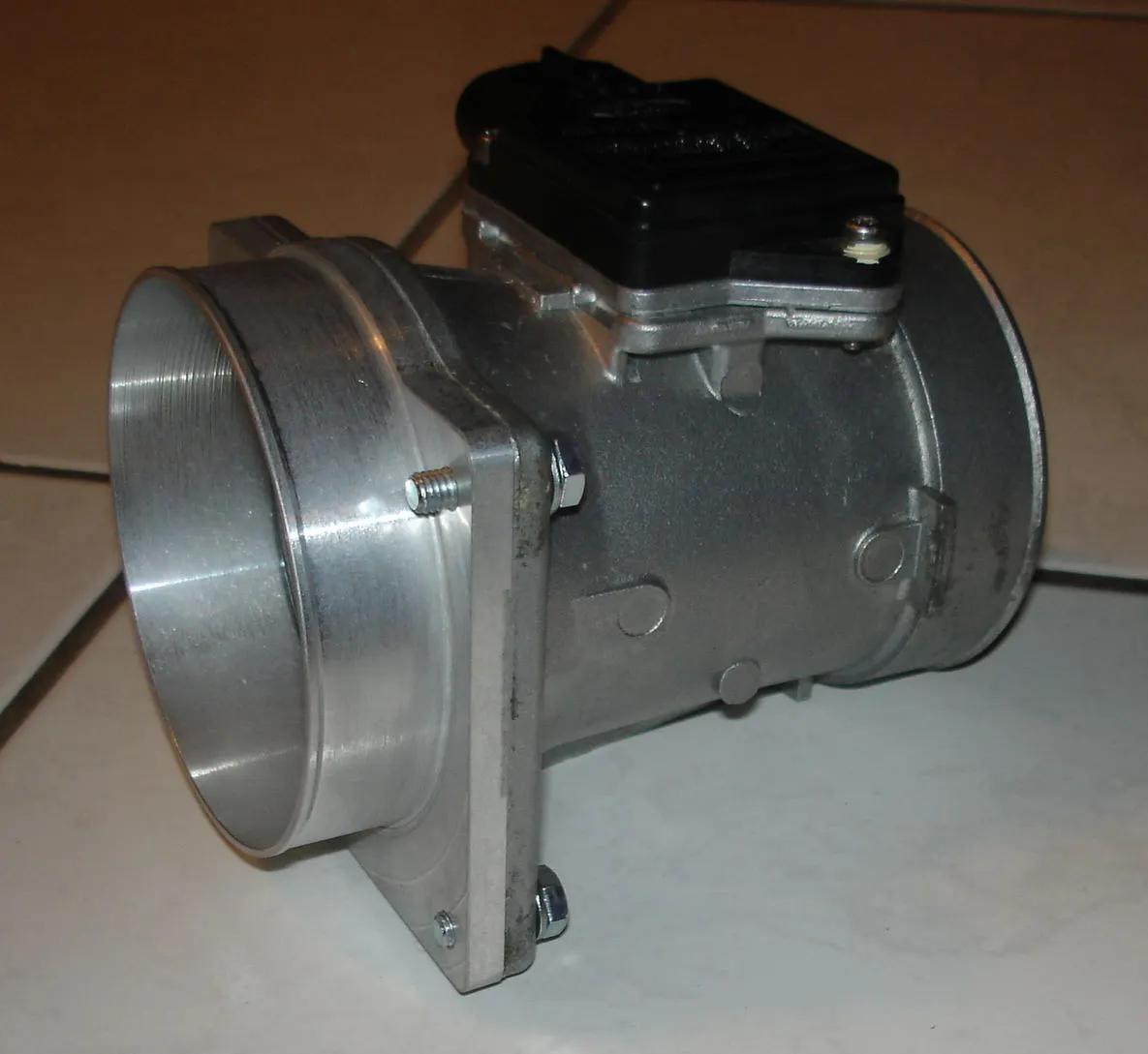

SN95 70MM MAF + Adapter.
I'm still SD, but running a MA intake track, so i still needed a bigger MAF for when i do upgrade! Plus i got the MAF for free!
vs the Fox MAF
attachment.php
With the adapter bolted on
attachment.php

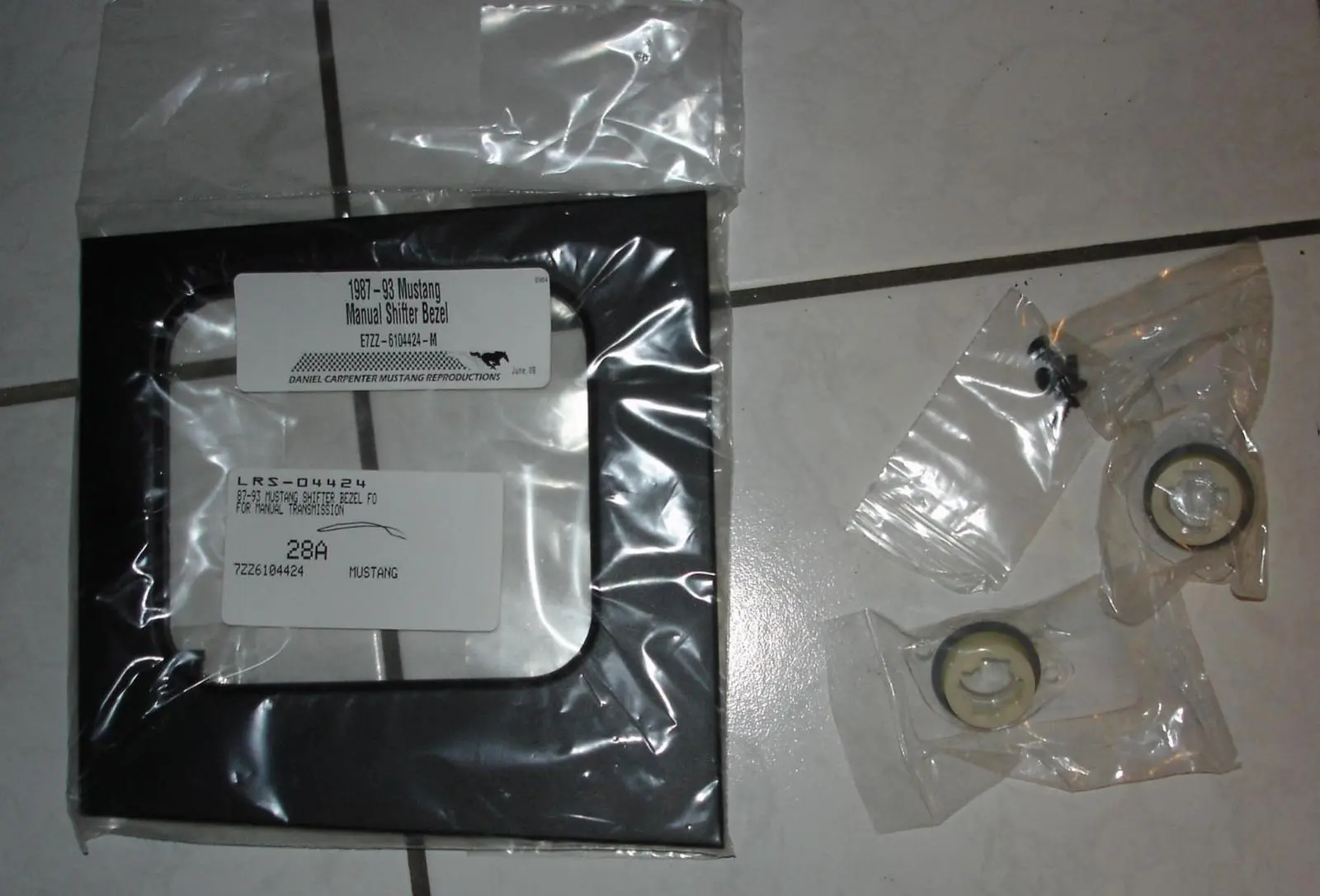

New shifter trim bezel. Waiting for my new boot from Redlinegoods.com to arrive. WIll be using an 03-04 cobra knob (5-spd version) as well

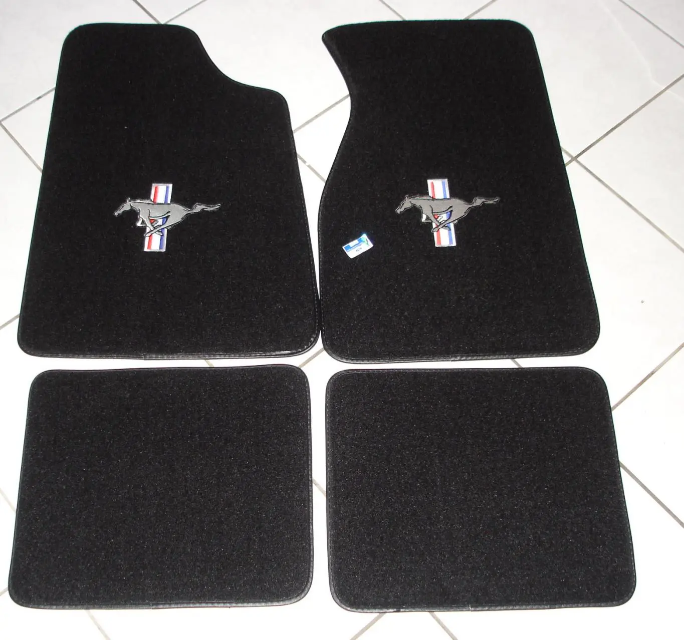

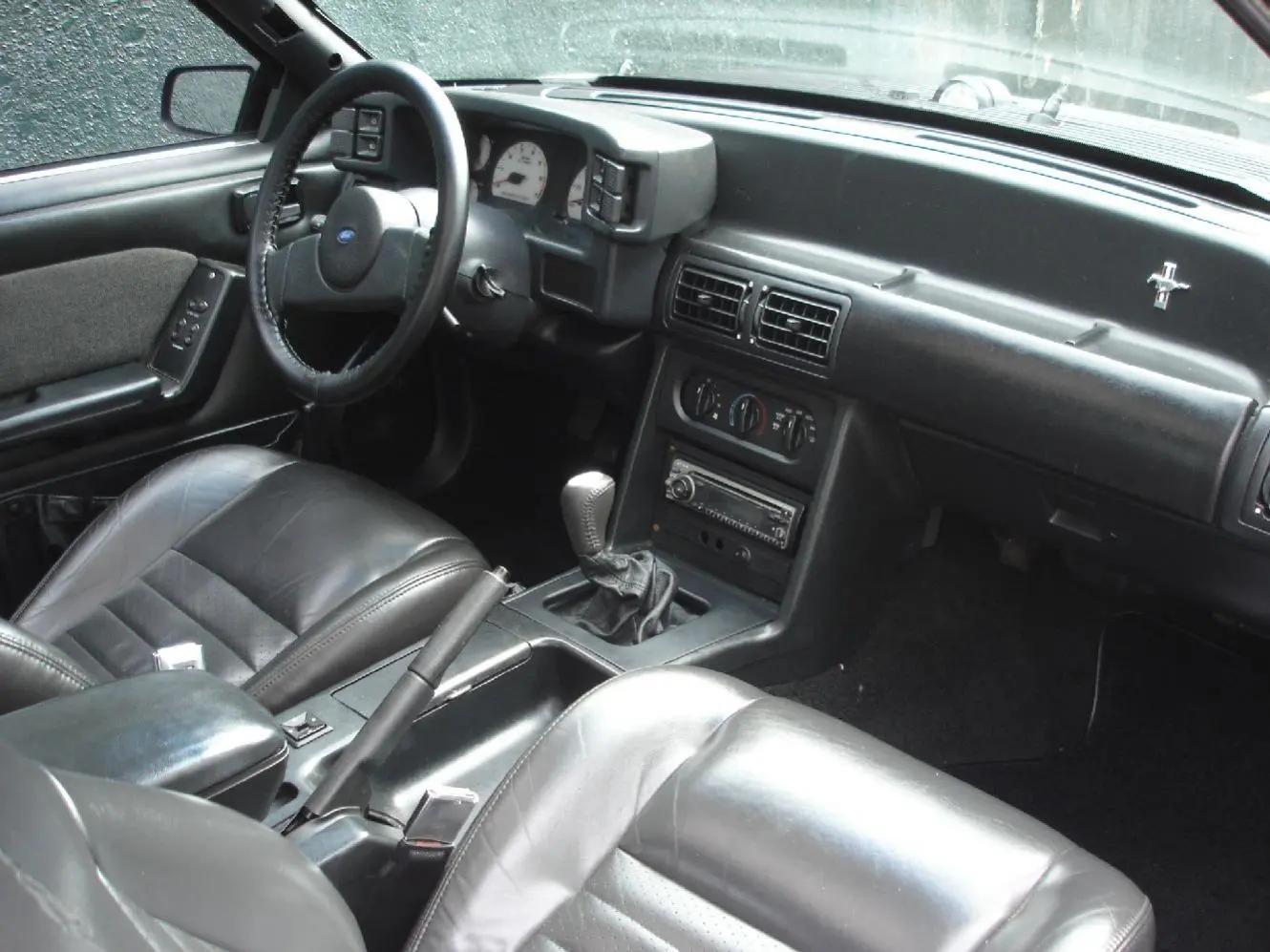

Also, new floormats!
attachment.php
attachment.php
Well, put the larger MAF in. Car def pulls a little more. The stock 5.0 MAF is TINY!
I also got around to putting the mats in. Really make sa difference. My new shift and e-brake boots should be here on the 20th, so can't wait to install those. You can see how my original shift trim peice is a little warped and sticks up.

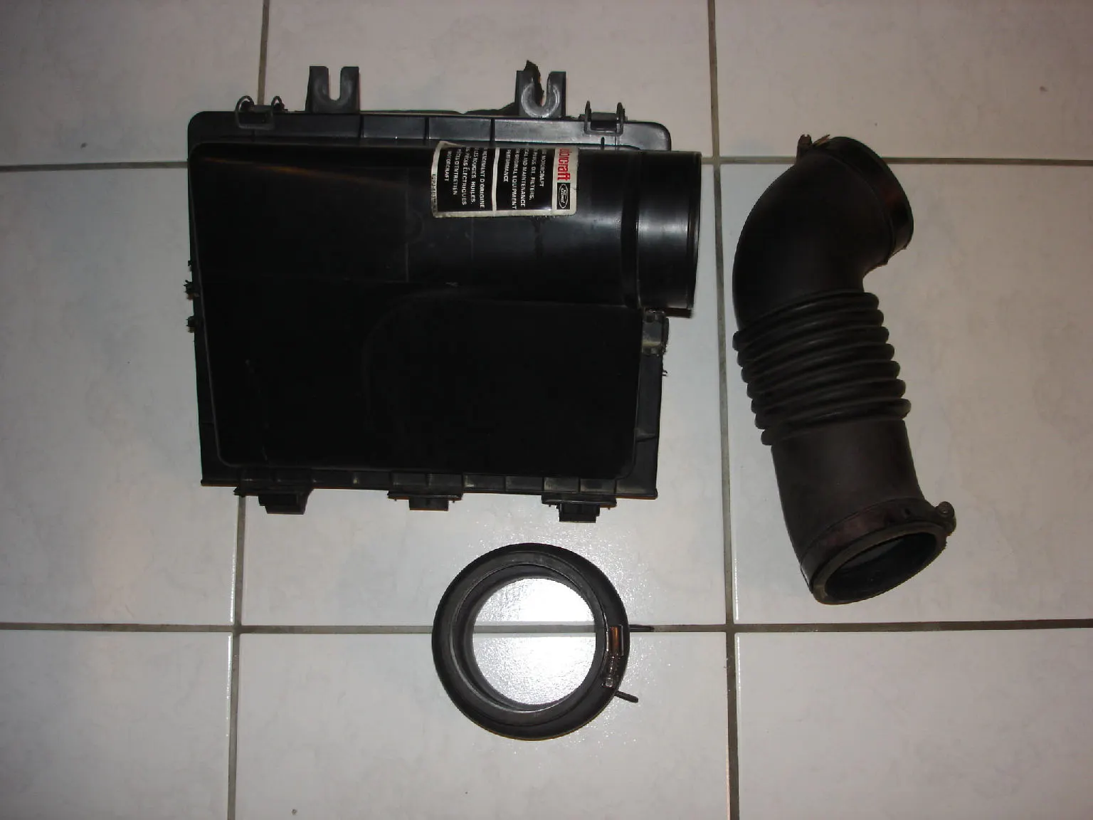

Scored a stock air box from 1991notchbackLX :nice:
My BBK CAI is all rusty from sitting for 6 years, plus i kinda like the stock airbox look and it doesn't get HOT like the metal BBK intake. SO i decided to go back. Plus i kinda like OEM look to things
Cleaned this up tonight. Just gotta order the rubber box mounts from 5.0 resto and toss it back in with my SN95 70mm MAF!

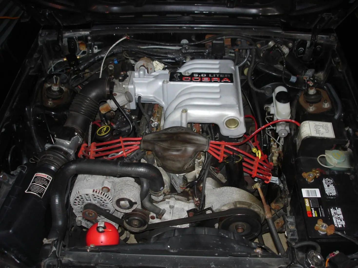

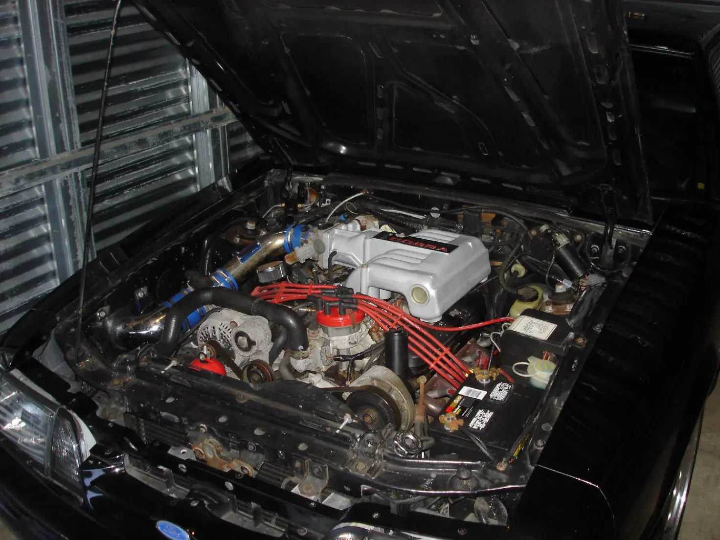

BTW, here's a shot of the engine bay as it sits. Notice a bit of it is rusty. Over the winter, i'll be sanding and painting the brackets and trim and whatnot. I just am too busy driving the car now to yank it apart.
I'll be going to BLACK Ford racing wires, i put my stock dist boot back on, the OEM airbox is going in, ditched the valve cover breather, and i'll be either repainting the valve covers or buying a set of black "MUSTANG" valve covers. I'll also be reinstalling the A/C.

So i cleaned up the accel coil that was original in there and put it back. Car def still hesitates or breaks up a little over 4000RPM. Prob TFI or pick-up related. I snagged about 5 Ford TFI's from the boneyard during the week, and 3 tested near new, so maybe i'll swap one in. I would have done it today, but my friend has my timing light and i need to move the dizzy to take the TFI off as you can see below.
I put the stock airbox in today, with the SN95 70MM MAF. Def a cleanerf look to it than the rusty BBK metal tube. I'm just wanting from new rubber posts to secure the box come in from LRS before it's complete.

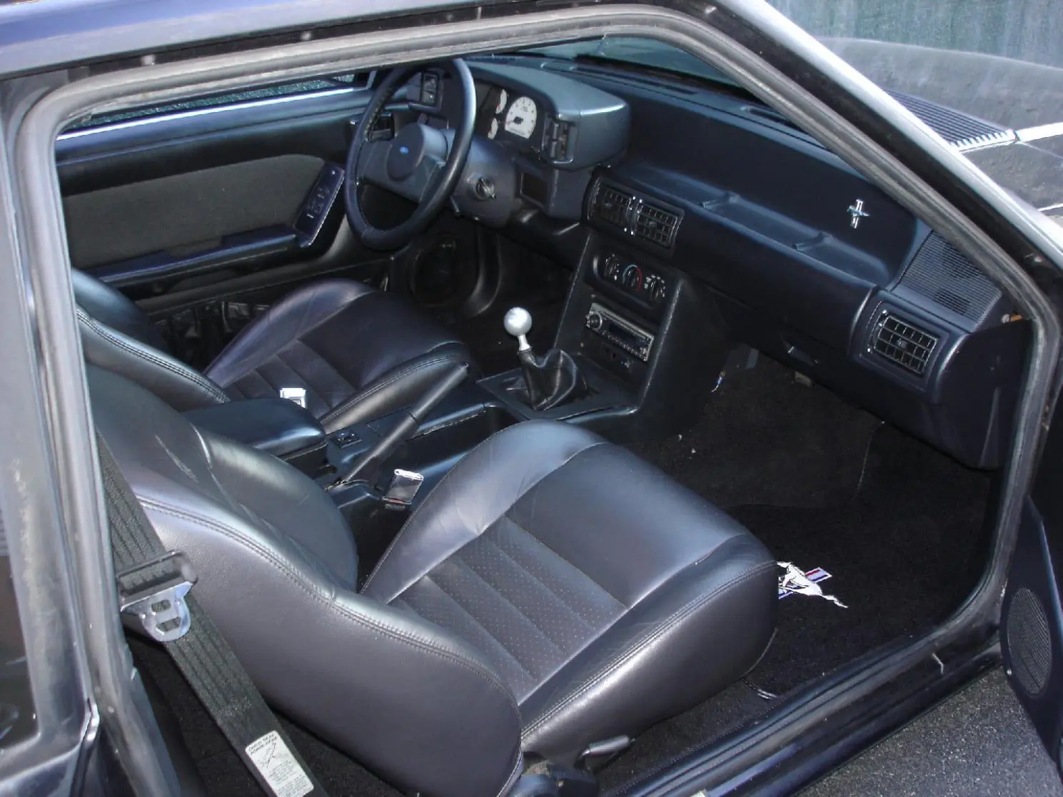

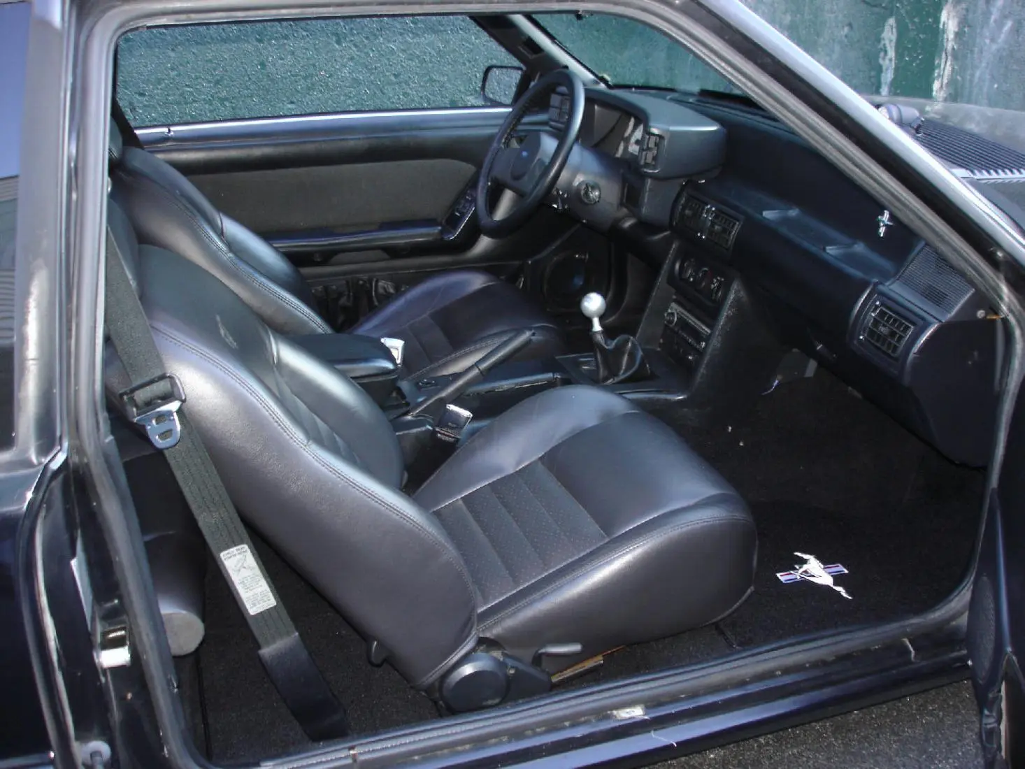

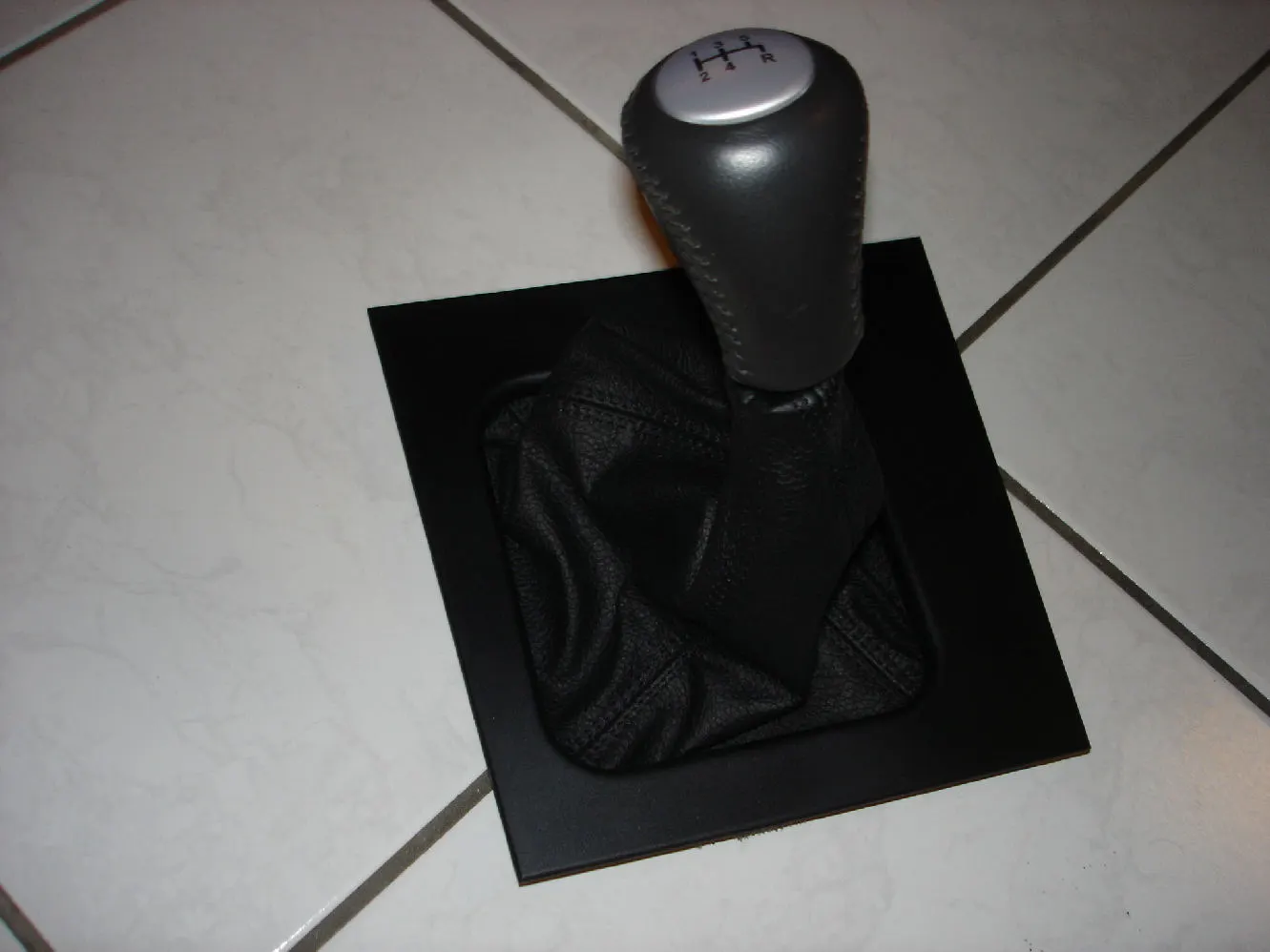

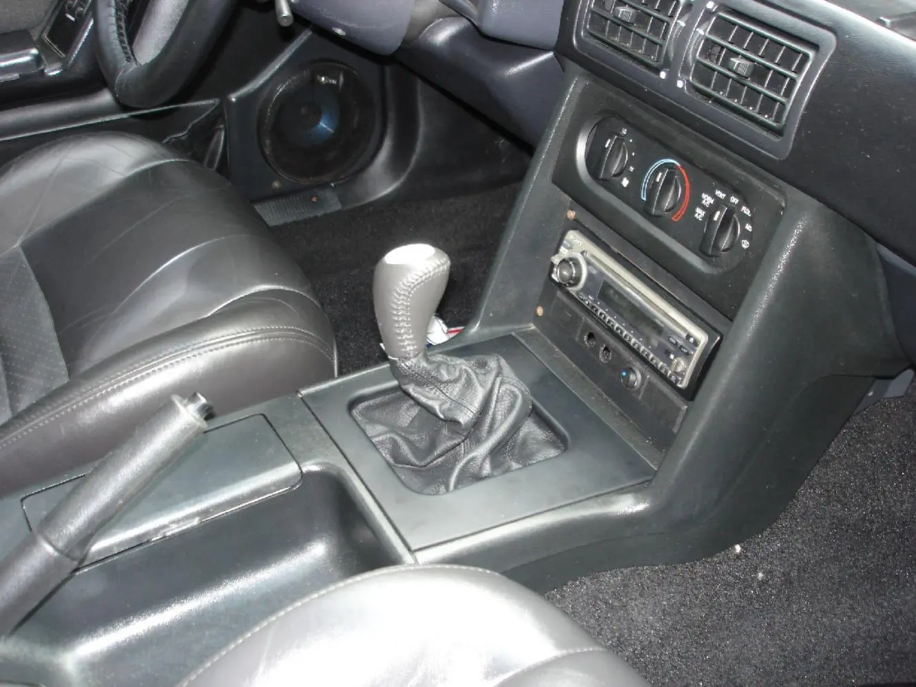

Okay, finally got the right color shift boot. Installed on a new shifter bezel from LRS and finally installed in the car. I swapped my Mach 1 shift knob to a 5-spd Cobra knob.
All that's left to do in the interior is install my gauges under the radio
attachment.php
attachment.php
I got a lot accomplished this year. If you look back, it was roughly 1 year ago that I started this project by pulling my rear axle out. So it's come a LONG way. Putting the car away for the winter.
Time to start gathering more mods for the spring! :)
attachment.php
What I did was this. I never attached the grey one. I just mocked it up.
For the black one I used, i had to cannibalize my OEM shift boot. I ripped the metal trim ring off the bottom. I also used a BRAND NEW shifter bezel. WHat I did was line up the 4 holes for the shift boot with the 4 guide pins, and then put the black ring on top and melted the plastic pins over. Peice of cake when you have a new shifter bezel. If you are reusing your old one, you'll have to make sure you have enough material to melt over when you reinstall.
Where the boot meets the shift knob--I just folded it in on itself. In other words, take the tip, and stuff it back down into the shift boot. I stuck it in about 1" and then slipped it over the shifter. I also took the rubber ring from the OEM boot and slipped it over the shifter first to hold it up tight. Took a couple tries to screw the knob on and keep it from twisting, but once together it stays put. It also fattens the tip up a bit so it meets the profile of the knob better. No glue needed for me, and i'm not even sure you need the black ring from an OEM shift boot so i wouldn't sweat it.
Closer pic.

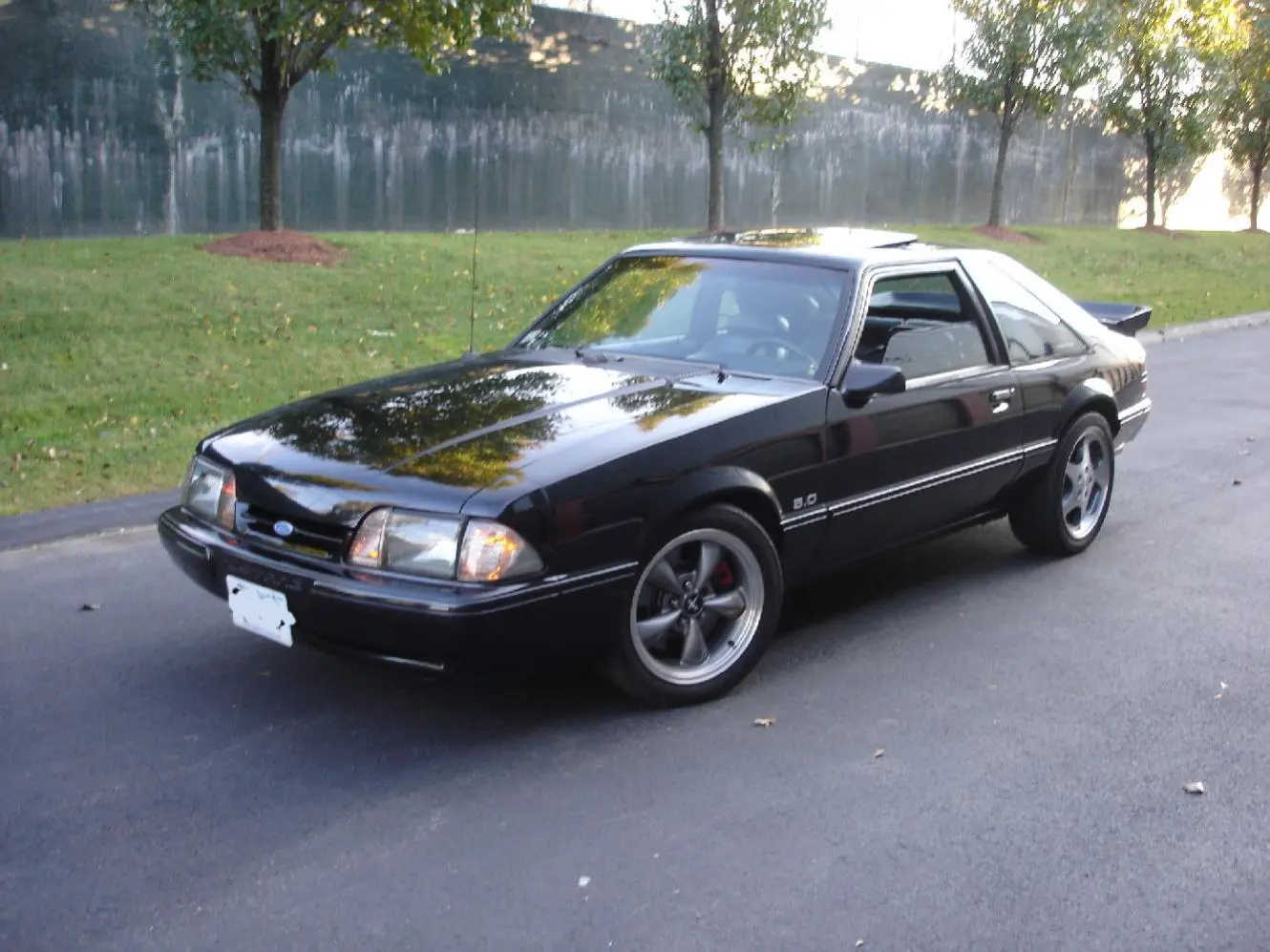

Today was a nice sunny Nov day in the 50's, so i took the car out. I know i said it was away, but until there is salt on the road, every weekend is fair game.
Just went for a spin for an hour, topped off the gas tank, added more stablizer, and got the usual round of questions and comments as I drove around. I dunno about you guys, but i love seeing other guys do a full turn in their seat to check out the car like it was some hot blonde who's top accidentally fell off! Big ego boost! :D

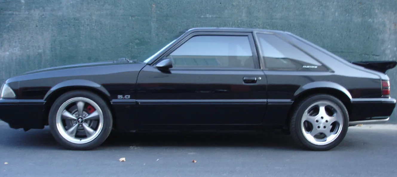

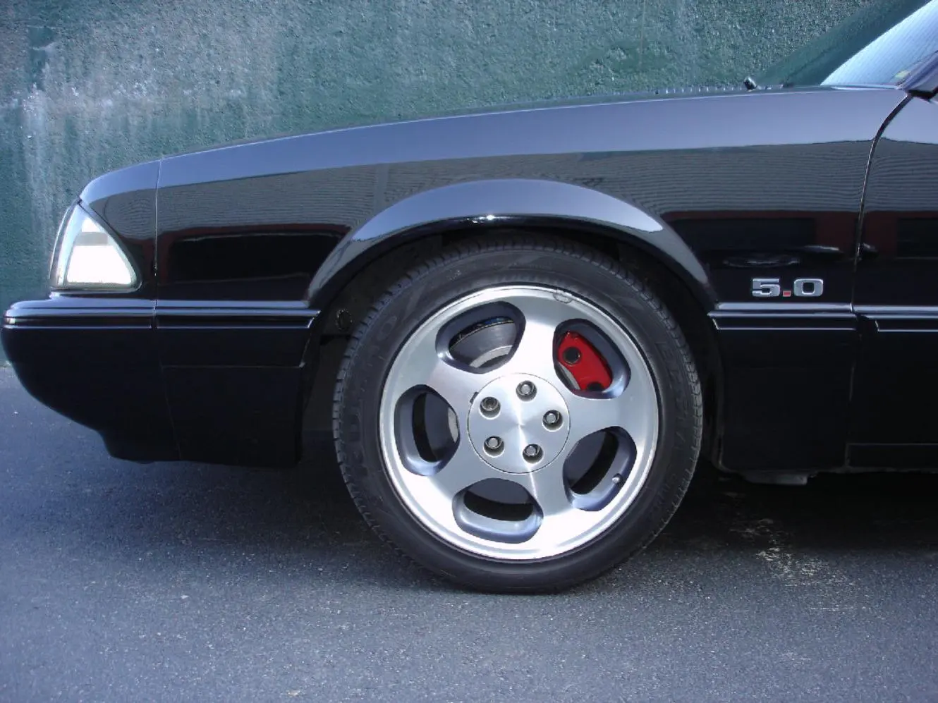

ANyway, since i had one of my bullitt wheels on with a tire, i decided to see how it would look.
'97 Cobra wheels
attachment.php
'03 Bullitt wheel
attachment.php
Personally, i prefer the bullitt wheels, but even i don't think they are right for my car. But i'll rock them for a while until i decide on the right wheel. Unfortunately i only have 3 so far :(
