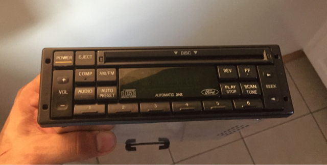

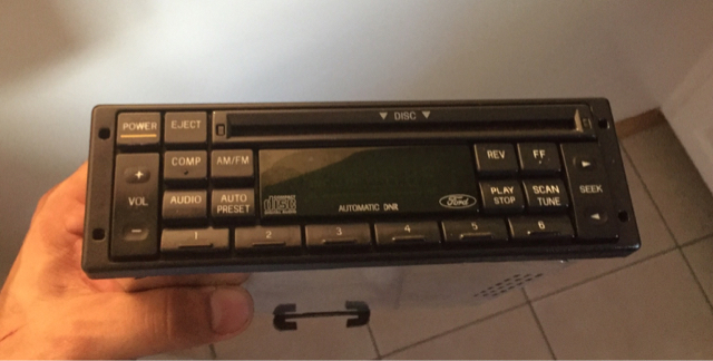

Technically it's a contour radio, which is why it flew under the radar and I got it for $50.
It's a backup for my OEM 1993 mustang CD player. Those radios sell for $300+ these days. If mine ever dies, I can swap the faceplate and bottom tray and it will slide right in
Yeah, I know it's a crappy oem radio...but it's a rare crappy oem radio. I don't even own CDs anymore

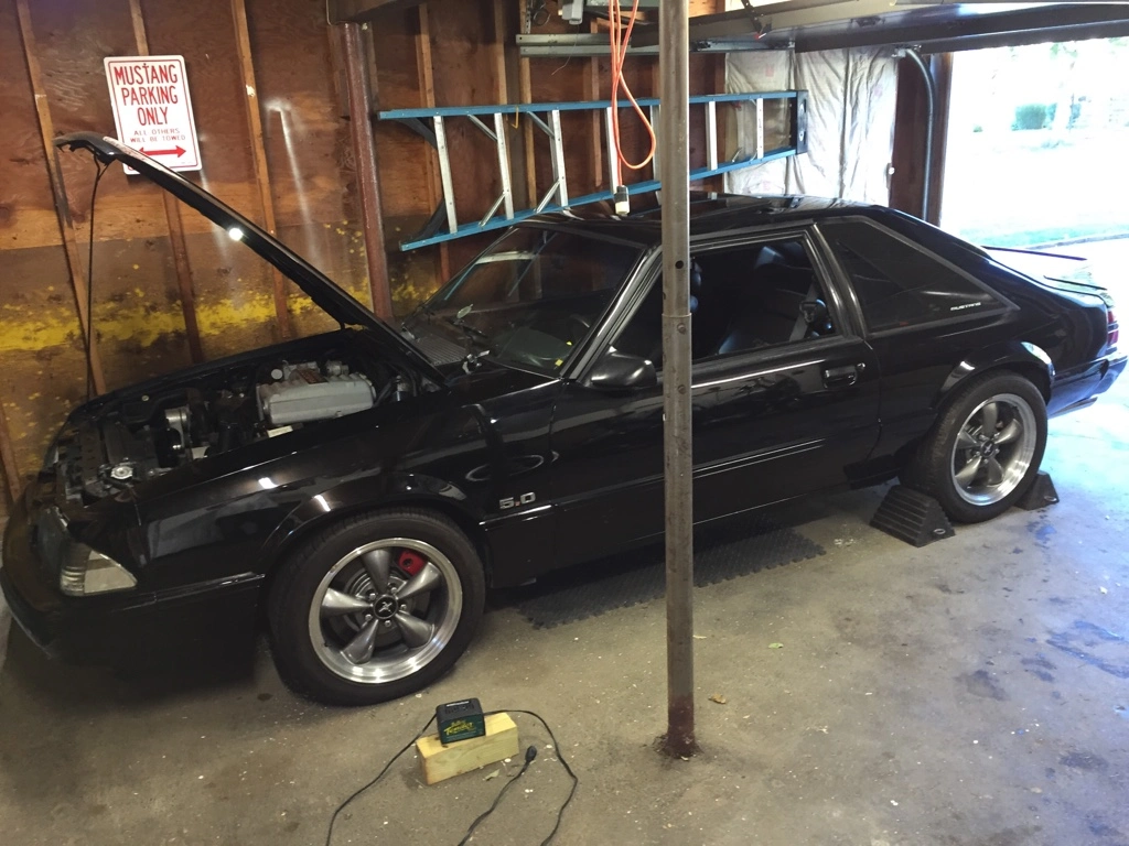

Welp, found my battery troubles. Battery tested fine. Trickle charger was working, but 3-4 days of sitting off the charger and there wasn't enough power to crank.
Well. Discovered that's because one of the vanity mirror lights wasn't turning off. Hard to notice cuz I keep a cover on it most of the time. I had discovered I had never plugged then in a few weeks back..so I did. Now I know why I left them unplugged. Anyway, glad to sort that out. Now to chase down my vac leak.

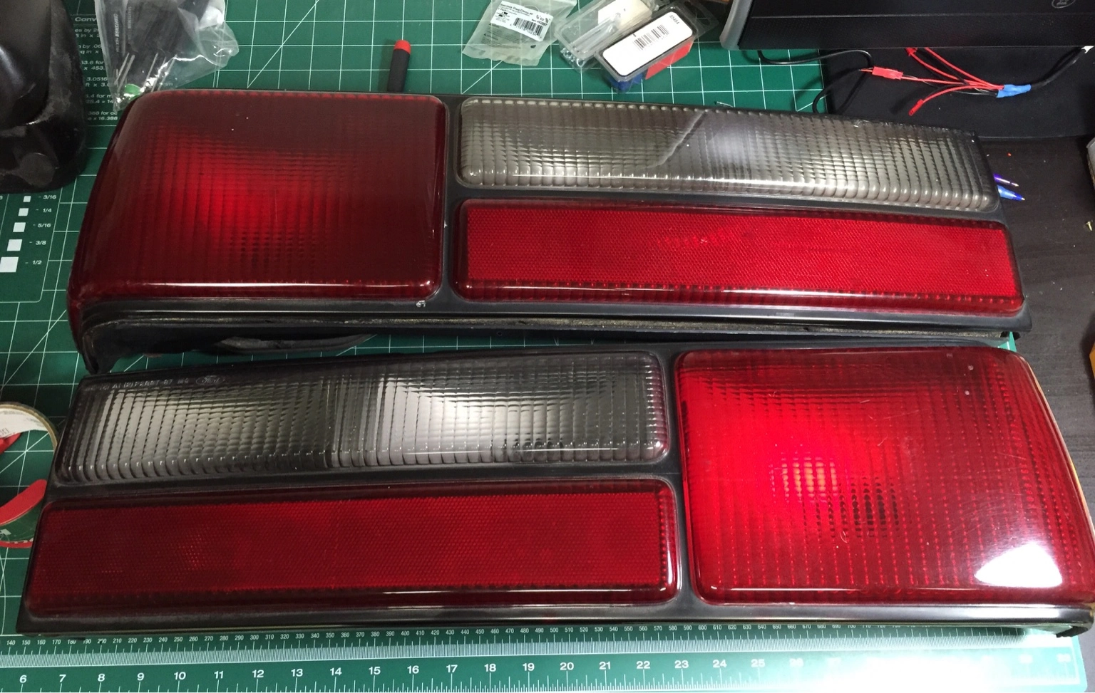

Craigslist score. $20 and the guy lived around the corner from me. Absolutely mint. Couldn't get myself over there fast enough.
I'll eBay my other set, which are in worse shape. Part of why I wasn't in a rush to get them on.

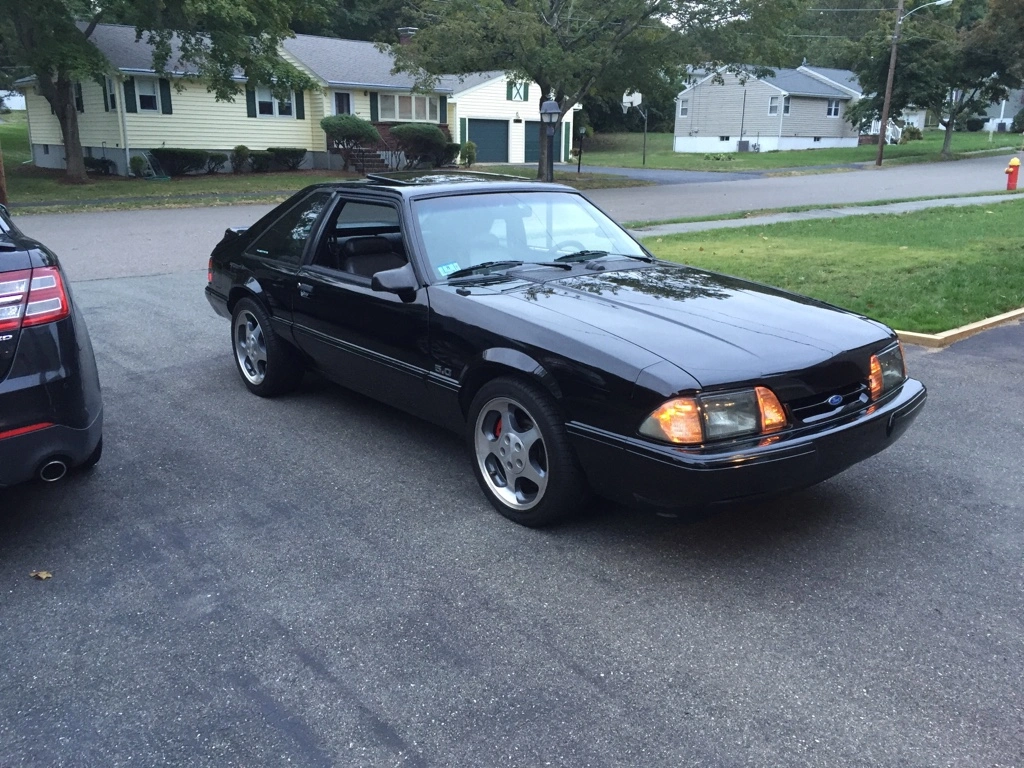

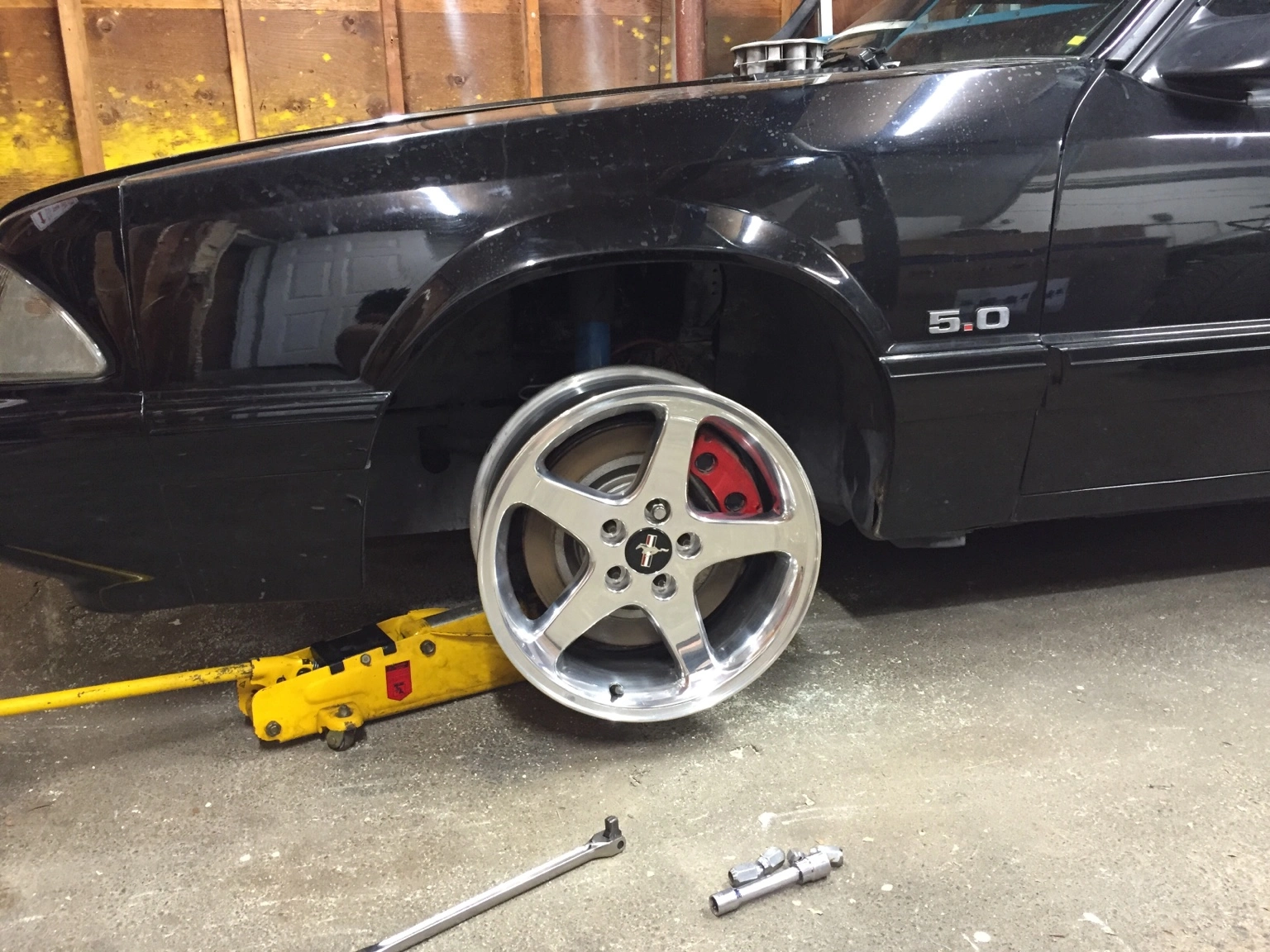

Ok. Still haven't settled on my wheel scenario, but I keep going back to a classic favorite. I had these on my 2003 GT and loved them.
I had a single wheel so I threw it on. I think I like it. Need 3 more though...and tires.
I know everyone and their mom has Bullitt wheels, But I like it...a lot. I'll have to dress up the brakes though.
Sent from my big ass iPhone 6 using Tapatalk

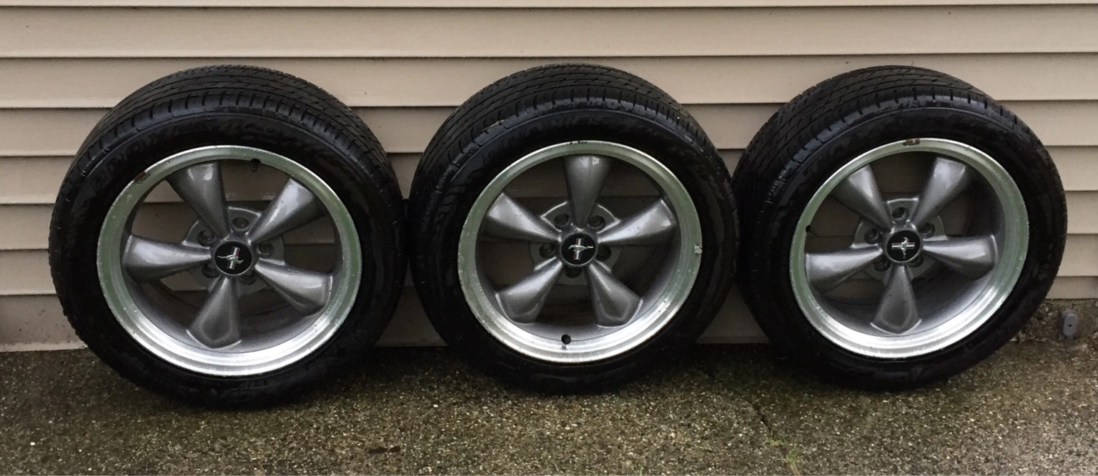

Ok. Well I lucked out. Scored 3 bullitt wheels, with relatively new Toyo Proxes Plus tires on them for pretty cheap. They were the 03-04 versions as well.
He gave me the 4th rim, but the rim was trashed, and the tire was sliced. Not sure it's usable. I'll get pics later, as he nailed a curb.
So anyway, I'm just 1 tire away from a set of 4.

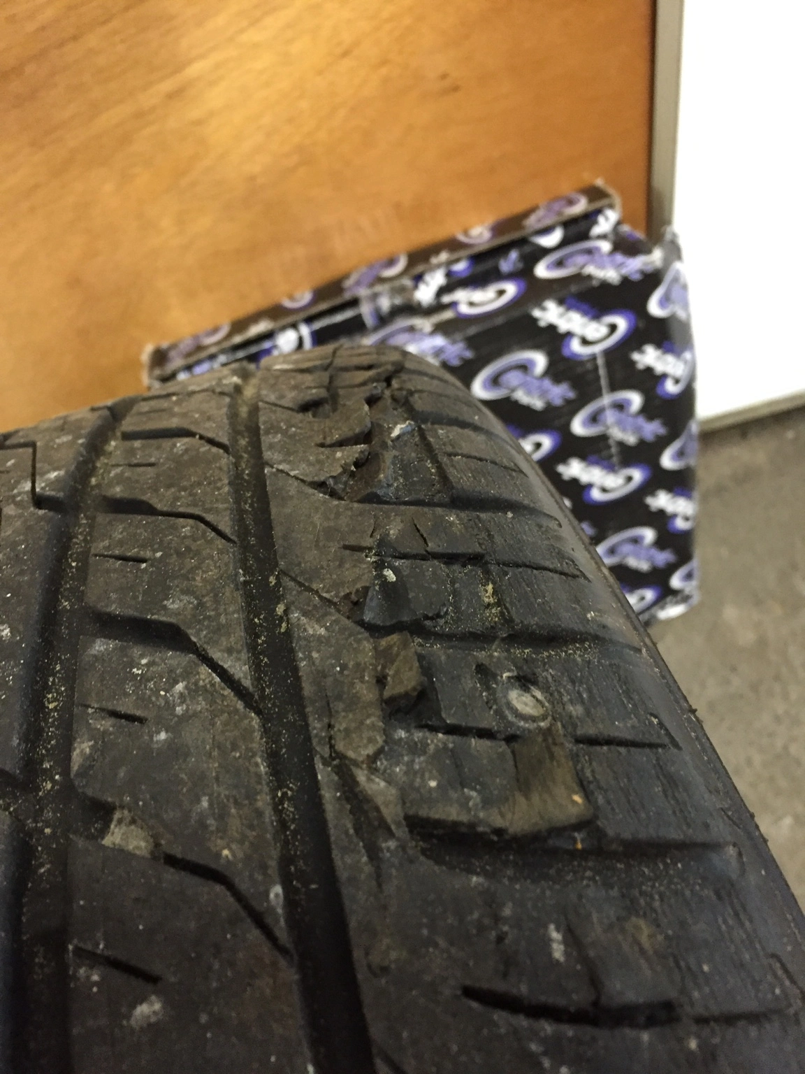

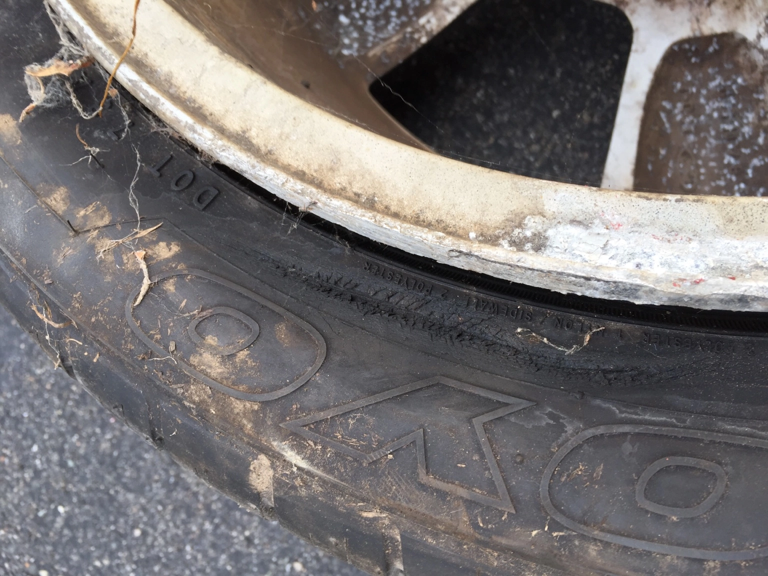

Tires? They were toyo proxes 4 plus. $200 a tire. When I replied to the CL add, thought all 4 were good. On site. The tire on the trashed wheel had a cut in sidewall. Upon getting home, looks like one tire got scraped up pretty good.
It's like that all the way around. Mostly shallow but a few go to the full depth of tread block. Not worth risking in my opinion.
Other two tires are good, so looks like I need two tires. What should I get?

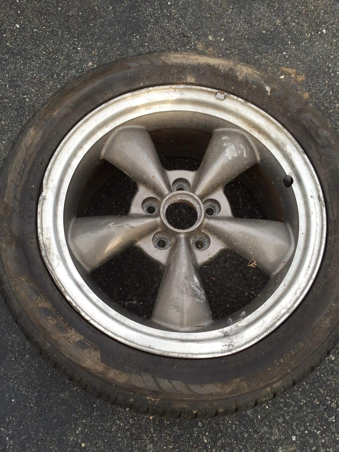

Oh, as for the 4th rim?
Not sure if that damage is all the way through, but again not taking a chance. I'd rather just buy two tires. Maybe get some 255/45/17s for the rear

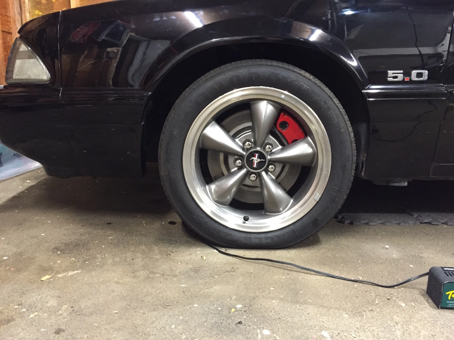

Well, that iron X is nasty smelling stuff, but works well. Smells like cat piss and skunk spray mixed into one. Anyway, did a great job cleaning the wheels up.
As for the brakes, got them cleaned up. Since I couldn't put evoigh pressure on the brakes for long to clean them, I instead just pressed the brakes while driving to "scrub" them. Worked pretty good and the pulsations are nearly gone.

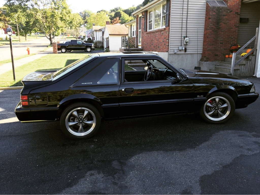

Decided to toss the Bullitt wheels on today. Still need rear tires, but wanted to see how it would look. I like

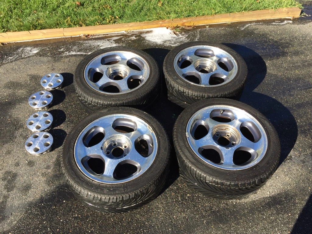

Gotta say, that iron-X is some good stuff. I cleaned up the cobra wheels with it, and they haven't looked this good in a while. The entire wheel turned purple when I sprayed it down, and they were spotless when done.
Almost temped to get some polish and shine then up.

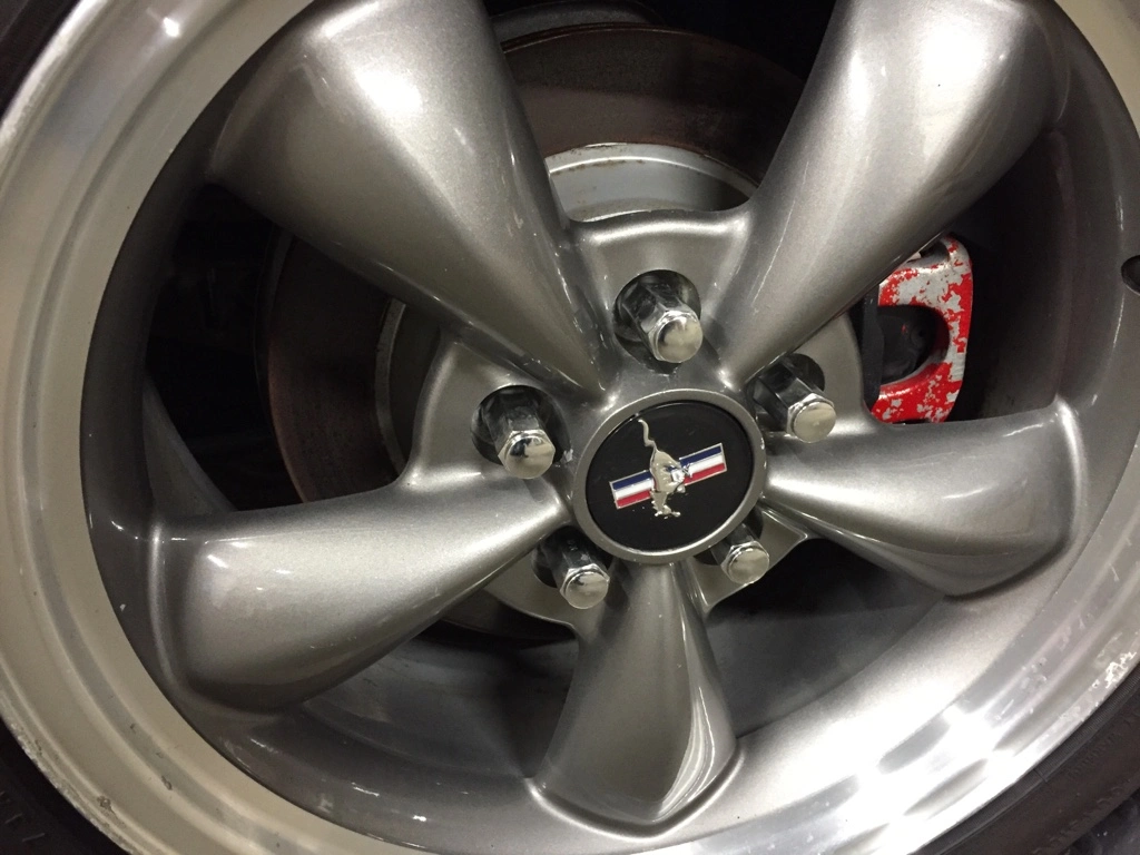

Here's a good shot of the backside of one of my Bullitt wheels. This was black when I got them. Now you can see the bare rim behind the spokes. They look practically new.
Highly recommend this stuff. Just don't use it on painted calipers. Ended up flaking it off a tad. I need to redo them anyway

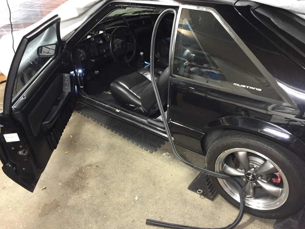

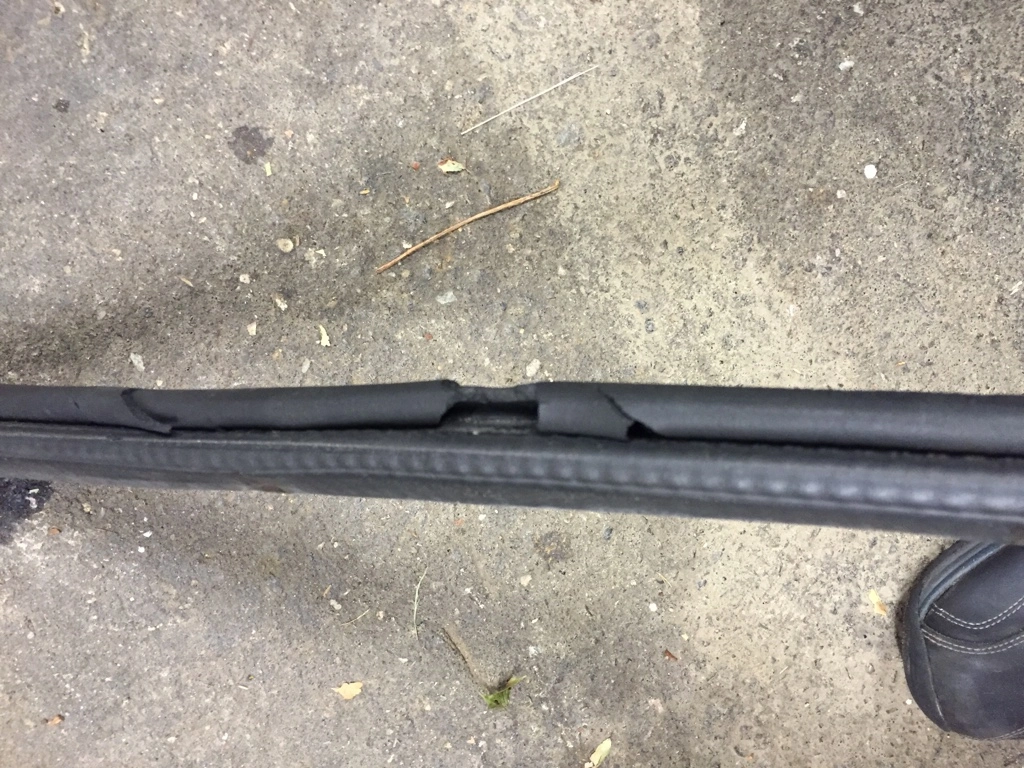

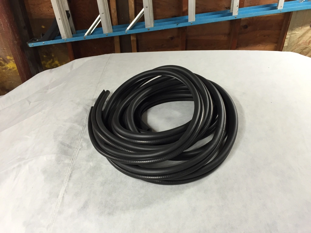

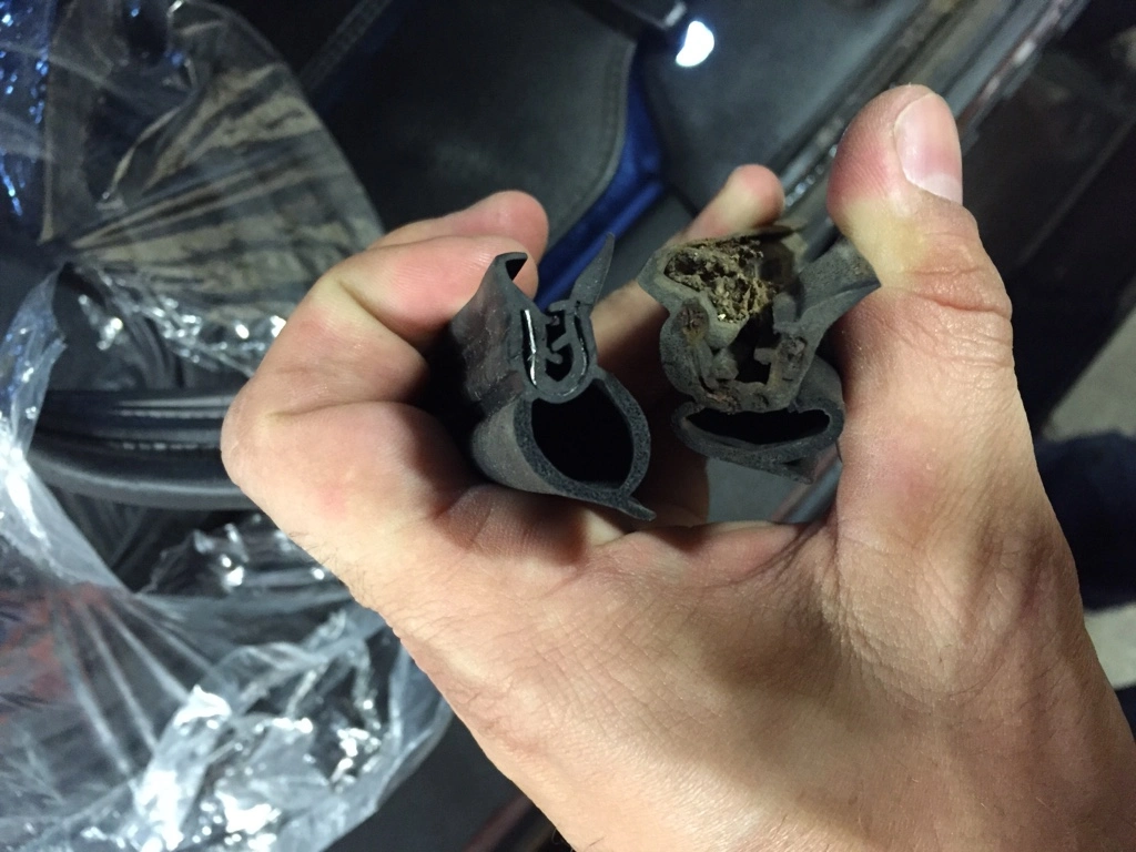

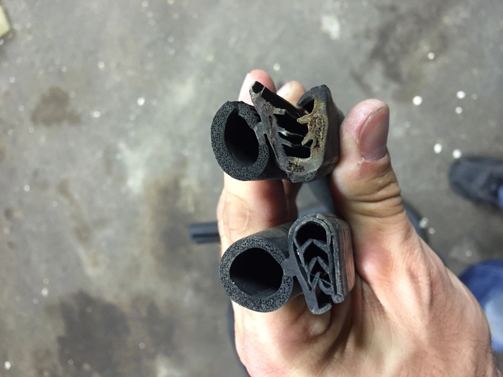

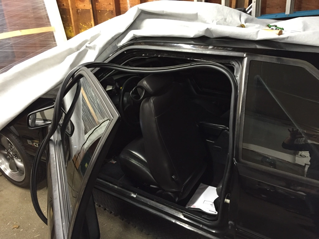

Ended up ordering the hatch seal last night after doing this. Not in bad shape, but figure it as cheap enough. I honestly hesitated on this because I figured torn OEM seal > new aftermarket. I was wrong. The seal is pretty damn good.
After the install, the door is slightly harder to close due to the old seal being compressed and this new one still being springy. Rather than adjust the striker, i'll just let the door naturaly compress the seal slightly for a period of time and readjust the striker at a later date.
Going to go through the rest of my seals and trims. For the most part everything is in good shape as it was replaced with OEM stuff back in 2000 when I had the car repainted. I think my sunroof seal could use a new seal.

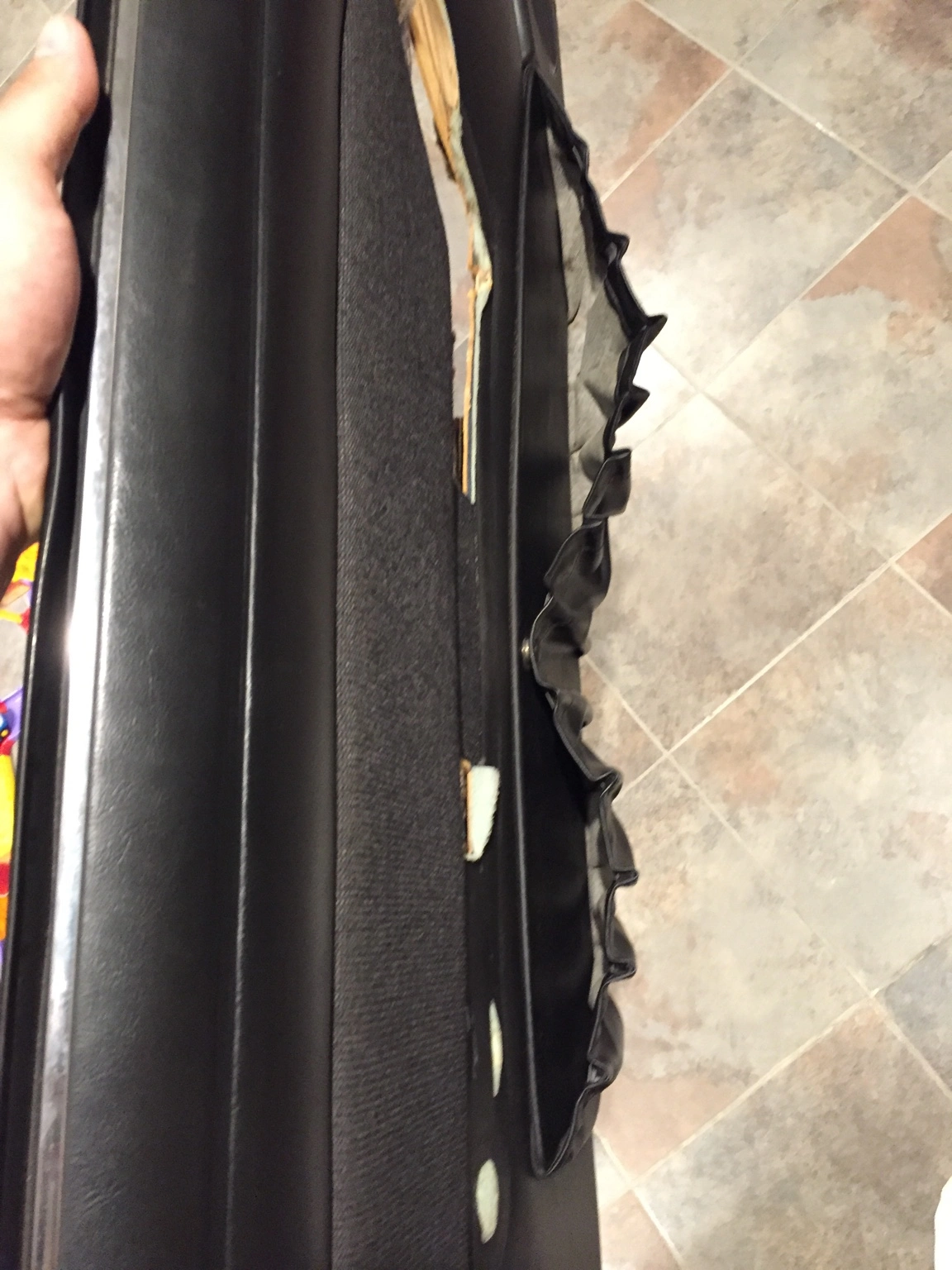

I still gotta tackle replacing the door spring as well.
Well, my sunroof seals are in really good shape. Tough to justify replacing them.
Got the hatch seal in. Didn't install yet because I need to pull the tops of the rear panels off slightly, so I'll do it another night because I'll probable also need to adjust striker.
But, cut is pretty good. Looks and feels like oem.
