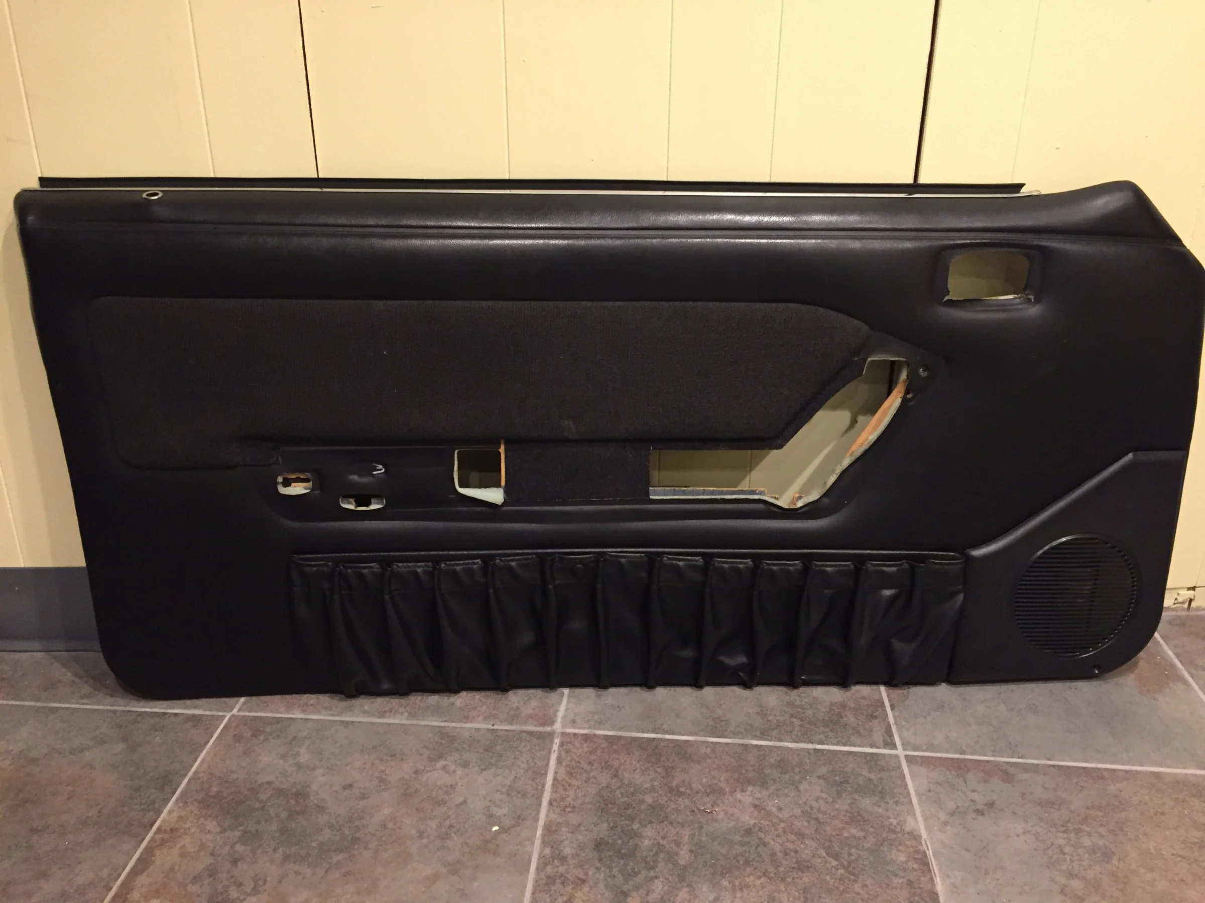

Eh, I ordered the inner plastic and door panel sound deadened from LRS. It was on sale. Meh

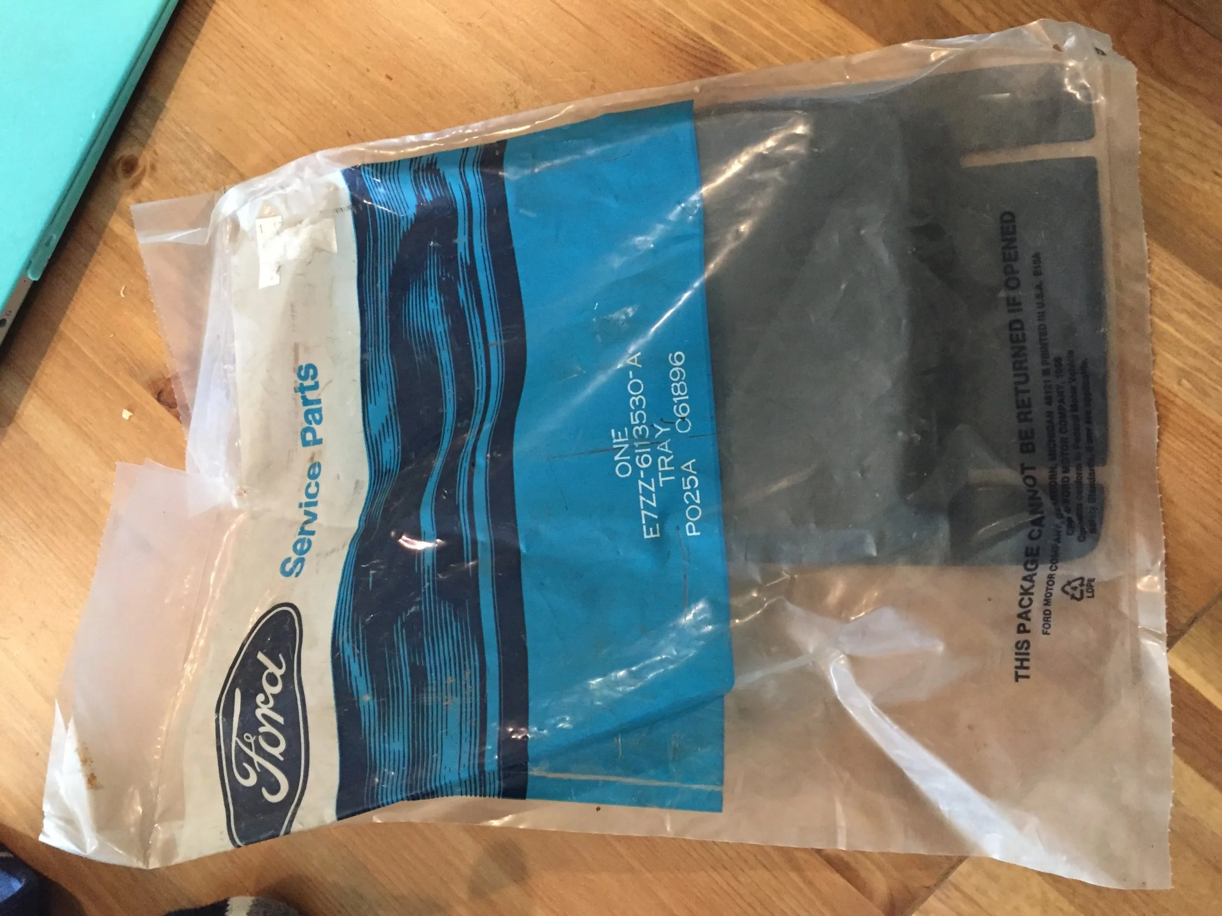

eBay snag.
I have alerts out for various NOS parts and such and if something is cheap I'll snag it up for my car or to save. I prefer all Ford parts on my car if I can avoid Chinese junk
I can see a "1993" mold date on it
I currently have a LRS repro on my car that actually looks fairly good minus not having the foam.

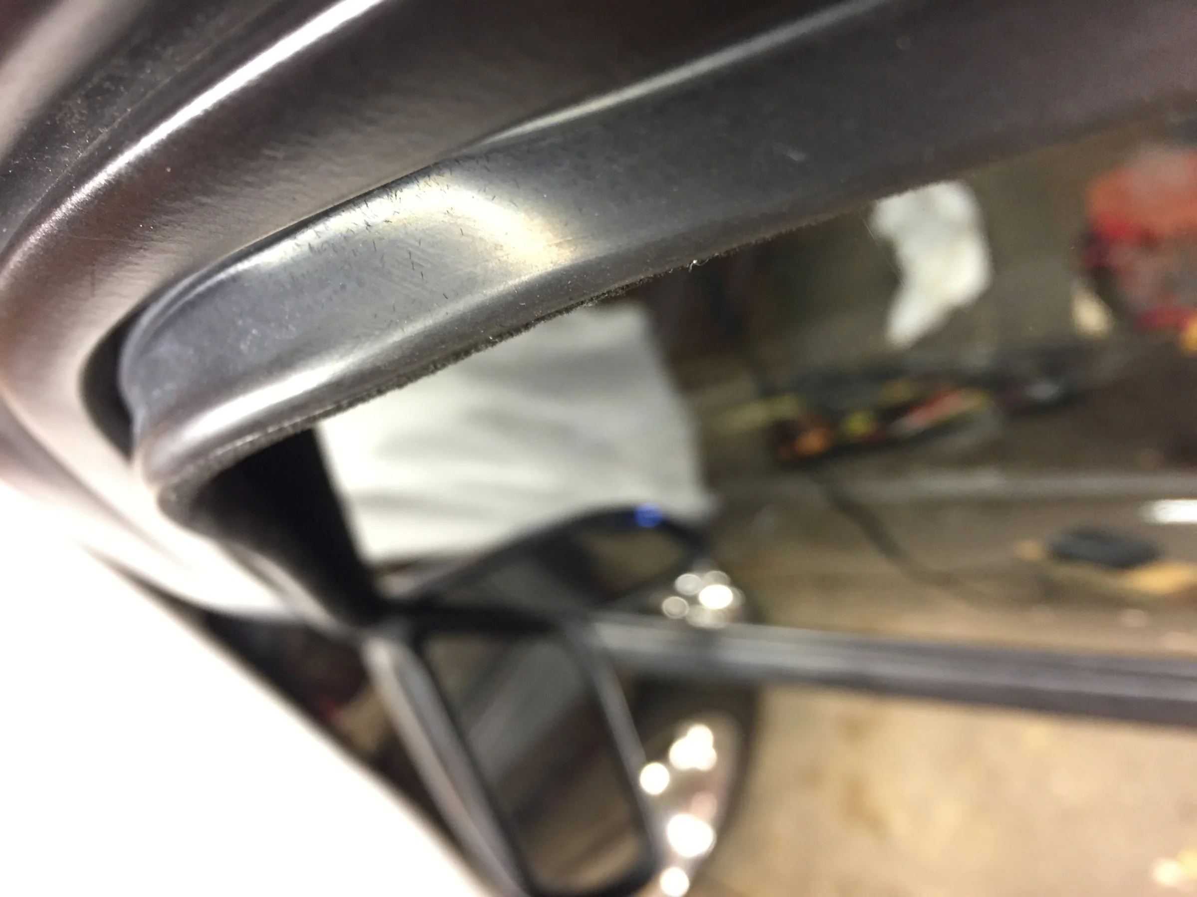

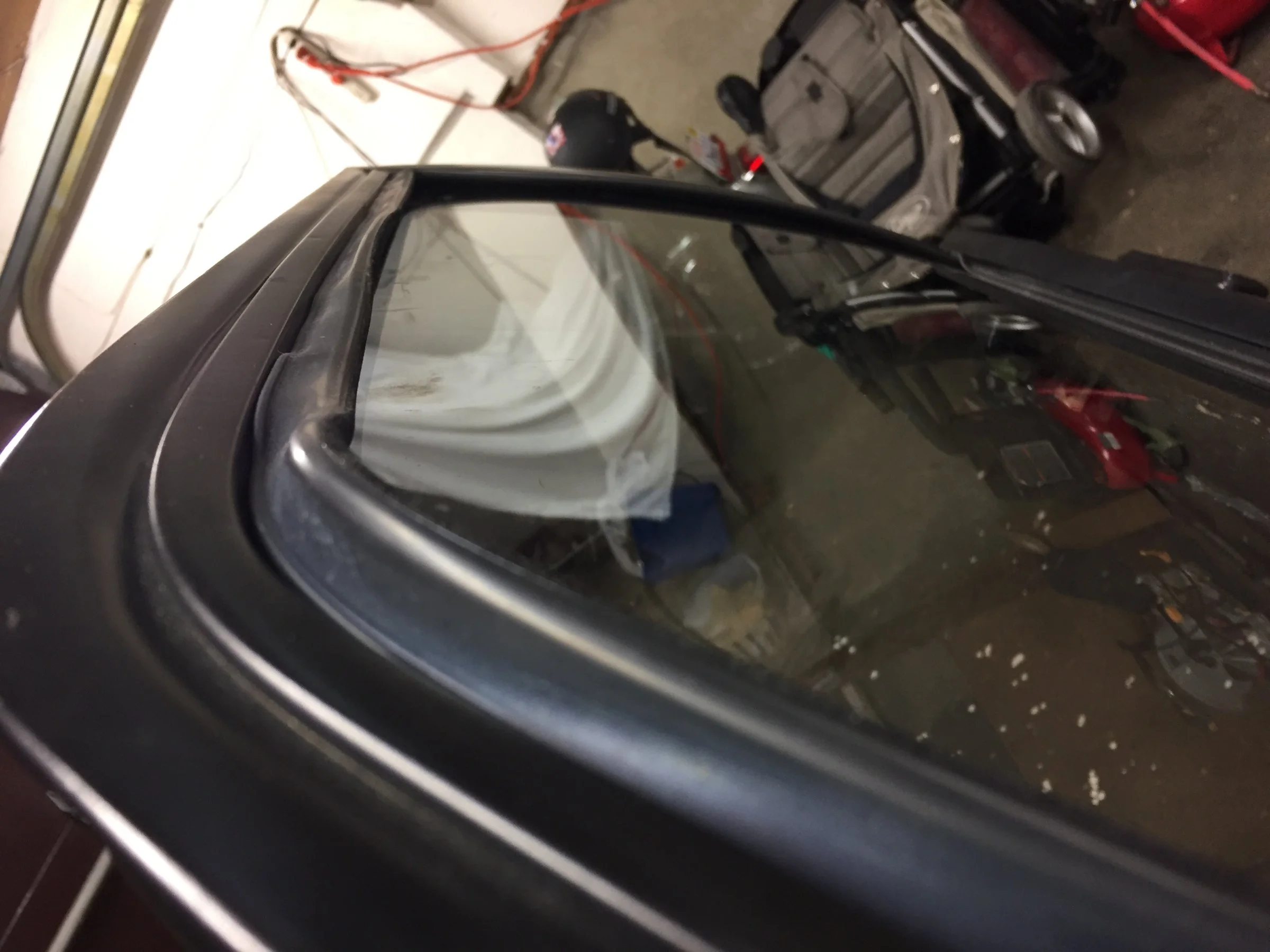

Ok, drivers door done!
Window guide bushings...not a bad job. But those two plastic clips make a huge difference! Window was much more stable after I changed them out. Had to run out for some grease for the rod so the window could move easily again.
Run channel molding? A bit trickier than the video makes it seem, especially in the front of the door. In hindsight, I should have left mine alone. The LRS run channel is ok quality but the fit is not perfect.
It's a job that takes you forever the first time but you can breeze through the second time...I know cuz o had to do it twice.
After getting it in, I was all set to write LRS a nasty gram. Look at this fit
It looked like crap, and I spent a good hour wrestling it before I realized...
I had the wrong side!
Of course, second time around took me 10 mins to do. Fit was better, but not perfect. Biggest complaint now is the window struggles that last 1/2" or so to seat. Not sure it's fully seated either. I'm sure it will get better as the mollding wears with use. My window motor probably could be changed out too, but I'd rather not if I don't have to.
Overall, I should have done bushings and called it a day. I may leave the other side alone and just do bushings and general window adjustment.

90sickfox said:
When I put my run channels in I had to remove the outer window trim that runs up to the mirror and the mirror. Not the dew wipe but the trim that slides on to the round clips. That was the only way I could get the end furthest from the mirror to fit correctly. Before that my windows would drag.
I ended up playing with it some more tonight and did take that piece off. I think I've gotten it much better by playing with the corners where the widow from meets the door. Now maybe the last 1/2" of travel is slow, but it does close all the way. I'm happy with that.
I'll try some silicone spray in the grooves to help it slide better, but I think I've gotten it the best it's going to go.
I may not replace the other side. The drivers side one wasn't all that bad to begin with. Window bushings and an adjustment might be all I need

Silicone spray did the trick.
A few sprays in the channel, especially where the window frame meets the door did it. Now the window slides up and down all the way with a nice, satisfying, thud as it reaches full travel without slowing down.
This window hasn't been this solid since the car was new.

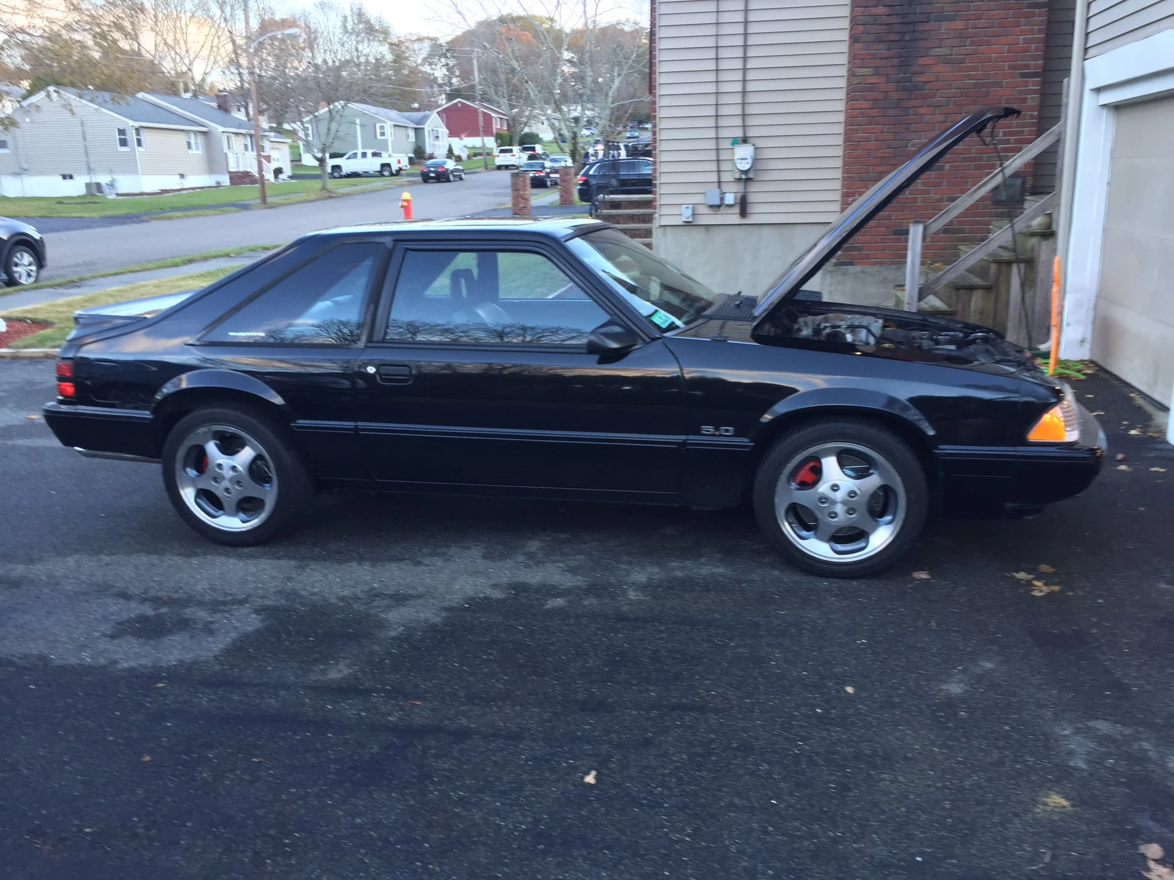

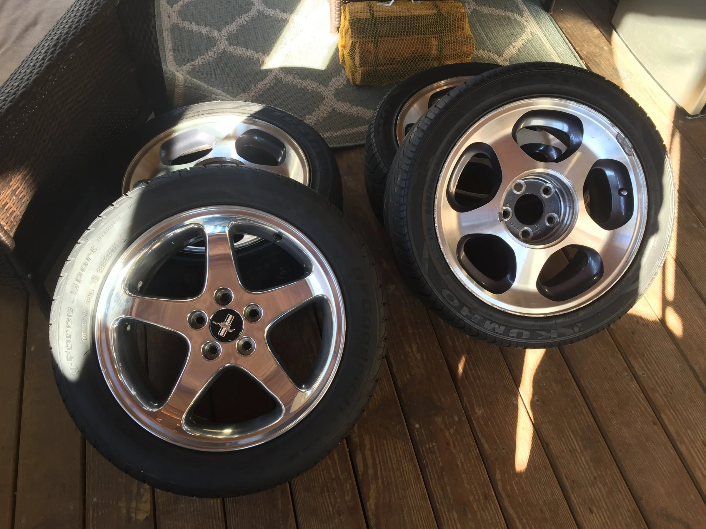

Time for wheel swap
Reactions: 90sickfox, RaggedGT and 02 281 GT
Mustang5L5
Mod Dude
Feb 18, 2001
43,333
18,059
224
Massachusetts
Nov 19, 2017
#807
  • Nov 19, 2017
  • #807
Miss the other wheels already

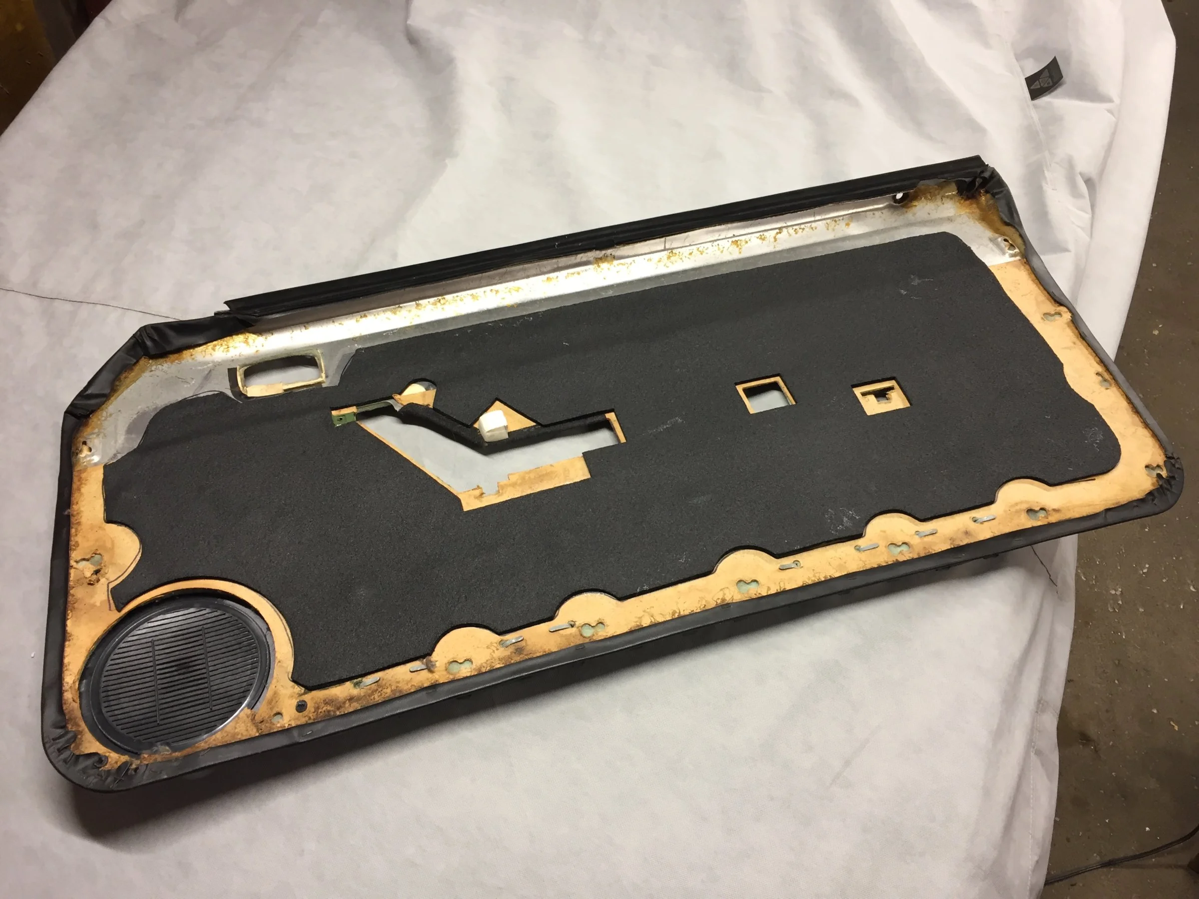

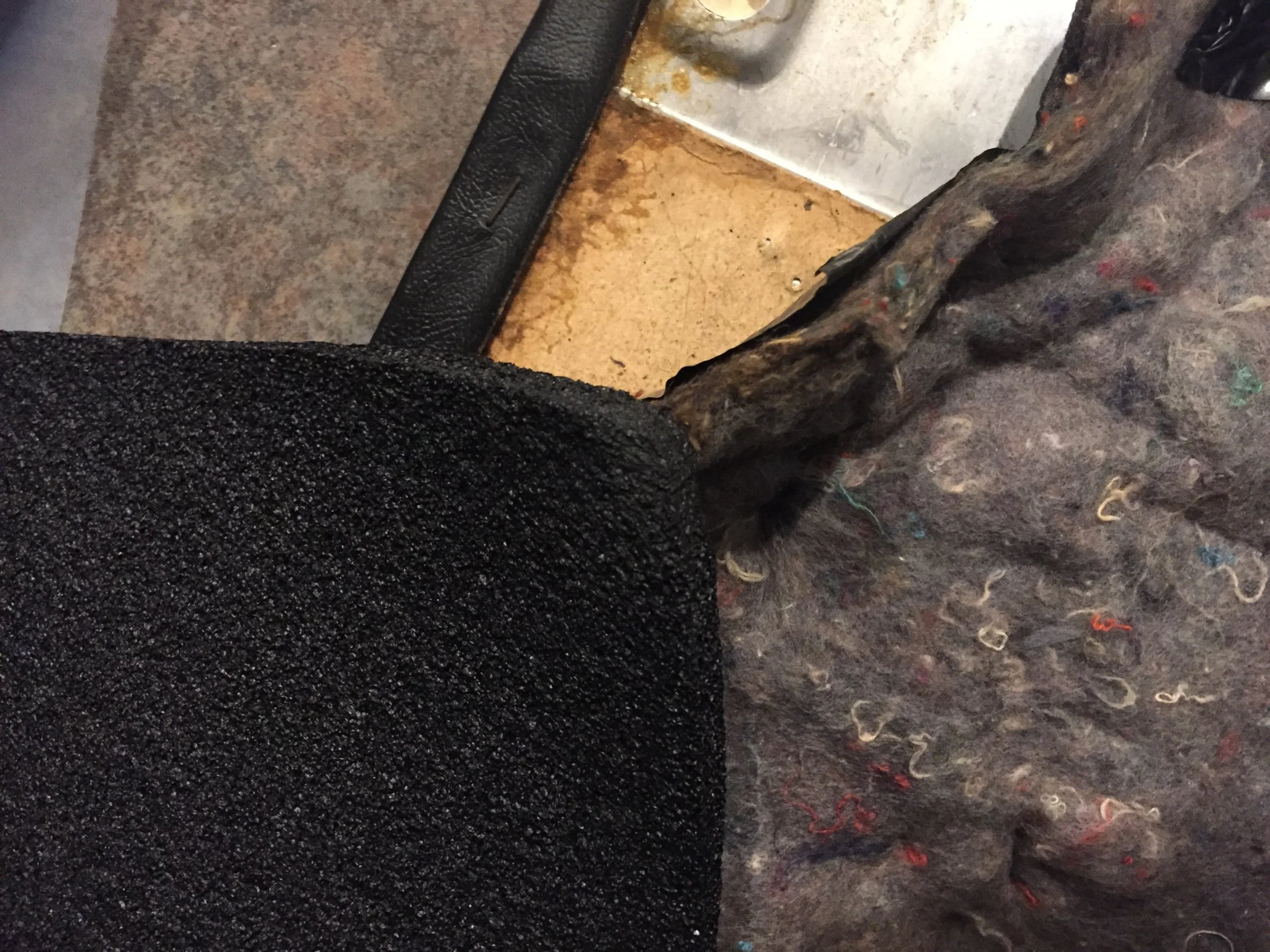

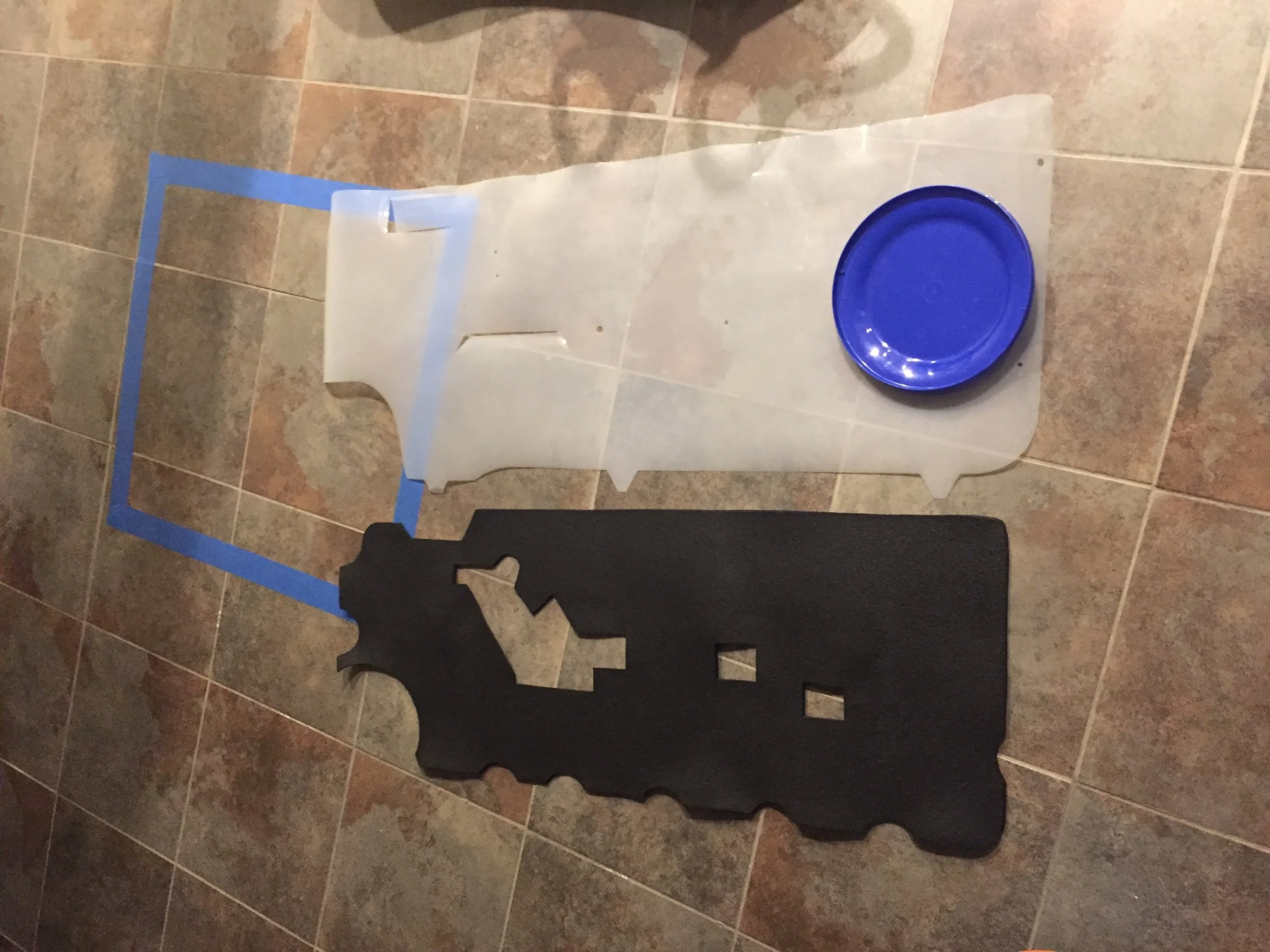

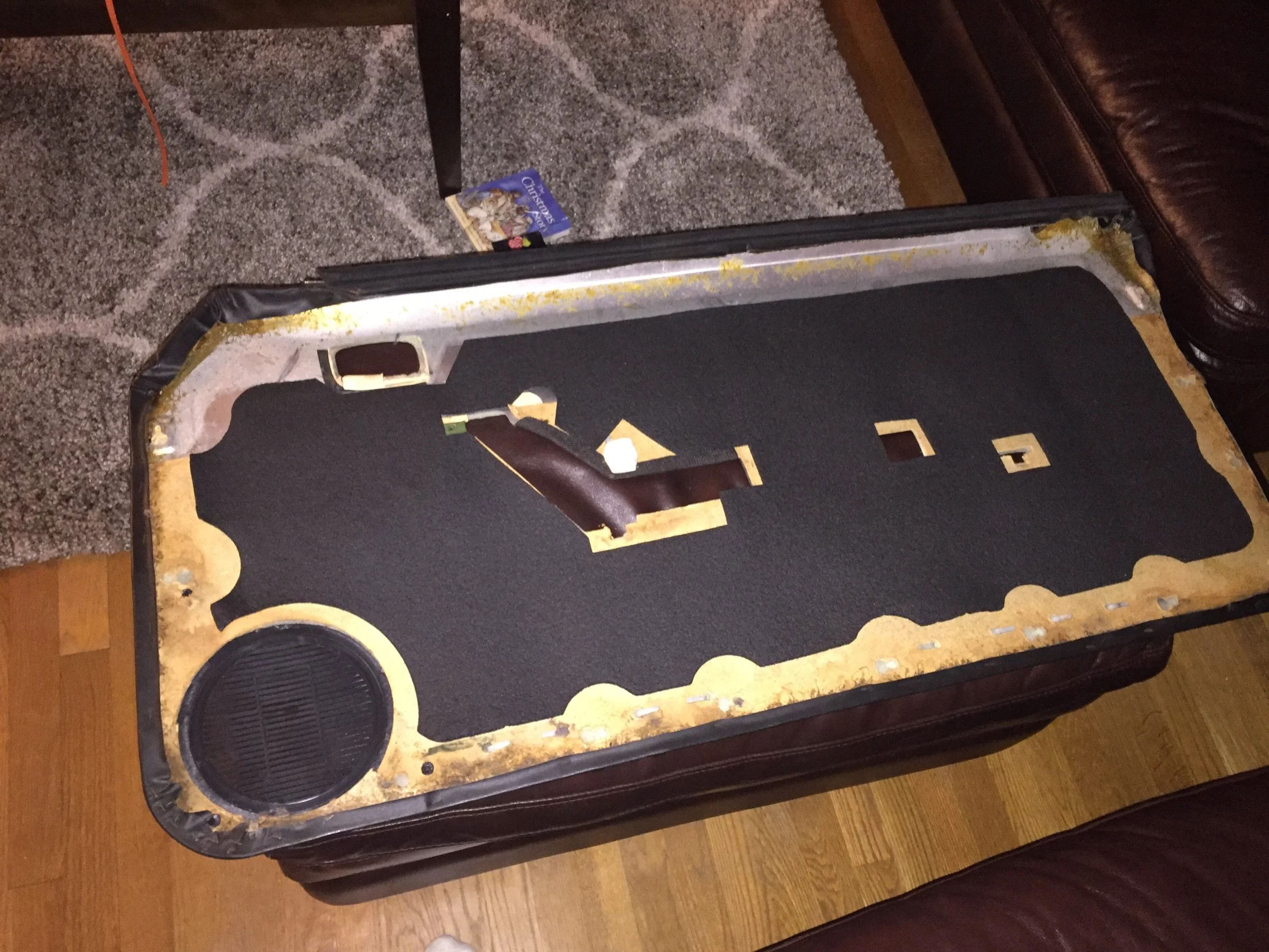

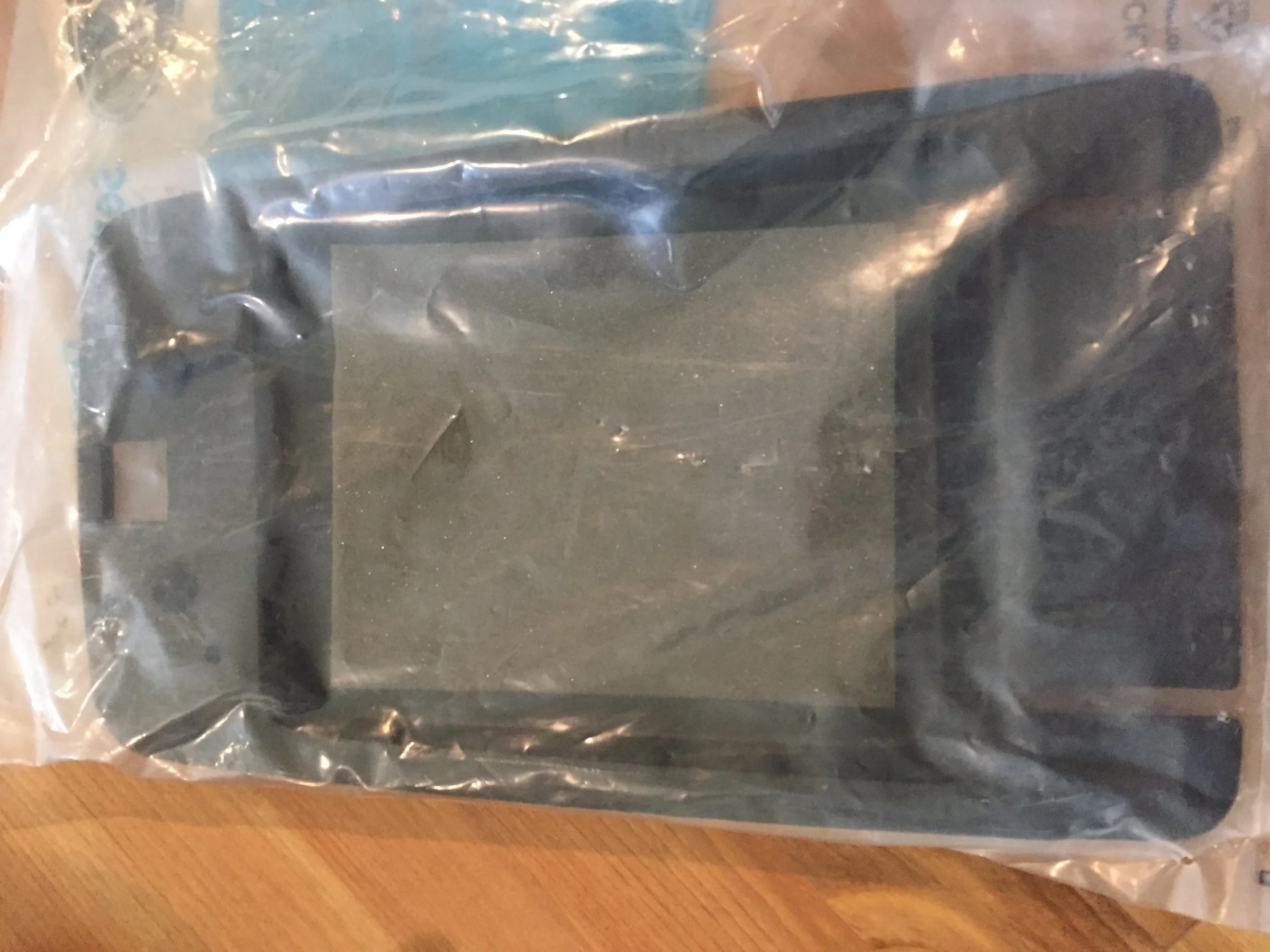

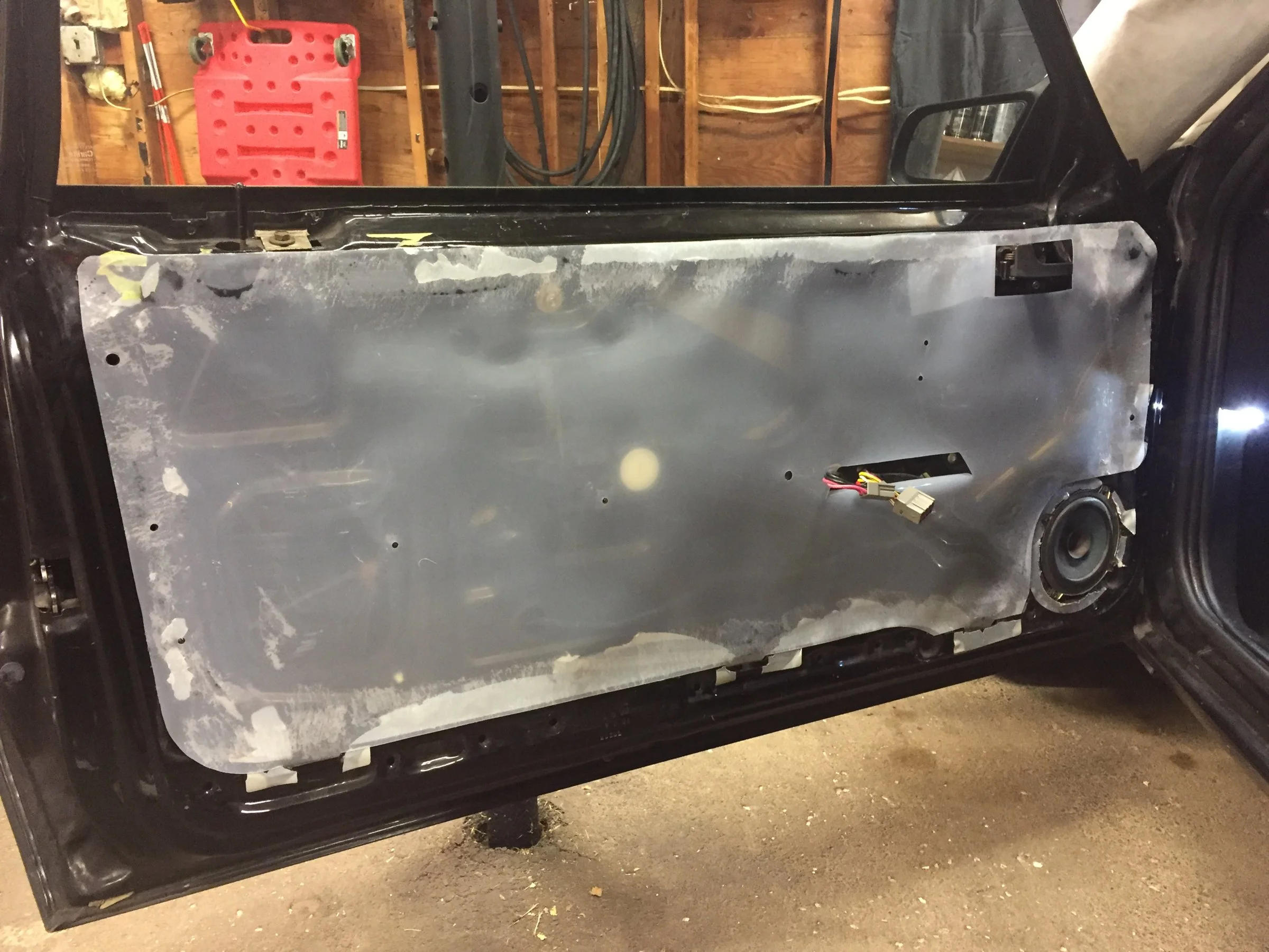

So the LRS vapor barrier and door card sound deadener showed up finally.
The vapor barrier is a much thicker plastic than the oem garbage bag, and the sound deadener is thicker than the oem garbage bag with fuzzy crap stuck to one side.
Now to actually see if the install is as easy as the LRS videos make it out to be.
Tracing my outline to pre-spray with some 3M adhesive spray
I don't know how effective it will be. I tried wrapping it around my head but I could still hear my wife yelling at me

Ok wasn't too bad. 3M super 90 spray adhevise sets up fast.
Vapor barrier was a bit tricky to line up the holes. A few spots had bends and wouldn't stick, but overall it's on there. I'll cut out the holes for push pins tomorrow
Door card insulation was easy. All of two minutes.
Ran out of time tonight so I'll install the door panel tomorrow. Got all new push pins for that.
So to recap my progress overall on this door:

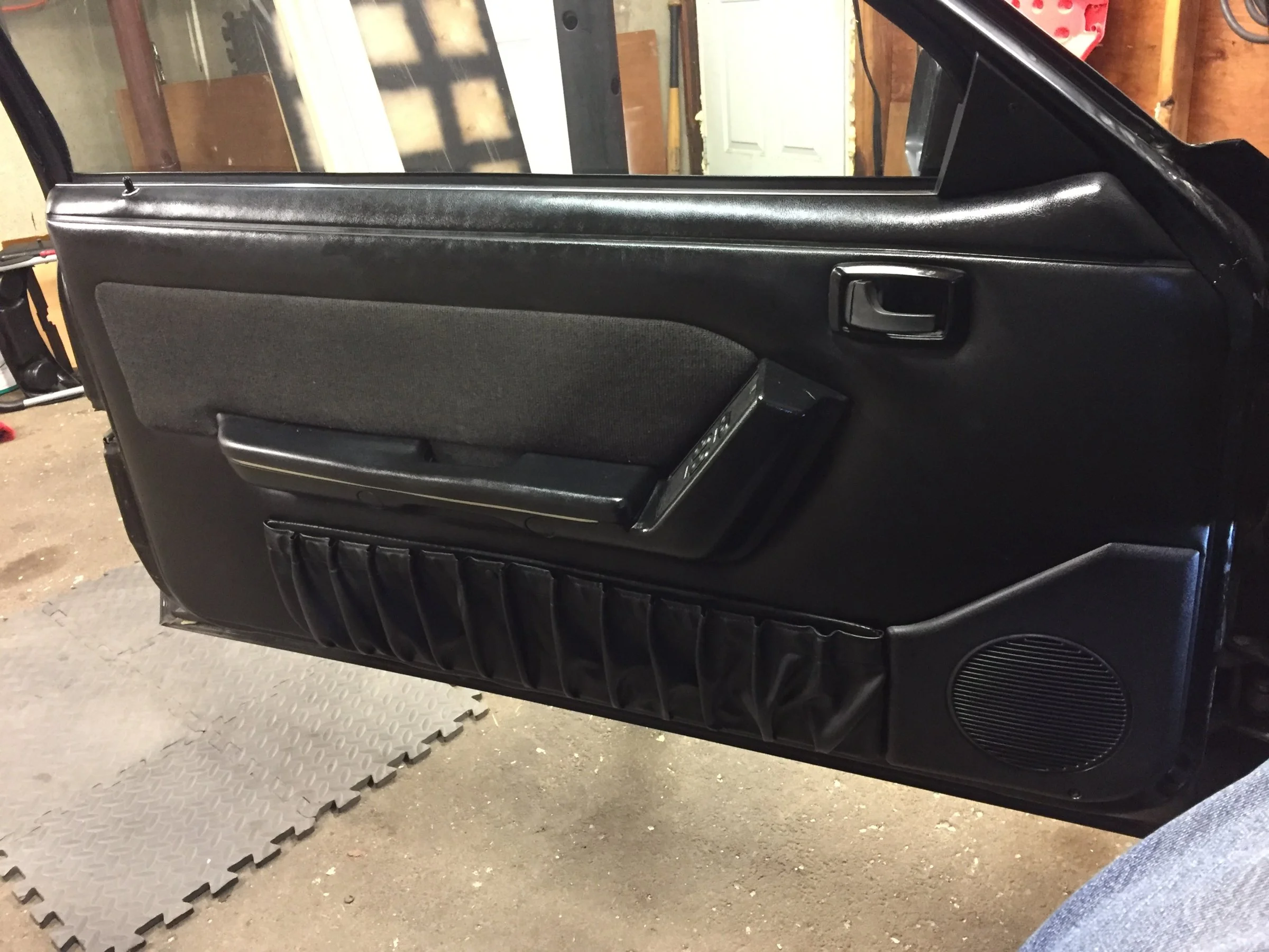

Door panel on. New clips, and every screw nice and tight. This door really is so much tighter now. Feels solid when I close it even with window half up. I don't even remember it feeling this good in a decade or two
For comparison, pass door now feels loose and rattles. But it's next
And these panels look so much better when the map pockets don't sag

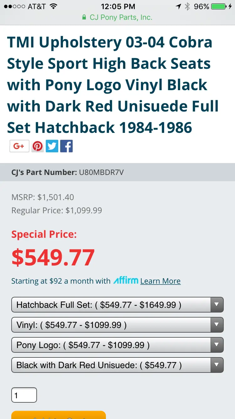

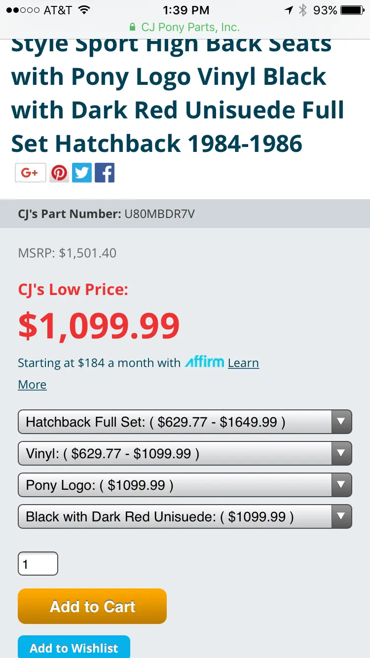

it....I bought myself an Xmas gift.
I fell in love with the dark red/black w/halos when I saw that pic. Price shopping the various sites, and wouldn't you know it...CJ pony parts has a clearance on a set of the exact same combo I wanted WITH the pony logo for $550. This kit is actually for an 85-86GT with halo headrests.
Ironically, if you price out the kit for the 87-89GT seats, it's $1100 optioned out the same way.
Pretty sure the 85-86 seats are 26" high backs like the 87-89 GTs. Either way, since it was on clearance I had to jump. Almost 50% off.
I don't actually have front seats yet. Chasing some local leads. Need to 100% verify the 84-89 sport seat is the same 26" high back frame. If not, no big deal i'll grab some 85-86 seats.
Since my SN95 seats are pretty mint, I can recoop a lot of this cost back provided I don't pay a premium on a set of front fox seats.

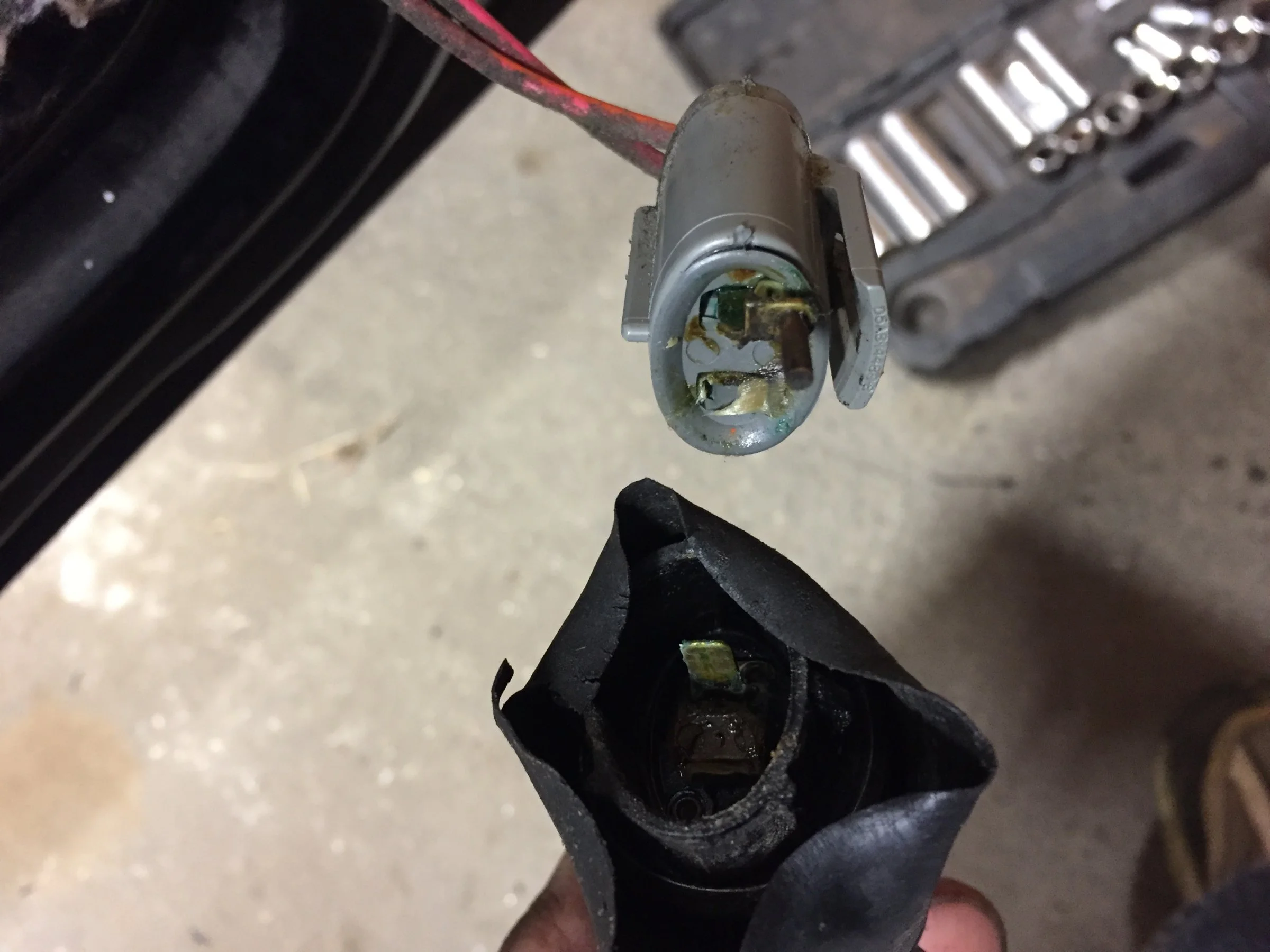

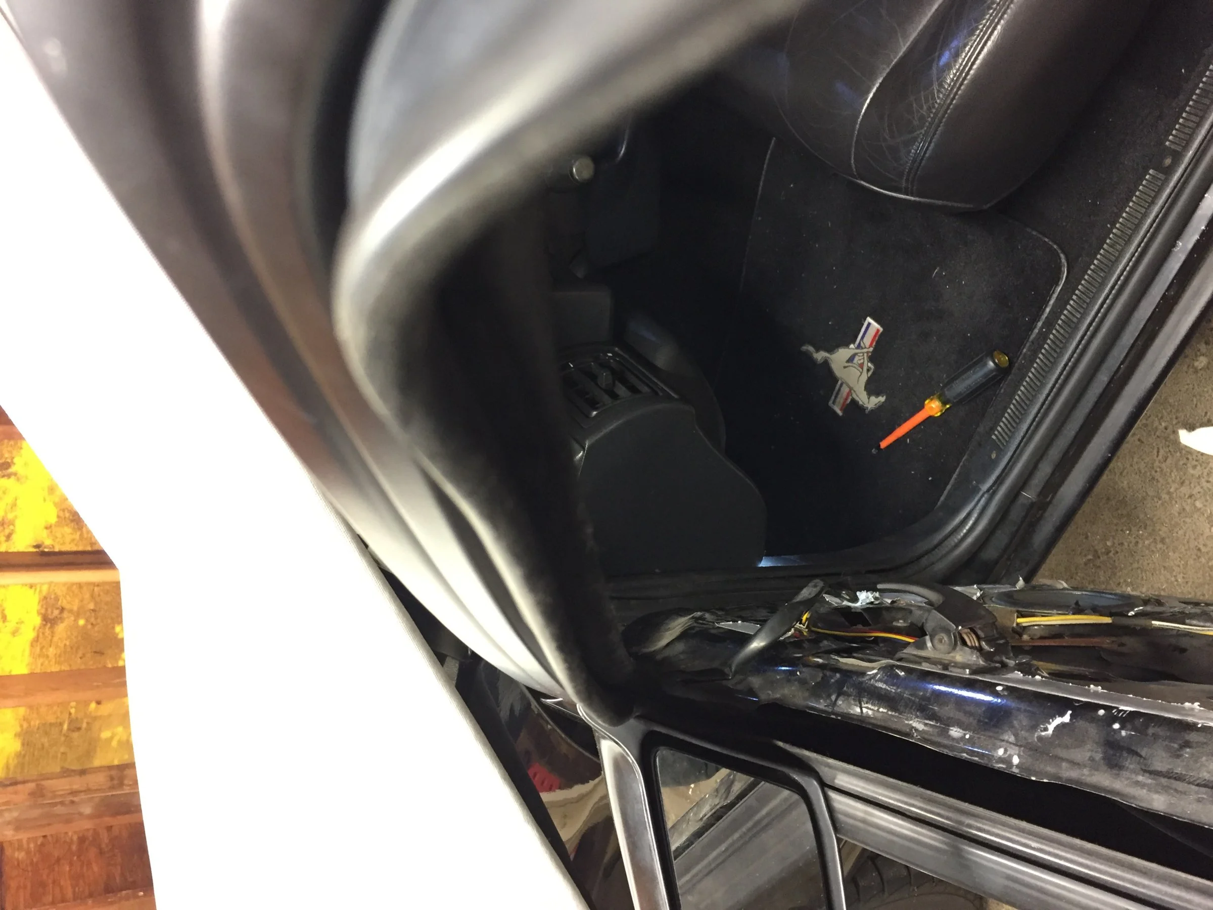

Ripped my pass door panel apart last night. Took the mirror off and found one of the gears was stripped out, which is why it wasn't moving in one direction.
Made this thread to detail my repair. I figure this could help someone in the future if they decide to refurb their mirrors like I am.
https://www.stangnet.com/mustang-forums/threads/power-mirror-rebuild.901292/

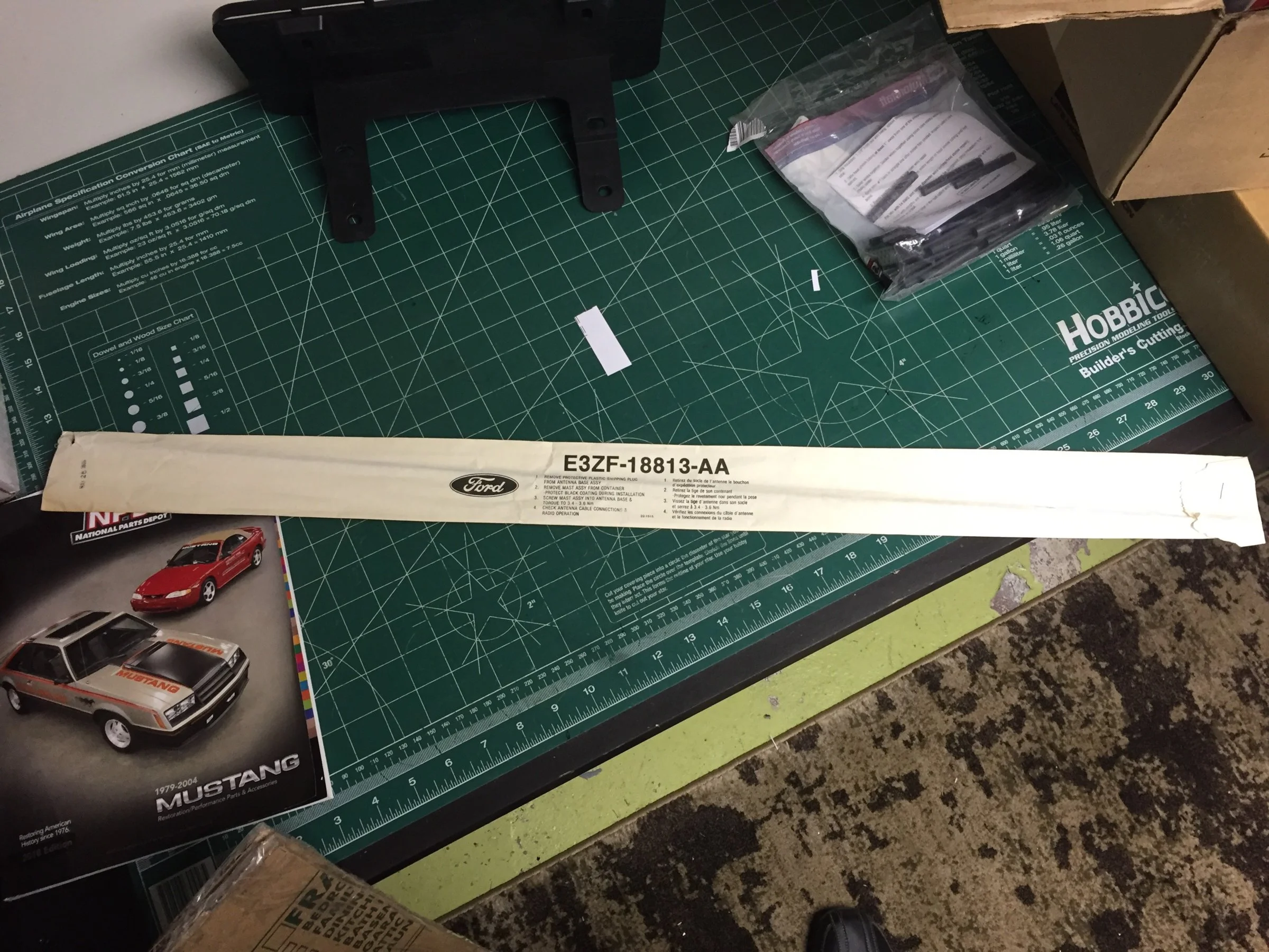

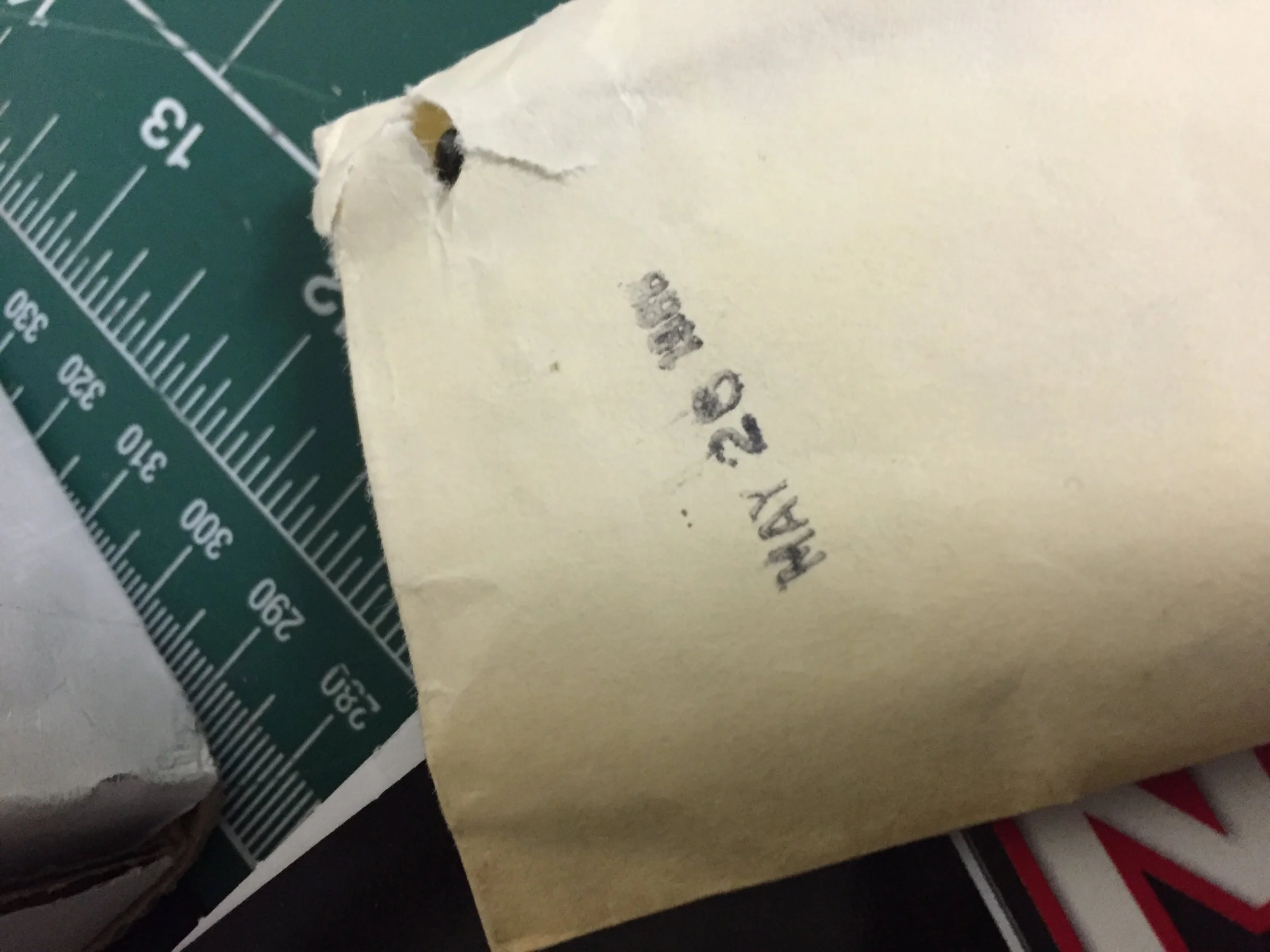

So yeah, I bought a NOS antenna. 1988 dated too.
Search the p/n E3ZF-18813-AA on eBay. Someone's selling a lot of them one at a time.

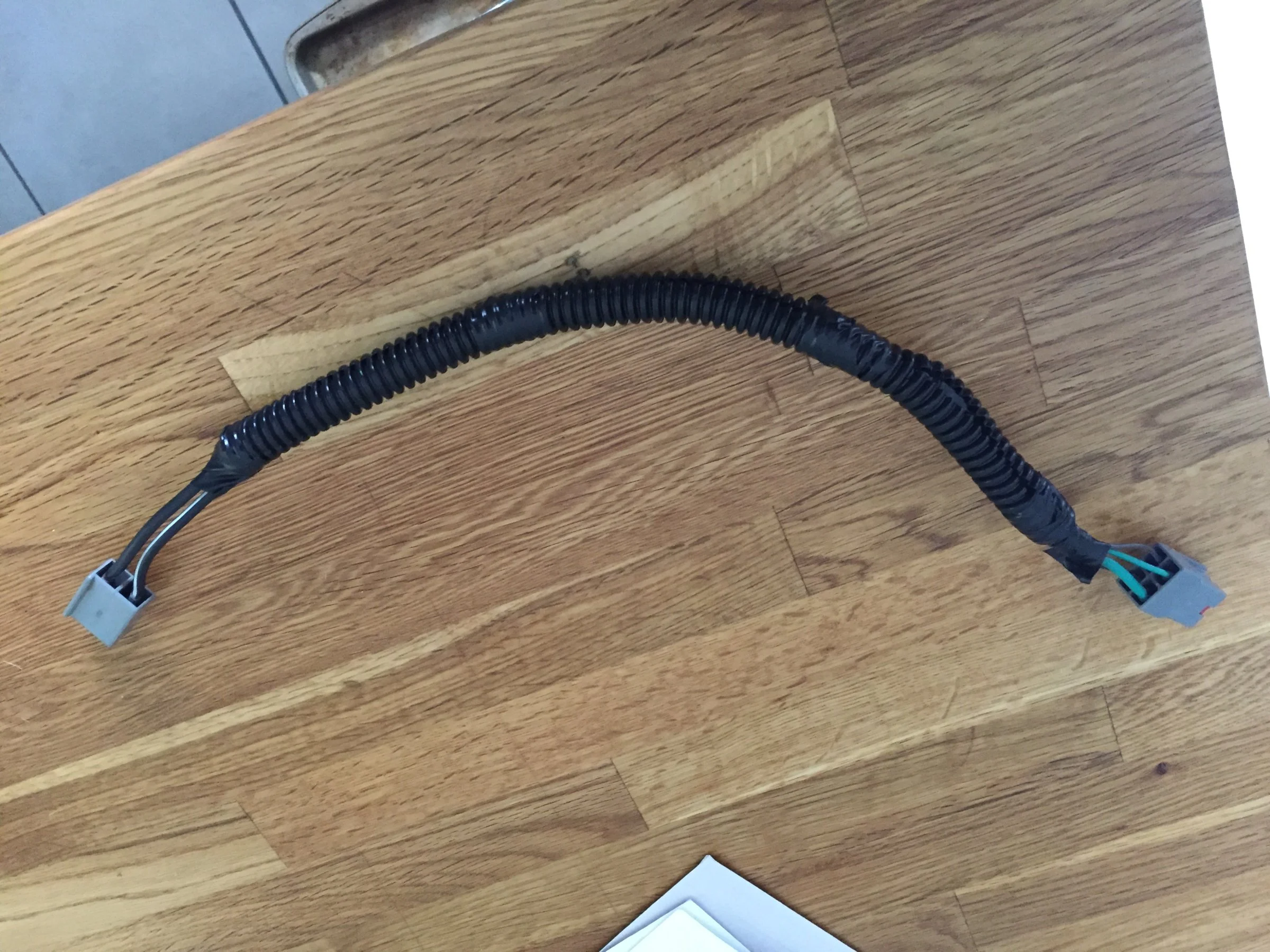

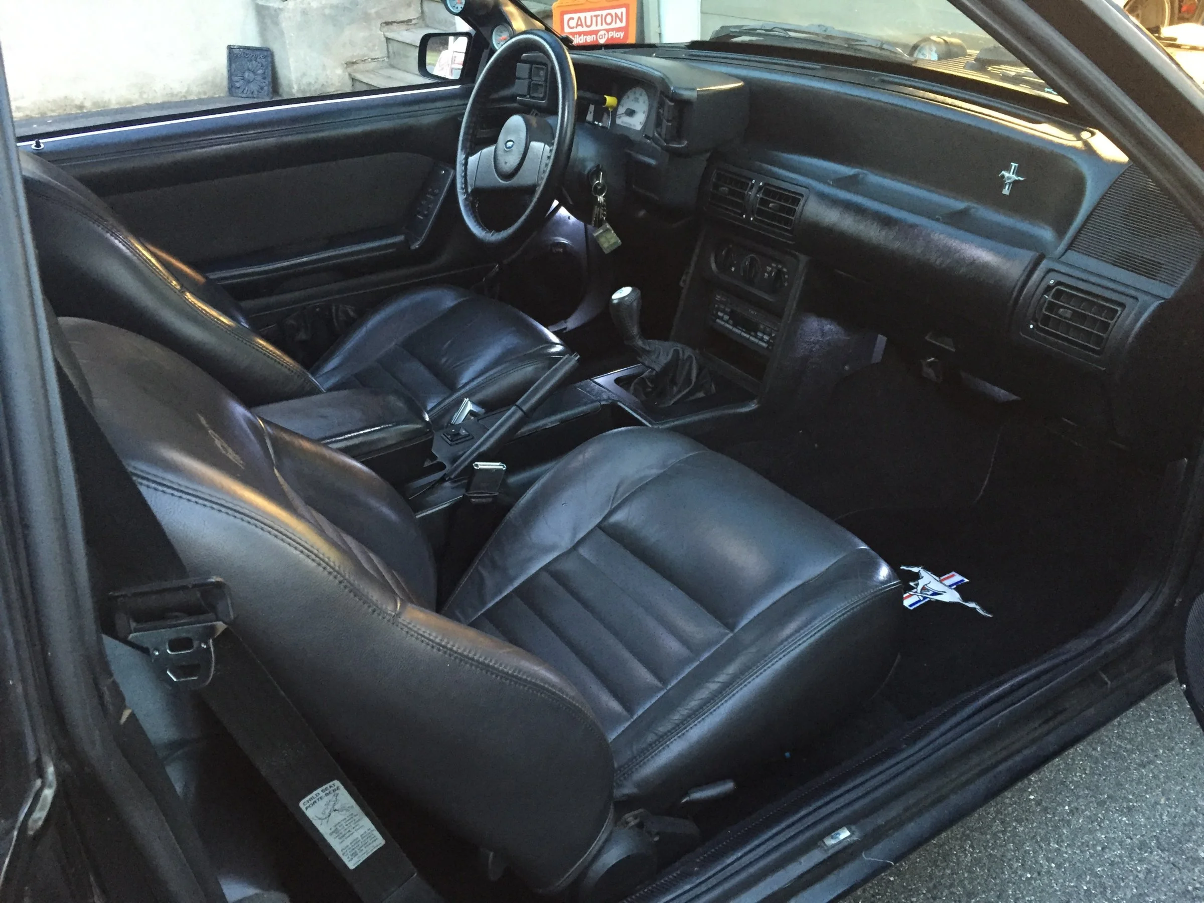

Yup. I cut a lumbar plug off a fox body seat, and then cut the power harness from an SN95 that used that track at the junkyard and soldered them together and made an adapter harness. Plugged it in and it all worked.
Honestly it made no difference in height over the fox tracks it originally had. If anything I can tilt the front up now and I gives my legs a bigger bend and let's me sit closer
Seats are still in great shape. I've driven maybe 800 miles since I bought them from you.
Pass seat still looks new

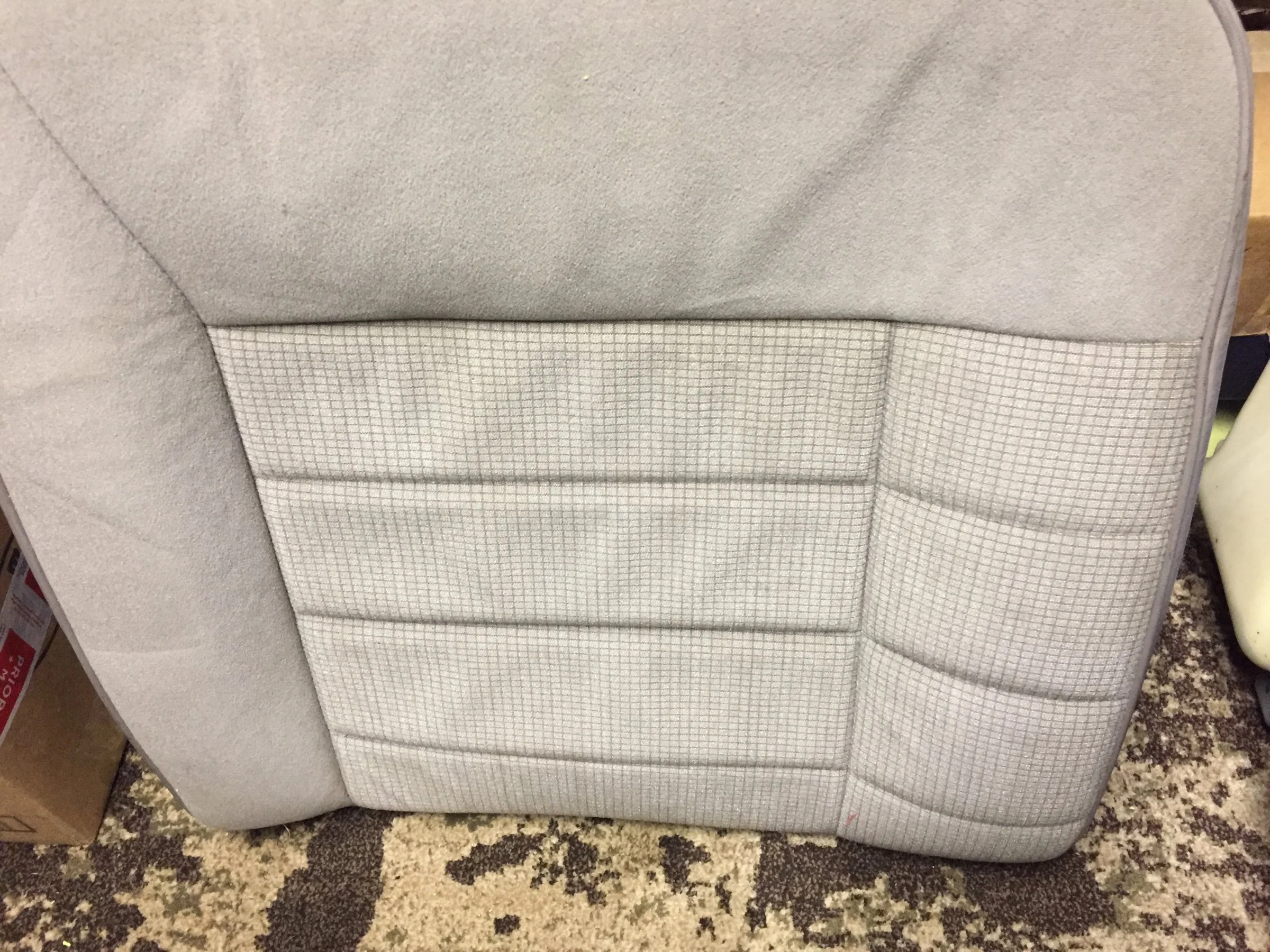

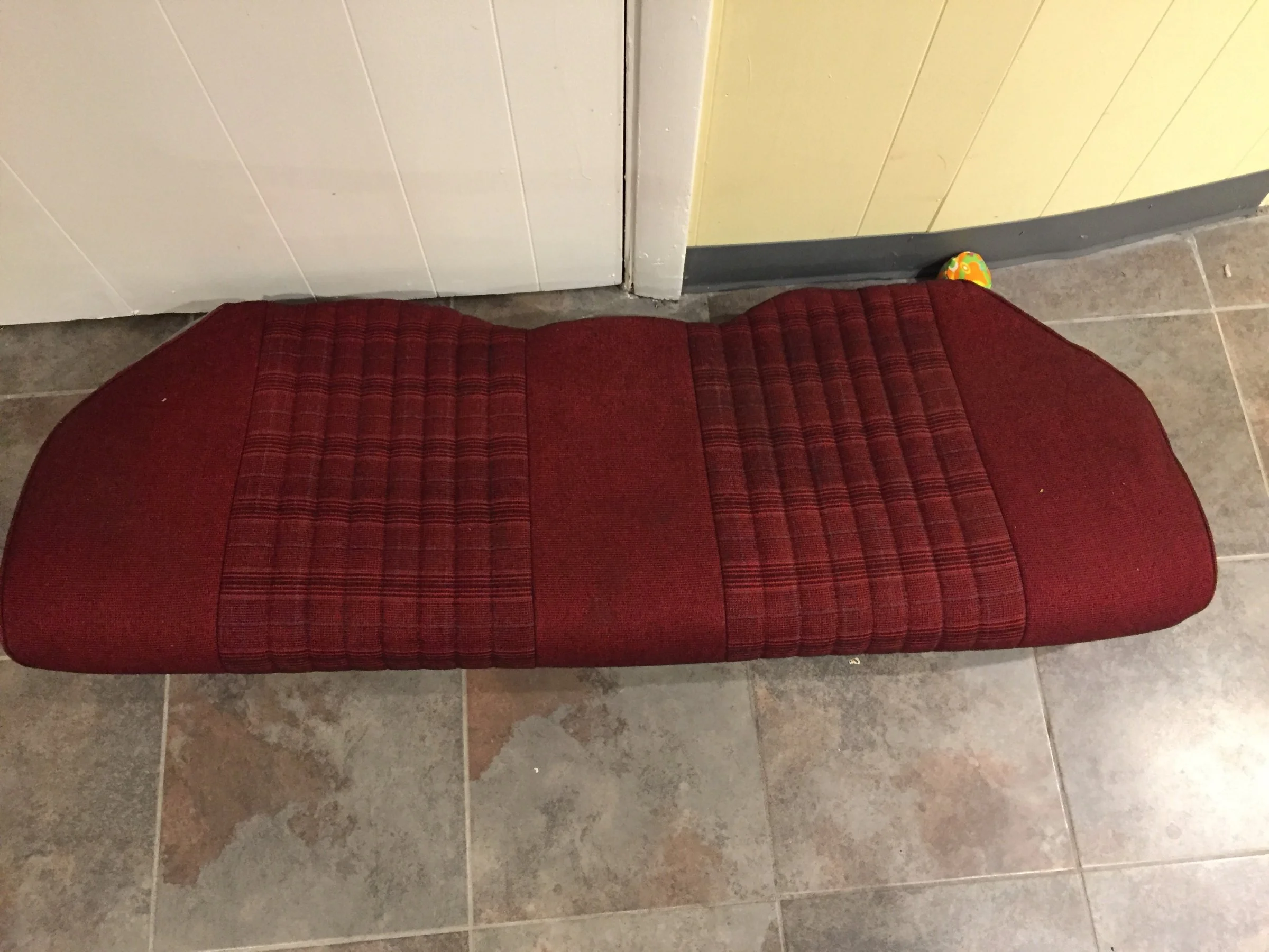

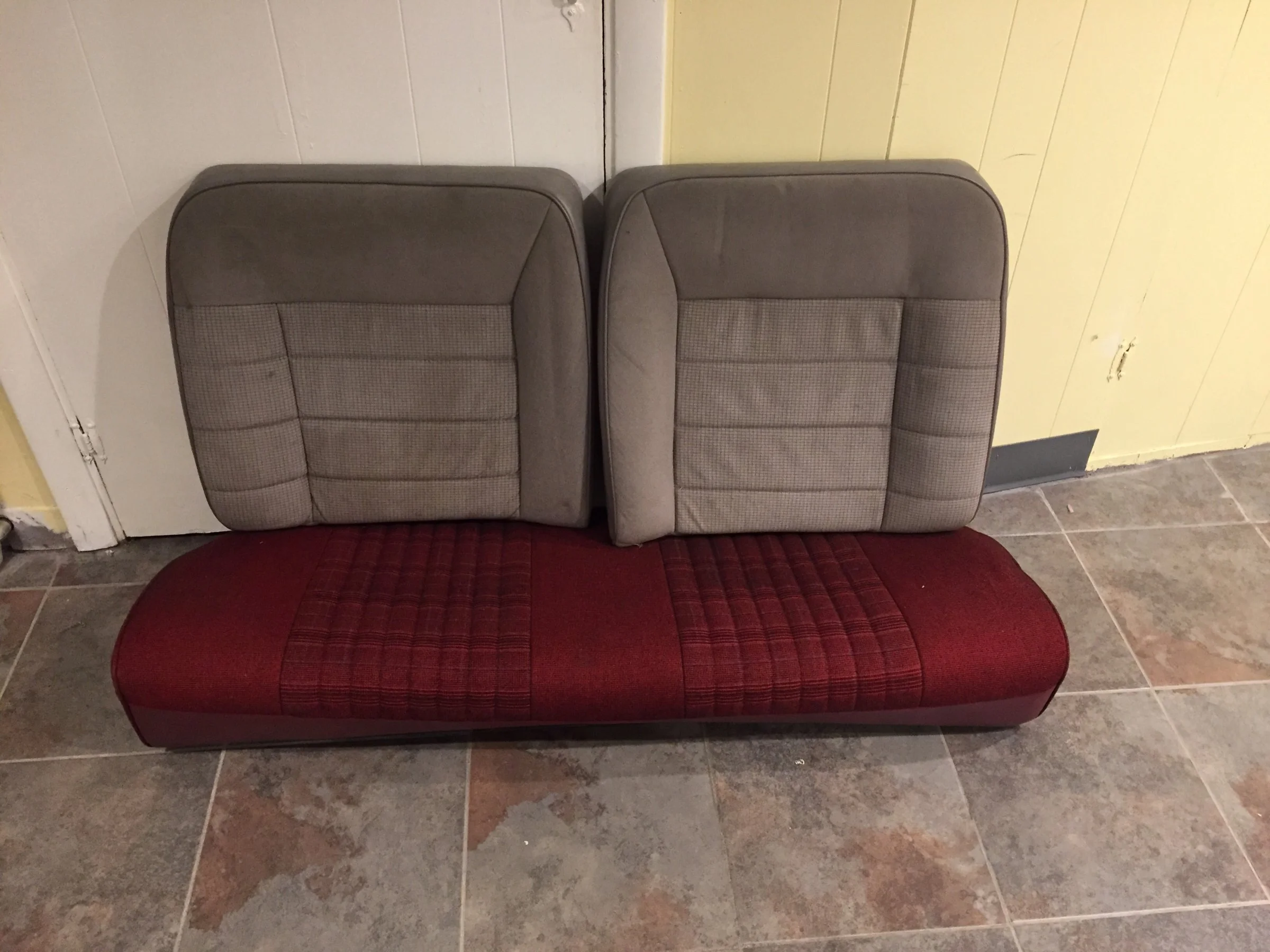

So here's the donor rear seat. Total cost under $100 (since I didn't have a fox seat to begin with) 87/89 tweed bottom, and some 92 4cyl seat backs. The seat bottom cleaned up real nice. I might save the cover and if anyone needs it, PM me. Too nice to toss in trash
The foam under the 4cyl seats is the same as the 5.0. It just lacks the extra crease near the top on the fabric like the 5.0 seats.
The 84-86 cars actually have a fabric pattern similar to the 87-93 2.3l. The cebter section and outer panel is the same material, while on the 87-93 Sport seats, only the cebter is the dissimilar material
Since i ordered an 85-86 GT set, curious to see how the fabric layout is.

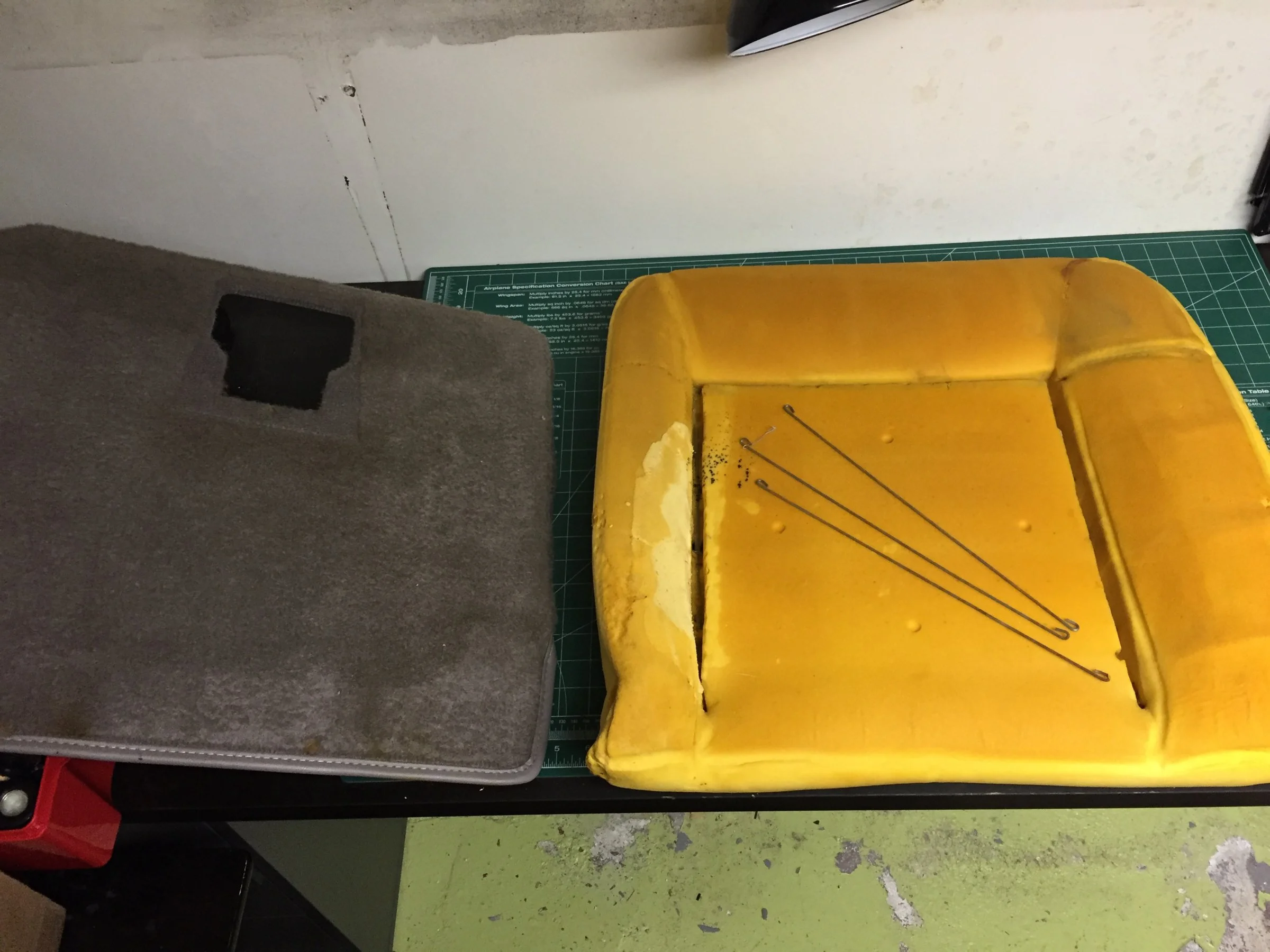

Anyway. Breakdown is easy. Watch the LRS video a few times and it's a breeze. Just need to save the listing rods from the old fabric

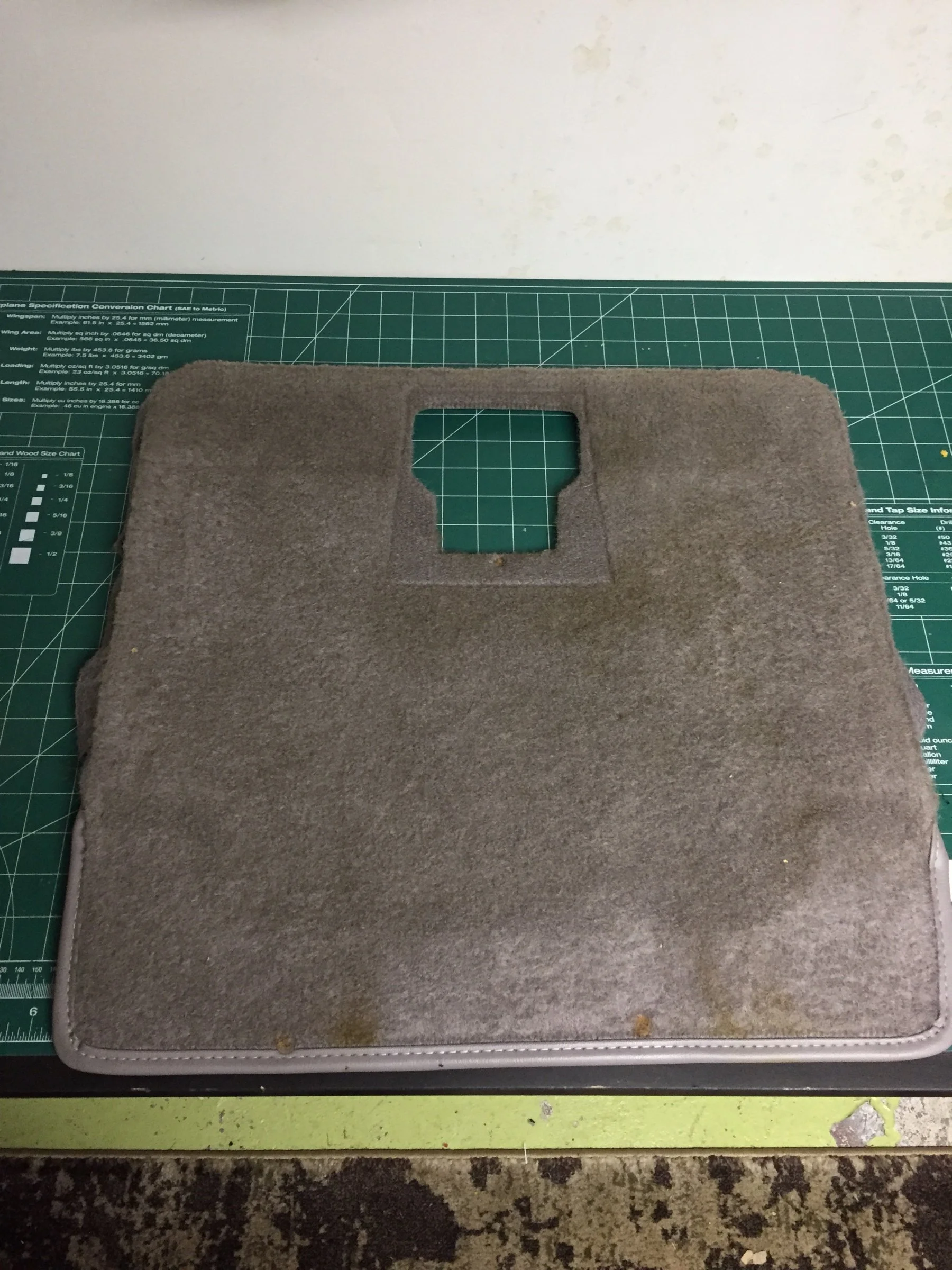

Now the dilemma. The TMI kit does not have rear seat back carpet.
So, do I dye this? It's kinda matted and stained a tad? Or do I pony up $90-120 for a new hatch carpet and seat carpets?
I'd fabricate one if it didn't have that vinyl seam sewed into the bottom edge. Remember...I need OEM fit/finish. Off to give it a bath.

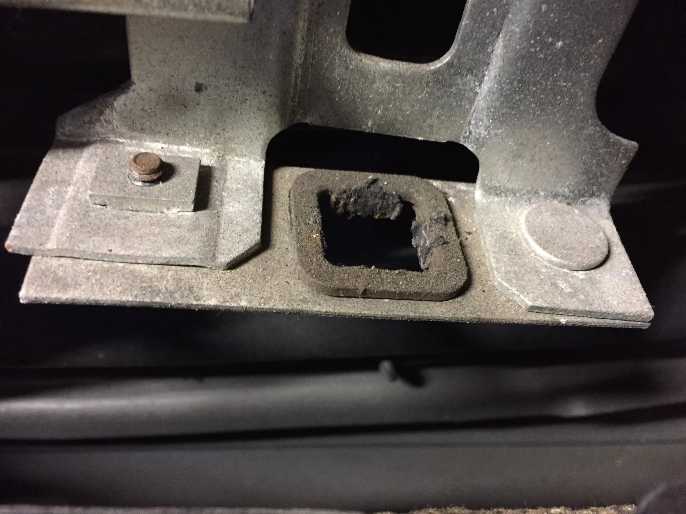

Next up, door lock actuator. I did not drill out the rivet. I just removed the lock from the white clip in the door. Wasn't too hard. Swapped in actuator and it sucks. It's weak. It actually works better on the pass side switch. If I press the drivers switch I need to hold it to give it s little extra time. It's a Daniel carpenter reproductions actuator. It sucks. I might have to spring for a Ford NoS unit on eBay one of these days.
Oh yeah, this might be why my original failed and seized up
