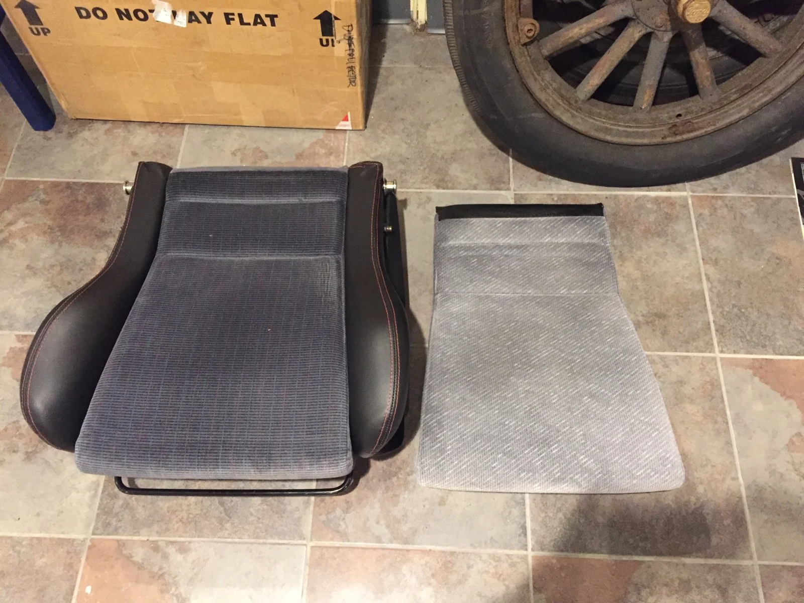

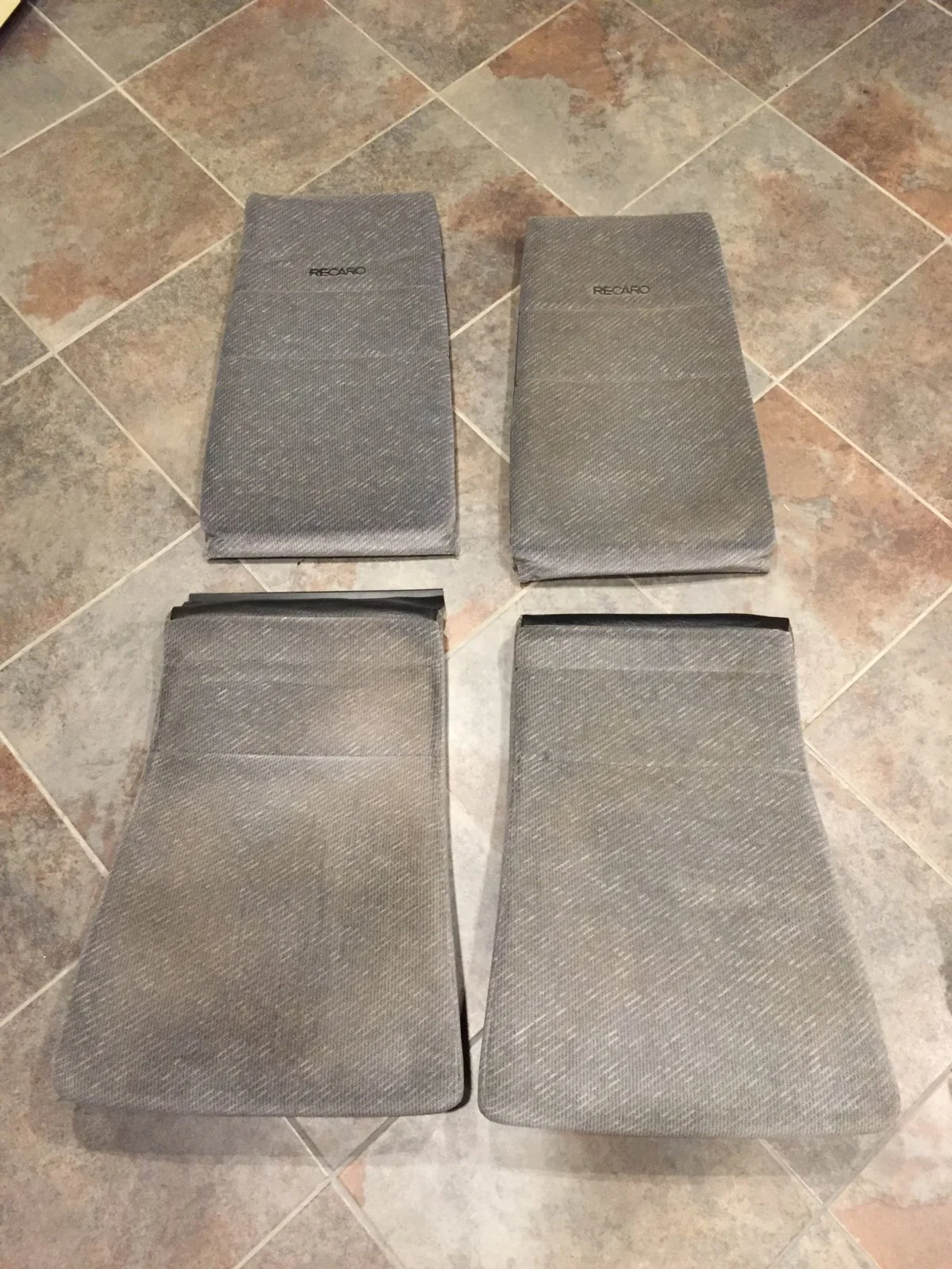

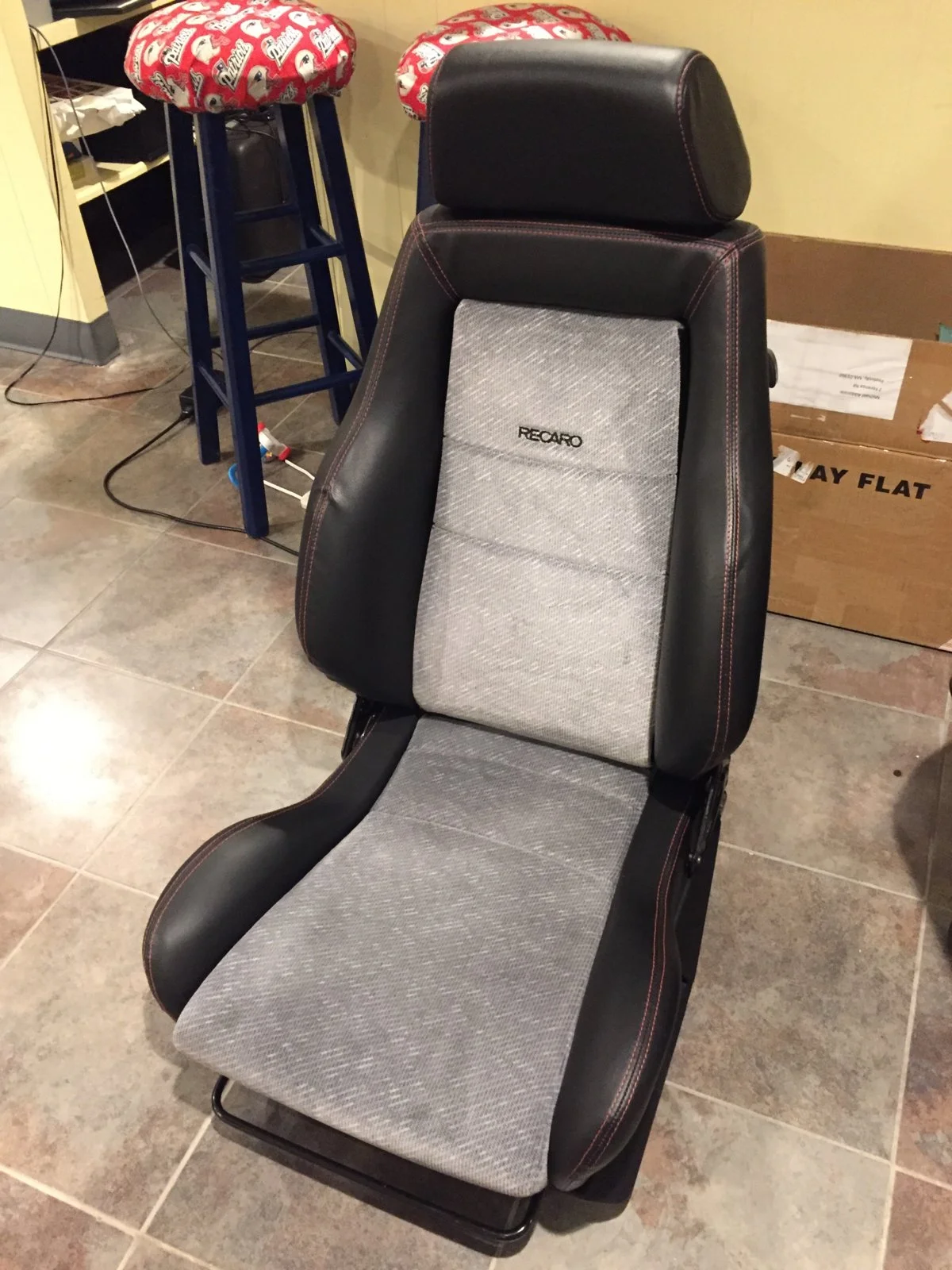

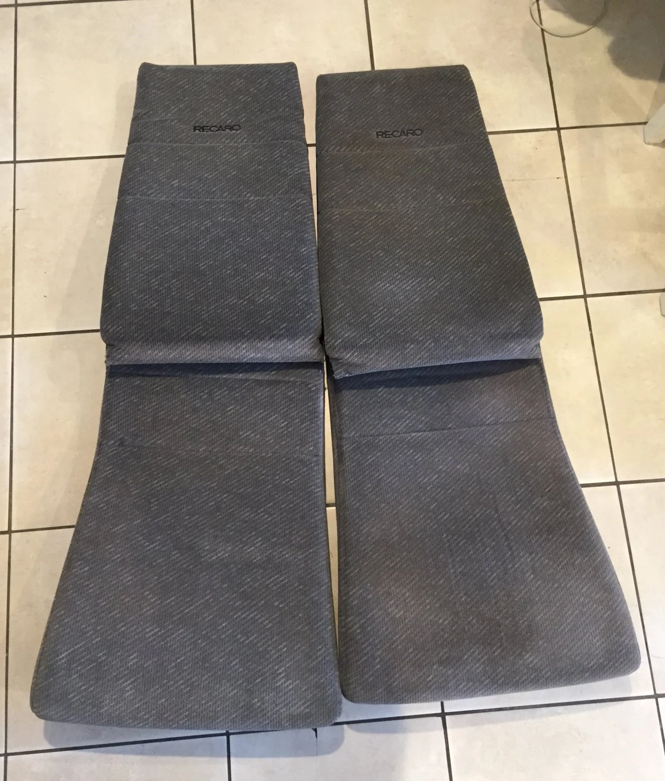

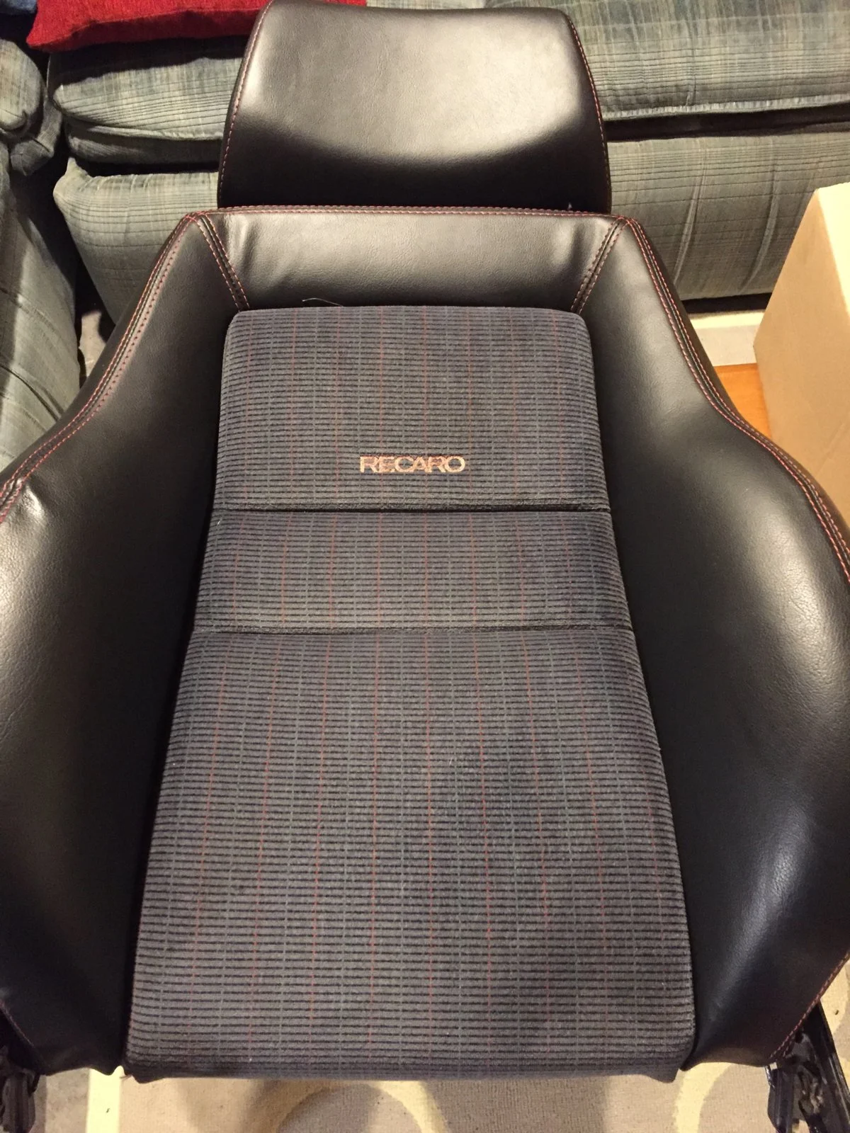

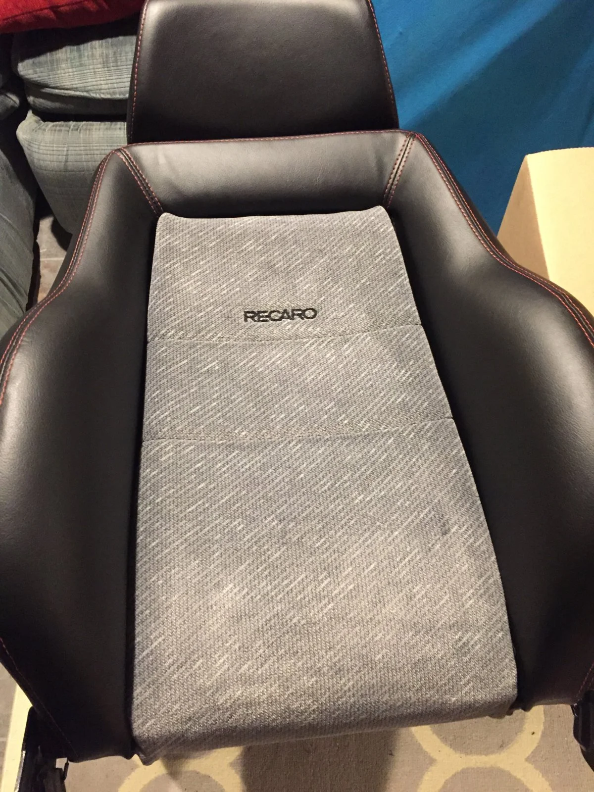

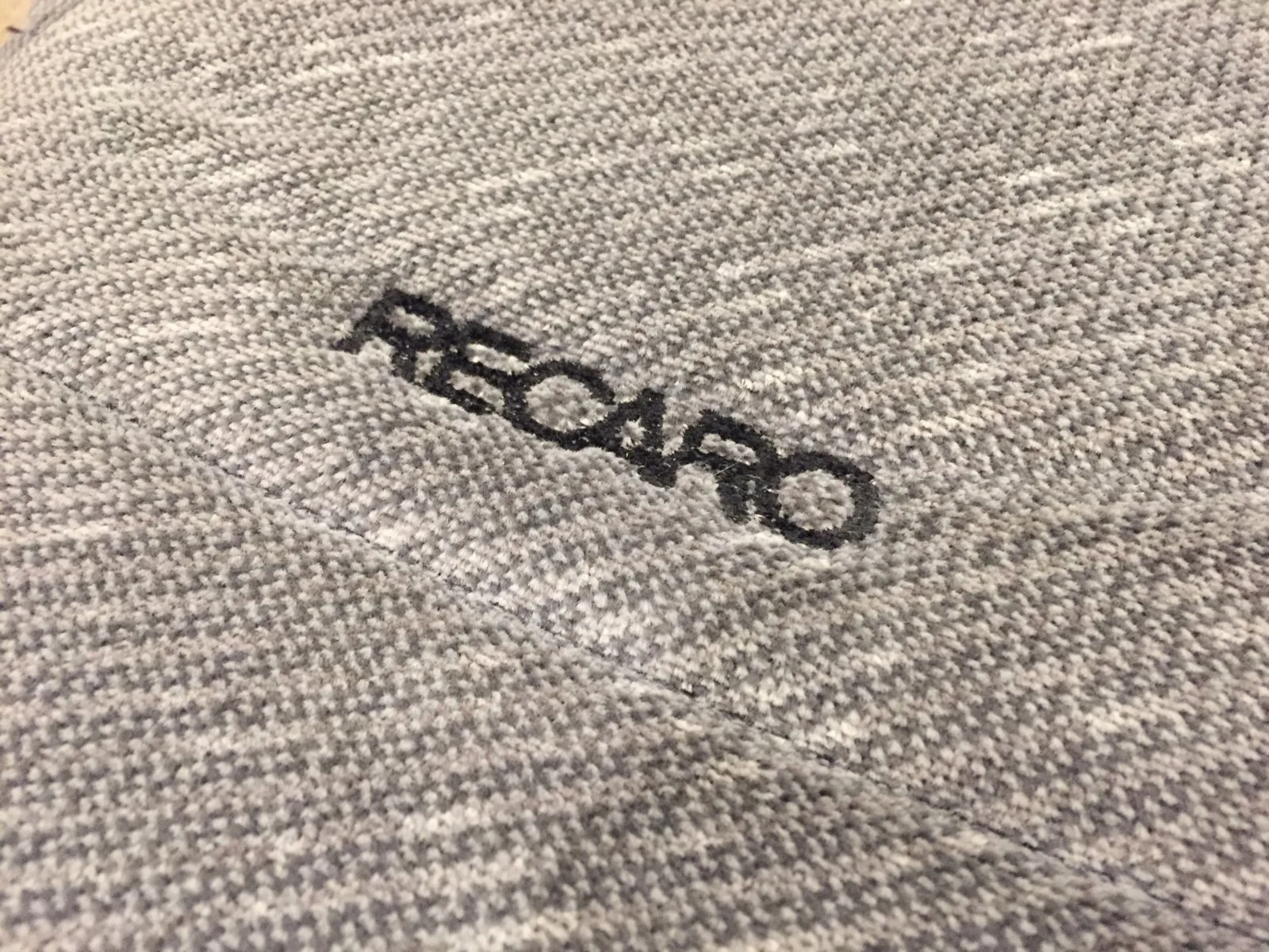

So as usual, I had my eye out for Recaro parts. Picked up an entire set of gray inserts. Nice foam too.

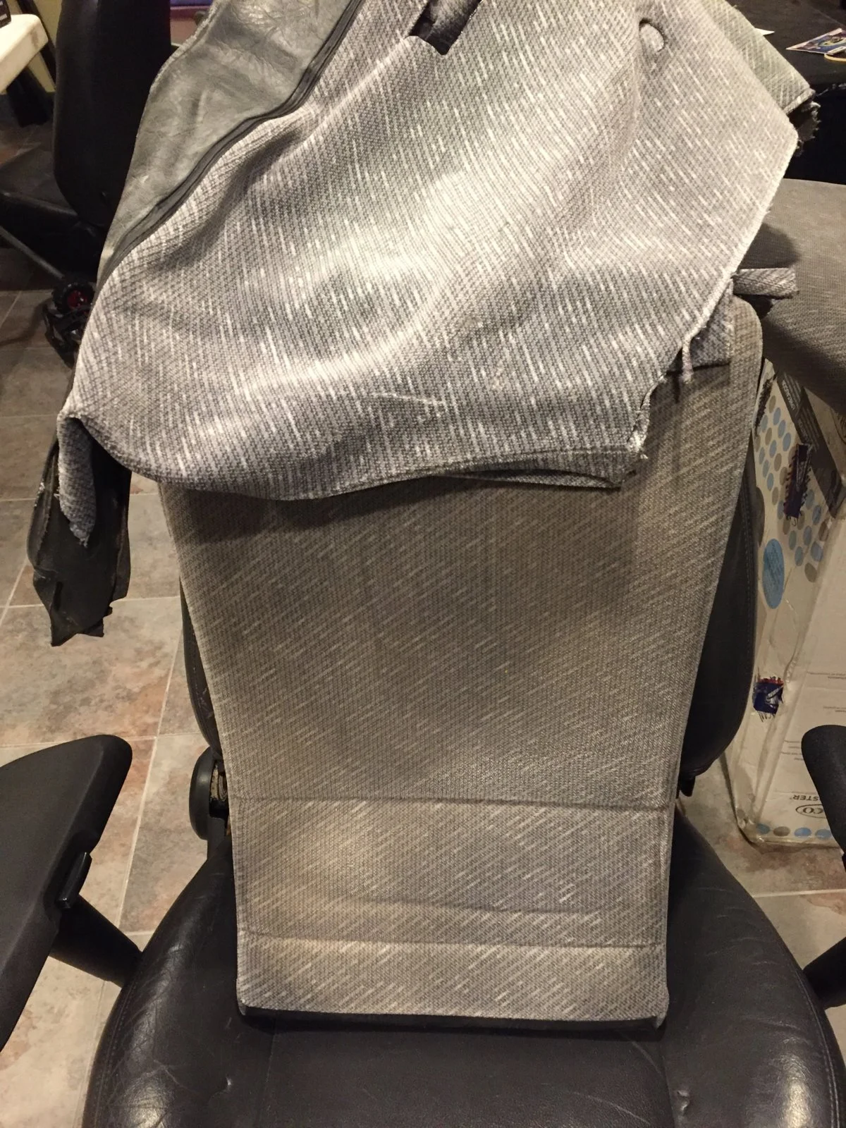

The color is more true light gray than my current set.
So next I'll take the covers off and toss them through the wash cycle a few times to get some of the dirt out.
You can see my current covers are gray, but compared to these they look almost purple

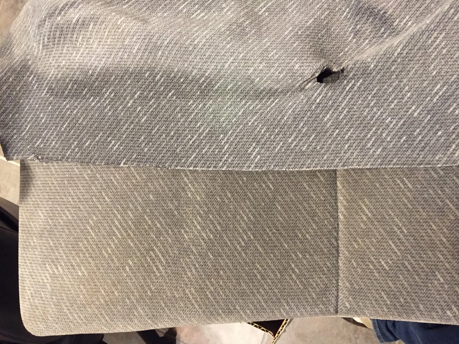

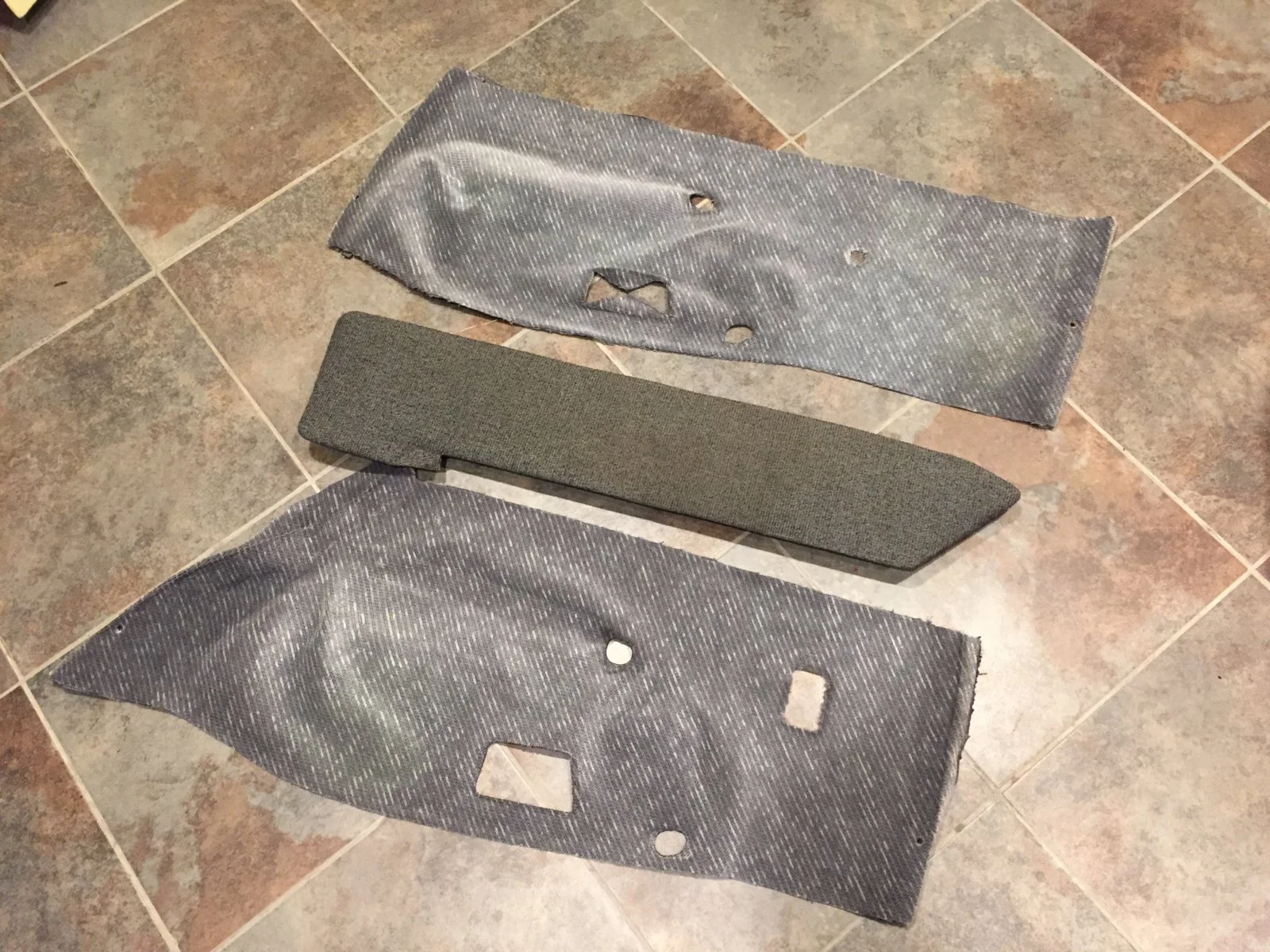

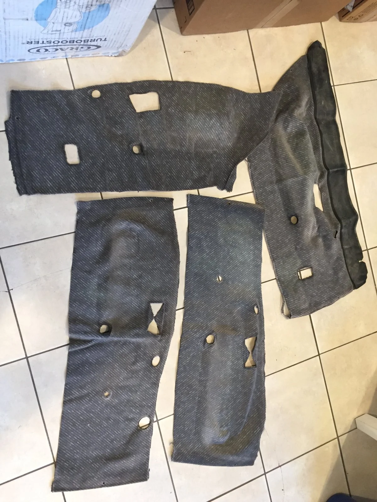

Added bonus was door material. I wanted to try and recover my door inserts with these, but don't think I have a straight shot to get a clean piece. I might have to improvise
Simple green, a stiff scrub brush and then a cycle through the wash really cleaned up the door panels. Nice and light colored compared to the inserts now.
Now the challenge is to figure out how to recover these in this material. I'll need to get creative.

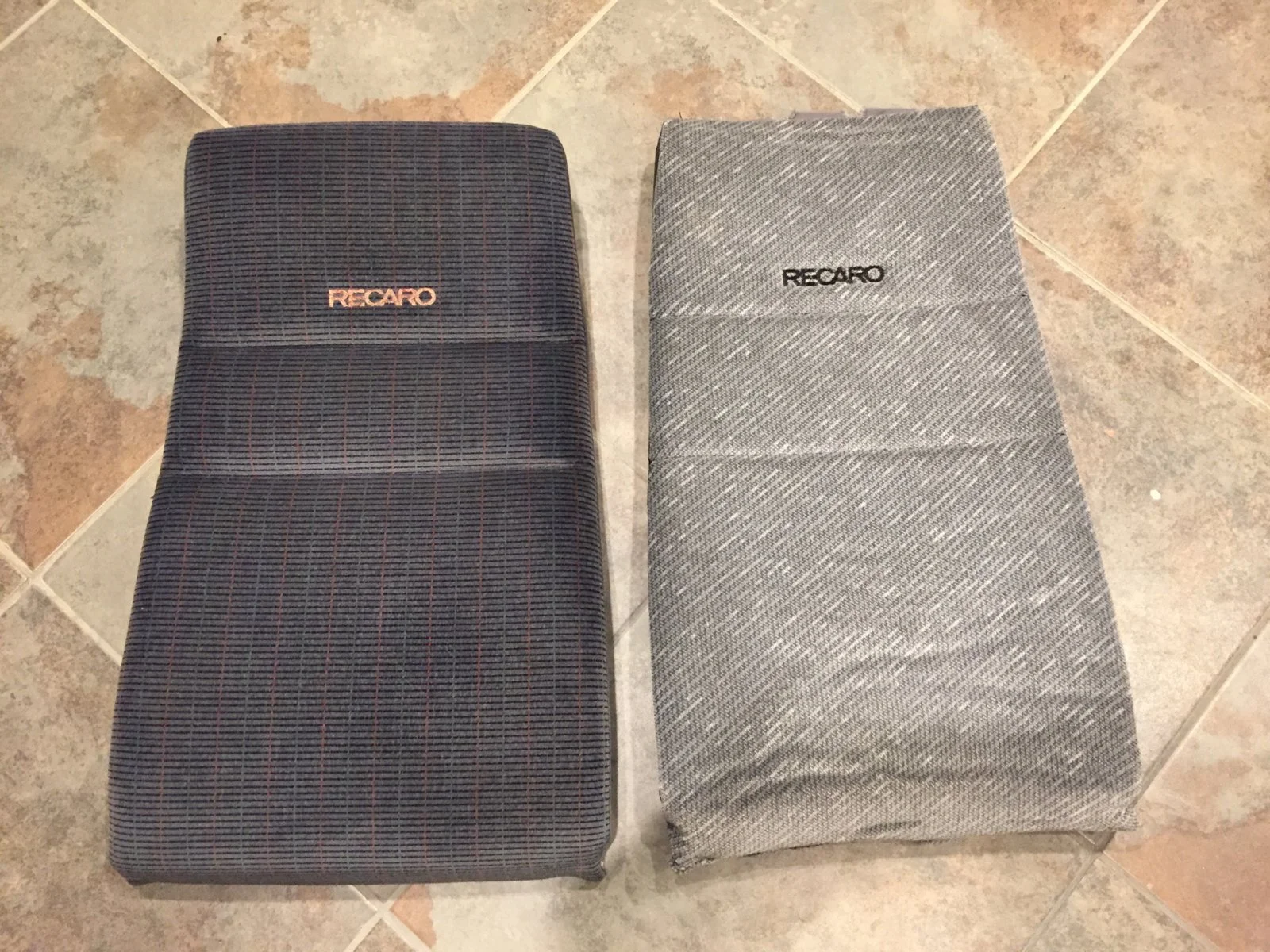

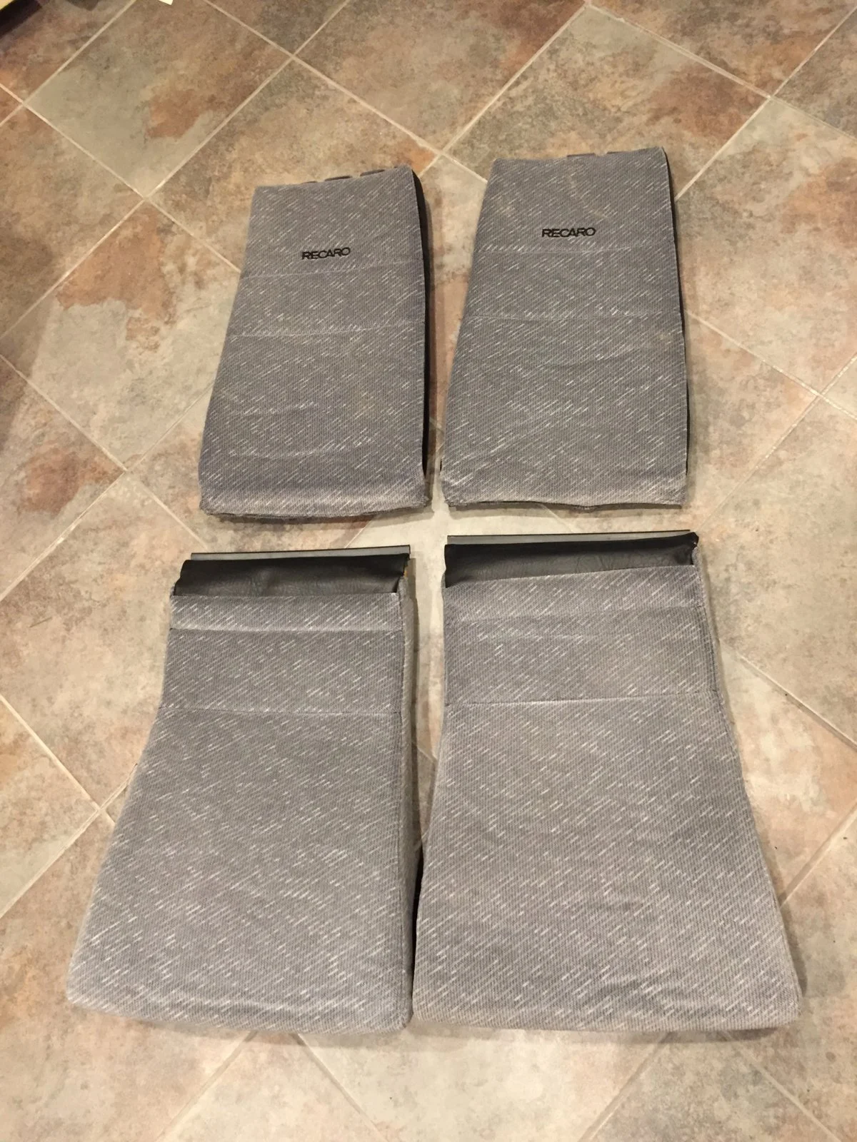

Up next, I'll remove the covers from the seat foam and do the same cleaning to them.
Before

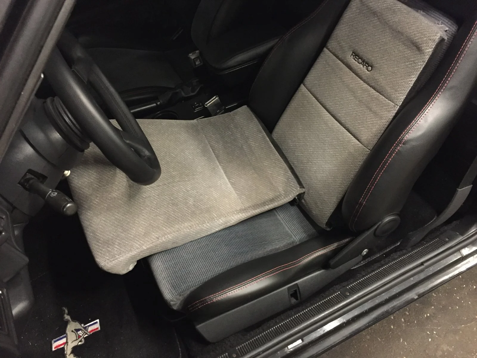

And after stripping the covers off, hand scrubbing and two washing machine cycles. Temporarily stretched over the foams while they dry.
In the car, these will be a nicer material for the inserts.
Need to order the proper stapler for upholstery that spreads the staples outward. Then I can install these tighter on the foam and secure. They did develop some small waves in the material from the washing, so i'll need to stretch and smooth those out.

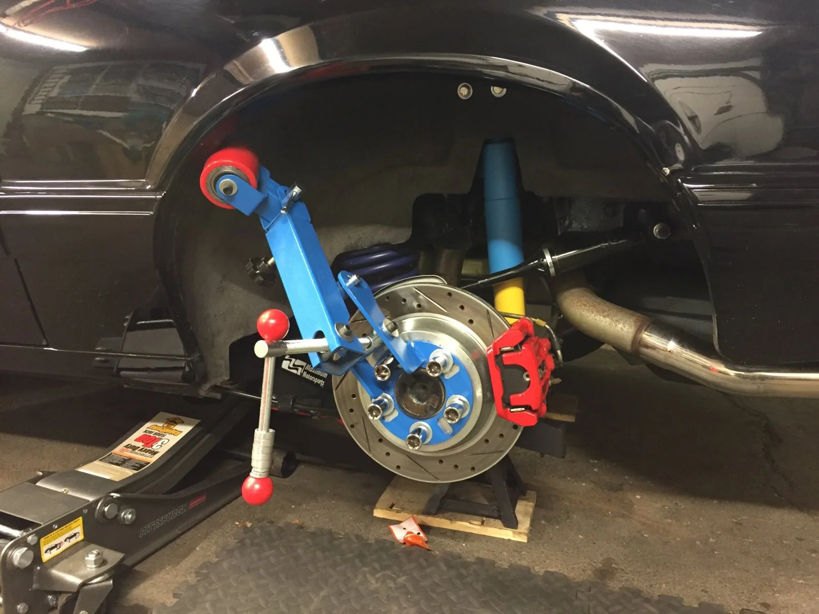

So today I pulled the car out of the garage and began tweaking some of the suspension adjustments. Height, Caster, Camber and worked on toe a tad. Took car for a ride but quickly turned around when I remembered all 20 lugs were just snugged and not torqued.
But from my brief ride...coil overs ride waaaaay nicer!

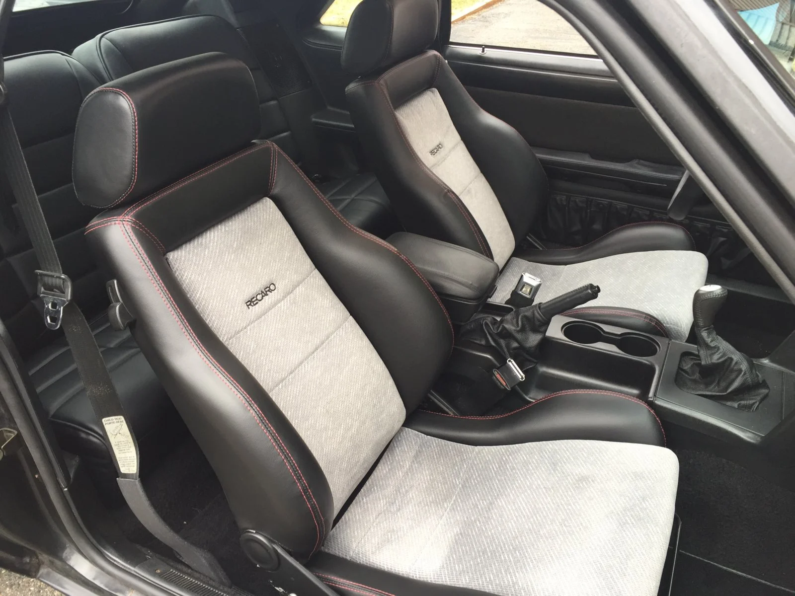

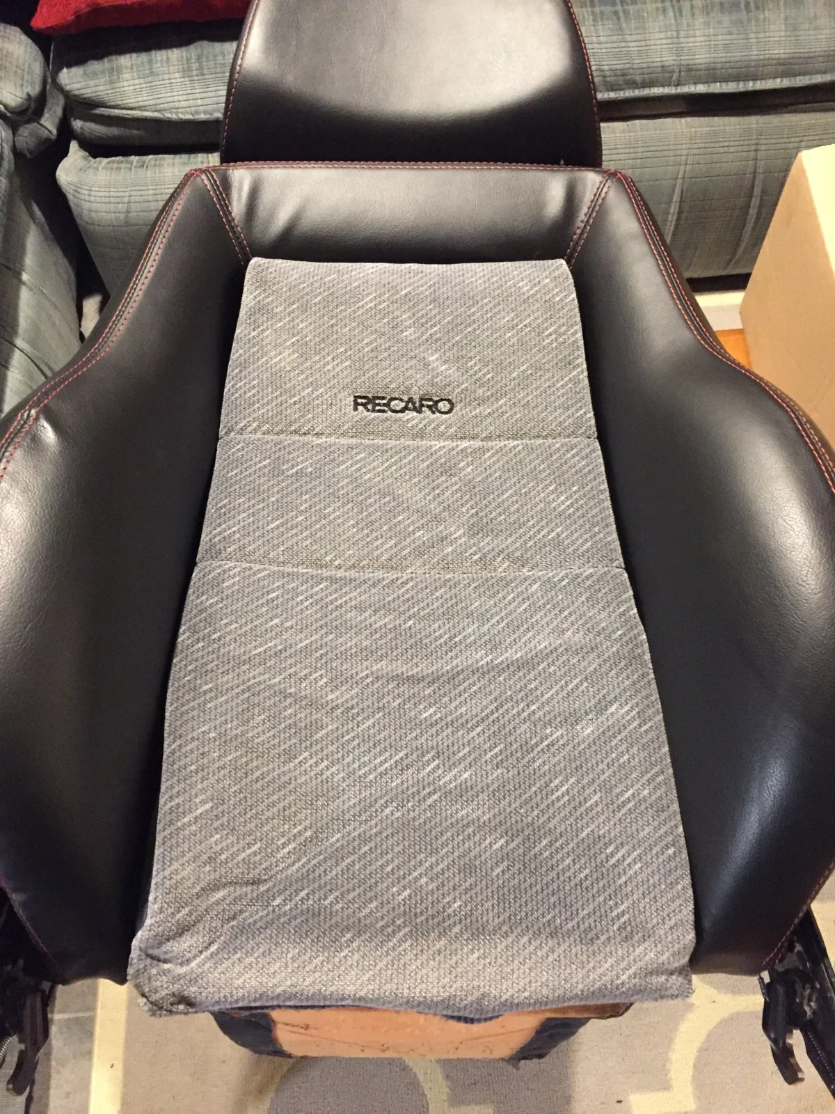

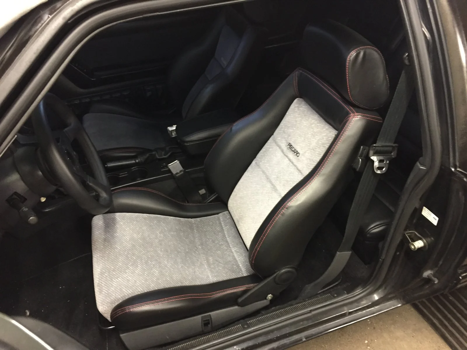

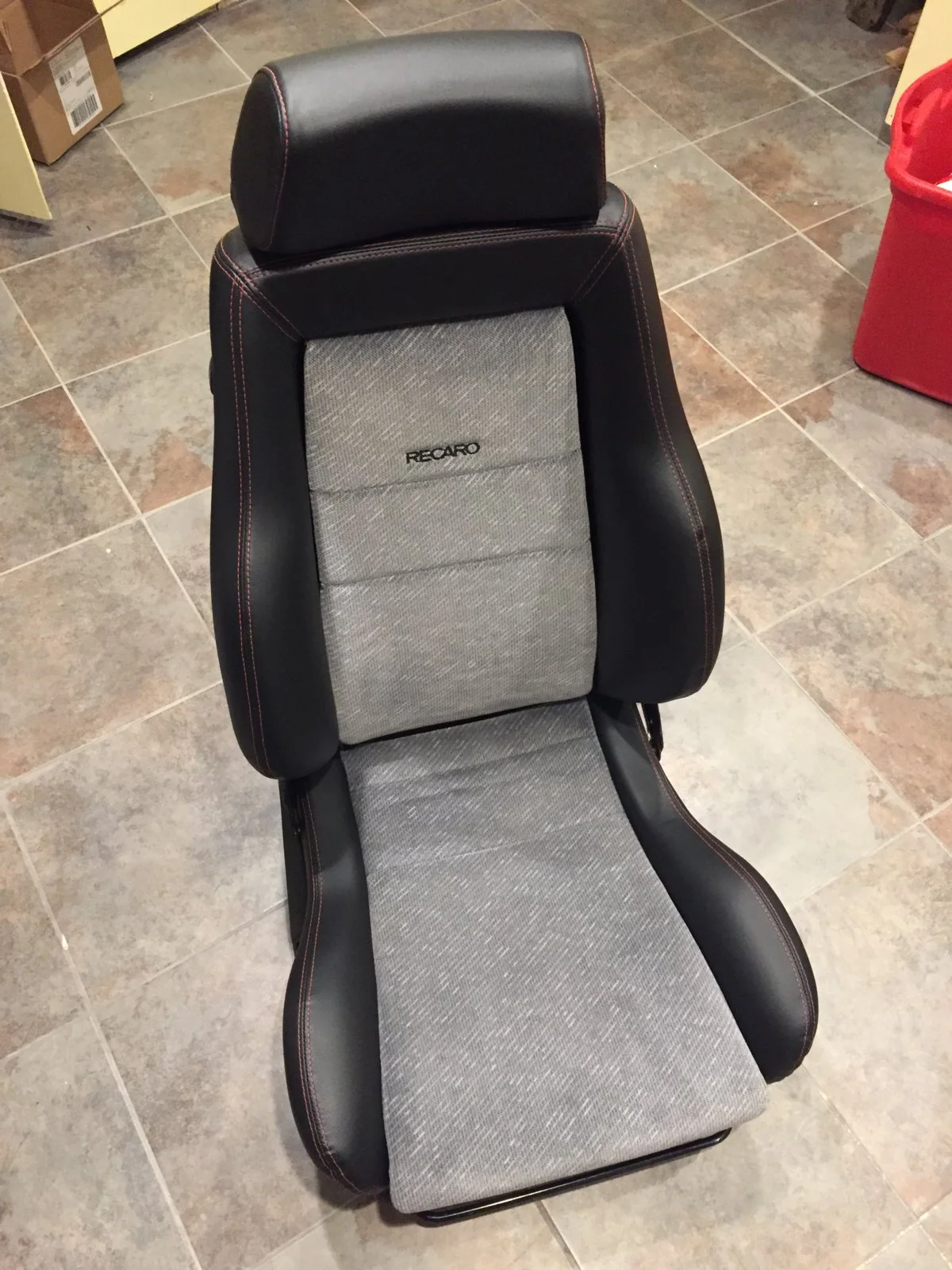

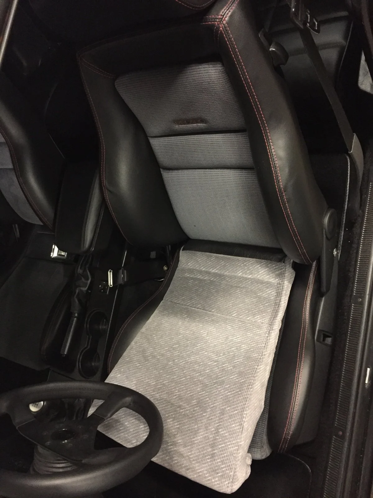

Anyway, pulled out the drivers Recaro and set out to replace the insets with the new gray cloth inserts. They really cleaned up well.
Discovered that Amazon sent me the wrong staples to secure the covers to the foam, so I had to stop. Need to steam out some of the wrinkles and then secure to the foam.
Some sneak peaks. Keep in mind these are loosely mocked up. Should tighten up nicely
Comparison of the dark gray vs light
Before
After (sorta)

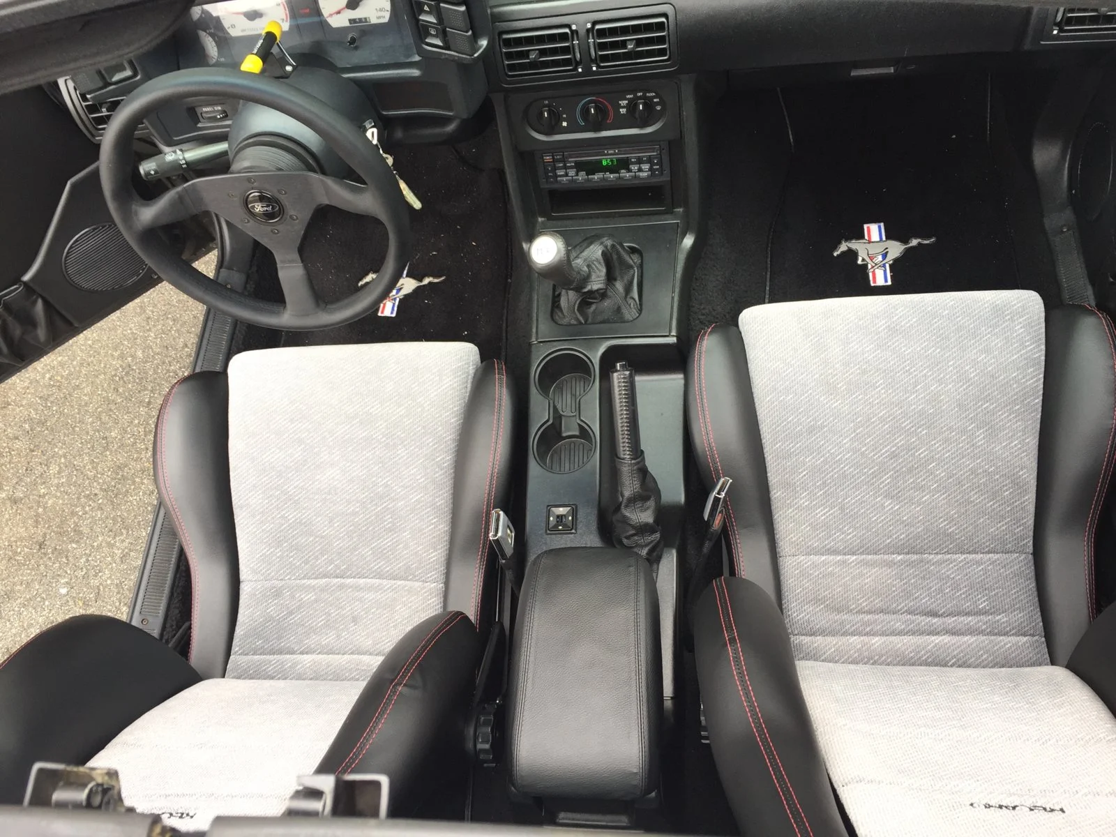

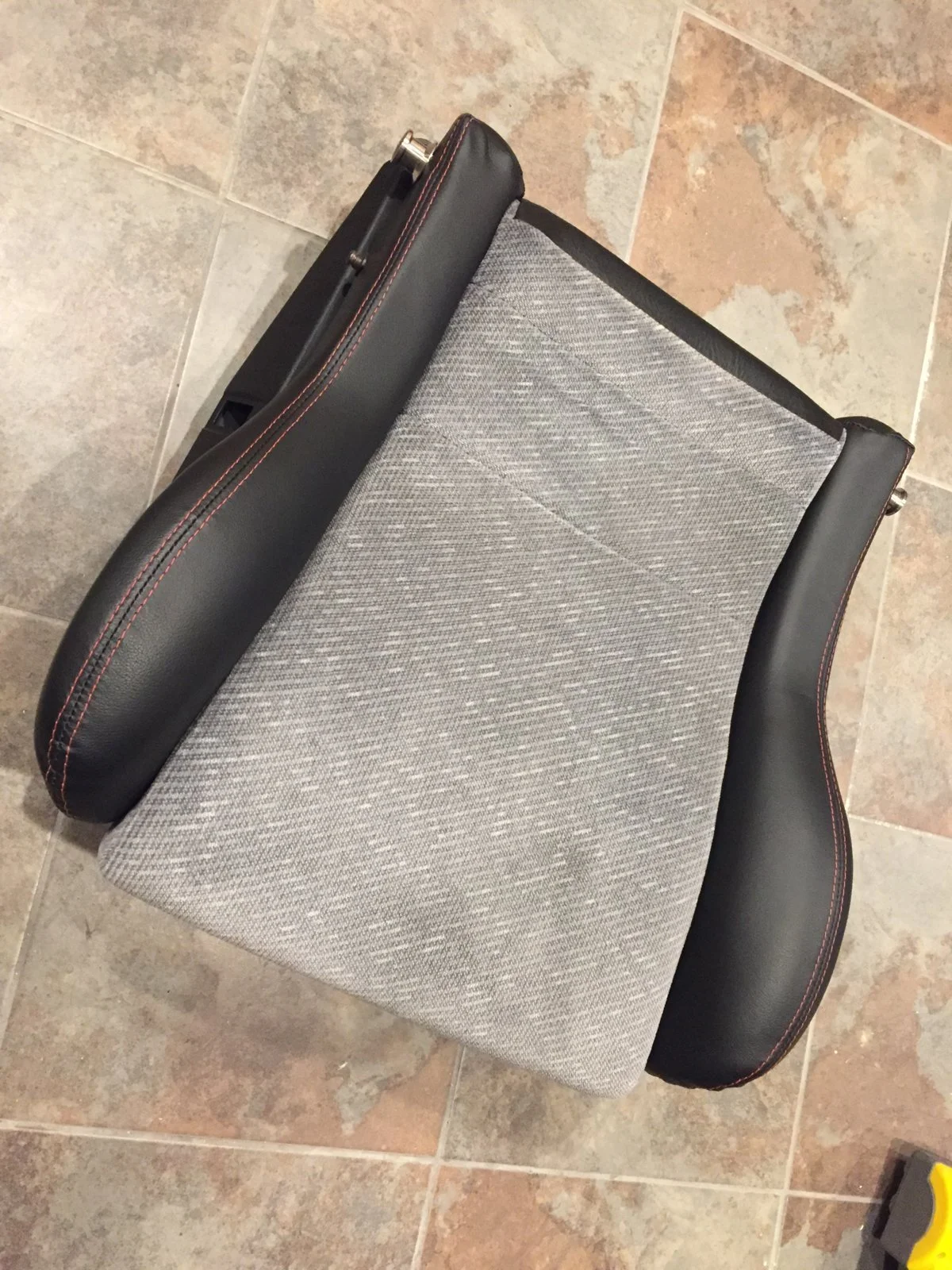

Started working on the drivers seat now that I have the correct staples to secure the fabric. The original covering had a little spray adhesive in the middle to keep the material flush. I excluded that, but think it might be a good idea. Need to break it down and redo.
Dark vs light gray
Preliminary teaser

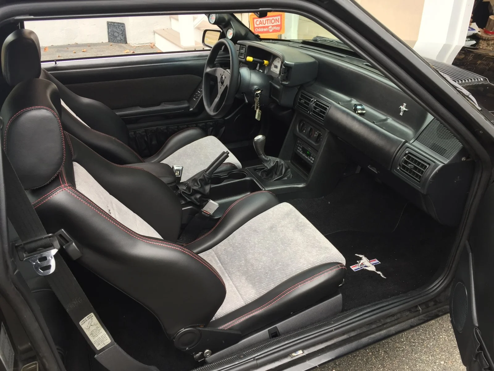

Man I bet those seats are comfortable! Looks really good man!
I find myself sneaking in the garage, sitting in the driver's seat and just enjoying it. They are really comfortable seats and the seating position (for me) is just perfect. Really glad how this turned out in the long run considering where I started almost 2 years ago when I bought those TMI seats with the pink Inserts.
Of course, now with the lighter cloth material in the center, i'm paranoid about getting it dirty. I don't really drive the car when i'm dirty, but i'm worried about a greasy hand on the cloth when doing something under the hood. I'll probably just swap in a junk seat when it's time to do extensive work.

-Couple short rides to settled the suspension and then double check ride height, camber and caster

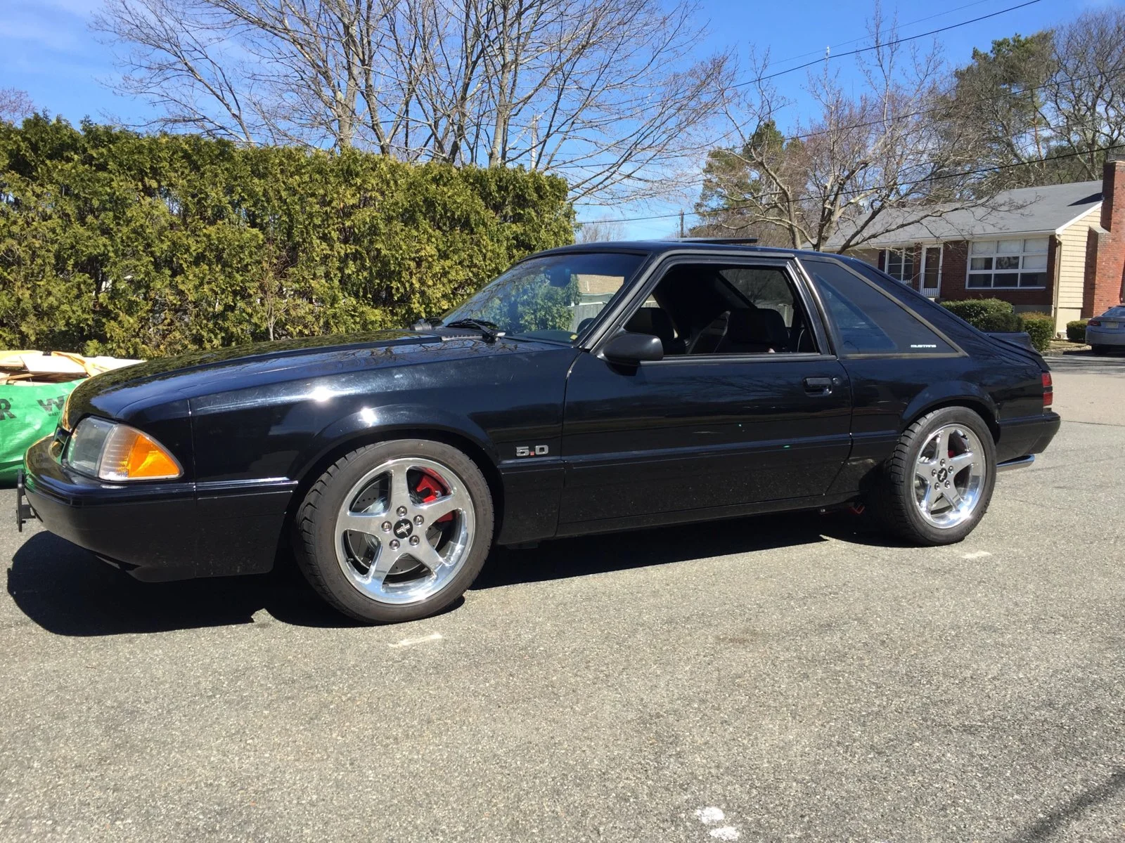

So went for the first ride of the season. Car felt great. Suspension really made a difference in how it feel. It honestly rides damn good for a fox body..I'm impressed. Just the front coil overs alone made s much softer ride, but still no body roll when I throw the car around.
Alignment was off a tad. Just readjusted it a few mins ago. Needs a test drive. It's aligned but was a tad off center on the highway
Rear we a bit high so I lowered it a tad. Rolling the fenders is on my to-do list one night after work.
