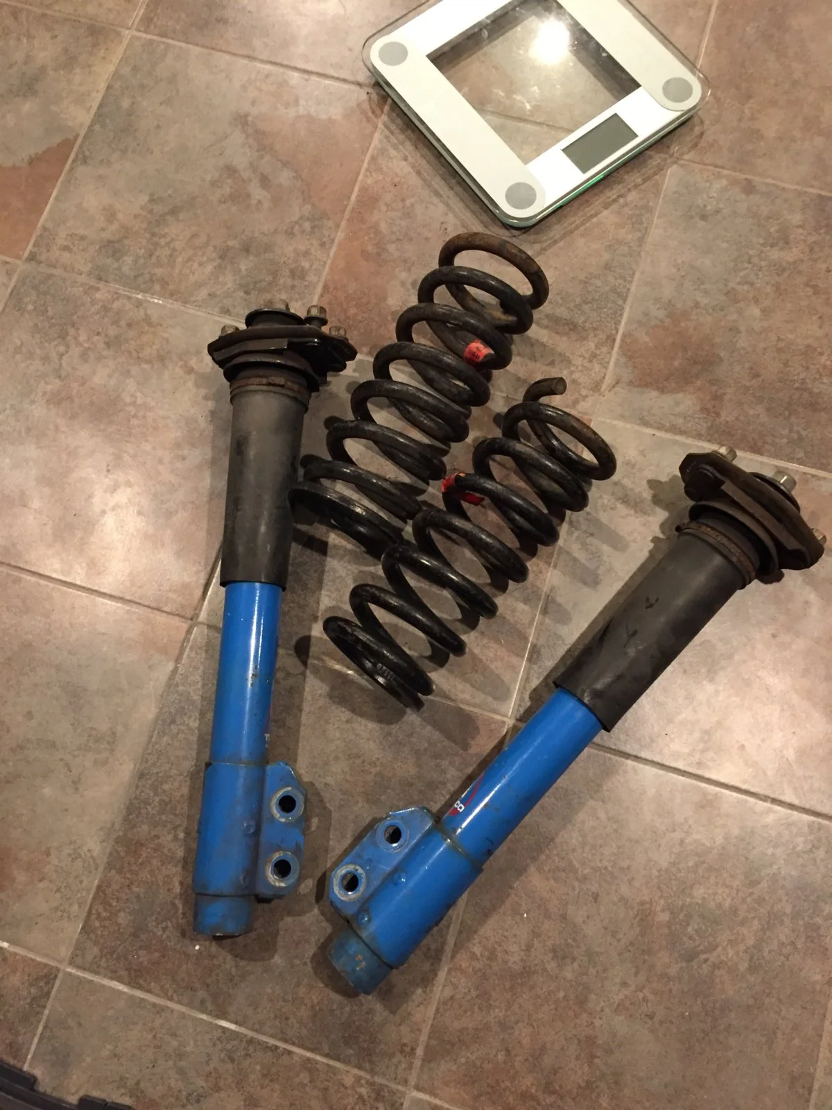

Here's what I got so far.
Tokico struts w/strut mounts : 28.8 lbs combined

Reference photo of the struts and strut mounts

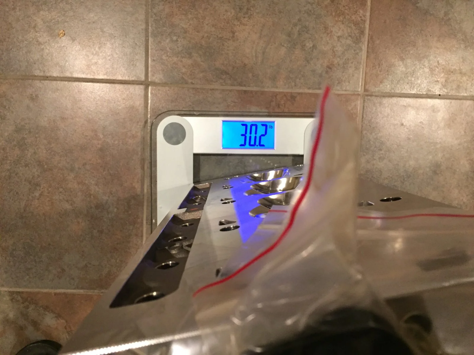

Using their weights listed here, I've kinda calculated out what I've saved. I'll weight the parts later when I get them off, but:
Front struts, coil overs, springs, c/c plates = 38.8 LBS both sides.
So with the K member I get:
MM, k-member, a arms, struts, coil overs, springs, c/c plates = 95.8 LBS
100% Stock suspension stuff: 125.8 LBS
Difference: 30 LBS.

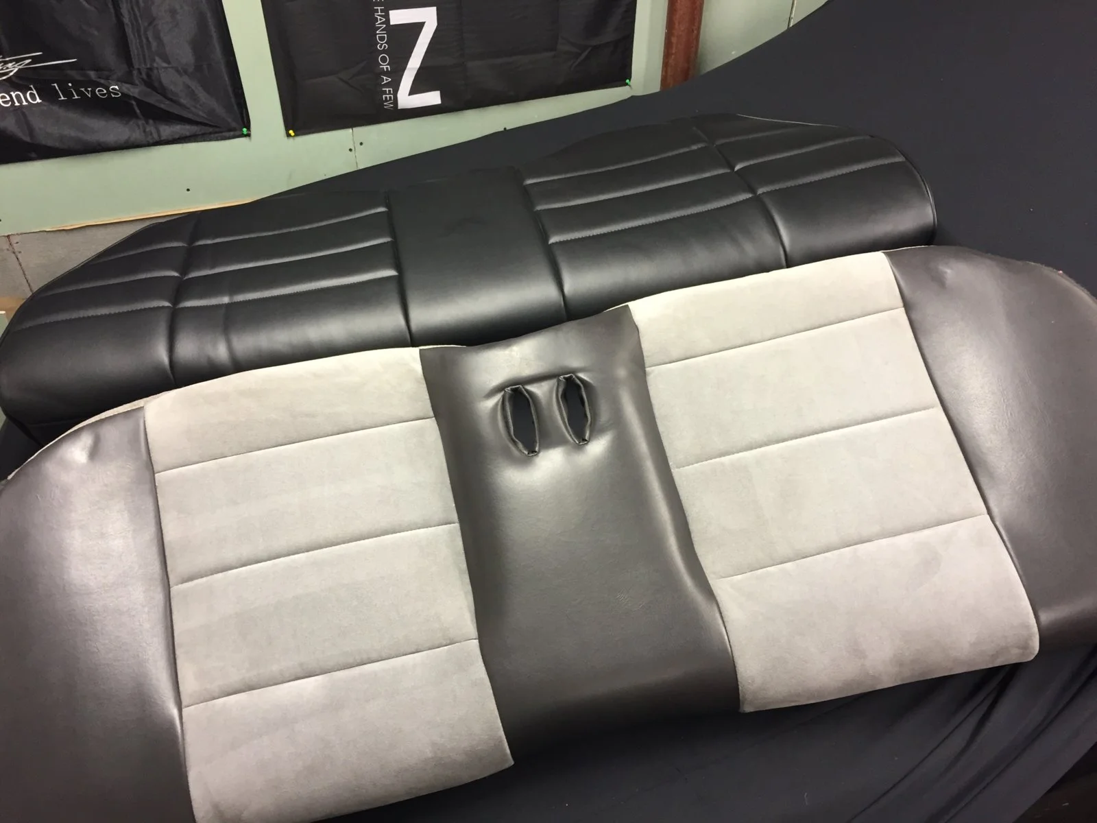

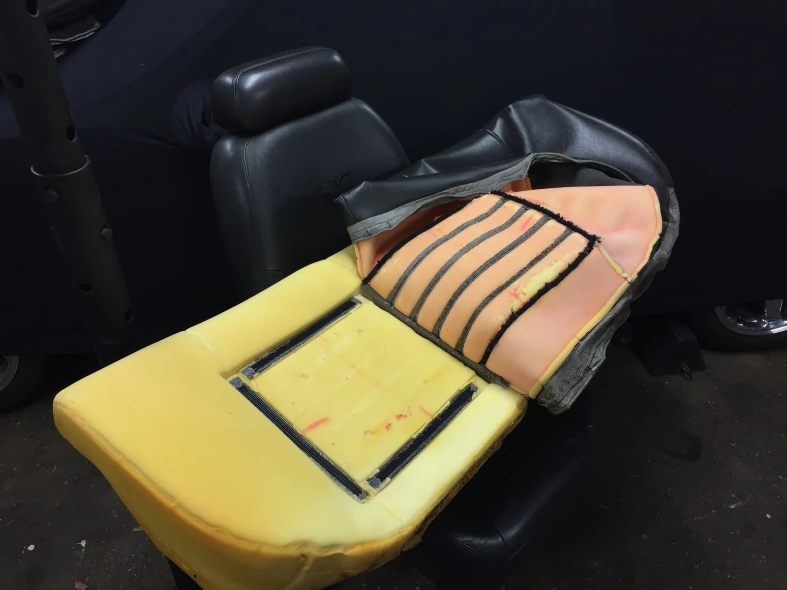

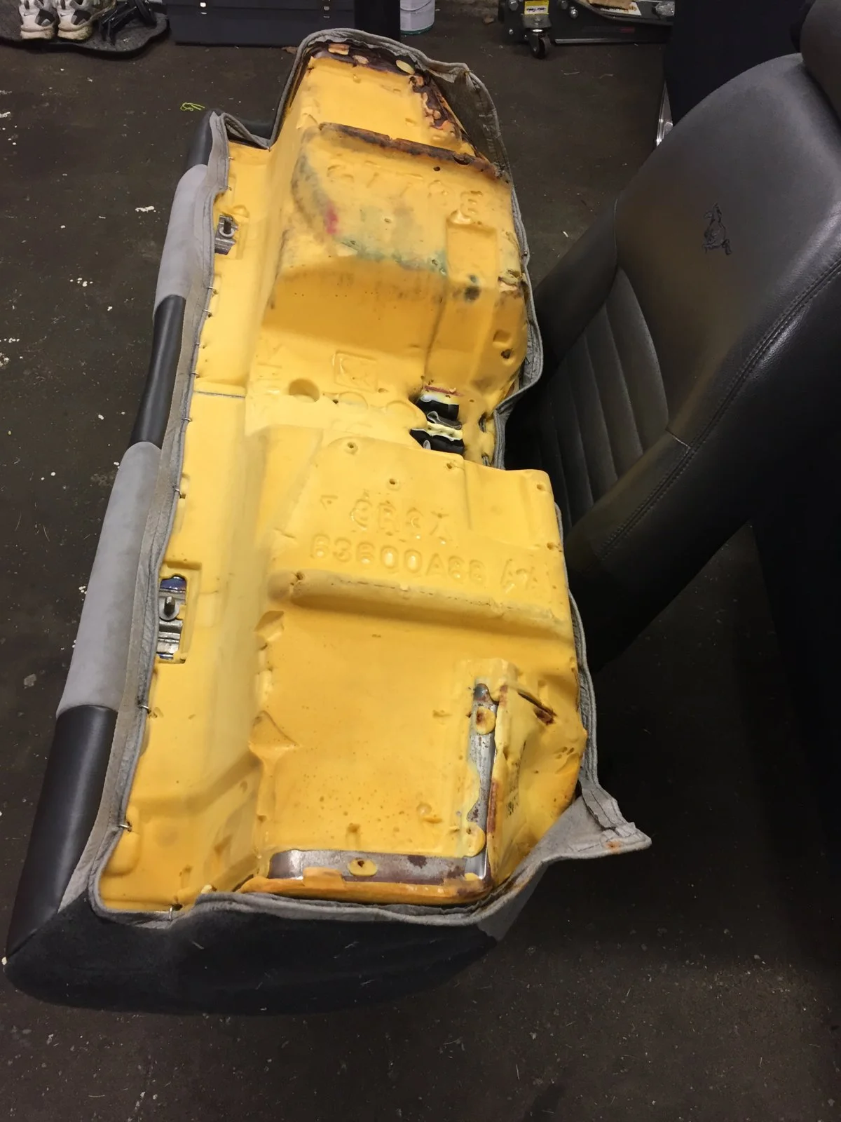

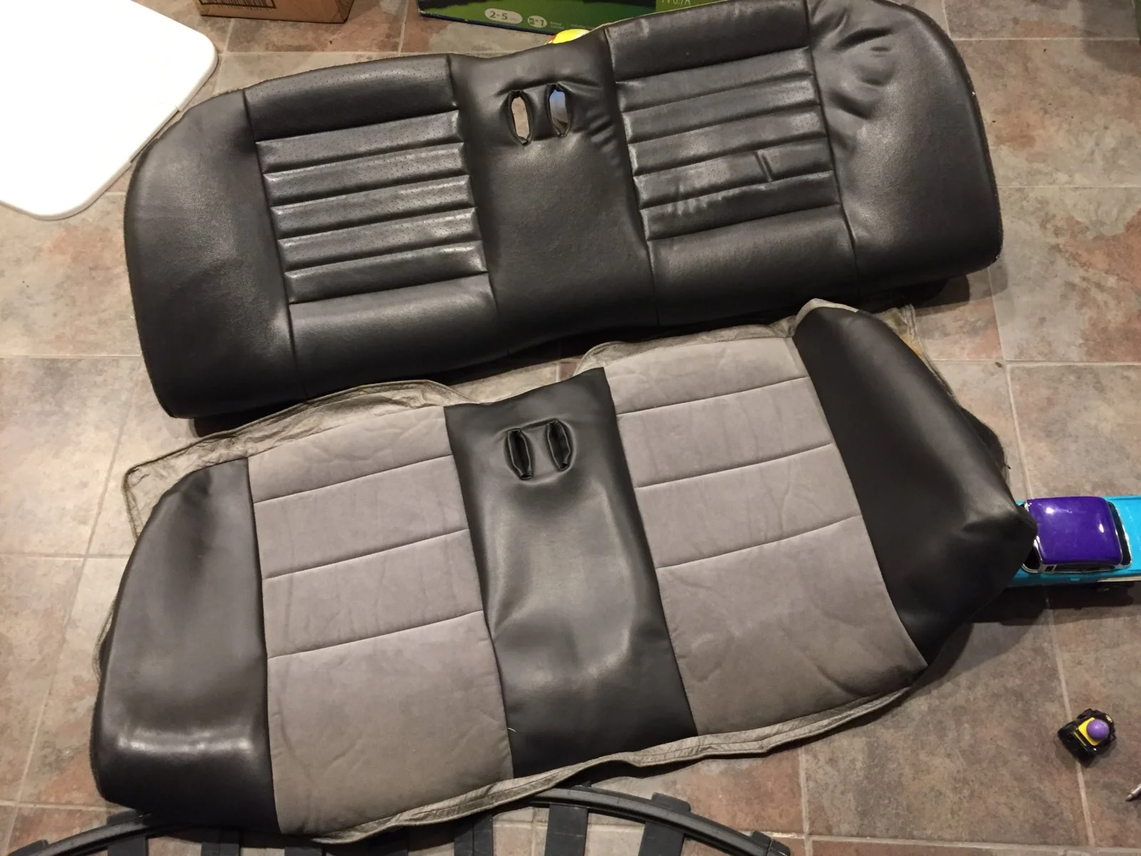

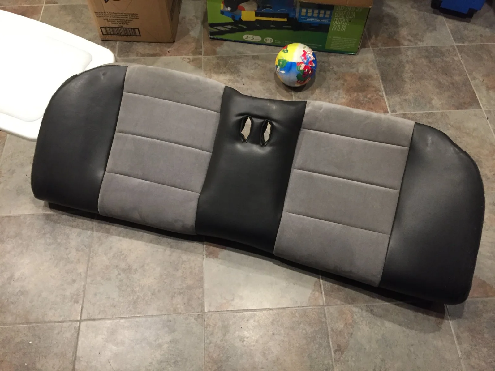

Found a cheap seat cover for an 03-04 Cobra bottom rear. Previous owner removed it from seat improperly and damaged the foam. They figured without the foam it was useless..so I got it cheap.

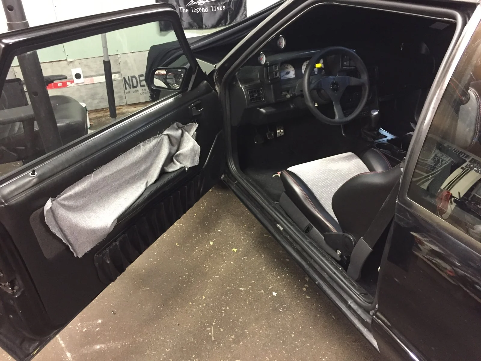

So I broke out my 03-04 GT rear seat nobody wants and ripped that cover off
Wouldn't you know it? The cobra cover fits nicely. Velcro mounting strips are identical. Almost hog ringed down. Did I mention I really starting to like interior work?
Finished work...a mint Cobra seat bottom. Tossed the GT seat material on eBay.

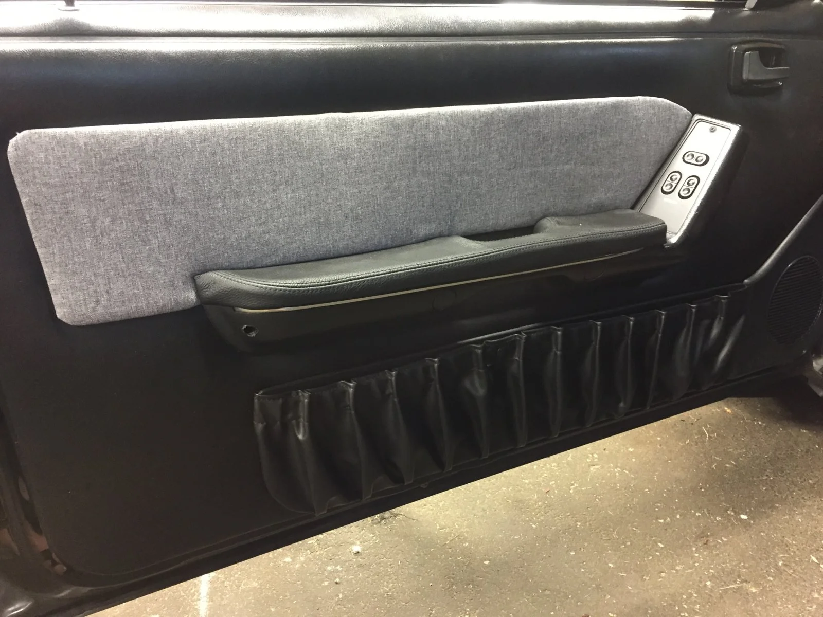

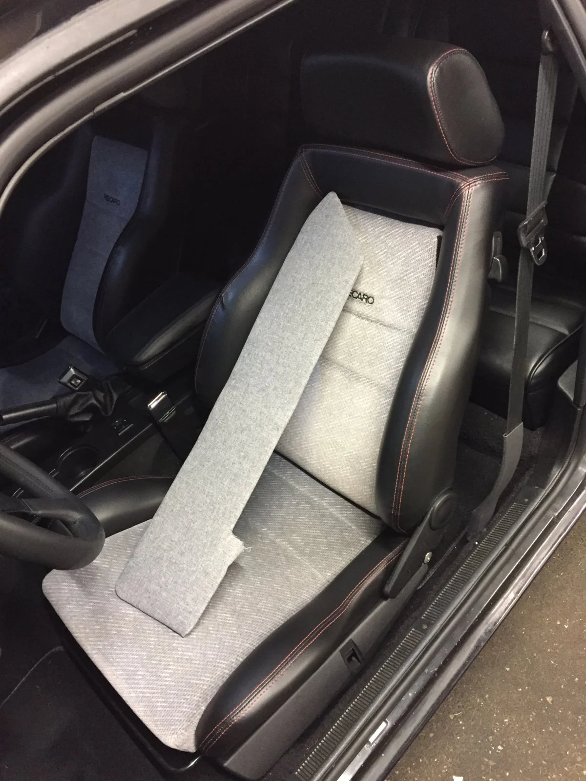

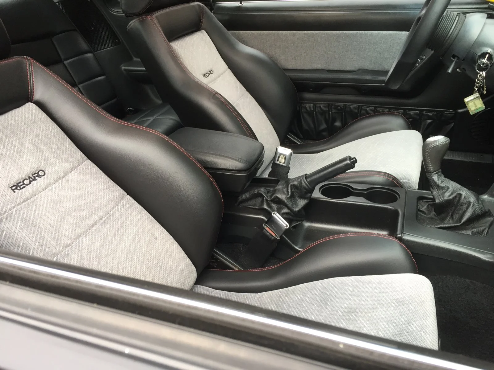

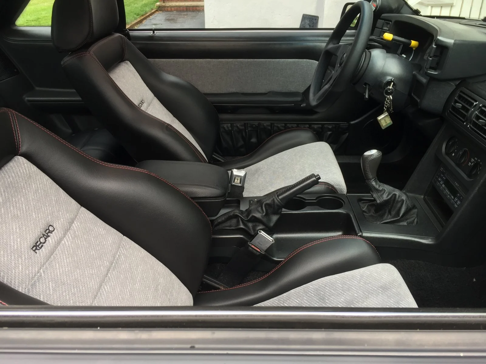

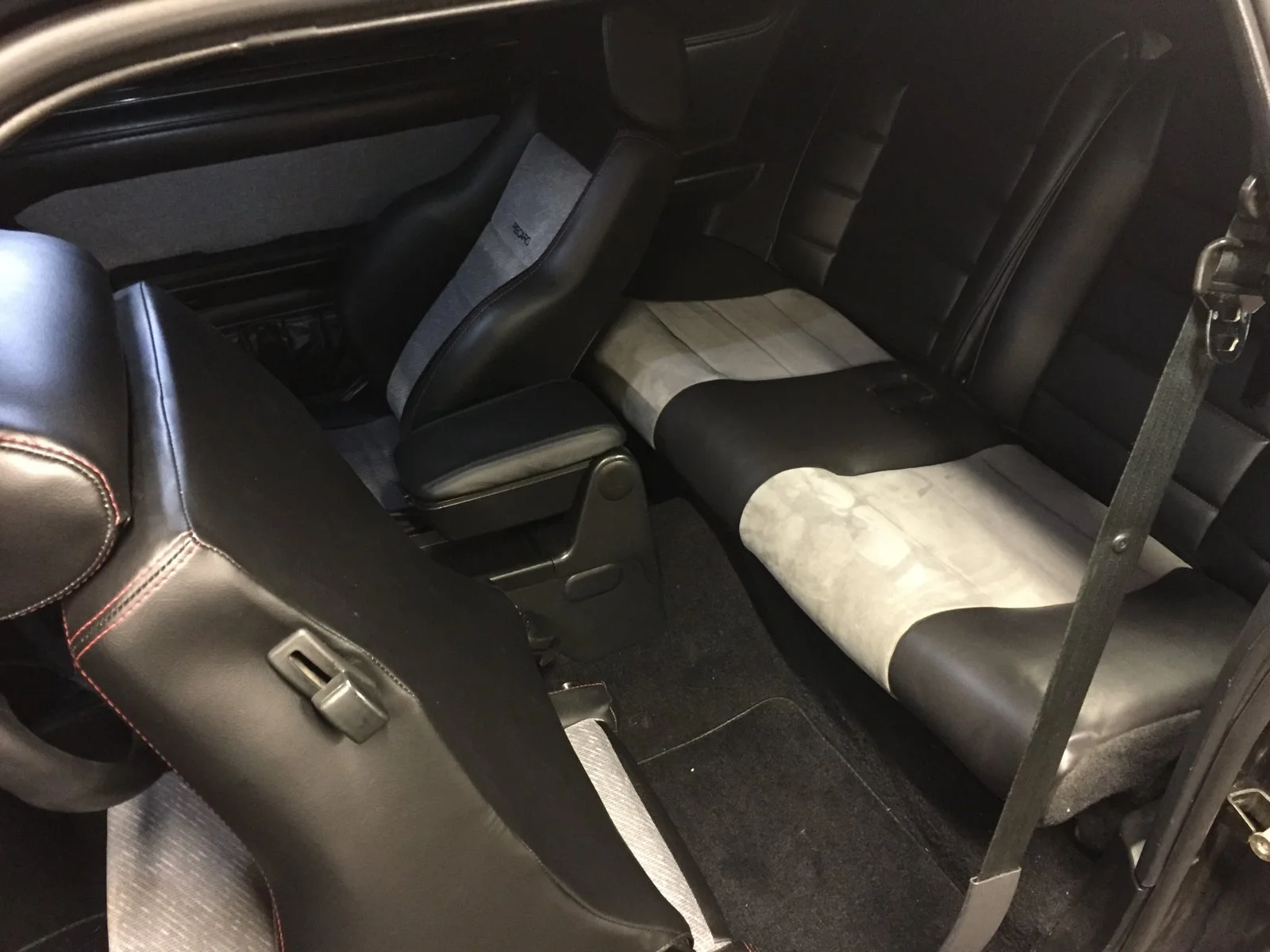

Now to try something....

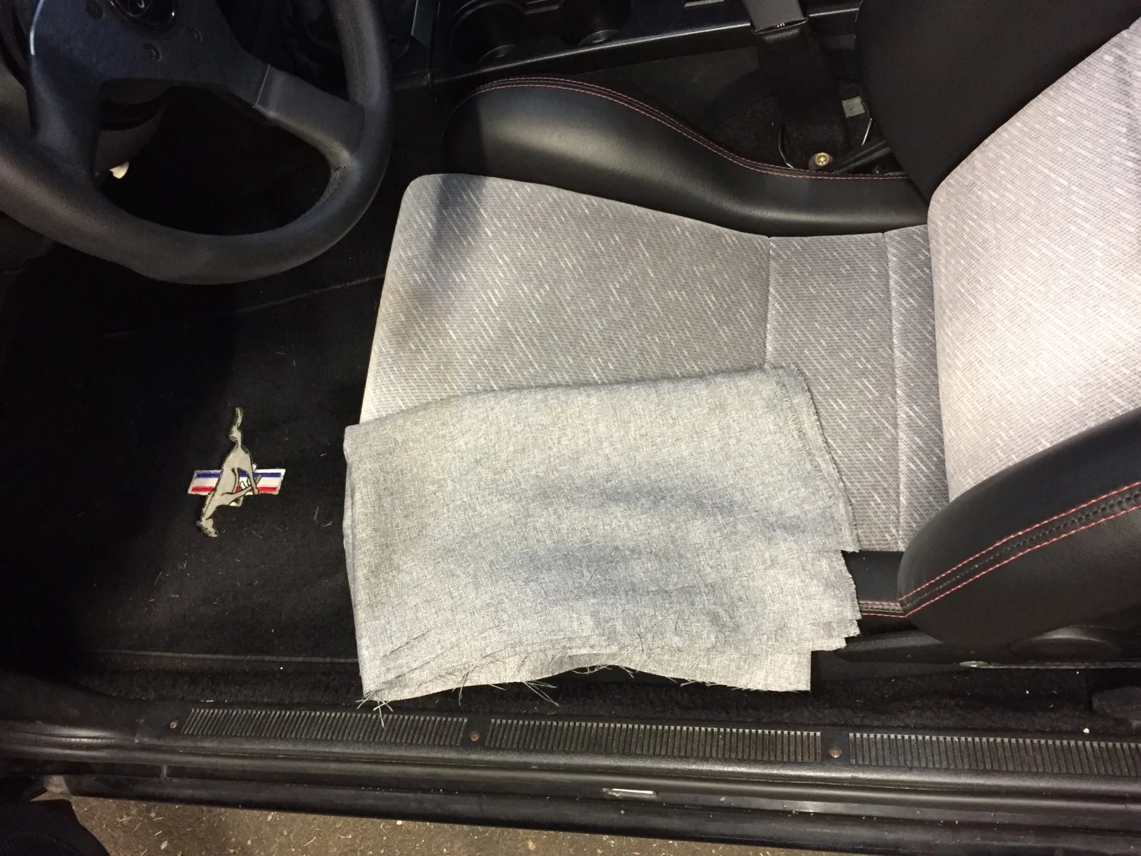

It's close, but the material and color is slightly off. Right now i'm debating if I recover the rear seat to match the front, or the front seat inserts to match the rear.
There is a downside to this though. The SN95 seat bottom doesn't really fit well in a fox, and I still need the cobra seat backs, and donor fox seat backs. At the end of the day, do I want to spend ~$400 or so to put an 03/04 cobra seat in the back that doesn't really fit or match well?
At the same time, I wasn't really crazy about the Corbeau rear seat pattern enough to put a gray insert in it. Still trying to decide how i'll do this without spending a mint.

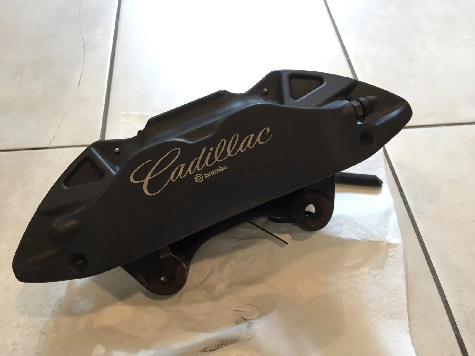

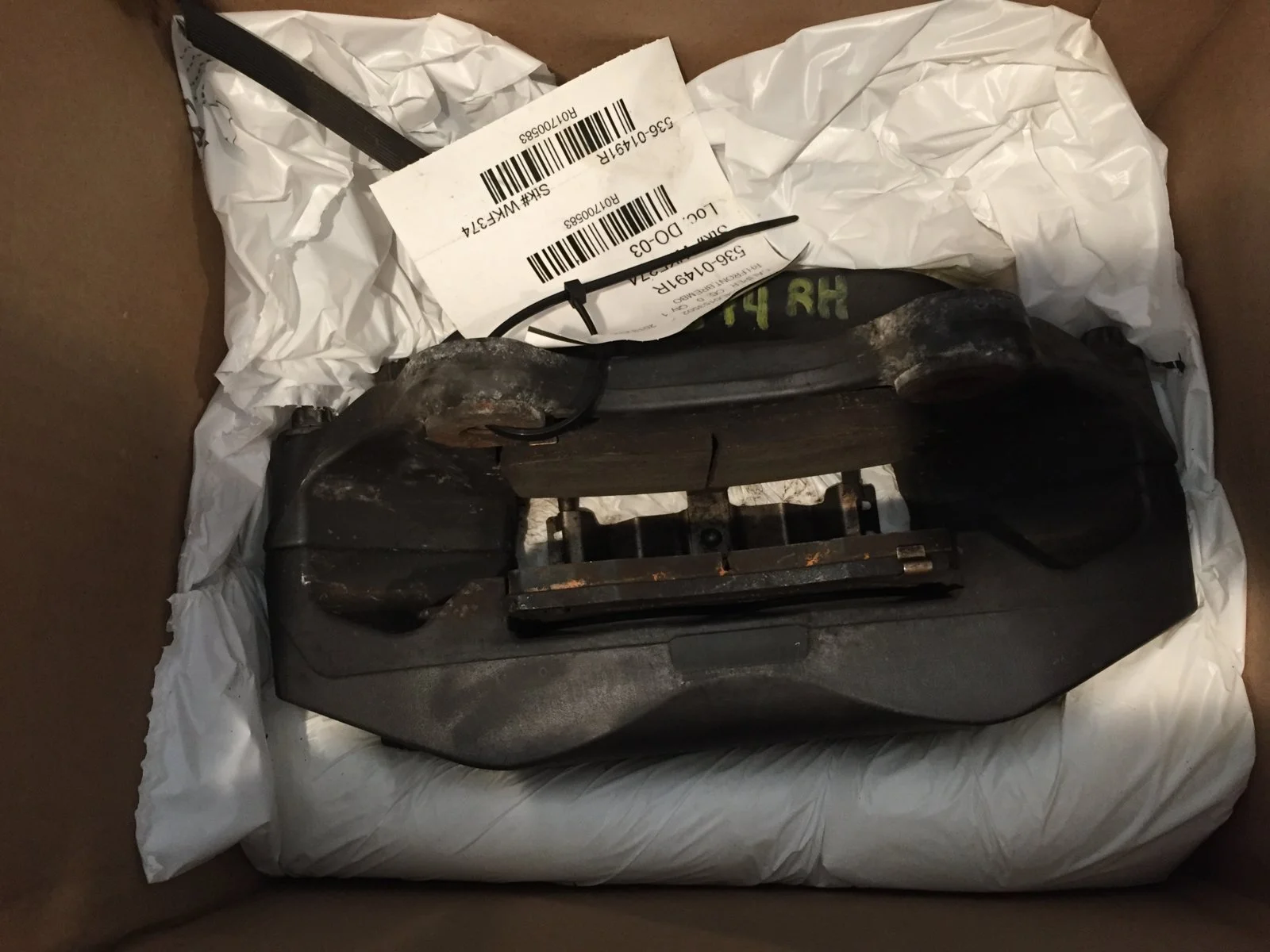

Decided to jump on the ATS brembo bandwagon and see what it's about. I know there are mixed feelings in this mod due to the modifications needed to mount them.
Decided to play around and see if I could find a better way to run these.
Probably not changing out my Corvette calipers at this time as I am 100% happy with the setup...but I'm curious.
$50/shipped....got a nice one from a recycler.

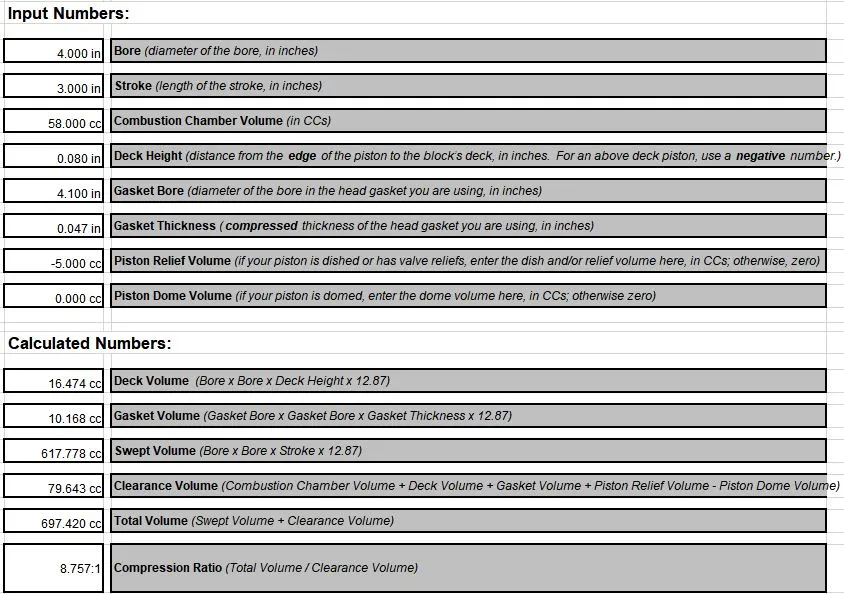

Yes the numbers look right Mike. There is a bit of loss with volume between the bore and above the ring only a few calculators consider this and it's only worth a couple of 100's which is only critical when calculating a spec motor. I use this one online:
