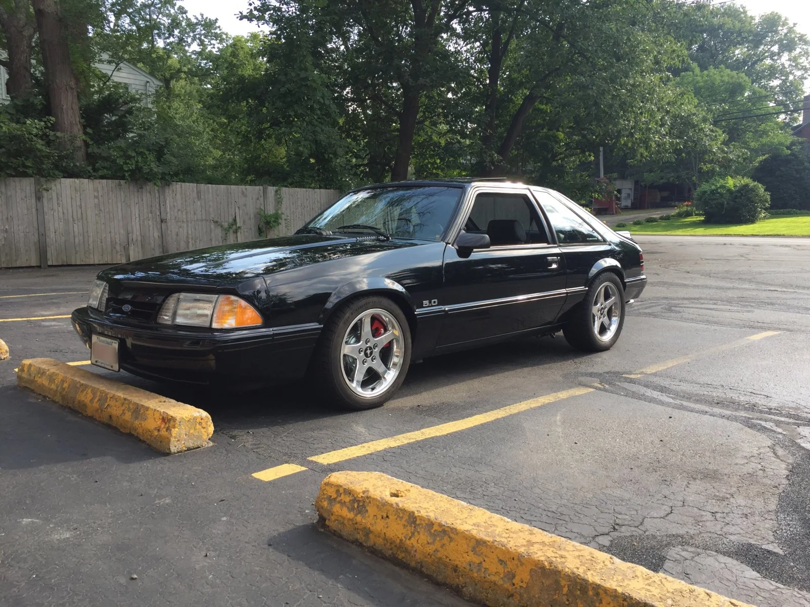

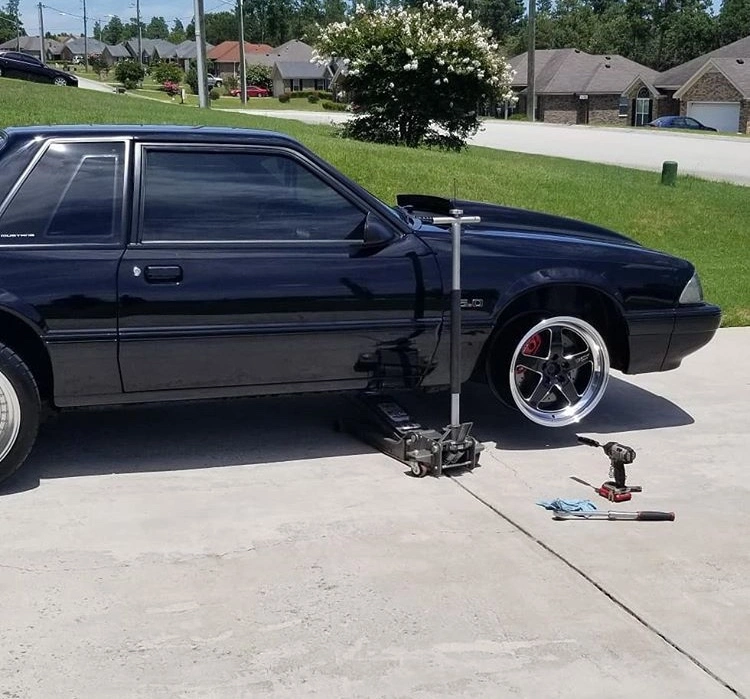

Anyway, took a good shot showing the final ride height while waiting for my food. Think I nailed the stance. Rides relatively well considering.

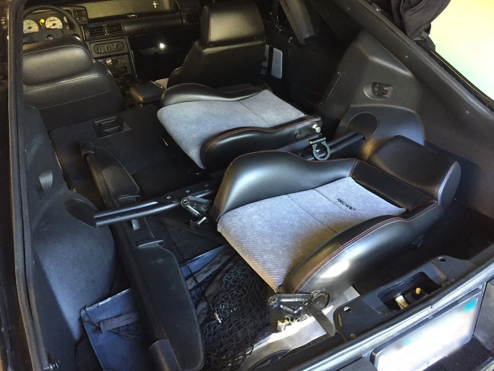

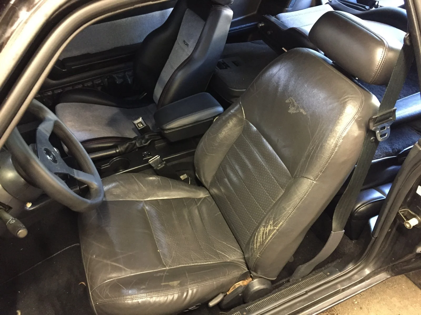

Well, my season is officially done. Swapped out the Recaro to a spare seat that I don’t mind sitting in while dirty to prep for my big job.
Needed a safe place to store the Recaro...so might as well use the hatchbsck

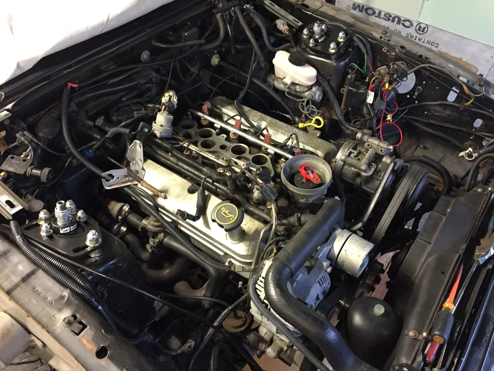

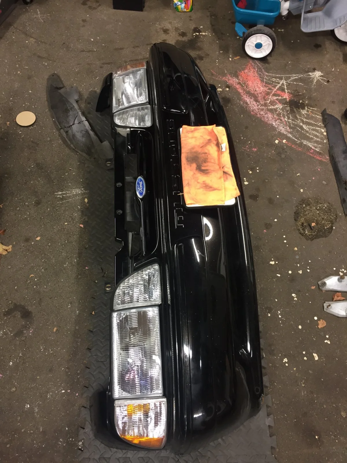

Hoods coming off tomorrow. Then I’ll work on bumper and fenders. Also need to swap to my ‘97 cobra roller wheels

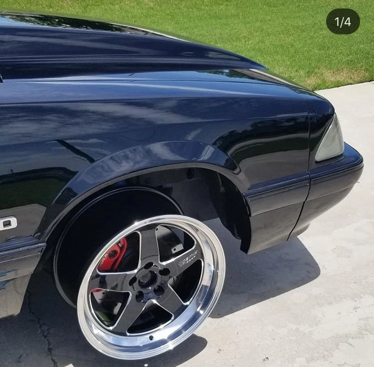

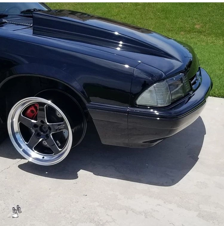

I know you like your cobra wheels, but I think they are holding your car back from true glory. A nice set of custom wheels will set your car off. Especially considering the nice interior, paint and soon to be sweet sounding engine.
Yeah, the wheels have gotten old to me. I’m ready to move on. I have something like these in mind
Cosmis XT-005R
18x9 and 18x10. I’ll have to change my axles out back to Fox lenght. So this won’t be cheap...but it will be the final touch

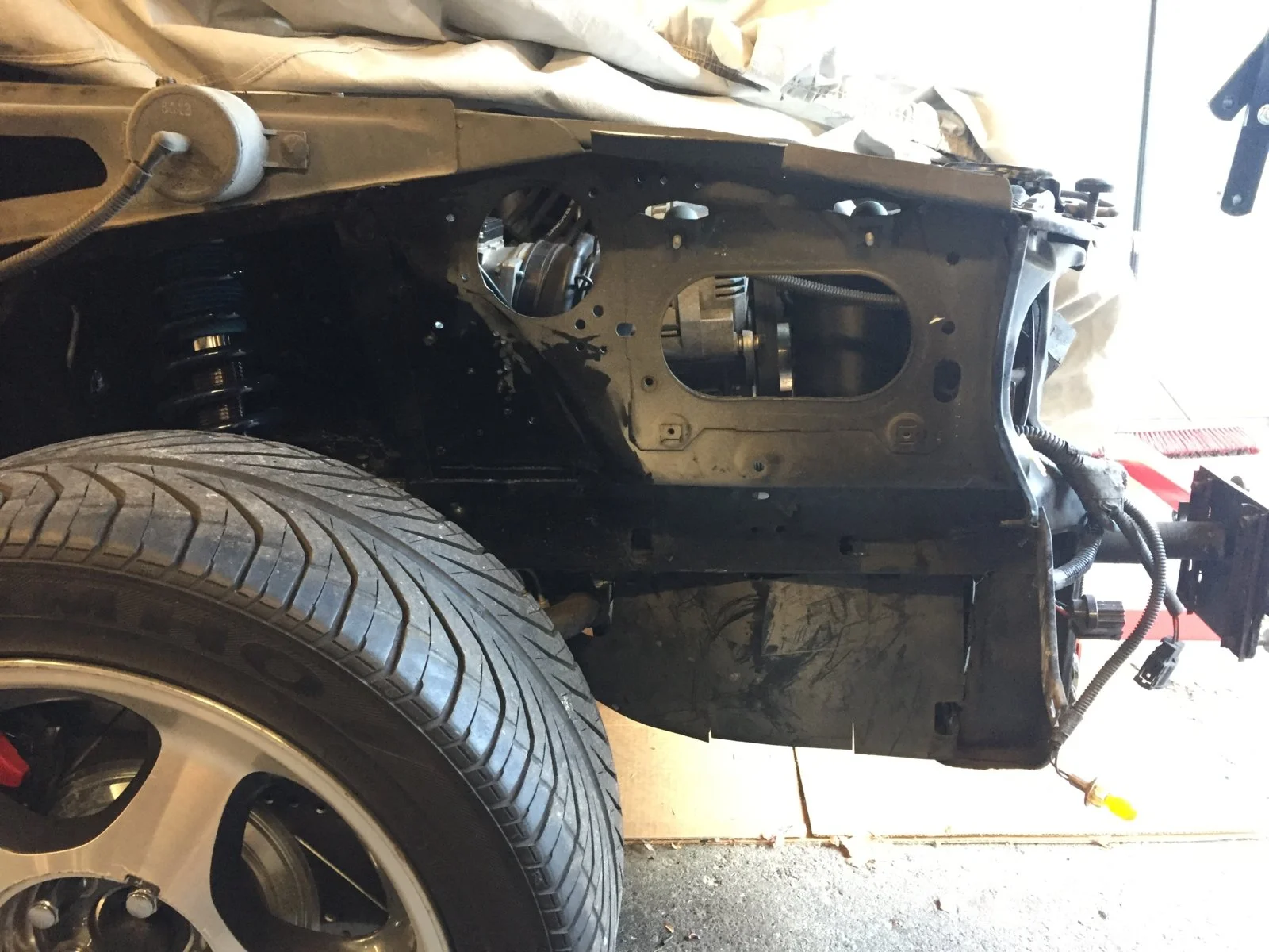

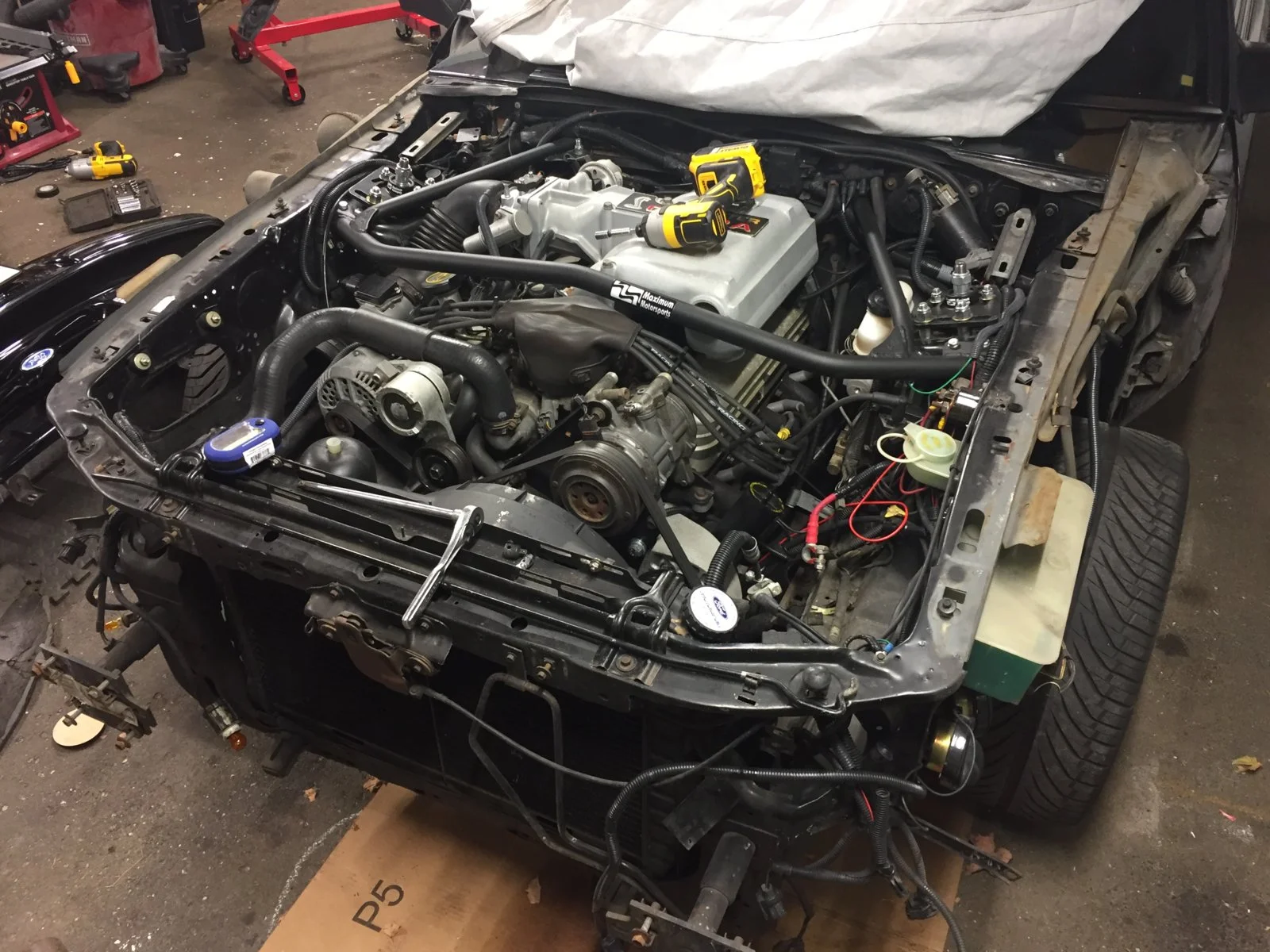

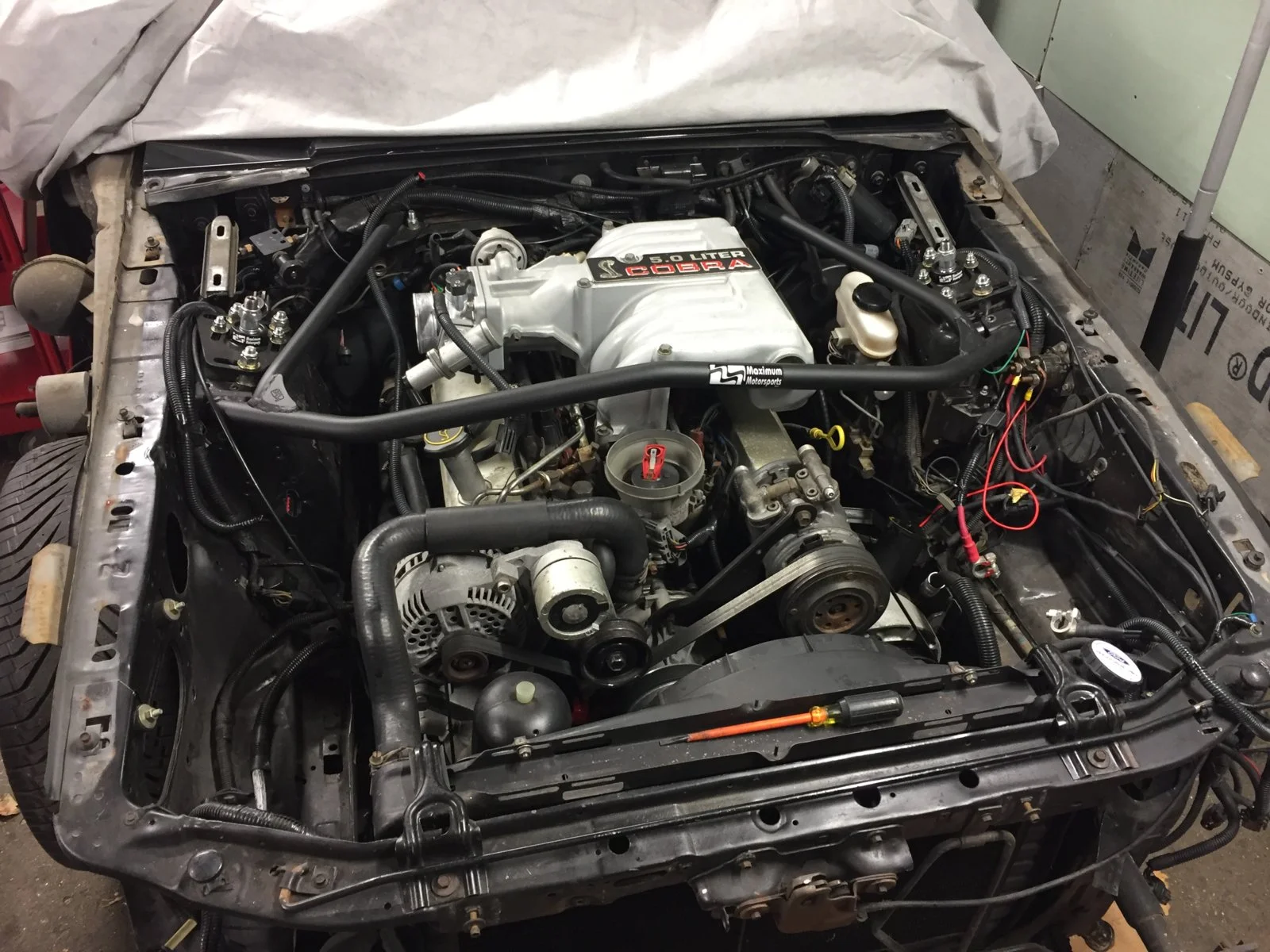

Why did you pull the front end off?
There's more to this project that just the H/C/I. In general my whole front end needs a good cleaning. 31 years of oil leaks and road grim is pretty much all over everything underneath. I've cleaned it pretty well from the firewall back, but need to take care of it up front.
Plus there are some small things I want to clean up like doing a partial wire tuck, relocate my starter solenoid inside the fender, reroute my Air pump hoses inside the fender, and my radiator core support has some rust I'd like to wirewheel up and get a nice coat of paint all over everything.
I also need to replace both door springs and the fenders need to come off to do that. Seemed like a good time.
Also remember that MM K-member brace didn't line up with my k-member? MM confirmed the dimensions are correct so it's likely my k-member is bent. I need to get a good look at everything once the engine is out to see if I have any bent subframe issues. So far doesn't appear so.
Also, it does make it easier to get close to the car without leaning over too far. My back will thank me.

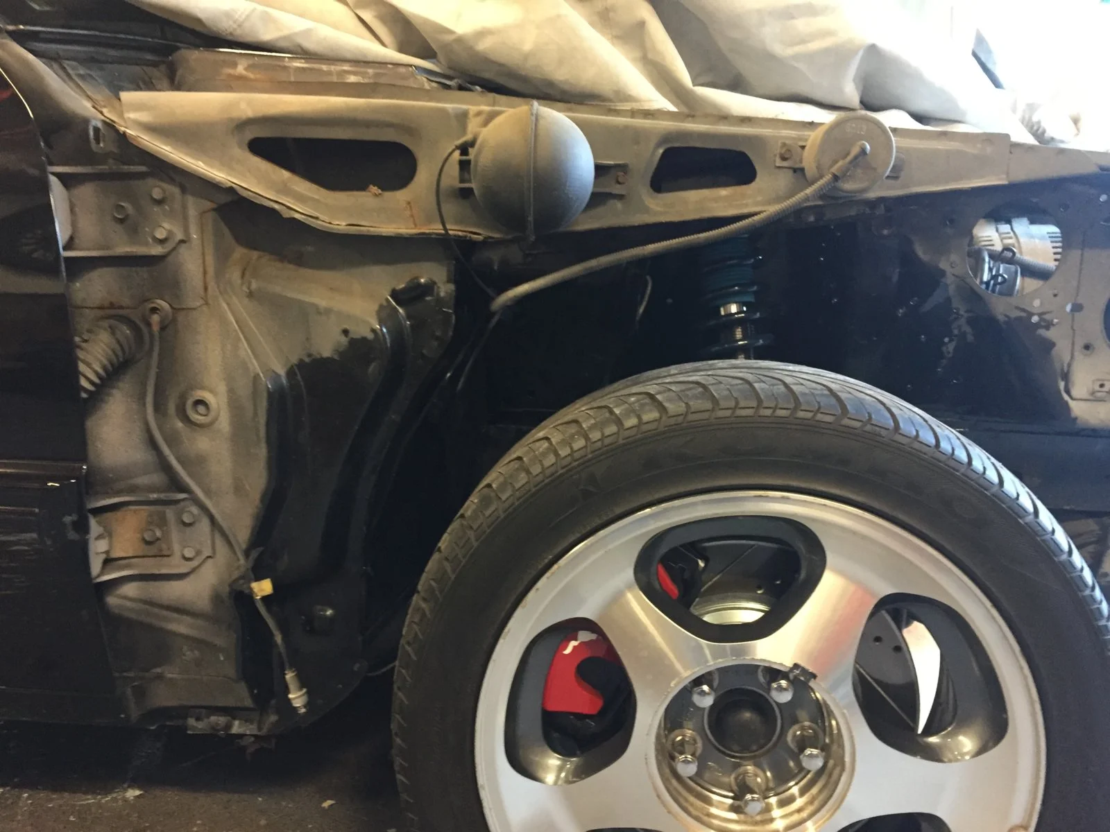

Would you do me a favor Mike? Could you take a good picture of each side showing all the factory under fender items? Hi res so I can zoom up if need be. I've been watching for a good picture of a car that hasn't been messed with. Thanks.
You mean like this?
All I have is my iPhone so it’s as hires as I can go
Excuse my partial POR-15 job. This is part of what I plan on correcting with fenders off
