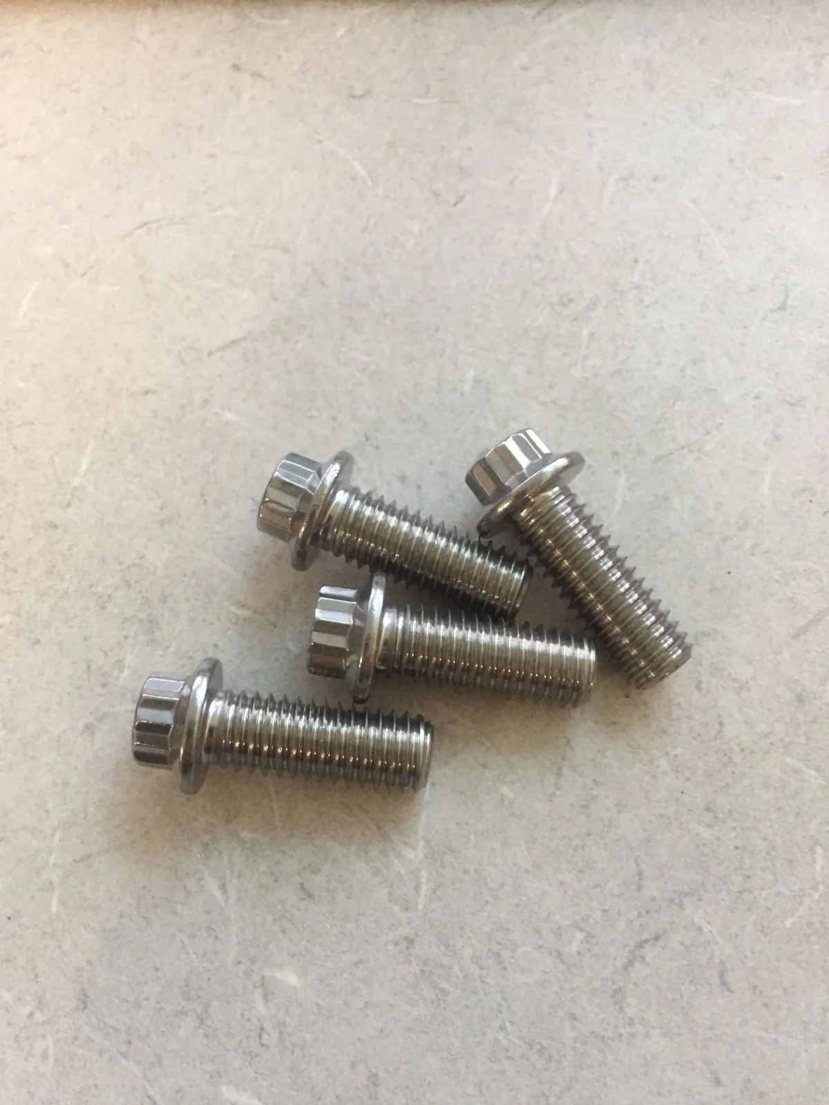

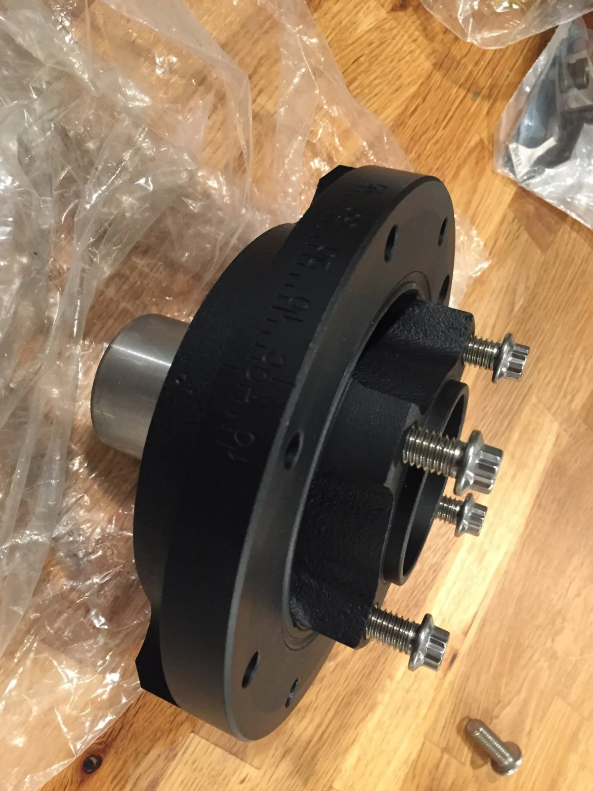

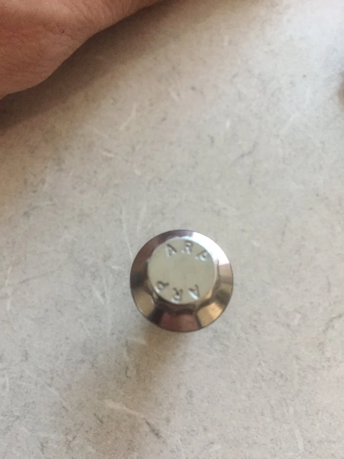

So, rounding up hardware. I really like the ARP 12 pt stuff but hate the cost.
ARP wants $18 plus shipping for 4 bolts I need for the crank pulley.
So I go on McMaster and find some for $8. Guess who makes them?
Brunt of my parts come in tomorrow. Need to find a block of 2 uninterrupted hours to get this done
Reactions: RaggedGT, Olivethefet, stanglx2002 and 1 other person

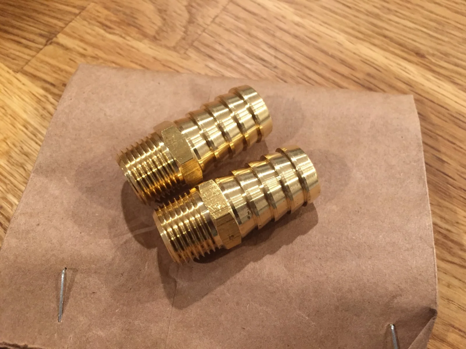

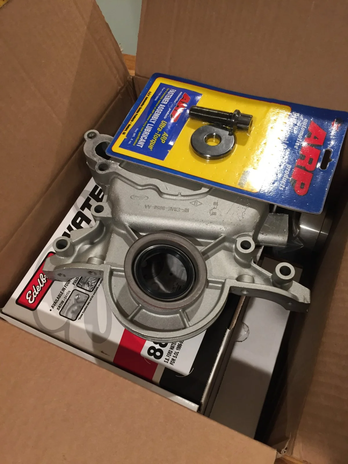

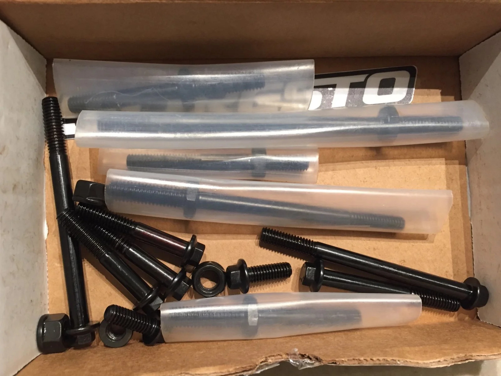

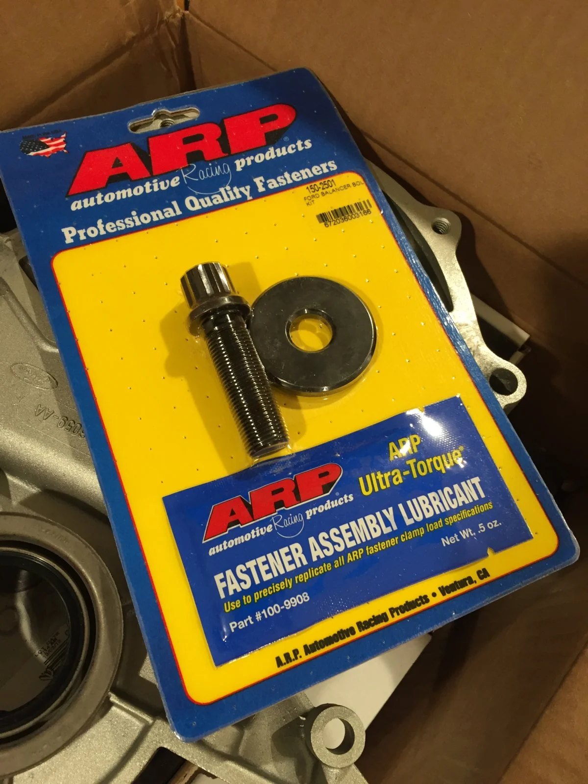

Boxes of parts showed up today. Let’s dissect.
First off LmRs bolt kit. Nice stuff, and it’s ARP....but $90 for hardware blows a monkeys ass

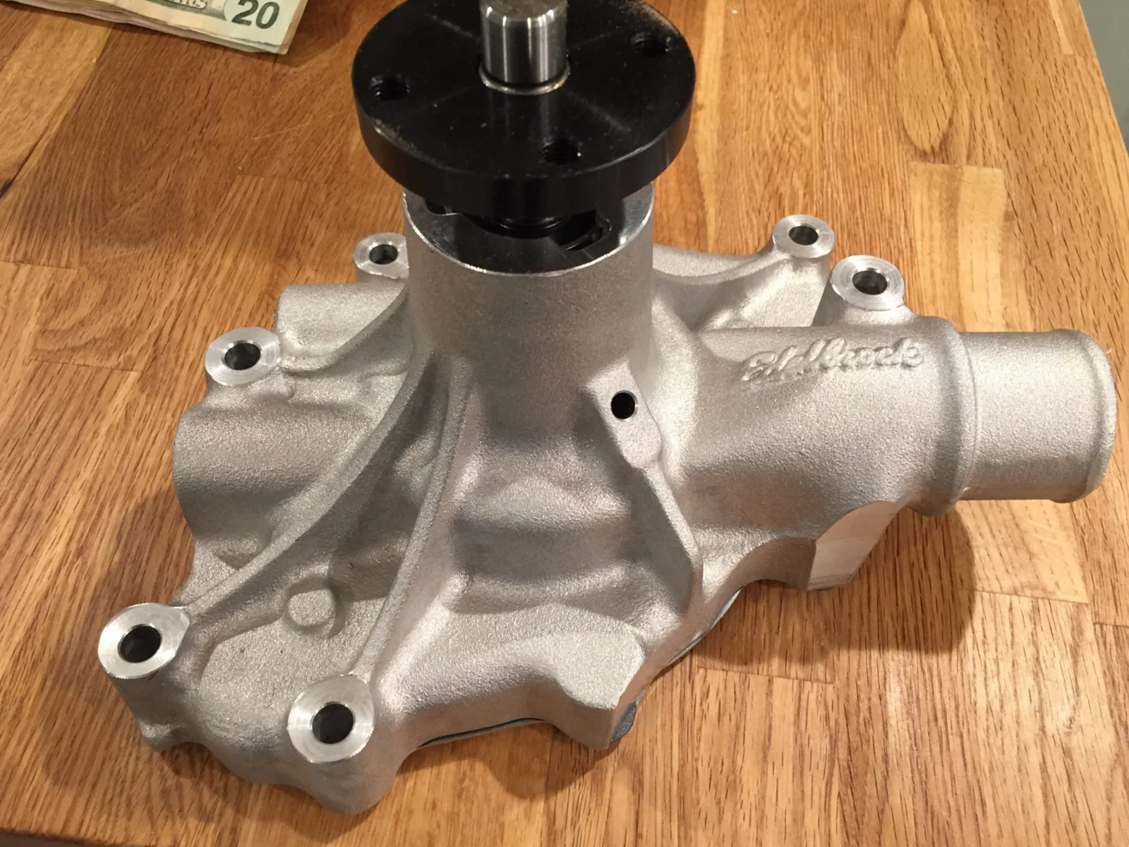

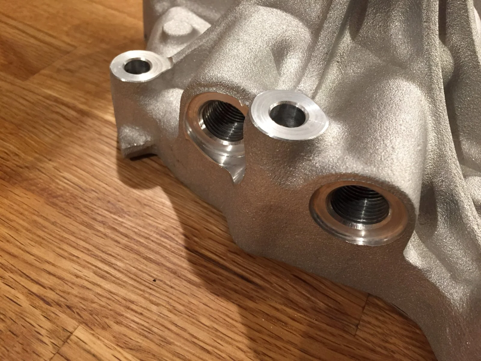

The edelbrock water pump is a nice piece. Well packaged and very nicely made with smooth bearings. Kinda expensive yes...but can’t find much bad said about it
I do like the pipe thread fittings though although I’ll likely replace them with stainless steel fittings
Reactions: Davedacarpainter, RaggedGT, Olivethefet and 1 other person

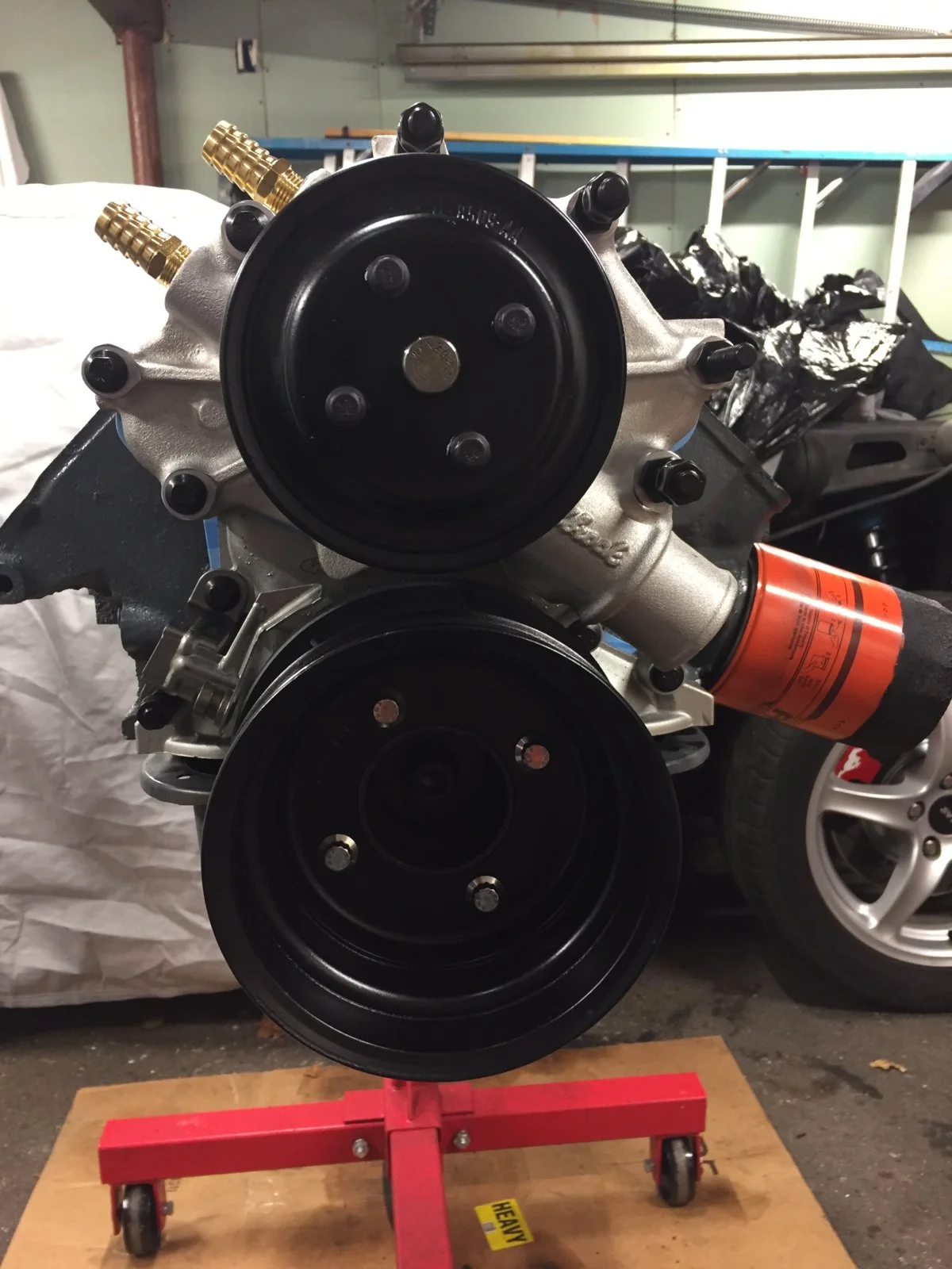

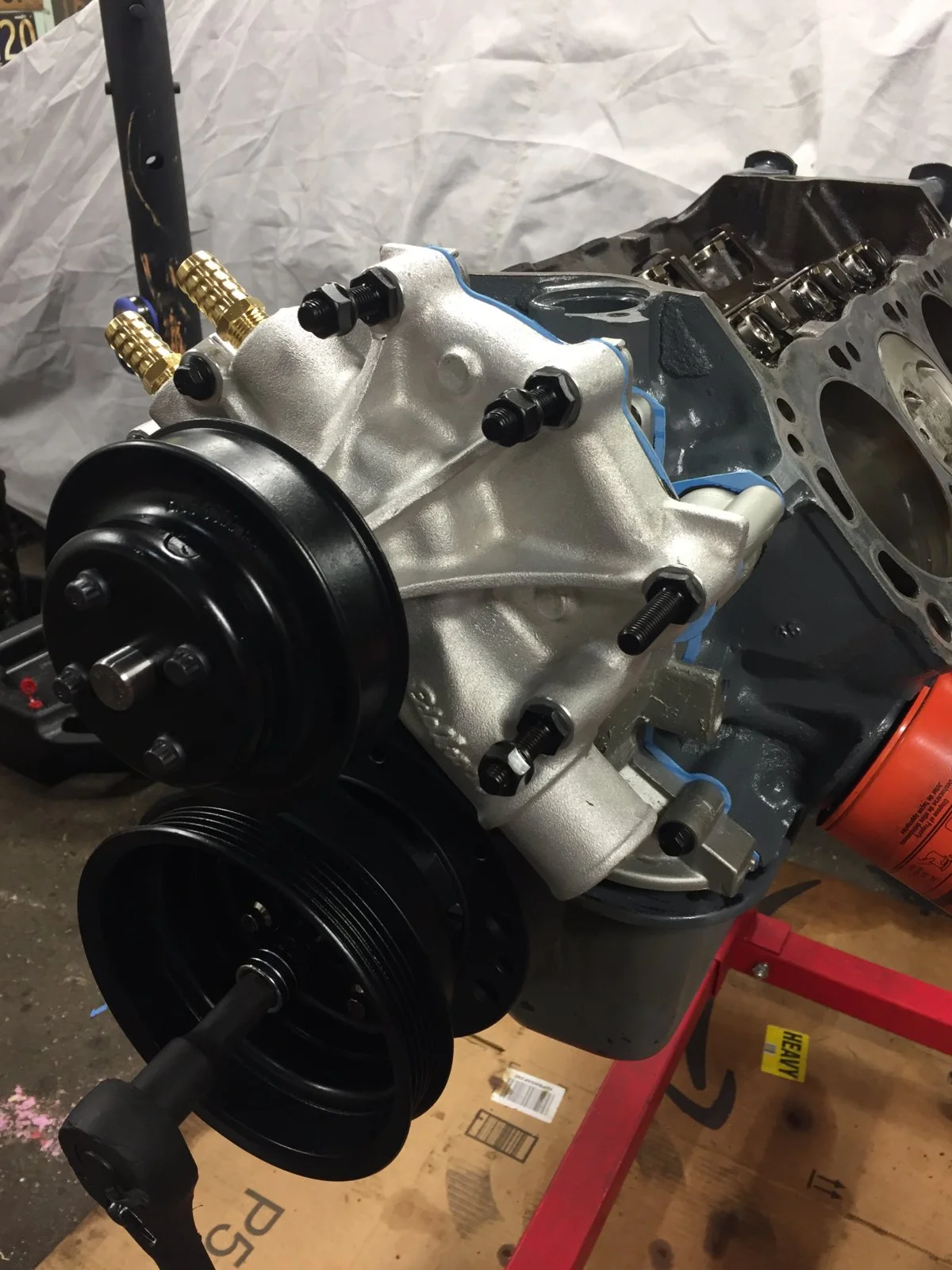

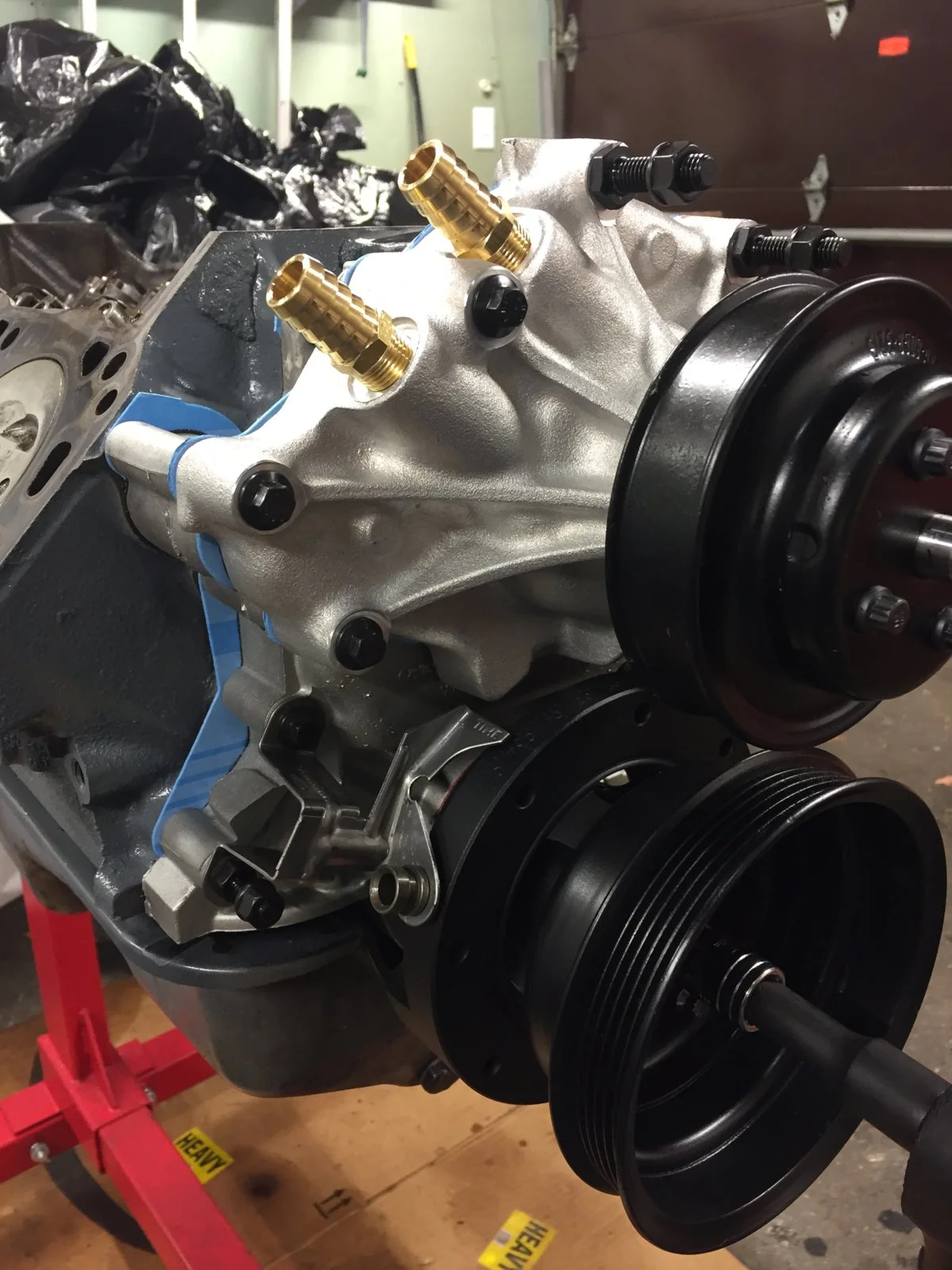

New balancer bolt. No really reason other than everything else being new

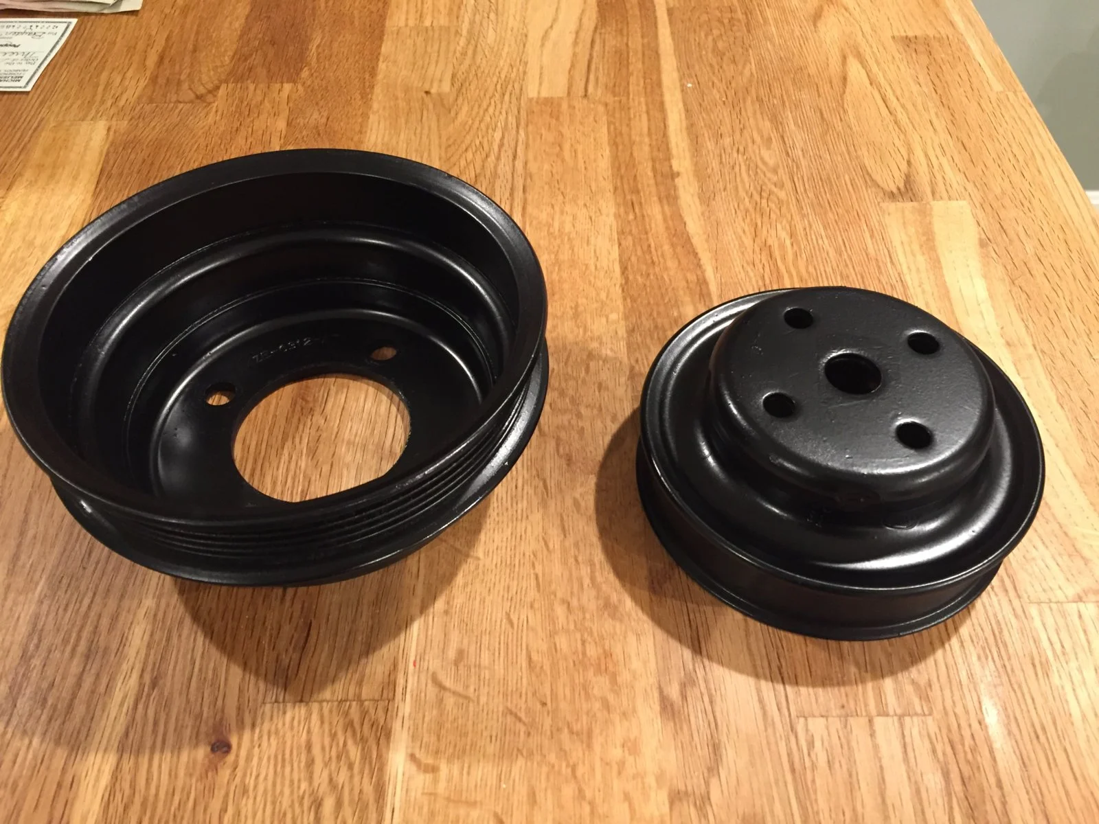

Bought some stock pullies a while back. Gonna Ditch the underdrives as I’m putting the ac back on and want reliability in the cooling system. Scuffed up and painted
That’s it. My box of parts awaits a couple good hours of free time. Then the front is done and onto the heads

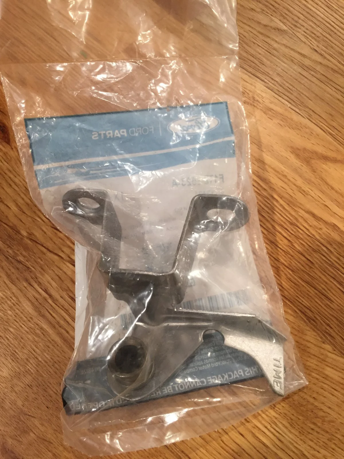

Oh, also forgot
New timing pointer
New balancer
Reactions: Jersey Joe, 90sickfox, 95BlueStallion and 3 others

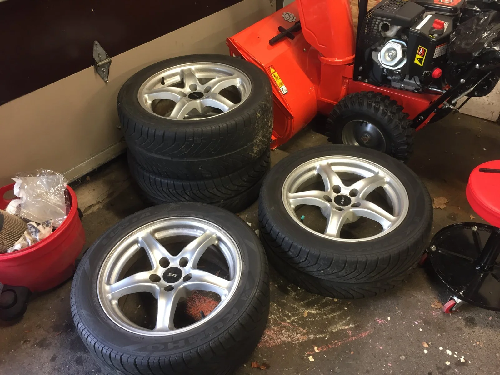

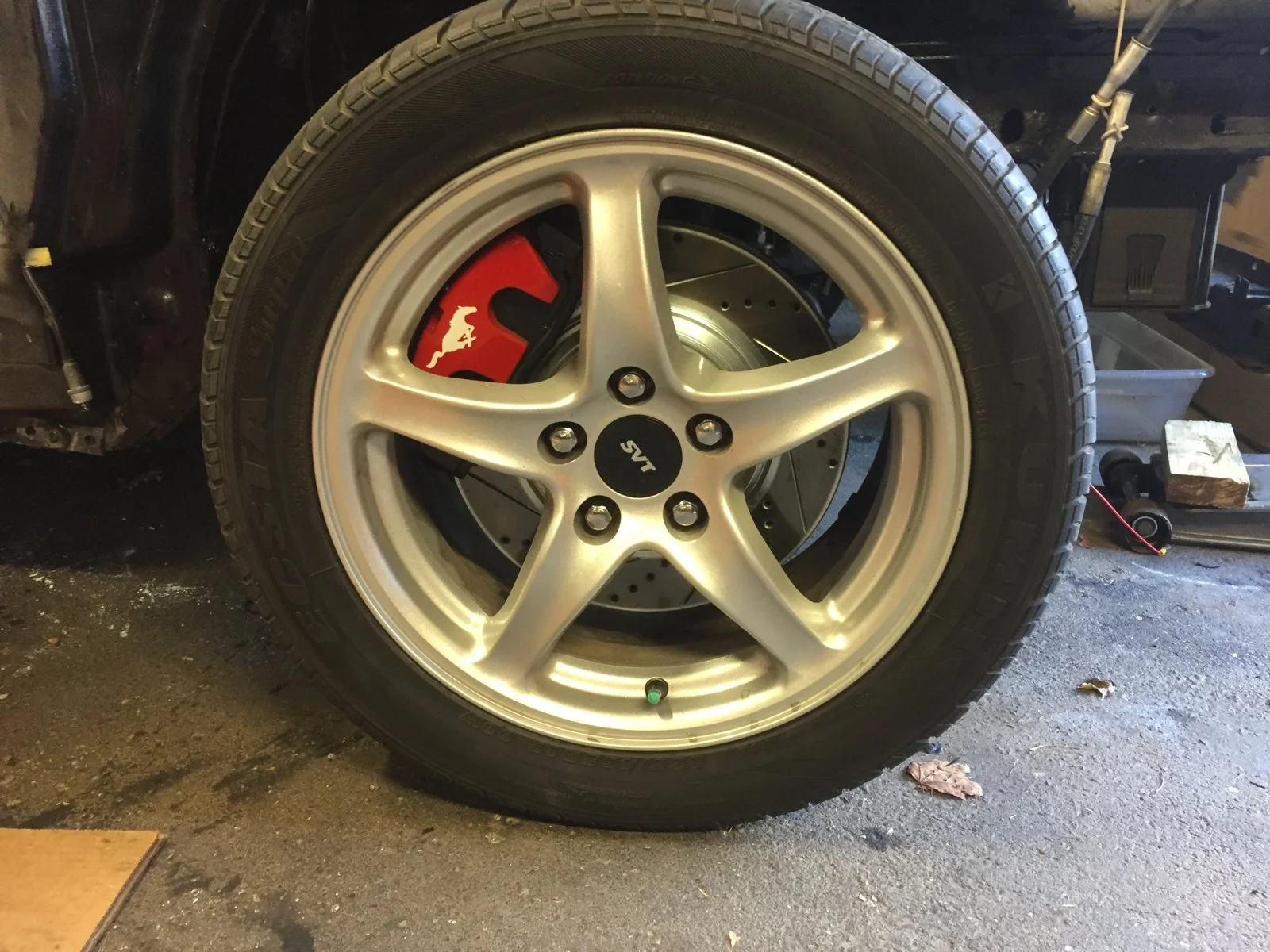

Looking good man, you gonna put the new wheels/tires on the proper side this time?
Mustang5L5
Mod Dude
Feb 18, 2001
43,392
18,135
224
Massachusetts
Nov 10, 2019
#1,431
  • Nov 10, 2019
  • #1,431
At this point I put them on the wrong way just to see how many people point that out.
Edit: looks like this one actually went on the right way
Reactions: 2Blue2 and darryl paarman

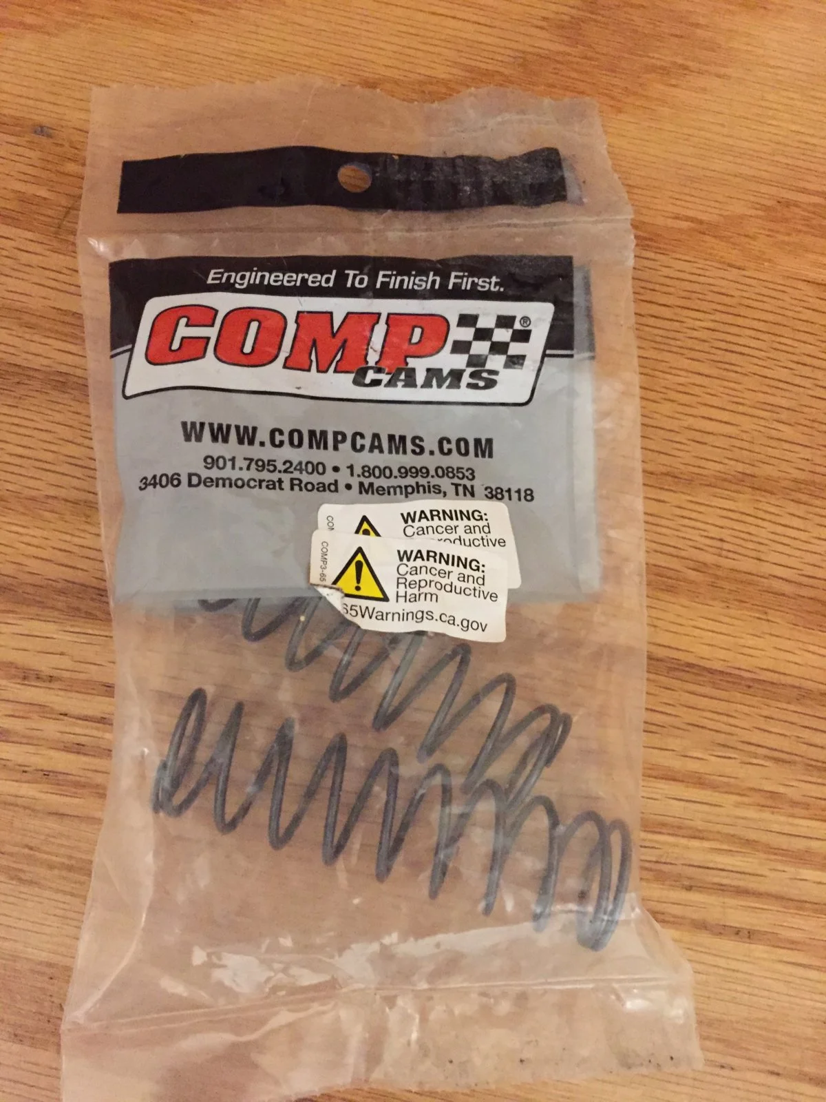

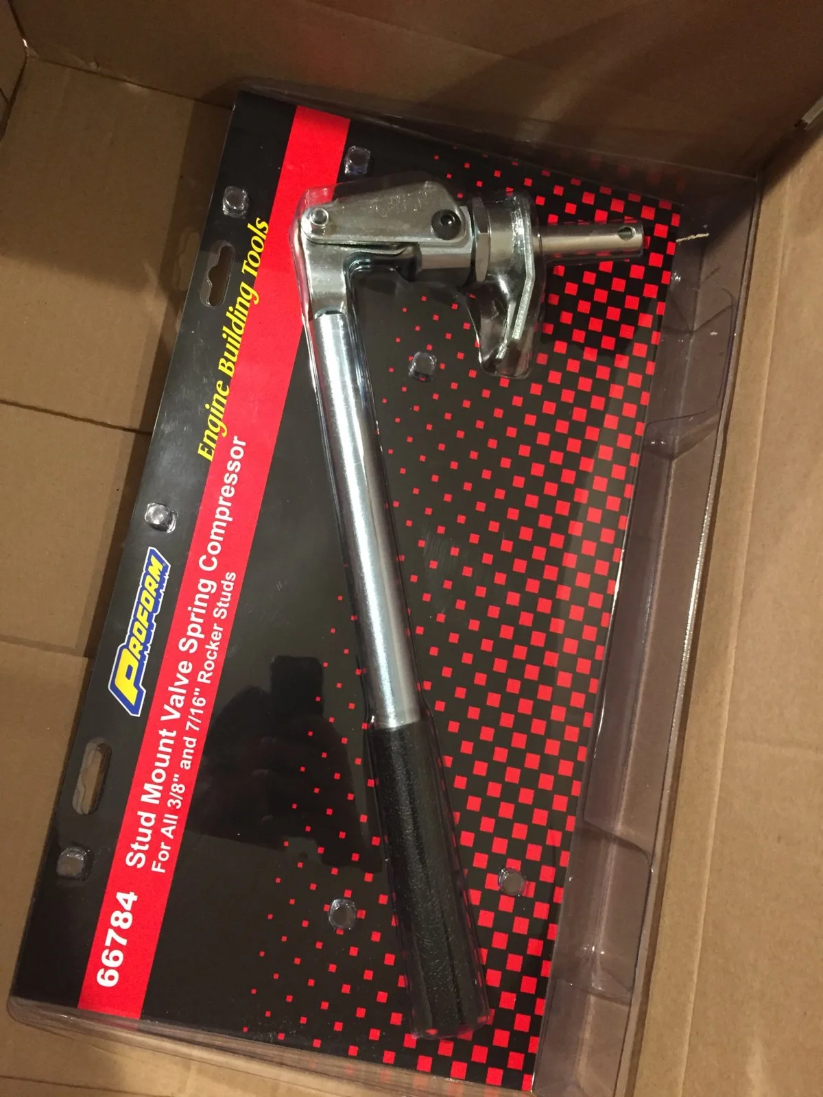

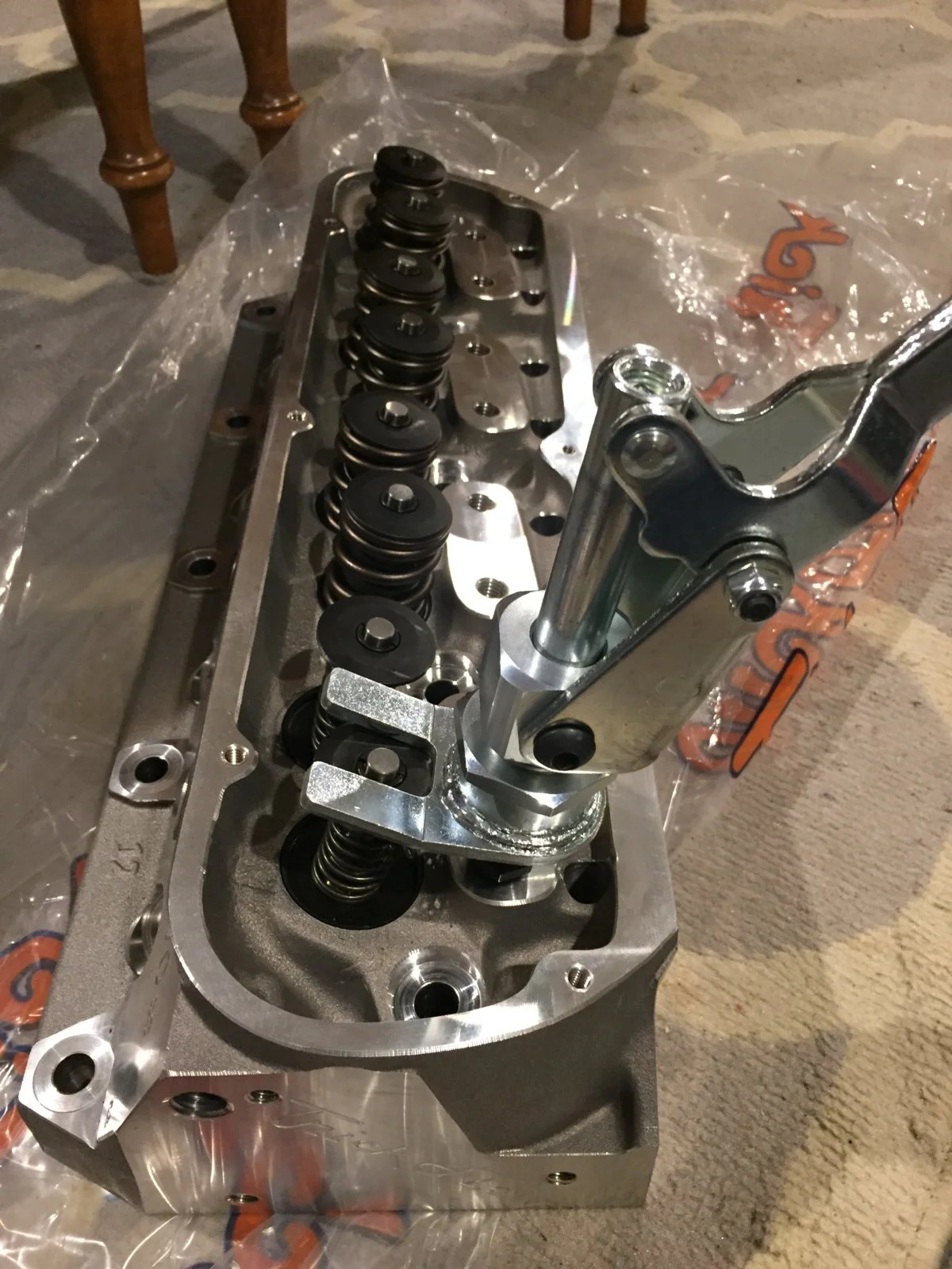

Another cost of engine assembling that gets overlooked. Tools.
Gotta say, Amazon is nice in getting things fast.
Gotta change out the springs to ones to handle the higher lift, but I also neeed to install the checker springs for ptv and pushrod lenght measurement.
Hoping to get in the garage one night this week and get this all done. Getting cold outside and currently 29 and light flurries.
My unheated (but insulated) garage is in the mid 50s, so I really want to get the engine done before the real cold sets in around Jan.
Reactions: 67coupe, Wayne Waldrep, awing and 1 other person

Tool works well, but freeing the valve stem locks was a bit of a PITA
Reactions: Olivethefet and General karthief

I used this video from Straub when I set-up the valve train on my last build, worked out really good.
View: https://www.youtube.com/watch?v=o5is9BsH5OU

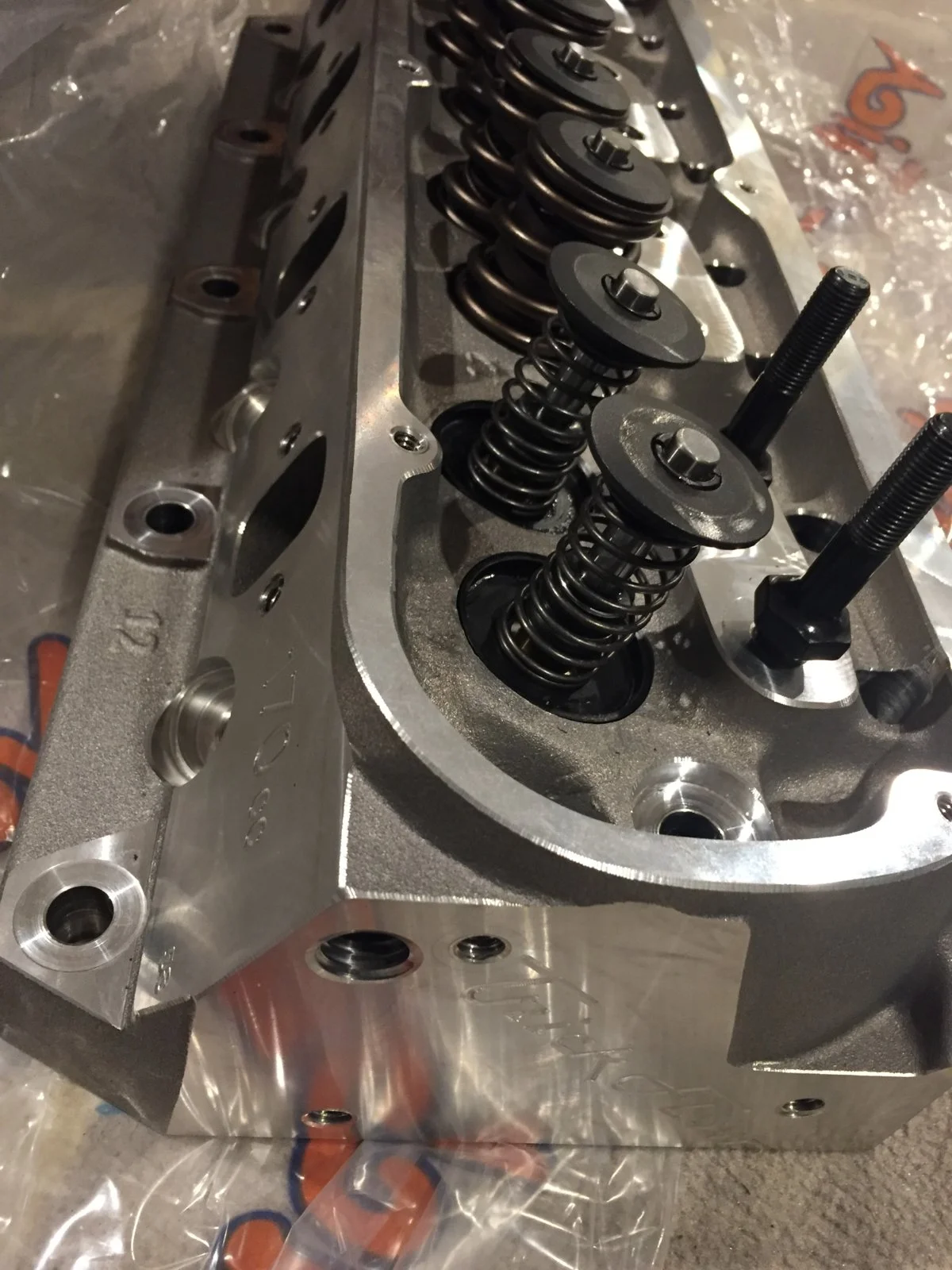

Found a couple hours of free time.
Back to the OEM pullies.

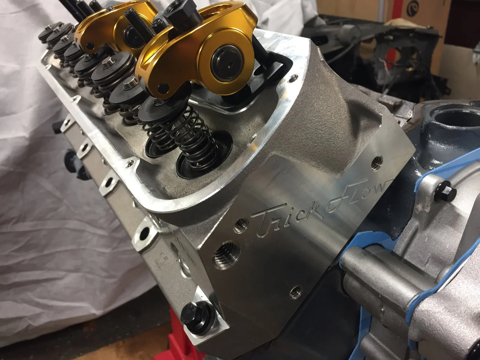

Ok, time to work on installing the heads
Reactions: darryl paarman, stanglx2002, 02 281 GT and 5 others

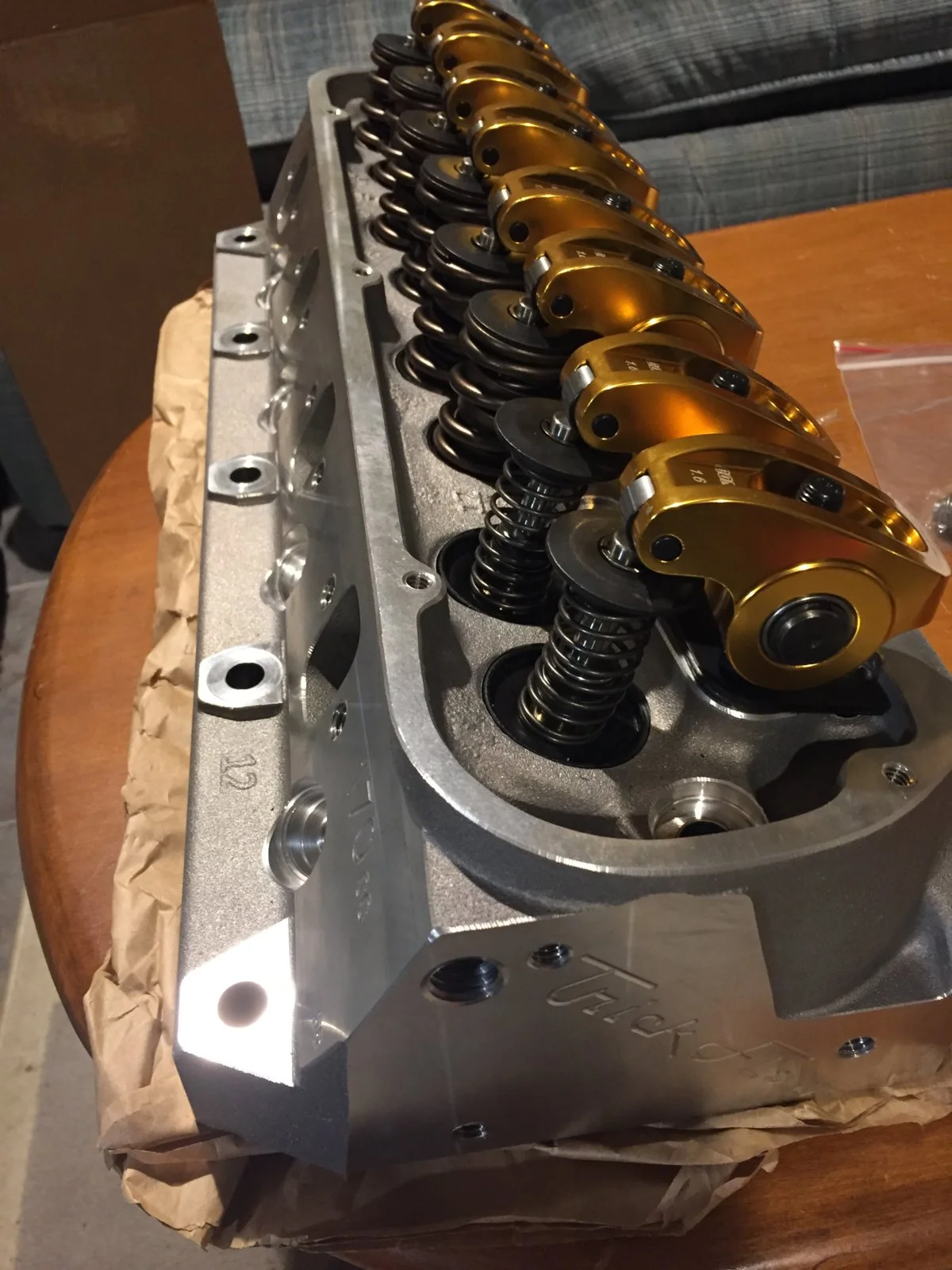

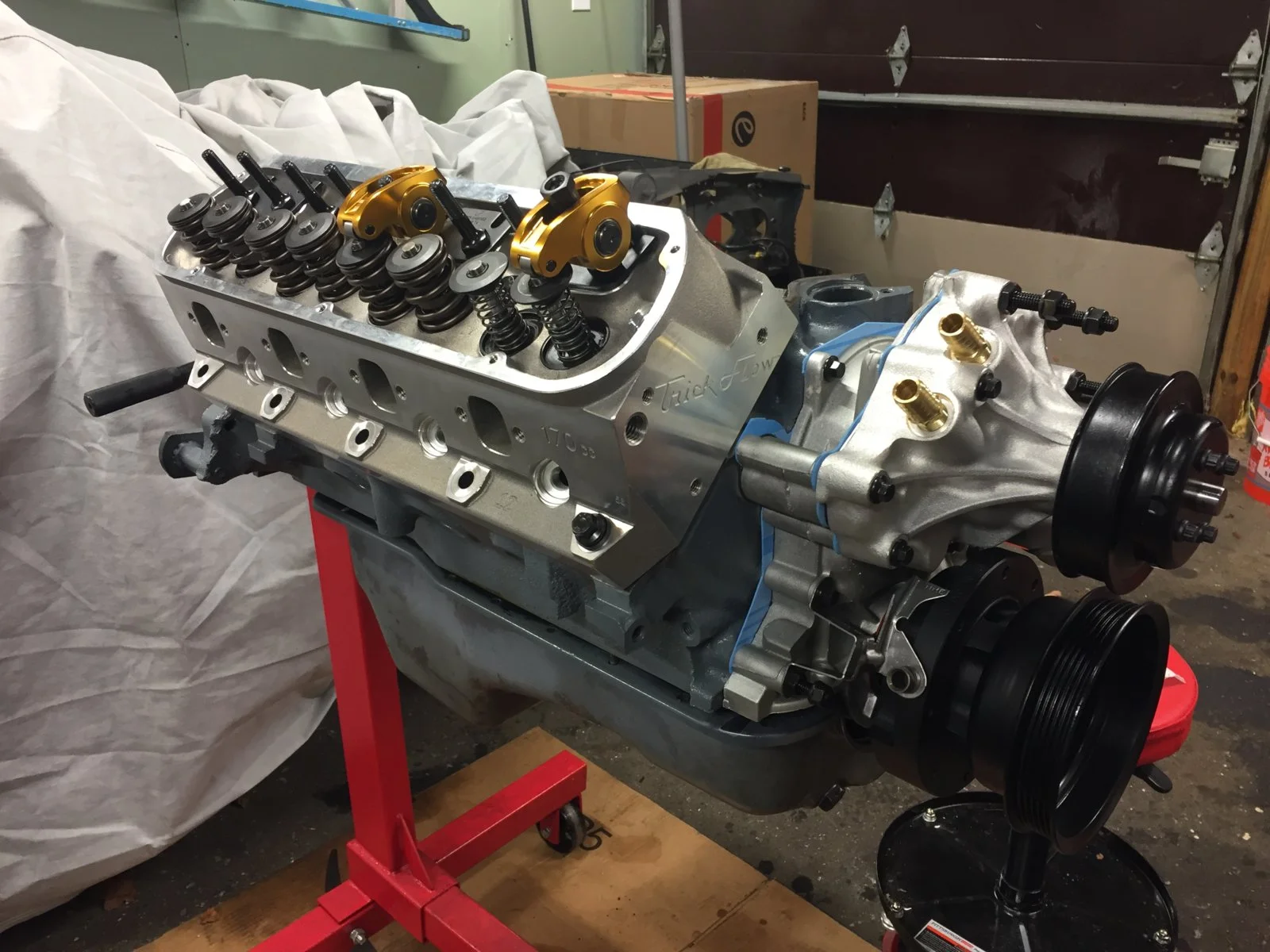

Starting to play with the fun pArts
Reactions: darryl paarman, Olivethefet and 67coupe

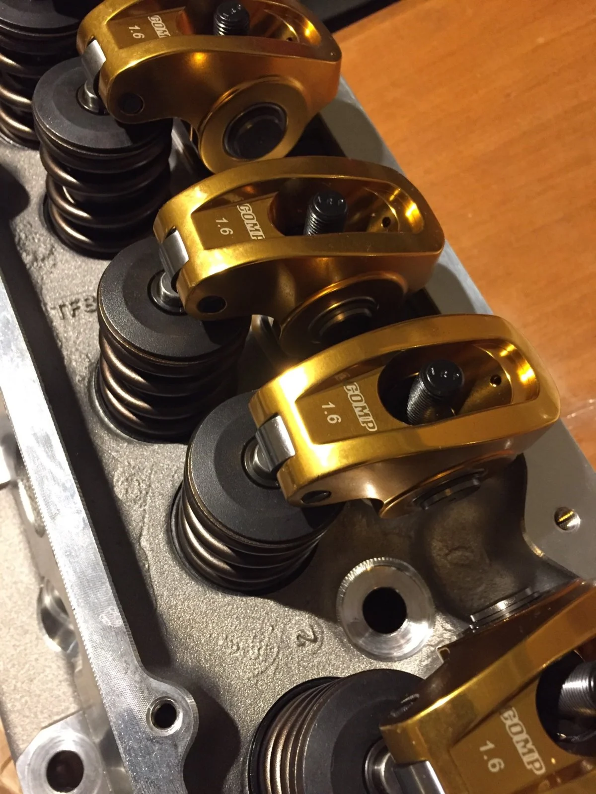

Starting to practice my pushrod measuring technique. I do know I’ll be somewhere in the neighborhood of 6.700” or so.
Problem is the lifters still collapse under the pressure of the checker springs. I’ll have to check the hardware store for lighter ones.
The ford racing lifters are different lenght than stock lifters by a tad, so unsure if making solids from my old lifters will work well. I also need to figure out how much preload to factor in with the M6500-R302 lifters.
In other words, i gotta take my time here and do this step right.
