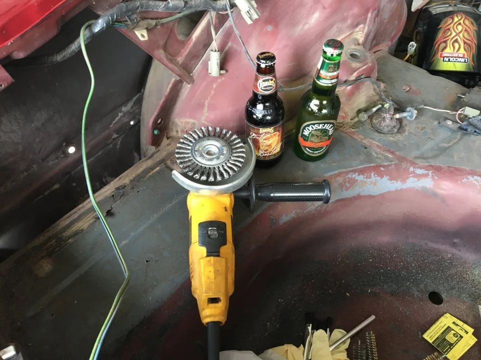

Ok, I have a conundrum here, I was going to start on the rear end removing the seam sealer.The grandchildren have gone home, I'm a little bleary eyed and am not sure which of these three to start using first.
Any thoughts?
Boosted92LX
Dec 19, 2010
5,721
4,244
224
Feb 21, 2016
#302
  • Feb 21, 2016
  • #302
Any thoughts?
The only brand in that pic I've used in the past is the Dewalt. I can't speak for the other two, but I've used products similar to them and had good results.

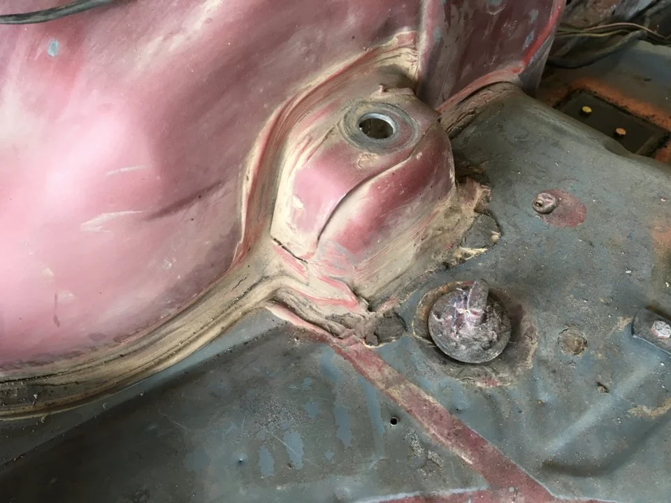

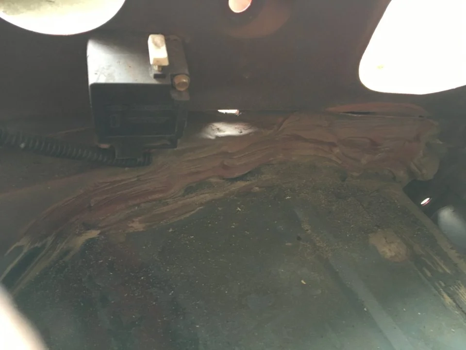

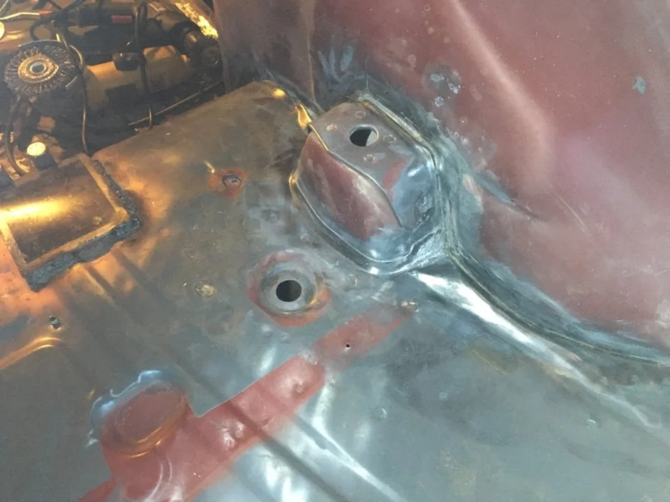

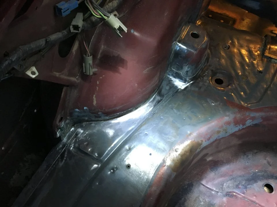

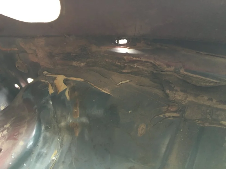

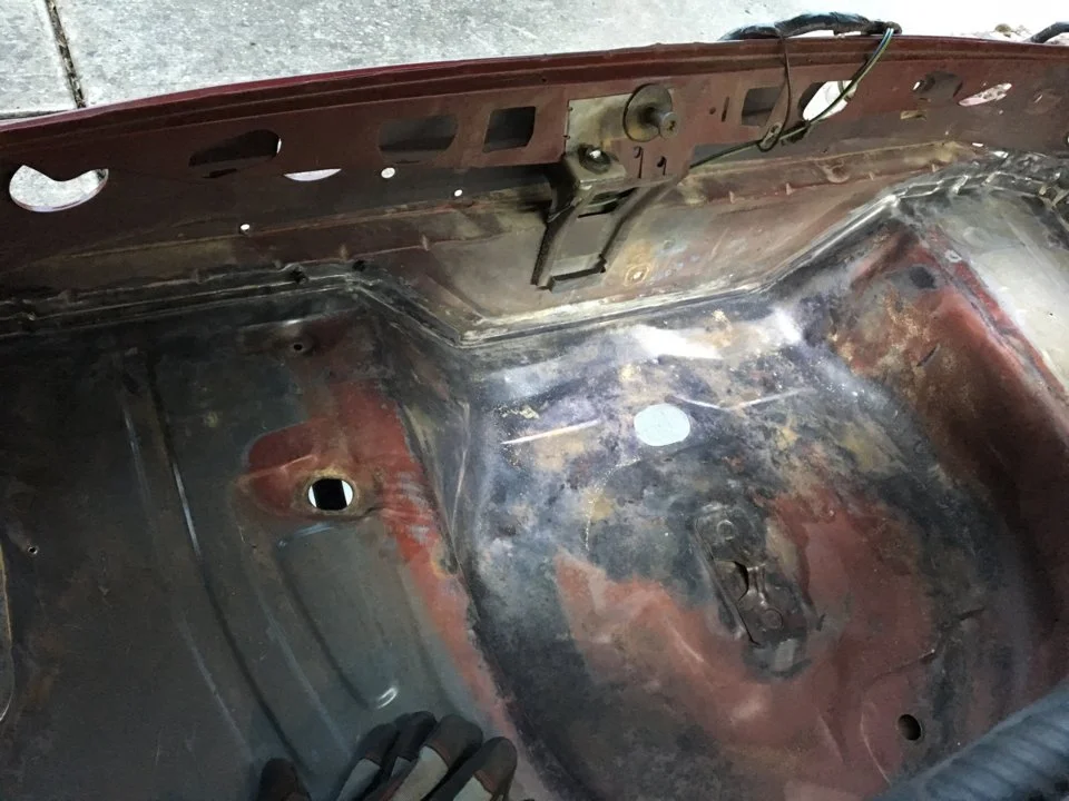

Taking a little bit longer to finish off the seam sealer than my wife likes, so I'm just a breath away from finishing. I'm afraid my wife will snatch that last breath from my dying body if I don't stop, so here's today's progress.
I got almost all of the old seam sealer off. I used my drimmel to get in the tight corners.
No real rust to speak of except for in the spare tire area, and it was just surface rust.
I'll finish the little bit on the right rear wheel well area tomorrow.
I have to wash the interior down before I will be able to roll out the POR 15.
It's supposed to warm back up to the sixties here on Wednesday, so I'll shoot to POR it then.
If you are sharp, you will notice where the floor is tweaked a bit from beating the hell out of the wheel wells. I want 285's and no rubbing problems.
Here's some photos for you guys that don't read text:
All I know is.......
I'm soo glad it's you doing all that, and not me.
I played that tune two years ago, and it sucked.
I was particularly fond of removing the stray pieces of wire out of my clothes, and skin that flew off that wheel at 13000 RPM.
Reactions: Davedacarpainter

While its apart,and the floor is already tweaked,and you wanna run a fat tire-and since you have a welder... Wheel tubs..
@madmike1157 has a cool way of doing them (at least I think it was him lol.)

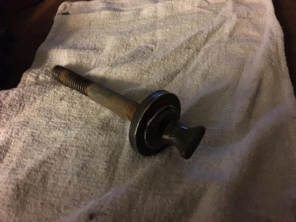

What is this bolt looking object? It is right next to my left rear shock tower. I know this is lame, by I have no memory of what this goes to....old, old, old...

Fuel tank strap mount?

41
Taylorsville ky
youtube.com
Feb 23, 2016
#313
  • Feb 23, 2016
  • #313
In the way of the New wheel tubs?
Nope, not that, thanks though. How's the weather in Iowa?

I was going to say "clevis for holding down the jack handle".
It goes through the frame underneath the rear, right above where the diff tubes are. I'll remember eventually. Has large threads like it might hold a rubber bumper, I just don't recall that.
