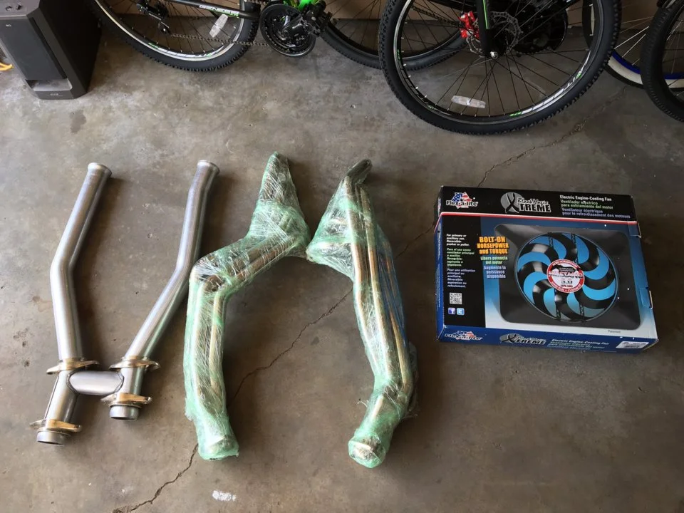

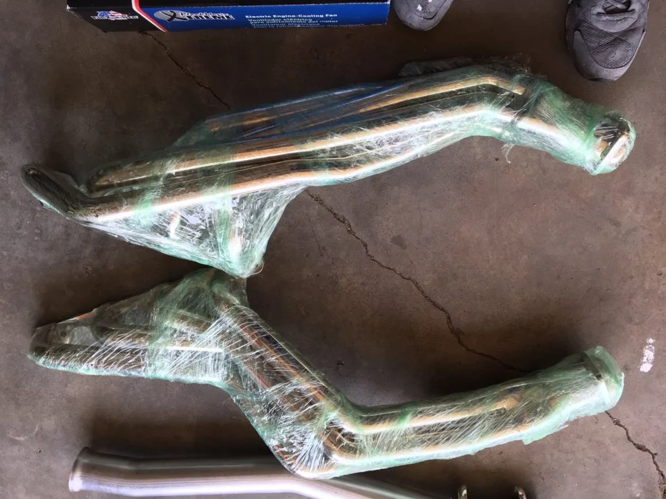

Just got some new parts in today! Thanks to @A5literMan , thanks Todd! I can't wait to surprise Doby. Couple of months before they'll be going on the dirty old bit*h.
Into the parts pile they go for now.

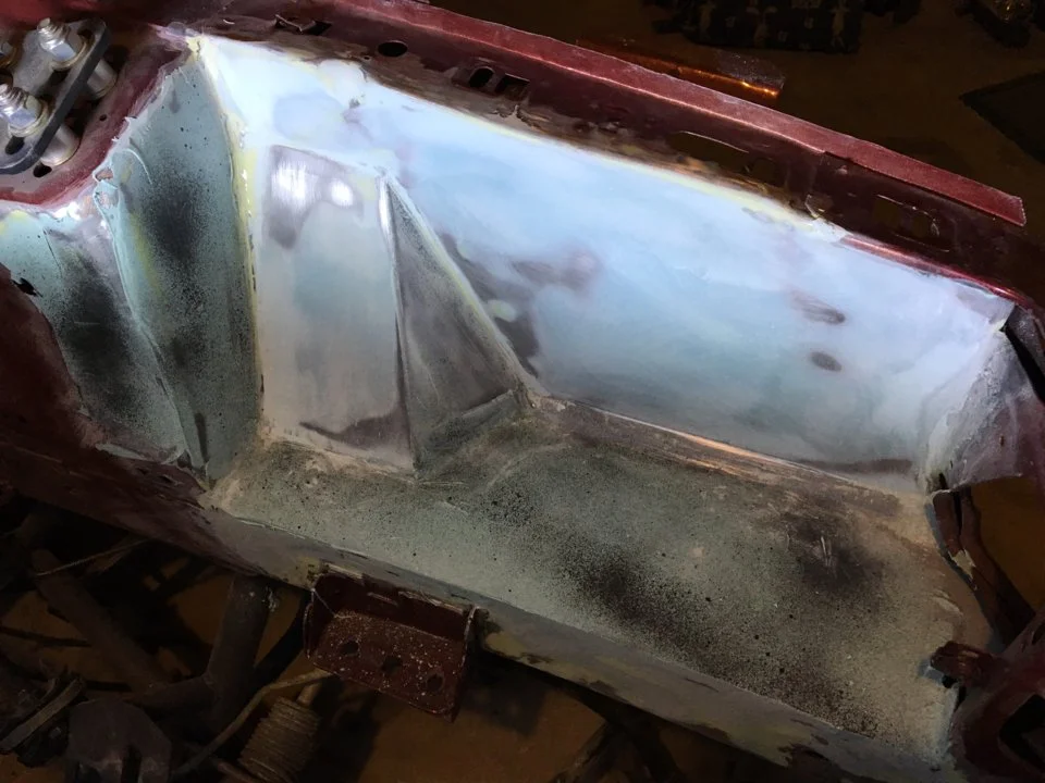

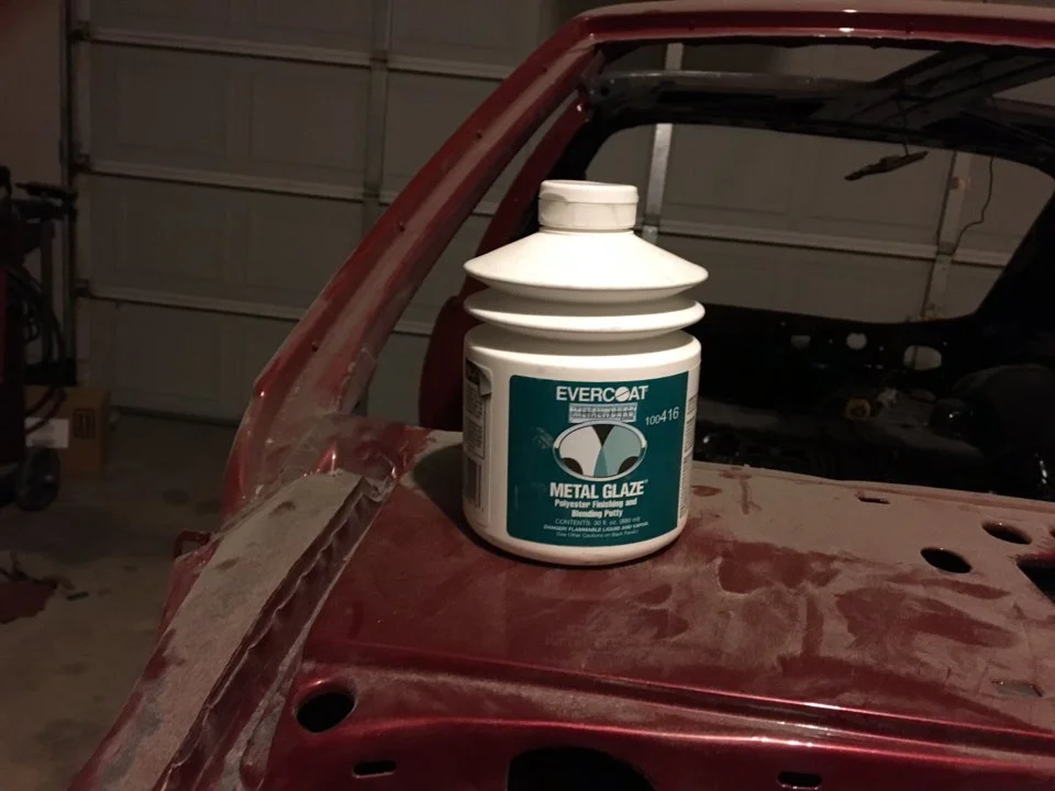

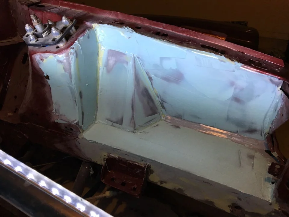

Got back to work on the engine bay this morning. I brought home 180 grit from work yesterday, so it's time to glaze the bondo. FYI, glaze is essentially a very runny bondo that you spread on you bondo work to fill in pin holes and heavier scratches from the straightening process. It's not meant for straightening a panel. It's best to use 180 grit to block this out.
I'm starting with the left panel since this is the one I screwed up by first bending the upper half by being clumsy, and second, by tack welding the lower half too fast and warping the metal. So I had the straightening mostly done until I felt it this morning and thought I should fill in a couple smaller dents that I thought the glaze wouldn't take care of. Took care of it and glazed the panel except for the frame rail and the corners. Be careful mixing up glaze, it spreads much farther than bondo does. So if you mix up as much as you did when you mixed bondo, you'll probably not get it all on the panel before it starts to harden, if what you're spreading it on has multiple facets like the Scott Rod panels. When it starts to feel tacky while spreading it out, stop using that batch. You want this to flow down into the pin holes and scratches. Use pressure spreading it as well, you want it to squeeze into your work.
I ran out of time blocking it this morning, got some of it though. Use a guide coat when blocking, btw, it'll make sure you get the entire area and mainly it helps with making sure the panel is straight. Though, like I said before, glaze isn't for the straightening process.
I know, it looks like the whole panel has mud on it. Fact is, it does! Oh well, once I primer it, who will know?
I've been reading Trbofox's build thread on his t-top notch, great reading for anyone building a car. He turned an absolute turd into a diamond. The color he put on his car is similar to mine, ironically. When he painted his engine bay I couldn't help but get excited, hopefully Doby will be half as nice as his.
Off to work, I'll finish glazing and blocking this side tomorrow morning and get on to the passenger side.
