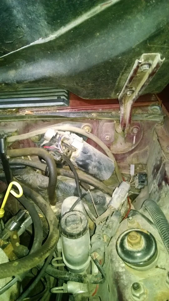

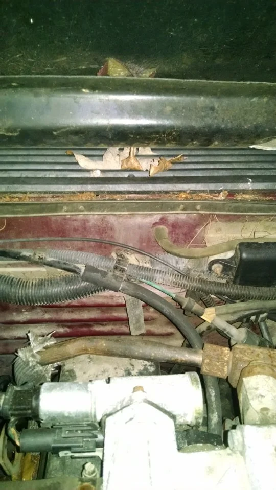

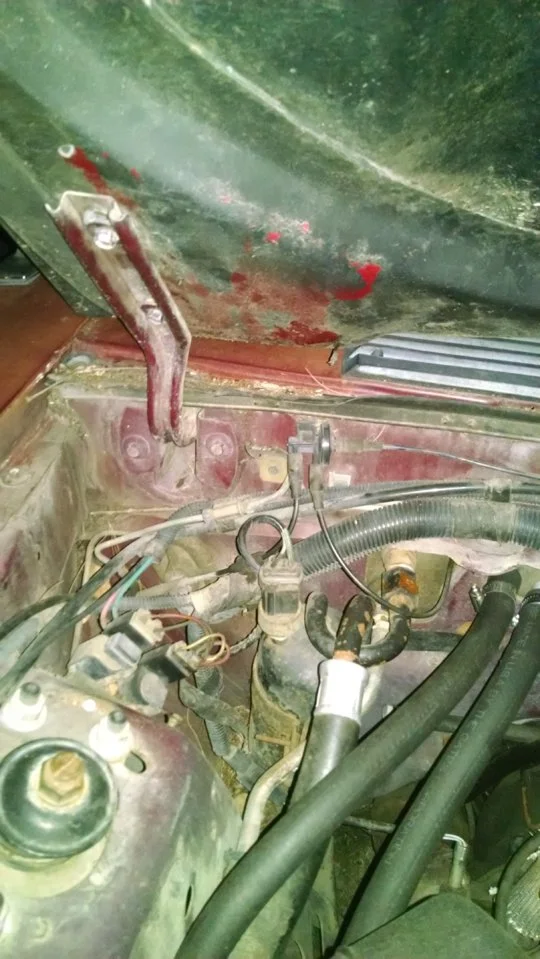

Would you take a picture for me? I'm going carbureted on Doby, so some of the efi stuff is gone. It's been a couple years since tear down though. Kind of forgotten some stuff.

The holes are for the MAP sensor, Vacuum tree. You can actually remove that entire firewall seam and smooth it out Not sure what dimples you are pointing to.
The dimples look like a place to keep something from rotating, or possibly a marker for the place to drill holes at the factory?
