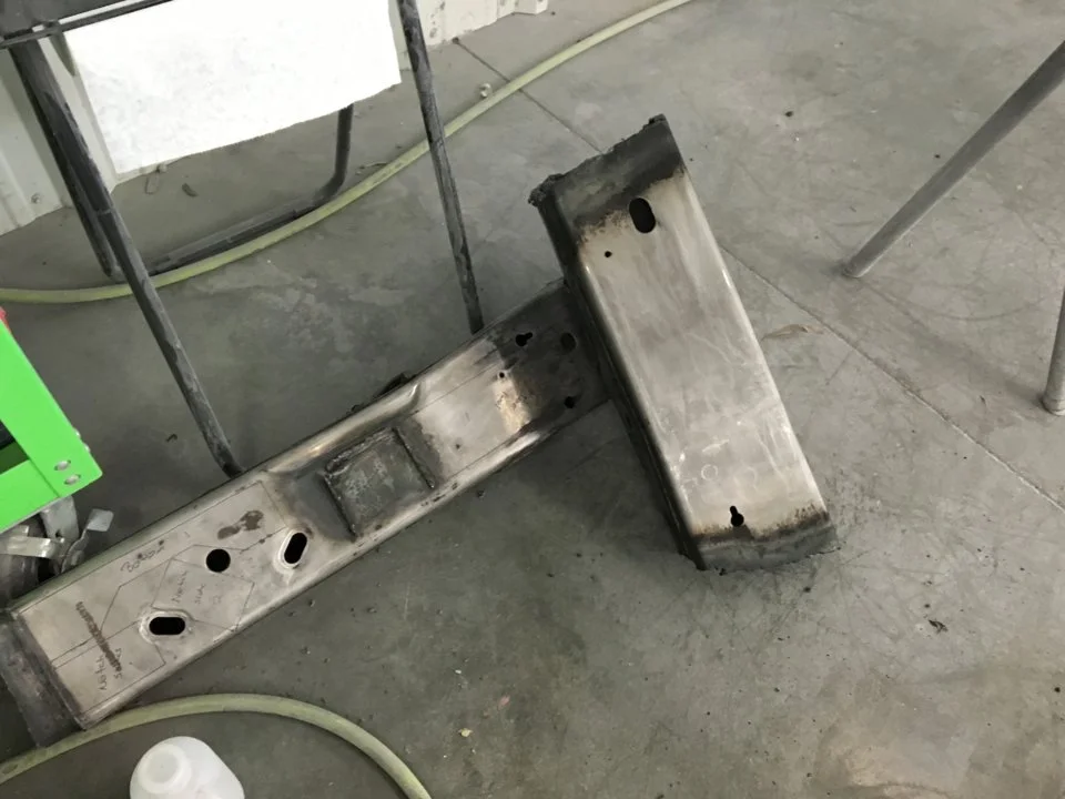

You could make a hell of a seatbelt mount outta that deluxe kit
Okay, you bring up a point with the seat belt mounting bracket.
Relocating that is necessary if I want to tub the rear end more than 1.25". 1.25" gets me 315's.
I have to admit, I've been playing with the 335's in my head.
So, here's the dealio. If I want to have a panhard bar, the coilovers need to be at a straight 90 degree angle, or at least the driver's side needs to be.
I talked to Jack Hidley at MM (thanks
@bird_dog0347 ). Without more fabrication than I'm willing to do, the panhard bar won't work. The problem is the mount for the panhard bar on the driver's side shock area. In order to fit 335's, I would have to relocate the lower mount even farther in than the 1.25" I was planning on. I have an easy solution to move the lower mount over 1.25", if I go further, I might as well do a drag racing set up and drop in a bored and stroked 351. Maybe a chute for just in case......
I will need to do some minor modification of MM's bracket just for the 1.25" tubbing, nothing crazy, little cutting and welding of their brackets. Nothing too crazy. Yet, I suppose if I put the lower bracket over like
@madmike1157 , and I could modify the MM panhard bracket to not use the shock mount on it and to clear my new lower shock mount......
Then a 2.5" mini tubbing could happen.
Got to do some thinking, I will probably just use 315's and be happy.
Soooo, a panhard bar would not only be very functional, it would be cool.
335's would be just so awesomely btchin'. I would just need to corner like your great grandmother out for a Sunday afternoon drive. It would look very cool though
