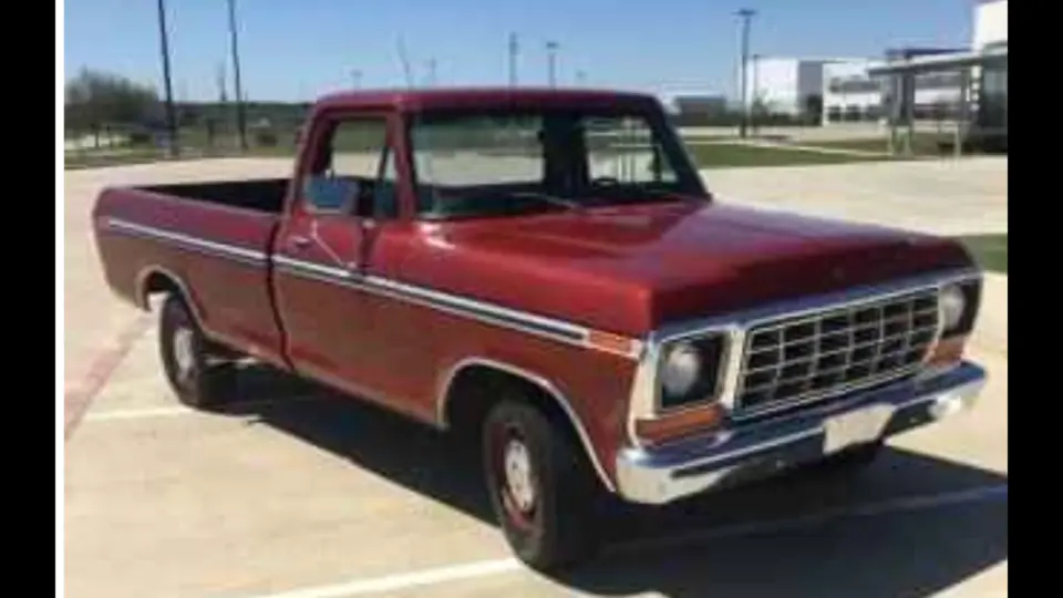

Here's what i got from Craigslist. I love these. My dad had one and I've always wanted one.
Yes, it's a longbed, but there's a lot of nostalgia there for me.
My truck is a long bed, it comes in handy if you haul bigger stuff.
Looks good from the picture, kind of hard to tell though, huh?
