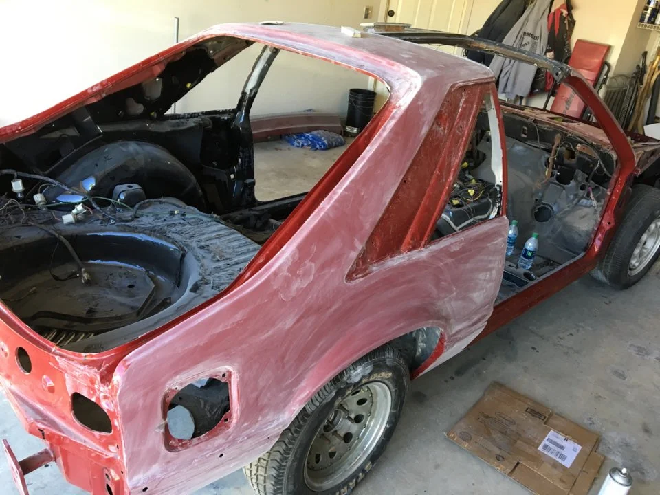

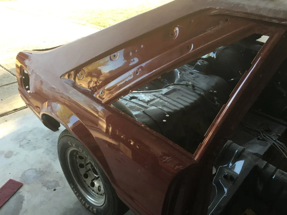

Ok, blocking out the expensive shiny red primer I put on doby several months ago.
Got to admit, that Sikkens clear still looks stunning, if it weren't for that whole wrong color thing.....
Anyhow, I'm using dry 800 grit sandpaper and several different blocks. Here's some early pics:

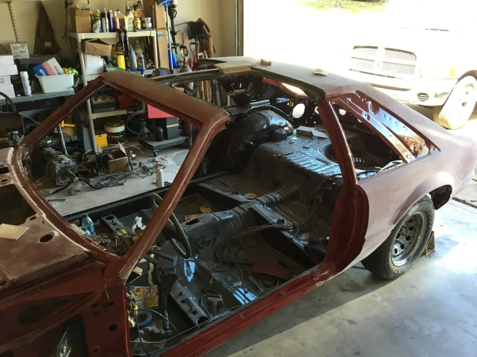

Ok, got everything blocked except the rockers and door jambs, that's for tomorrow.

You may want to hold on blocking those rear quarters until you flare the fenders for those monster 335's.
Reactions: 95BlueStallion, Boosted92LX, RaggedGT and 1 other person
Right, what was I thinking.....
And when we say " blocking", I'm assuming that is done dry, with a xxx" long dura block, and 320g paper.
What keeps it from turning into a loaded up piece of junk after using it a minute?

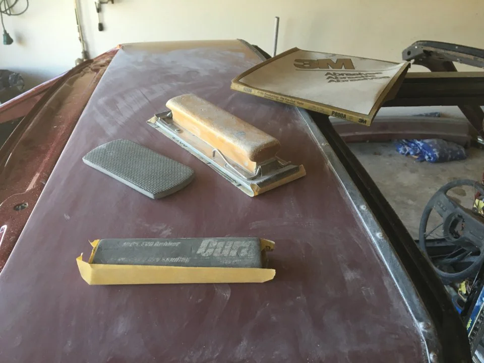

These panels are too little for that big block (I like the durablocks, btw, I'm using one of their smaller ones that I trimmed a little).
Look up a few posts and you'll see the three I'm using. I have the one 12" wooden handled block that I've had for ever, a small flat durablock that is about four inches long, and a flexible (not soft) block.
I have some 3m spray adhesive that I spray on the back side of the paper before I put it on the block. Works real well at keeping it in place. I just use a very light coat of the glue. It doesn't seem to build up on the block except for a small amount that I clean off at the end of the day with lacquer thinner.
When you say a loaded up piece of junk, are you referring to my above solution or do you mean building up with sanding residue from the painted surface I'm blocking?
Plus, at this stage of the main body, since it was already painted with the wrong color once, I'm blocking with dry 800 grit so I won't have to put any sealer back over the body.
The engine bay is being sanded with 320 grit though. I will seal it prior to laying out the color and clear. Those scratches are far too heavy to not seal first.

Ok, I'm talking about me, trying to use 320 dry in primer, and it loads the paper up in 30 sec or less. Then I gotta stop, and take a wire brush to the paper to clean it off. There's gotta be a better way short of wetsanding
Davedacarpainter
SN Certified Technician
Nov 28, 2015
11,833
11,633
203
64
Discordia
Apr 2, 2016
#1,031
  • Apr 2, 2016
  • #1,031
I get the same problem at times Mike. Usually it's because I'm trying to rush the primer.
Take Doby for example though, the clear is doing exactly what you are saying with the 800 grit. I have a red scotchbrite with me to wipe the paper.
You're kind of stuck though Mike. When it loads up like that, it usually means that you are using too fine of a grit. The material coming off can't get out of the way of itself and balls up.
Different primers from different manufactures wil do different things along this line. Even if you let the primer catalyze for what seems an exorbitant amount of time, it can still do that.
I'm assuming you will lay down a sealer first when you go to paint, right? If so, just block out the car with 220-240 grit and then DA the panels with 320 grit to help remove the criss/cross scratches from blocking. DA lightly and don't lift it on its edges (keep it as flat as possible).
